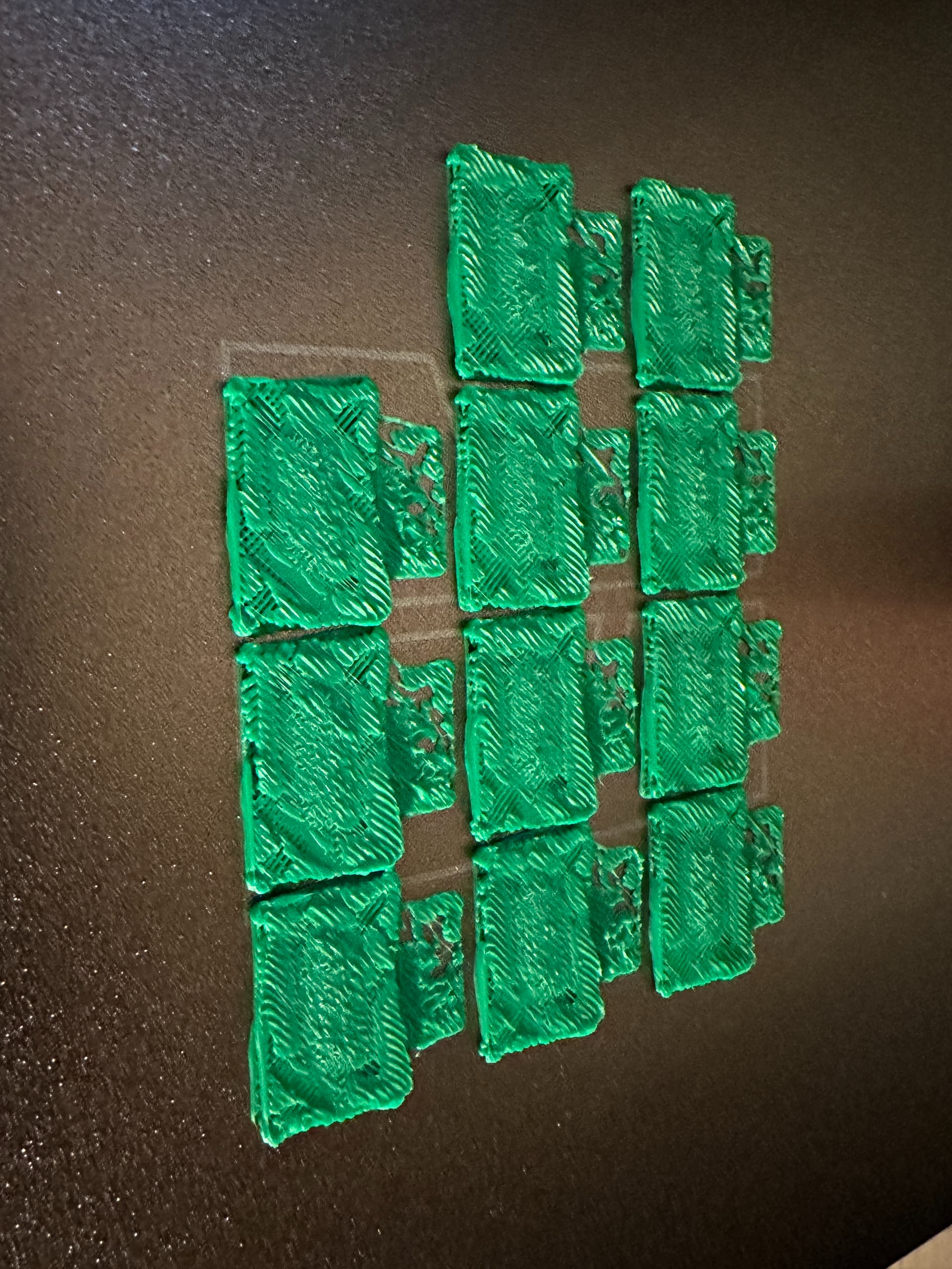

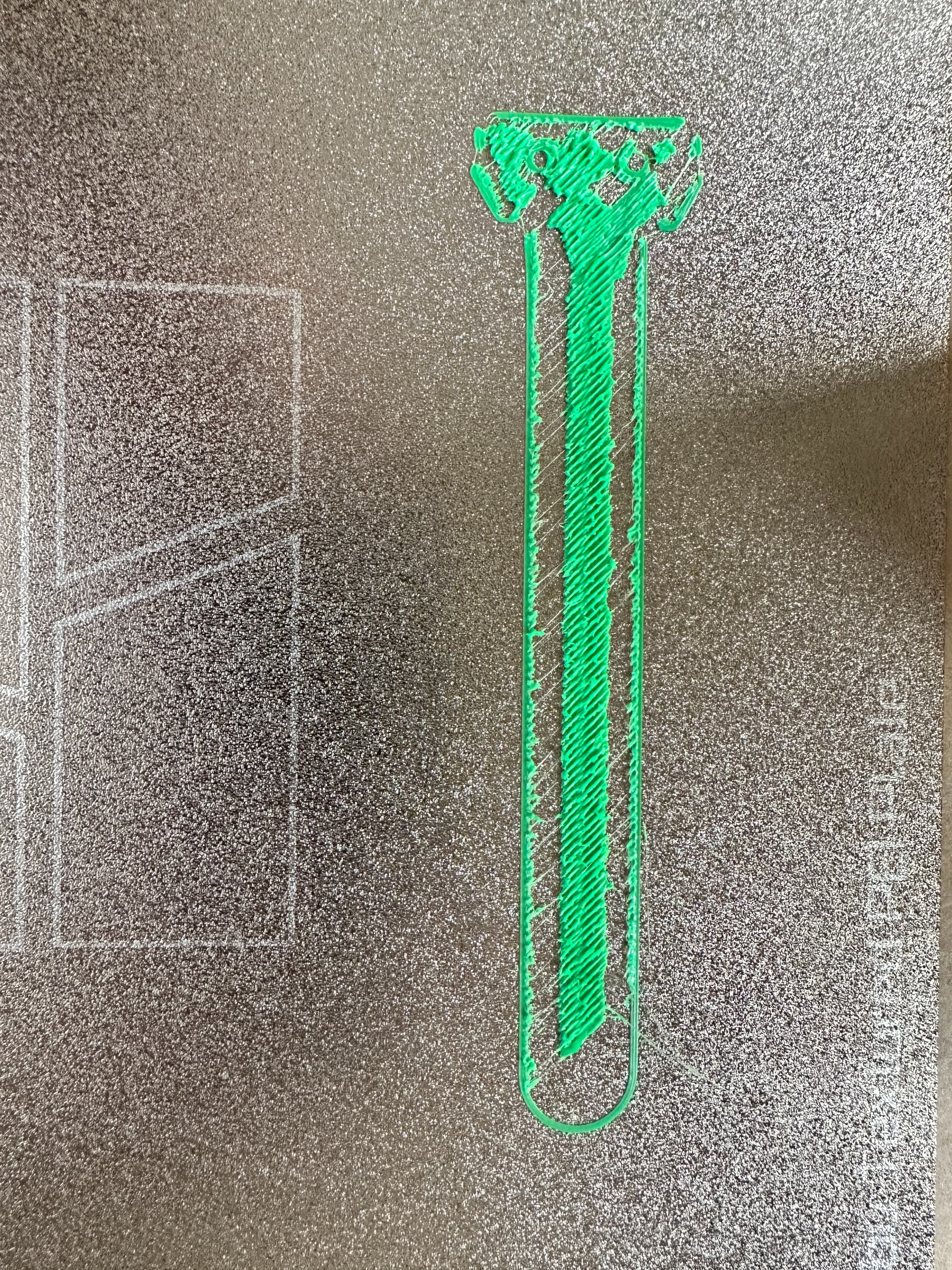

My other problem is that I am unable to get a good print (using an external spool), similar to what this person experienced in the following post except that I have triple checked my setting and everything seems correct. I have upgraded my nozzle (with entire hotend) and filament drive to hardened steel and the nozzle still remains a 0.4
This person had a similar result but different fix https://forum.bambulab.com/t/calibration-prints-look-horrific/165632
I have tried both printing a calibration print and a print which came on the SD card and had to interrupt both. At least the poor printing seems consistent but I must clearly be missing something !!
This is an attempt of a flow calibration print.
This is the bed scraper printing directly from the SD Card in the printer.
I have used the 0.20mm Standard @BBLX1C for the calibration print and the other print uses whatever it was sliced with but according to Bambu readme all the prints on the SD Card can be done with PLA…
There must be something fundamentally wrong as in my understanding it should just print.

If you perform a factory reset and print the benchie from the SD card do you get similar results?
It looks to me like your K value and flow is WAY off…

Thanks, I will give the factory reset a try. I am printing green Bambu PLA basic which was delivered with the printer.
@JonRaymond
Thank you very much a factory reset solved my problem, how the printer got into that state during initial setup is beyond me and I certainly was not expecting it.

I just bought a PS1 yesterday and was having the same issues. The factory reset seems to have fixed my problems! This is my first printer and I can finally get excited after two days of trouble shooting! Thank you!
Fixed my problems too! Thanks!
I just got a P1S and all of my first attempts to print looked identical to your photos. I was getting blobs everywhere and first layers were incomplete. I was trying to run calibration steps with no success. Your post was my gateway to finding a solution. I tried a factory reset and now it works. . Thanks…
Glad this has helped others. This may not be the case for everyone but I did play around with both Bamboo Studio and Orca slicer. Seems the K value is not handled the same which may be a contributing factor per this video.
