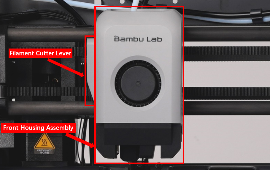

Just connected AMS 2 Pro to my P1S and I even wasn’t able to use it. It can’t pull back filament in slot 1 either push it further. It’s stuck. How to deal with this?
Is the filament still loaded into the print head? If so you will need to activated the filament cutter manually or use the screen to “Unload” the filament.

It is actually loaded. I successfully loaded filaments in slots 1 and 2. Then when I started to print, it got stuck. Bambu studio showed a window with an error. Something like “Filament is stuck or broken”.
I see that filament reached the extruder. I guess I have to disassemble extruder and manually get filament. Or is there a better solution?
Sorry, didn’t mention it. I’ve already tried unloading. This didn’t help either.
I don’t know how to activate the filament cutter manually, I suppose it should be done only during unloading. P1S seems not to have this functionality to activate cutter only.
Reach in and press the filament cutter on the left side of the print head.
If this doesn’t release the filament then you probably have a jam in the extruder.

There was a jam in the extruder. I had to disassemble and clean it. That was an amazing experience though. It’s working well now.
