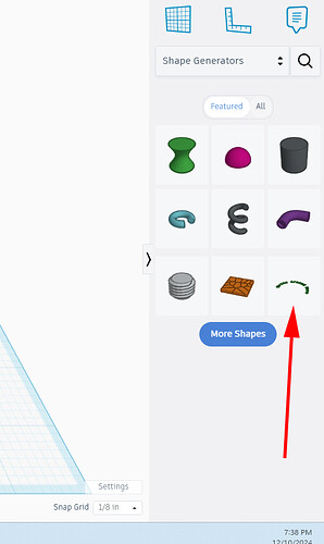

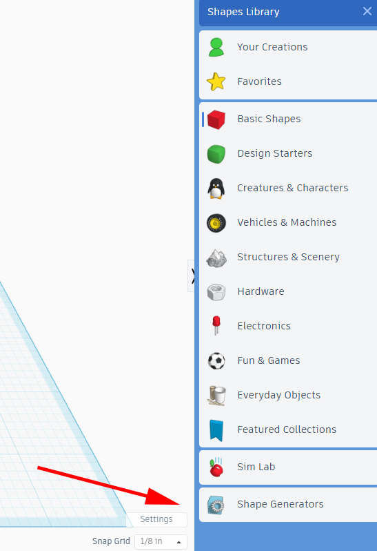

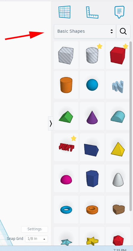

It’s not easy to find but there is actually a curved text function in Tinkercad.
If you click “basic shapes”

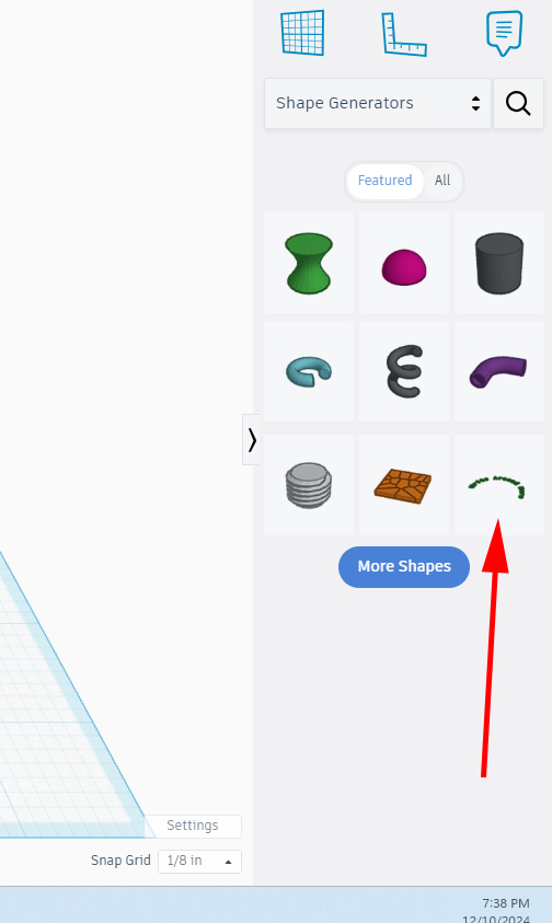

Then “shape generators”
Then drag “curved words” to the work area.
Now you’ll see all sorts of options to rotate it and orientate it to exactly where you want it…

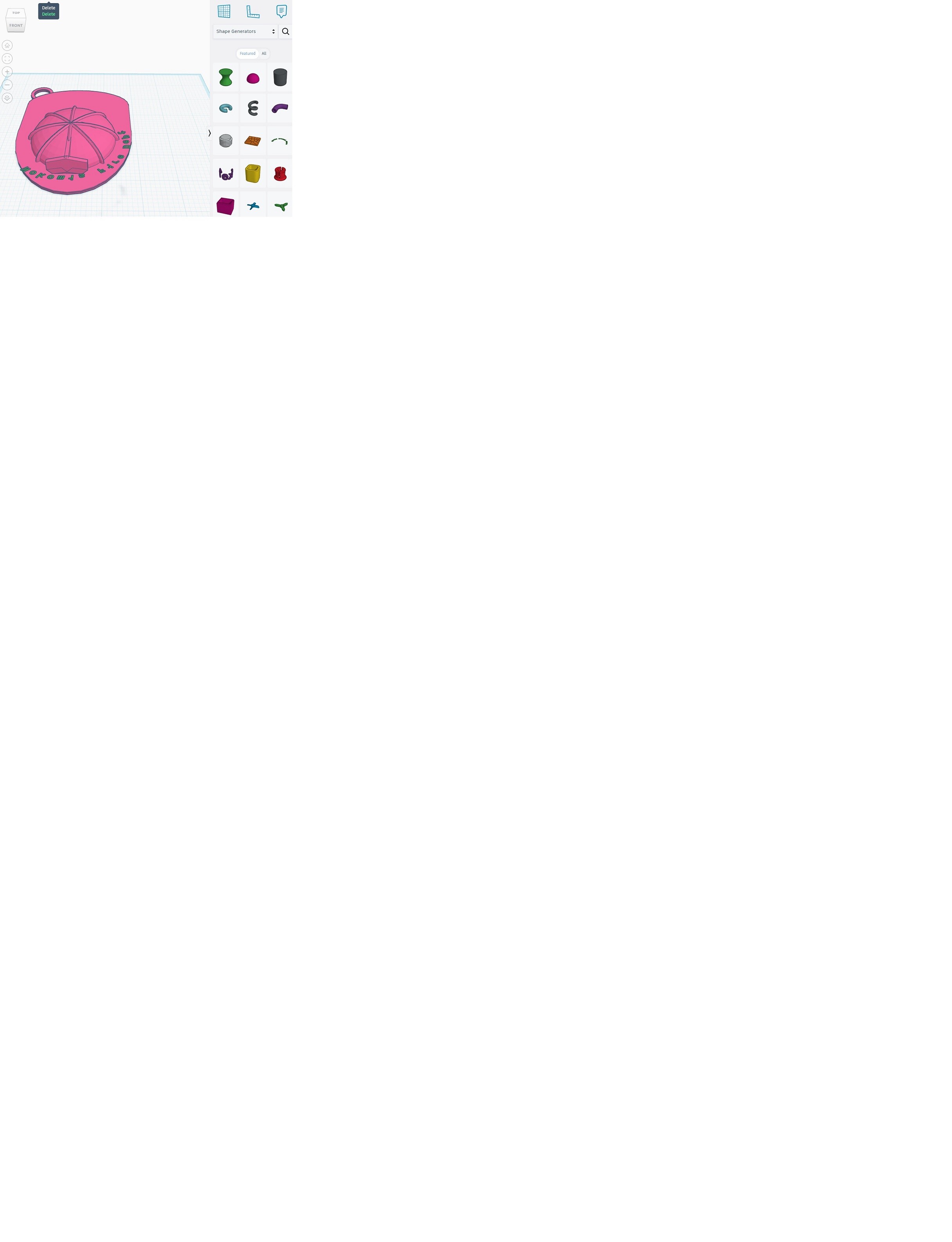

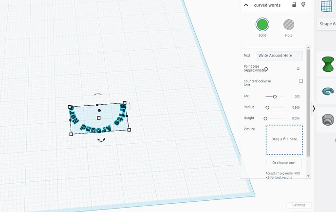

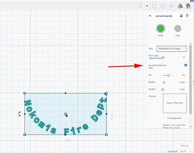

I took the sample shape generator text and typed in my preferred text and tried to " flip it" so the text would read from upper left to upper right but I may be missing an “anchor” or step in the Tinkercad process. I’ve attached a screenshot of that. Thank you again for your kind help.
You’re welcome. You’re almost there. When you type in the text make sure to check “Counterclockwise Text”. That will flip the arc and it should read left to right.

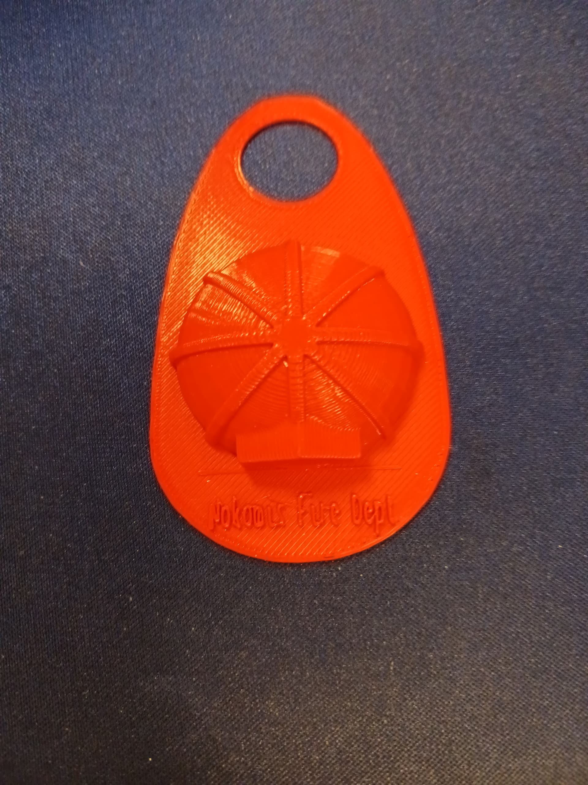

I placed the curved text on the firehat and then Grouped them in Tinkercad abd then saved that as an ,stl file and when I opened that firehat .stl file in Cura I could see the curved text so I then cut the gcode but when it printed with the Lulzbot Taz 6 it never printed the text on the hat.
Did I miss a step?

Was the text still visible after you sliced it, before you printed it? Normally if something is too small it won’t show up after the model is sliced, or only parts of it will show up. Try scaling the model up a little and see if the text prints.
Here’s the rub. :wink: I see the curved text in Tinkercad and in the Cura Slicer but when it prints the gcode, cut in the Cura 3.6.7, in the old Lulzbot Taz 6 it doesn’t print the text. I then looked at that gcode in the Prusa Slier and you don’t see any text. I’ve scaled it to 109 mm - still no text. I would use my Prusa MK4 but I only have the PLA color needed in 2.85 so I have to use the Lulzbot Taz 6. A friend created the text in Inkspace and then exported as svg and then imported that in the Prusa Slicer but that has so many different settings for the Prusa MK4) by category and numbers than the Lulzbot Taz 6 and since the Lullzbot is not well supported I’m trying to be resourceful. I had no idea curved text was such a challenge. Thank you for any further thoughts.

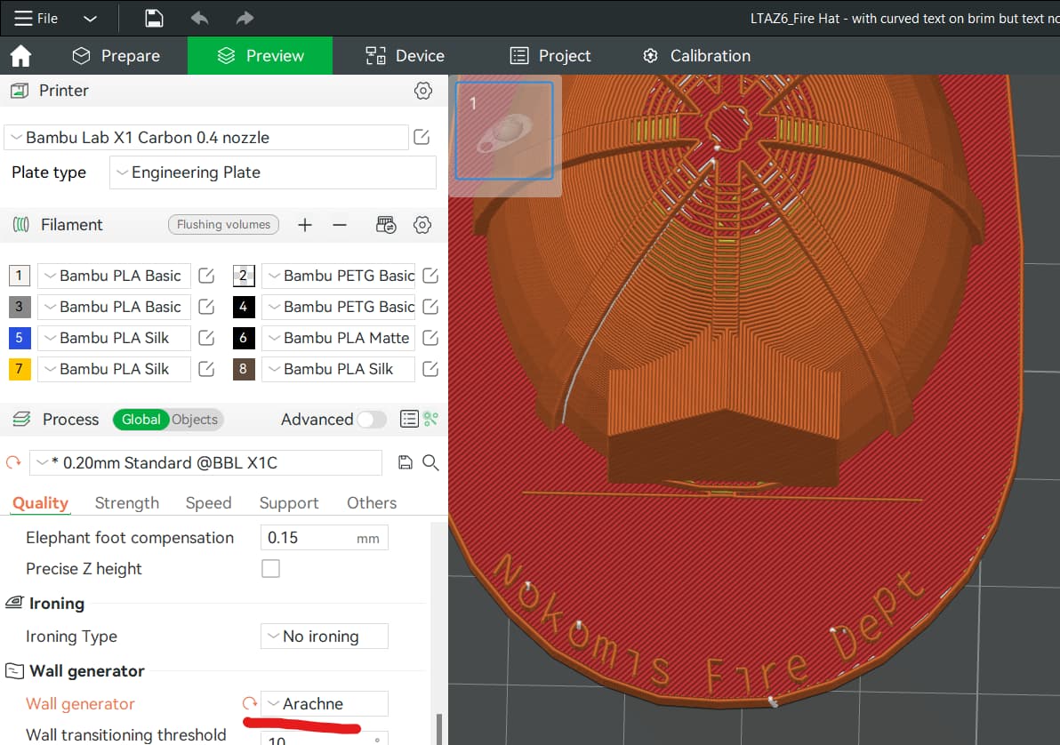

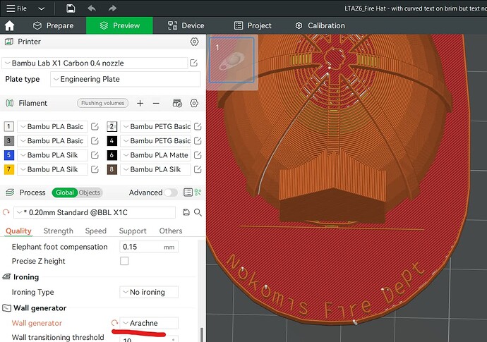

  1. The 3mf has non-manifold edges. Right click on the Object in Studio and “Fix model”.
  2. The letters are finer than a typical .4 nozzle. I measure .33mm. So you’ll definitely want to use Arachne and/or maybe even a .2 nozzle. Or make the letters fatter to ensure that you can squeeze in 2 wall lines (even if they are below nozzle diameter using Arachne). That should give a decent print quality.

I’ve never used Bambu Studio so I’m not following re: Arachne. Do I just press the tab named Arachne? I’m not sure how I would make the letters fatter in Studio using Arachne? Thank you.
Arachne is the type of wall generator which allows wall lines that are thinner than a nozzle diameter. So line quality can be impaired but in practice, it works surprisingly well (within limits of course).
I marked it in my last screenshot to make it easier to find in the Quality settings.

I’m truly a noobie so I don’t see how you reach elephant foot compression. I see .20mm Standard @MK3S and then I just see Arachne. I don’t see how this thickens the text to be printed? Thank you.
Elephant foot compensation is a first layer thing and not really relevant to this issue which occurs on top.
Arachne concerns line width rather than height. So you can print a 0.33 mm line with a 0.4mm nozzle. But for quality, it is best to have 2 walls. With Arachne, you could use a .2 nozzle to get 2 lines into the 0.33mm wide letter lines.
In order to thicken the letters, which would be ideal, you do however need to do that in Tinkercad as Studio only imported a stl file. CAD work cant’t really be done in Studio.
