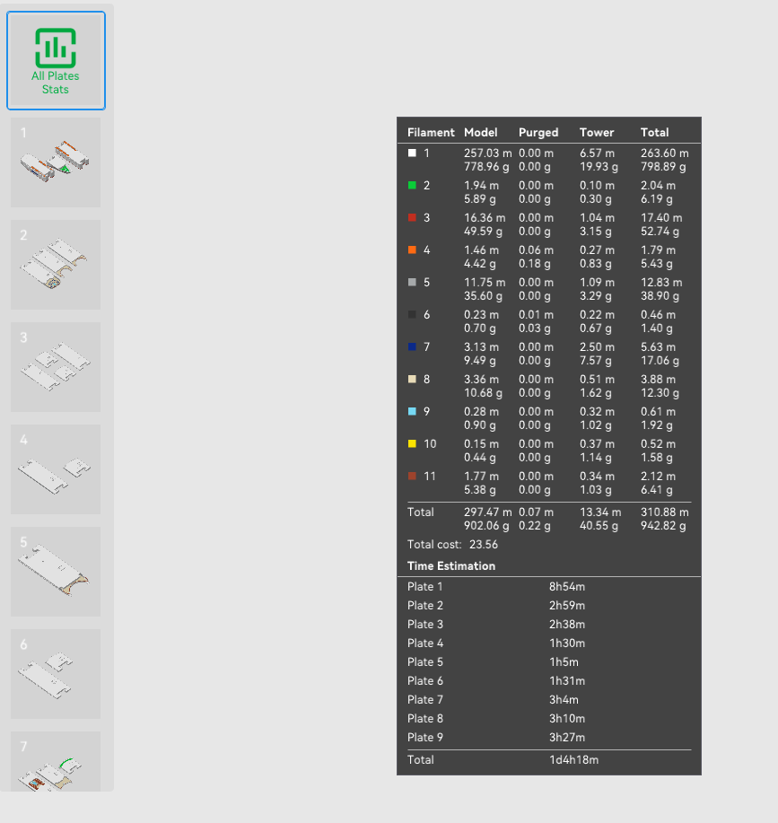

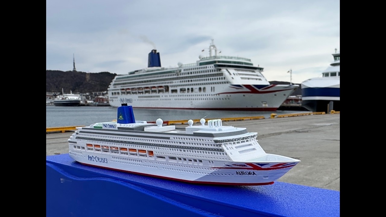

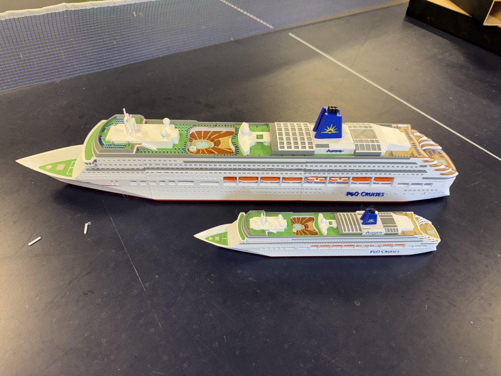

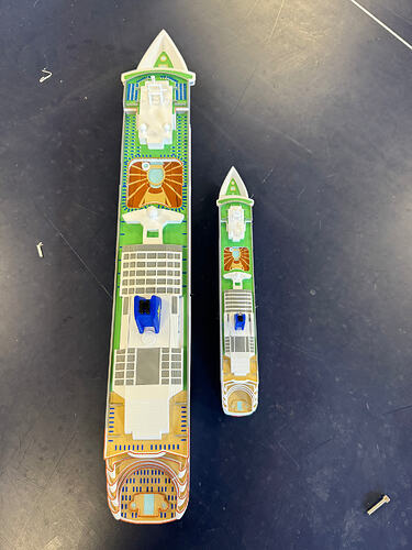

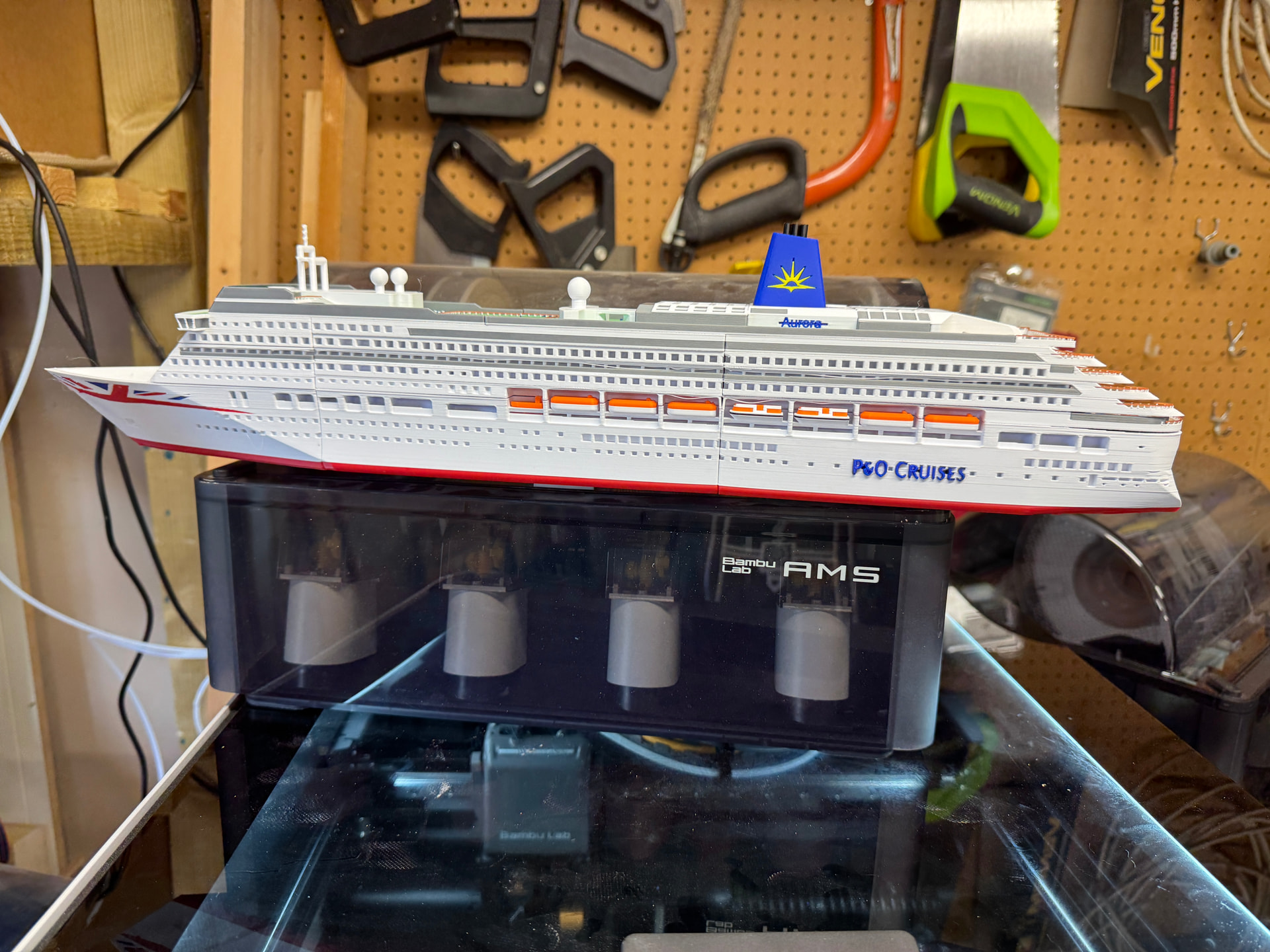

Thanks - Then prints shown are 1:1000/0.4mm nozzle. I’m actually going a level of detail more than this on the 1:500/0.4mm version - which I’m then going to try printing at 1:1000/0.2mm. I’m also going to try scaling the 1:1000/0.4mm version down to 1:2000/0.2mm too to see how it comes out.

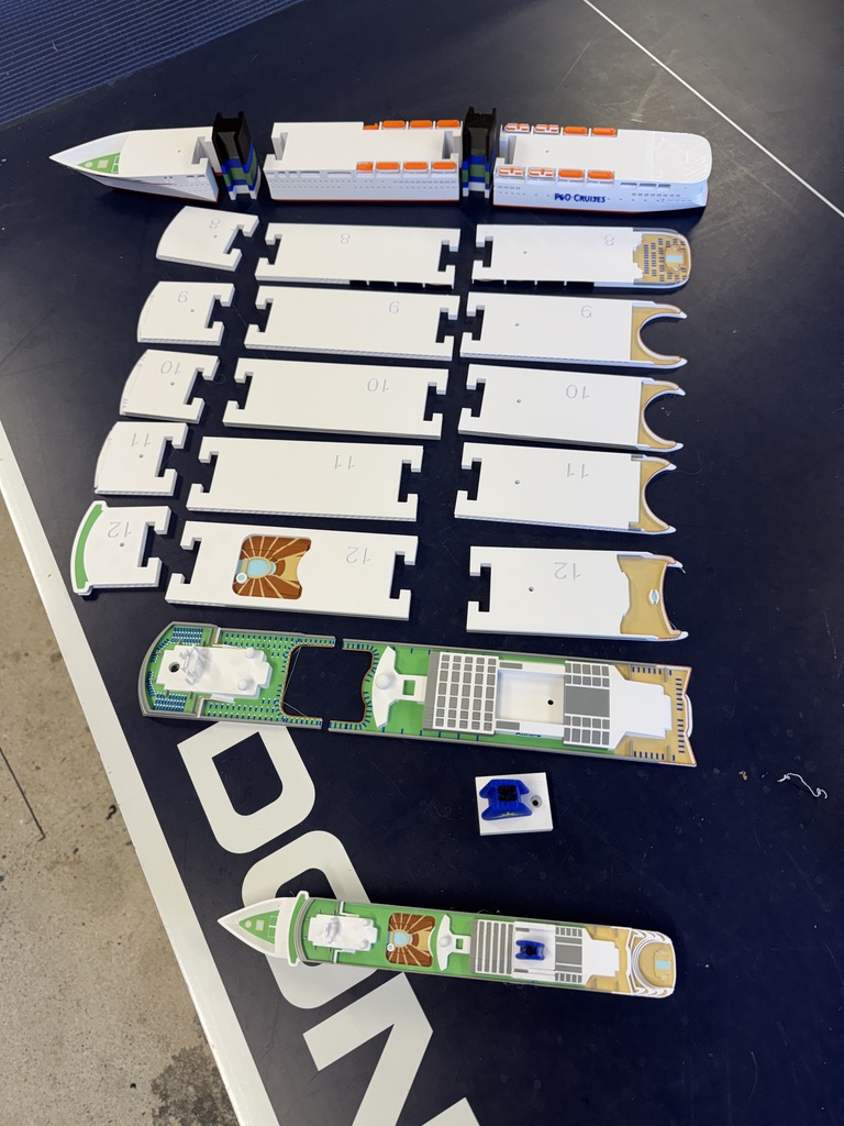

Ready now I think - printing it in one go took about 7 hours - it stopped once due to white running out, and about three times with AI errors - which I told it to ignore.

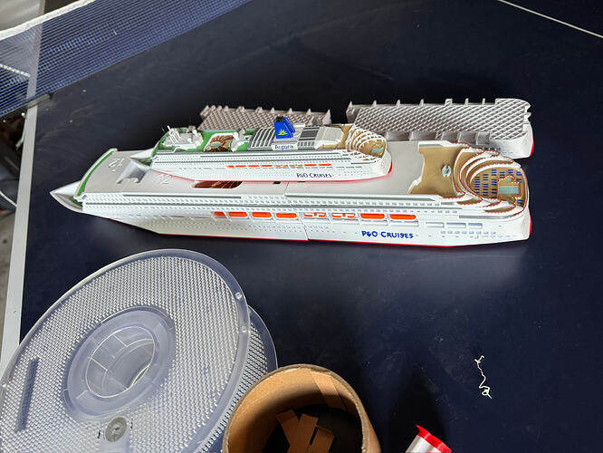

A little bit stringy - but good enough I think for Makerworld.

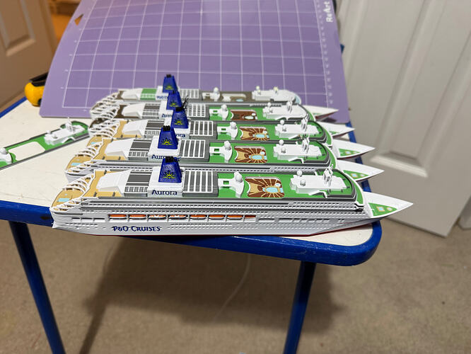

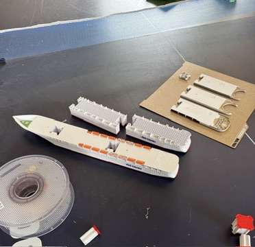

The front two ships are the one done in one go, and the one done in 4 parts. The rest are previous test prints with slight flaws, plus the original version at the back that I did a couple of years ago - but didn’t release until I finally got to cruise on the ship a few weeks ago.

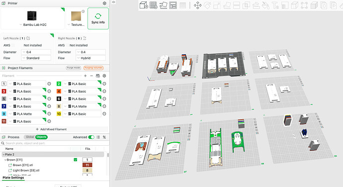

1:500 multi part version now ready to start printing.
Short video - showing Fusion Model and Timelapse of 1:1000 Aurora print - which is now published on Makerworld.

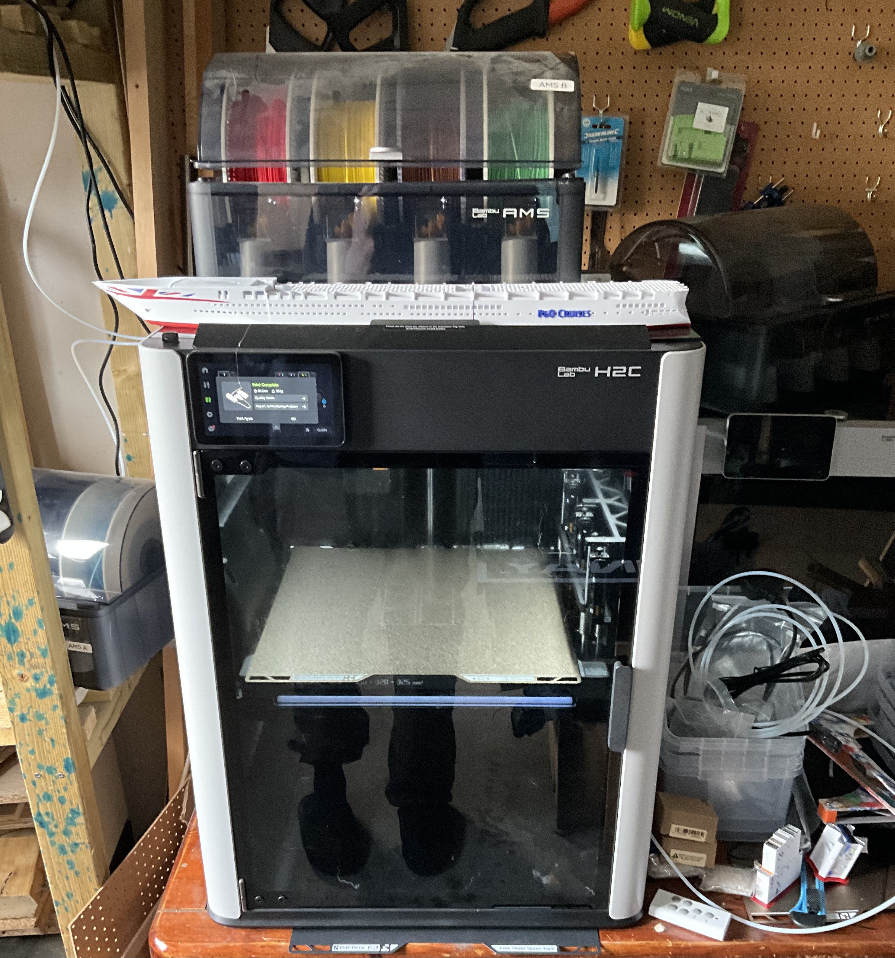

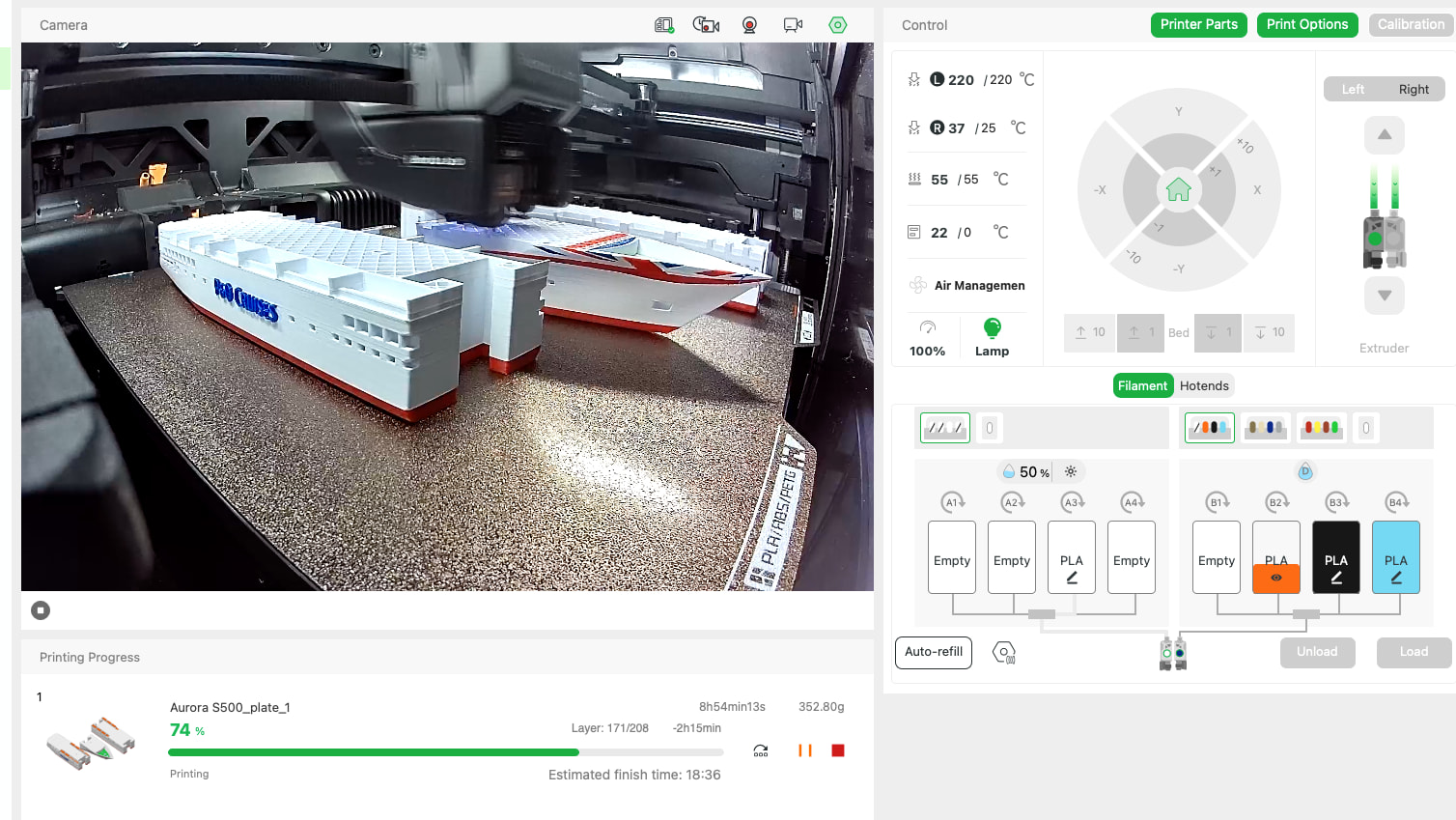

1:500 print progressing fairly well - one AI stop, 1 stop due to snapped white filament, and a really strange stop due to being unable to extract the Red Filament - It took me a while to work out what was going on - as I couldn’t find the AMS with Red in it - I eventually found it upside down behind the printer - it must have fallen off of the top!
Anyway recovered the print ok - and the first plate is still going.
Print failed shortly after previous post -as I had accidentally turned off the modelled supports below the lifeboats - so had to reprint the back and middle section - luckily the front section wasn’t affected - so did object cancellation.
I imagine a bit of orange filament was wasted due to now unnecessary colour changes - but overall print progressing well.

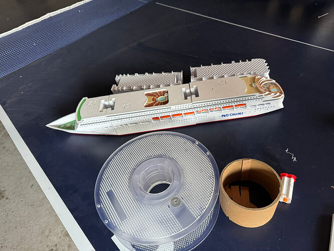

1:500 Aurora print almost complete - only 2 plates to go.

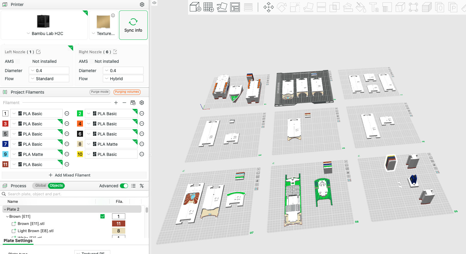

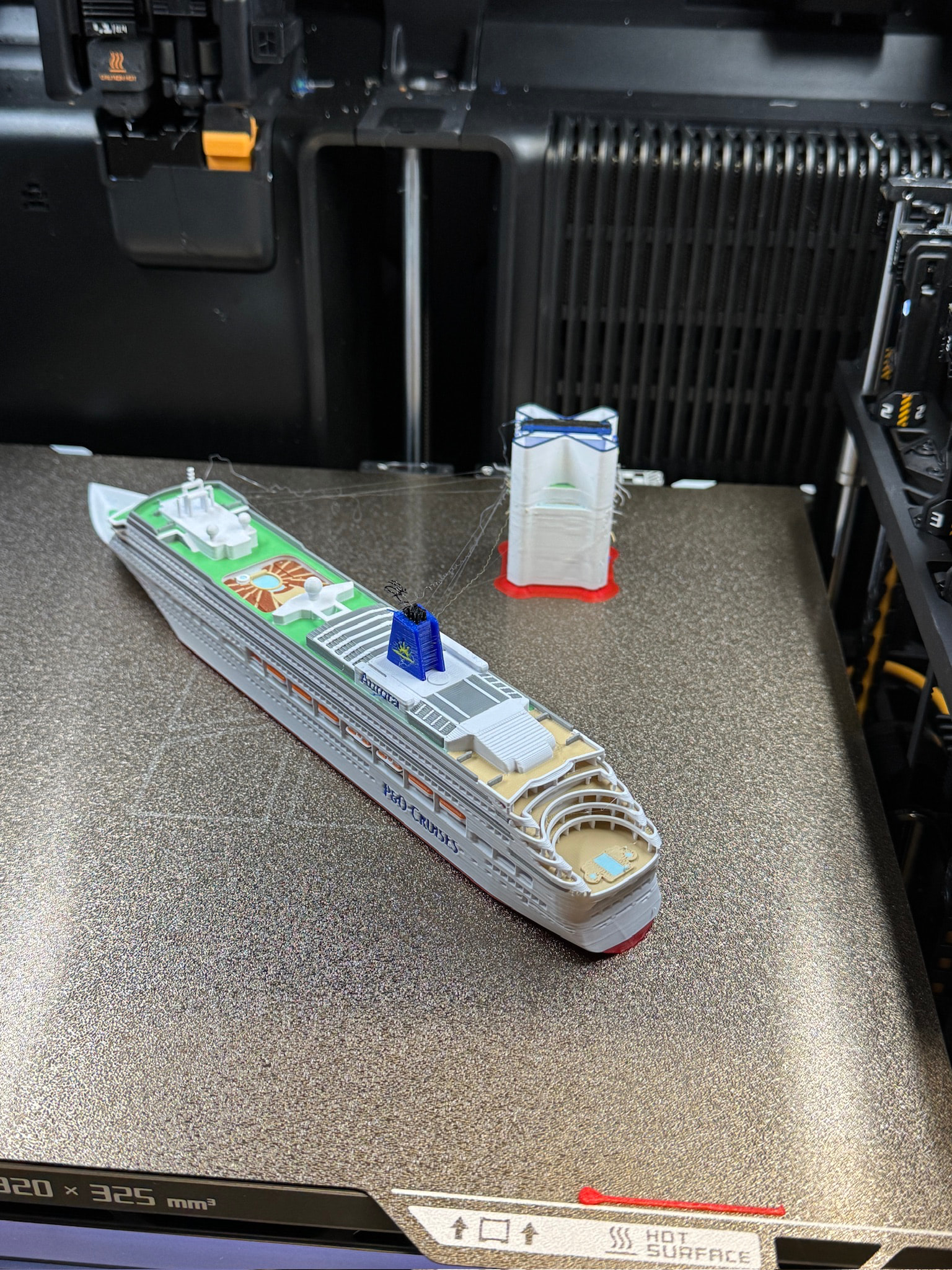

Had an issue with the h2C Supertach Build plate - which decided to lift off the parts and make them too messy to use - so ended up re-printing a whole plate again on a textured plate.
Strange - because I usually find supertach sticks better than textured.
Will have to try some glue I suppose.

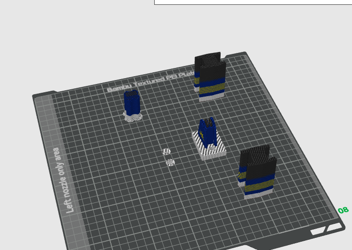

Seeing that prime tower on the photo - does make me wonder whether that type of prime tower could be used as ‘springyT’ connectors - if the holes in the main parts were designed the correct shape.
Might try that for my next ship - the springyT’s for this one are this shape - note I am using purge-into-infill - although its mainly to avoid an extra plate on the H2C - rather than for actual purge saving.

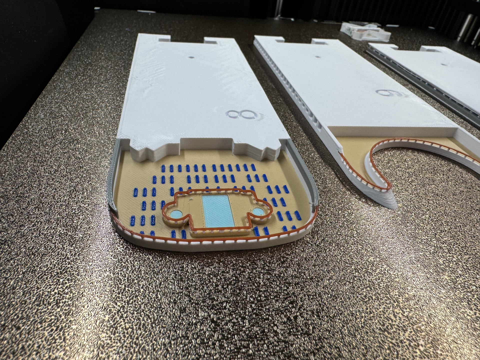

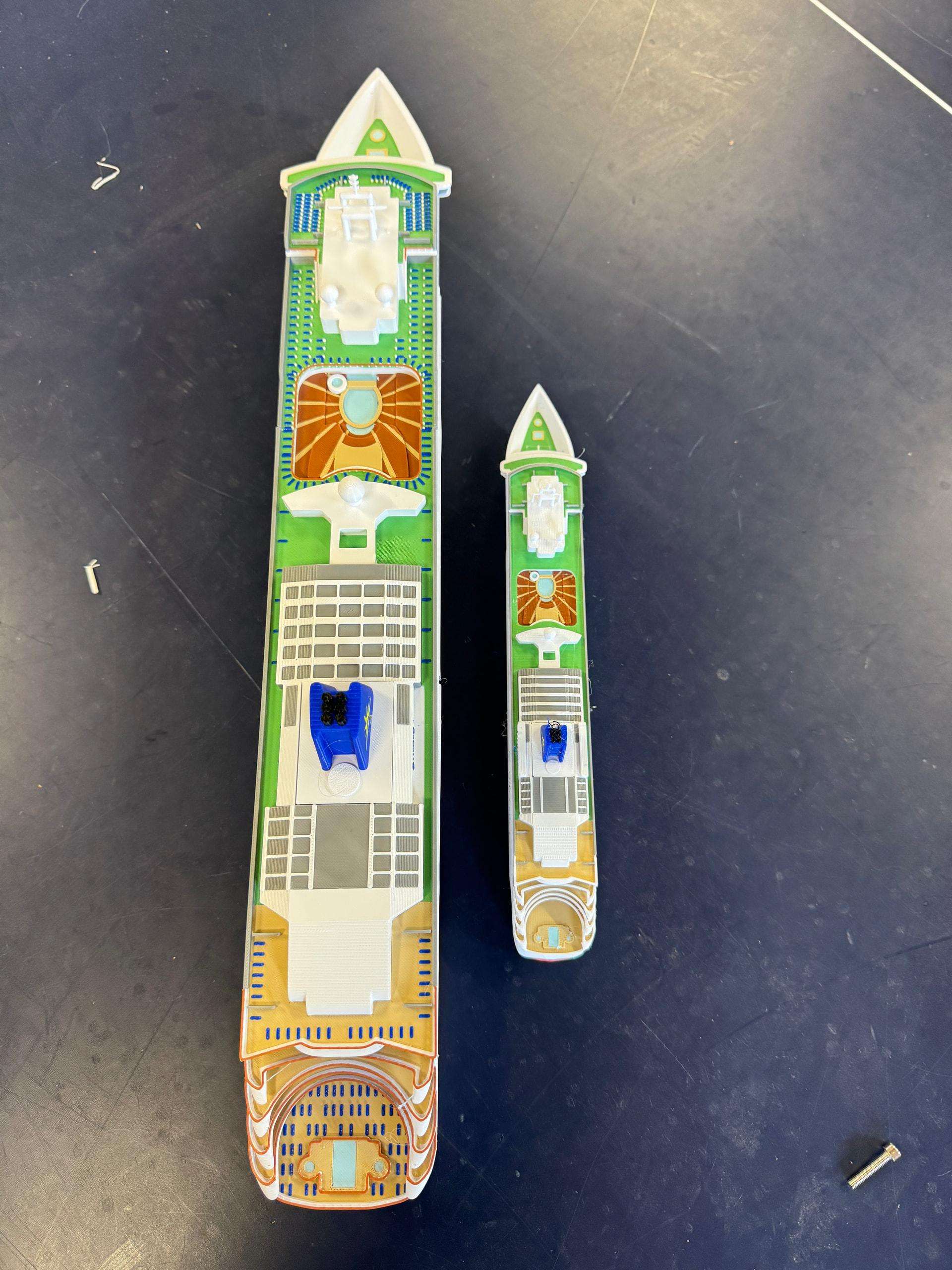

Aurora 1:500 complete - will probably hold off for a few weeks on putting it on Makerworld as I am hoping to get Prusa to print a version on their CoreOne INDX - its already on Printables - but only in a CoreOne 3mf.
Showing the additional detail on the 1:500 version.

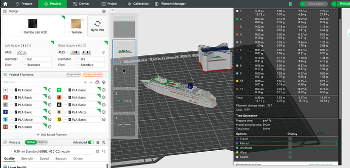

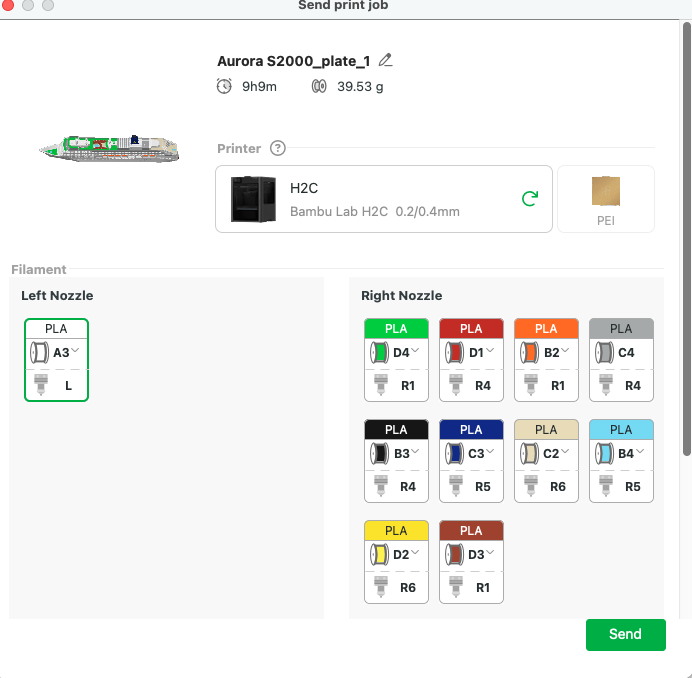

Next stage - I am going to try printing the lower detailed version 1:1000 / 0.4mm - at 1:2000 / 0.2mm - i.e. A quarter size of the larger one shown - as I’ve now got 5 nozzles (1+4), plus a filament track switch to try in the Beta H2C firmware.

Thanks - Aurora 1:1000 is probably my quickest printing ship model - on an H2C - as its P&O’s smallest ship - only 7 hrs - and only about 350 colour changes :wink:
My first 0.2mm Nozzle H2C print just started - I’ve only got 4 Induction 0.2s - so only 5 in total. - Projected print time about 9hrs - this version with be roughly 0.25x0.25x0.25 =0.016 (updated with correct decimal point position) - times the volume of the big one I just did.
