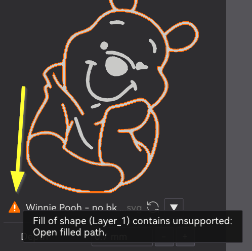

Hi I am new at 3D printing and Bambu Studios. I am trying to curve an object to fit on a cylinder cup but the object I am trying to adhere is flat and I want it to fit around the cup… it’s not text. I would appreciate any help I can get!

What is the object you are looking to join? If you can convert it to an SVG format, then you can use the SVG modifier command and check surface. This will wrap the object around the curve.
Thanks!!! I did not know you could do that!! Either I did something wrong or did not explain what I wanted I want to get a Winnie the Pooh to stand out like the A on the red cut. Thanks for all your help!!!

From the screengrab it looks like you may have the the setting set to high a depths and you’re passing the image through the solid. You want to the image to stay on the surface and use the depth to determine how far out you want the SVG to come out.
If you care to upload the 3MF, I can give you a more precise answer.

winnie the pooh - test.3mf (1.5 MB)
It would appear that there were two issues with the model. The first was that the SVG file had an open path meaning that the lines had “breaks” in them which the slicer couldn’t render. That showed as an exclamation mark.
For the sake of expediency, I brought the file into Inkscape (an open-source, free SVG editor) and flattened it to a single grayscale color. This is not unusual, as the SVG file format includes many optional features and is a poorly implemented specification. Consequently, many programs struggle with it.
I replaced the SVG file with a flat file (simplified SVG) in a single color, which is easier for most programs to process. While this approach doesn’t always work, it did in this case.
Please try out this file and see if it works.
winnie the pooh - test - ver II gray path.3mf (1.5 MB)
If your goal was to do a multicolor SVG, then you may have to experiment with an SVG editor like Inkscape and simplify the paths on your own. This is a trial and error process.
