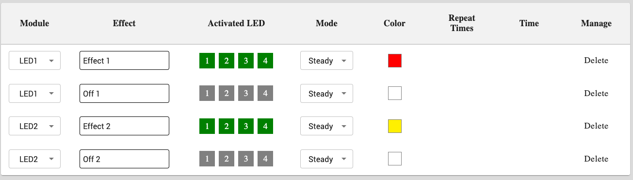

I have almost completed my CyberBrick vehicle, but a dumb “bug” with the LEDs means I may have to launch without any lights.
Have any of you experienced this, and better still, any suggestions?
The short version:

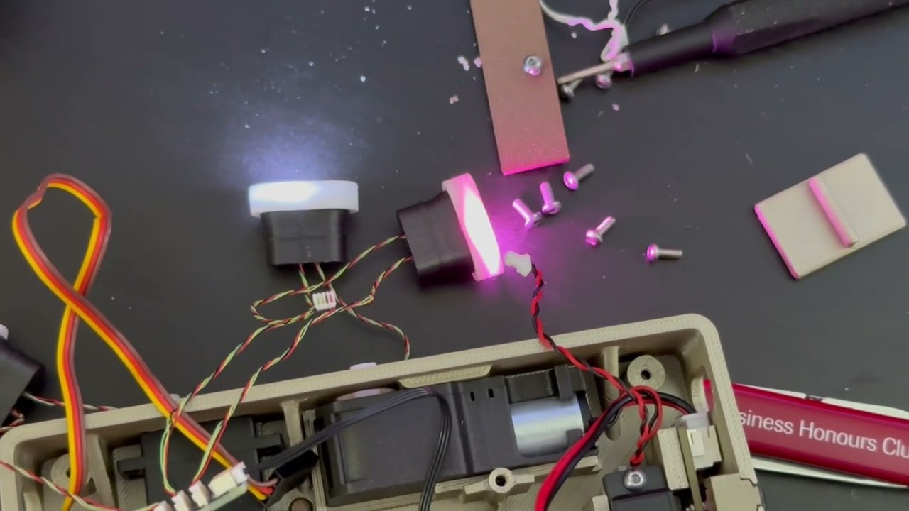

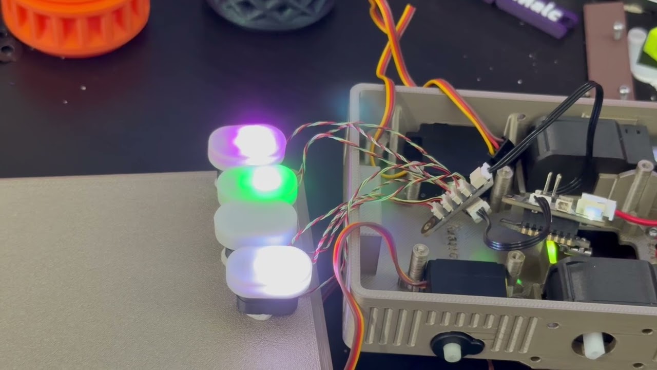

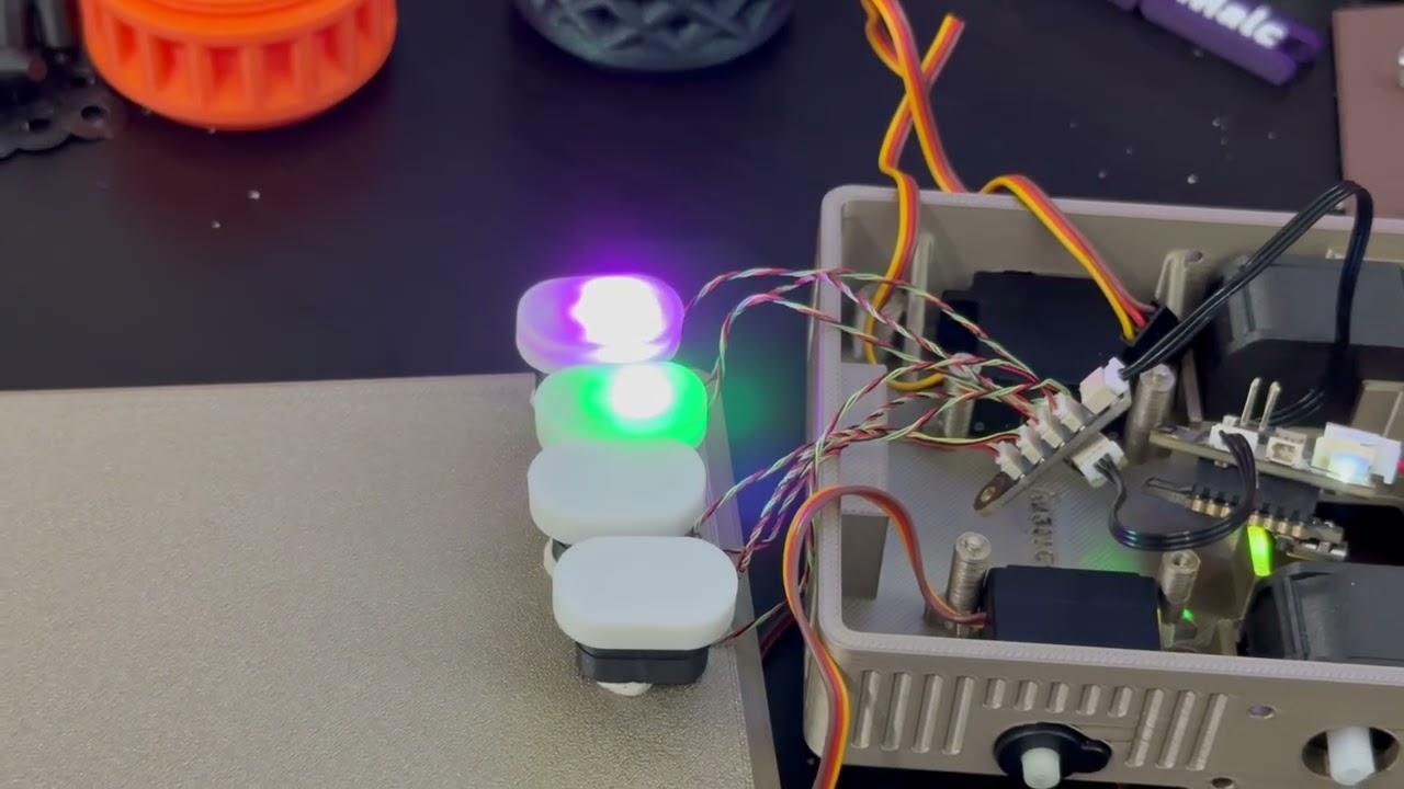

When I set some of the LEDs, they observe the colours I select; other times, they do not. Worse, they also scroll through colours I haven’t set each time I press the test button.
The test should generate four red LEDs, one in each of the housings.
However, I do not get red, I get other colours, different ones from each other. If I press the test button again, I get another set of different colours. The test that turns them all off doesn’t; one of them doesn’t illuminate.
I am used to testing things and ruling them out, here are just a few of the things I have done.
  • A reset of the board
  • A different receiver board
  • A different LED hub
  • A different LED hub cable
  • All different LEDs
  • Different LED port on the receiver

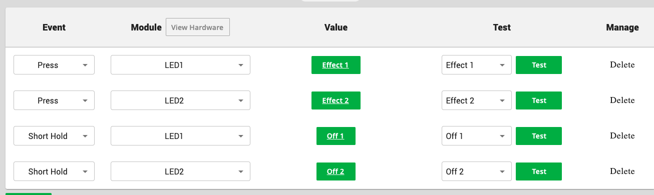

  • Using the UI
  • Using code
My test LED setup (not my final setup)
My test panel.
I have created a ticket, but as that often takes ages and they usually they me to perform tests I already have and documented to them, I thought I would also ask here.

The problem only affects the LED1 (D1).
  • If I disconnect LED2 and only use LED1 the problem occurs.
  • If I disconnect LED1 and only use LED2 it works.

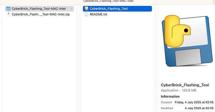

The Intel Mac version will not expand, and the suggested “if something goes wrong” assumes the zip is unzipped; it isn’t.

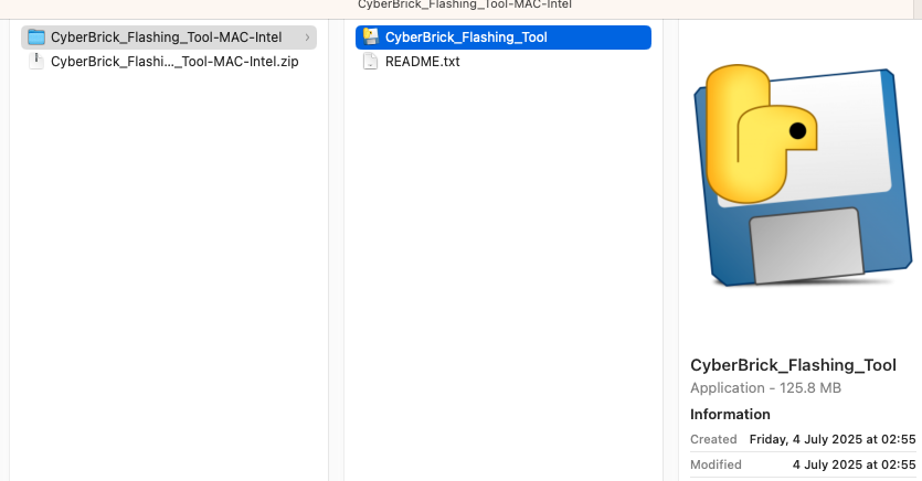

I’m on Windows atm, but was able to download and unzip CyberBrick_Flashing_Tool-MAC-Intel.zip without error, so either they have fixed it on the server, or the issue is with your download. Double check the file size of the zip, it should be approx 49.5MB (50,776KB).
It does download and unzip, but as I said, it is corrupted.
When you launch the tool, you get this error message.
They have not changed it since they originally uploaded it in July.
In their message to me, they stated they will not update it, and at some future point, they will build the flash update into the main desktop app.
There is no reason they couldn’t compress the file again and upload. Unless the tool doesn’t work or has never worked.

Ok, that is different. As you said before
both of which implied the zip file itself was corrupt.
While I’m not that conversant in things MacOS, I do know that the same error message can also come up due to MacOS security settings (Gatekeeper quarantine) … which is why there is the instruction to remove the flag that indicates the file is not local (i.e. was downloaded)… which you have to run after unzipping the file. I think another place to check might be “System Settings > Privacy & Security” (to see if it was overeager and deemed it a blocked app?)
sudo xattr -dr com.apple.quarantine CyberBrick_Flashing_Tool.app
Not trying to tell you how to suck eggs, but making sure something “simple” wasn’t missed… :crossed_fingers: … I did the same just yesterday… it said right there in the instructions to reset the module manually if it wasn’t flashing properly… naturally I didn’t do that and just repeated the same steps multiple times until I did read that! :man_facepalming:
This went long.
The first few times I tried, it failed to unzip.
Thus, the comments you refer to.
Later it did, thus the later comments.
The date/time reflects an old Zip and old contents; nothing has changed.
The SUDO command does not work now or before.
I do know what it does. I have been a developer for 35+ years and a Mac user for well over half of that. I knew what I was doing when I tried and shared technical info with them.
BL are shipping out new versions of the hardware to me after telling me they have no interest in fixing the problem with the application. They say they no longer support them and have no interest in testing, re-zipping, or anything else.

For my needs, I wanted to drive 8 LEDs with three colours, which is impossible without code, as you cannot set a single hub to show more than one colour at the same time in the UI.
My model lets users turn on the main lights (white for the front and red for the back) while also having indicators that work left and right.
It is impossible to achieve using the UI.
