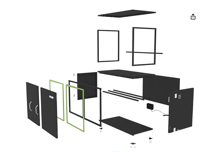

I am building a cabinet that will hold 24 filament rolls. I want to hook up a dehumidifier to the cabinet. Has anyone done anything similar, and what dehumidifier did you use? How did you hook it up?

I think what I want is a solid state dehumidifier… I am going to take a closer look at the back of cabinet tomorrow. The de humidifier is riveted in place, the only thing to identify it is “DRY BOX” printed on the inside the shell.
Ok… it’s bugging me so I checked it out sooner.
There is a vent on the back… I have it set to 25% humidity and the temp shows 20C, but that could be the air temp…
Looking at similar cabinets, I think its self-regenerating desiccant, basically it heats up the desiccant and vents the moisture out the back. (no drainage tube)

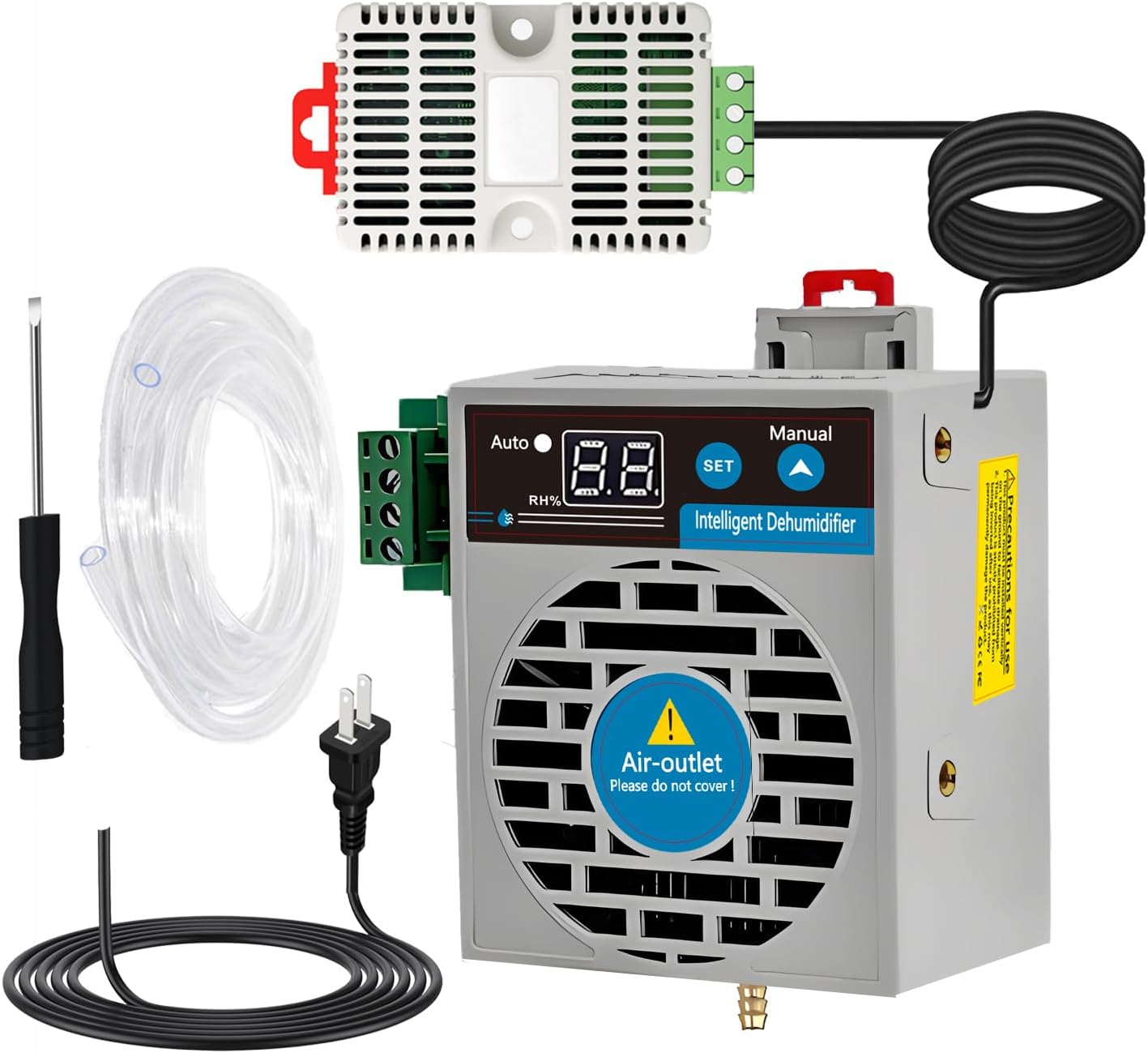

This is what I bought.
I got it installed and it has been running for 4-5 days now. It has lowered the humidity by about 9-10% in that time, but I can’t get it to go lower than about 29%. I was hoping to get it down to 20%. I have it set to go on at +26% and off again at 20%. So far it’s never turned off.

I have caulked every seam with silicone. I have a gasket around the door, and the windows are also caulked. I have latches that hold the door tightly closed. I don’t know what else I could do to seal it.
Two weird phenomenons: 1) there has never been even a drop of water come out of the drain hose; 2) sometimes when I open the door, the humidity will go DOWN a few percentage points, say from 33% to 31%. The humidity in the room is around 40%.

if the water is not coming out, it is staying in. It is a numbers game. Maybe the water is condensed on the wall and not in the air that is measured. lower number.
In short the water tends to equilibrium. But when you heat the air in the cabinet, it condenses on the cooler walls. Lowering the humidity, but once the condensed water evaporates the back to starting humidity.
So it is imperative to release the water somehow.

I’m still frustrated with my dehumidification cabinet. I bought two of these units Amazon.com - Grow Tent Dehumidifier, Smart Temp and Humidity Controller with External Heating or Cooling Interface, Auto Dehumidification Kit for Safes/Cabinets/Electric Box/Closets, AC/DC 85-265V, Auto Shut Off and installed them in my cabinet. They are sort of ok at the best. The LED displays often say that the humidity is 10% when my independent hygrometers show 25%+. Not a drop of water has ever drained out of either unit, but it HAS lowered the humidity about 10% from the room humidity. Still–very frustrating.
