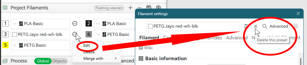

Hello,
I have some filament profiles in BL-Studio that are directly from the filament manufacturer and were read in via the filament folder of the file system.
Since I have made a few changes to them, I would like to delete the old profiles again.
But I can’t find a way to delete them.
If I delete the files from the file system, they will be syncronised from the cloud again after the next start of BL-Studio and are all available again.
How do I get rid of them?
If this is not possible, please create a feature request for it, otherwise you will accumulate a data rubbish of profiles.
Thanks in advance
Filament management, printer profile management (the one with the nozzle size) and print profile management are all difficult.
I am with you on this. A proper management page that allows deletion, copying, modification, renaming, etc. would be nice.
User presets can be deleted, but I don’t think you can delete System presets.
To delete a Filament profile you created, select the filament and then click on the edit icon on the right end of the name. To the right of the filament name in the edit window, there is a floppy icon to Save the profile, and an X which deletes the filament profile.

hello . this delete option for filament profiles is not visible on studio 2.3. Does anyone know how i can delete it
Studio 2.4.0.70
Three-dot circle next to filament, Edit, X

Update zur aktuellen Version BambuLab 2.4.0.70 - Stand 11.01.2026
Das Löschen der Presets aus der Cloud funktioniert nicht mehr wie oben beschrieben.
Dafür gibt es inzwischen eine eigene Funktion unter File → Batch Preset Management → Management user presets.
