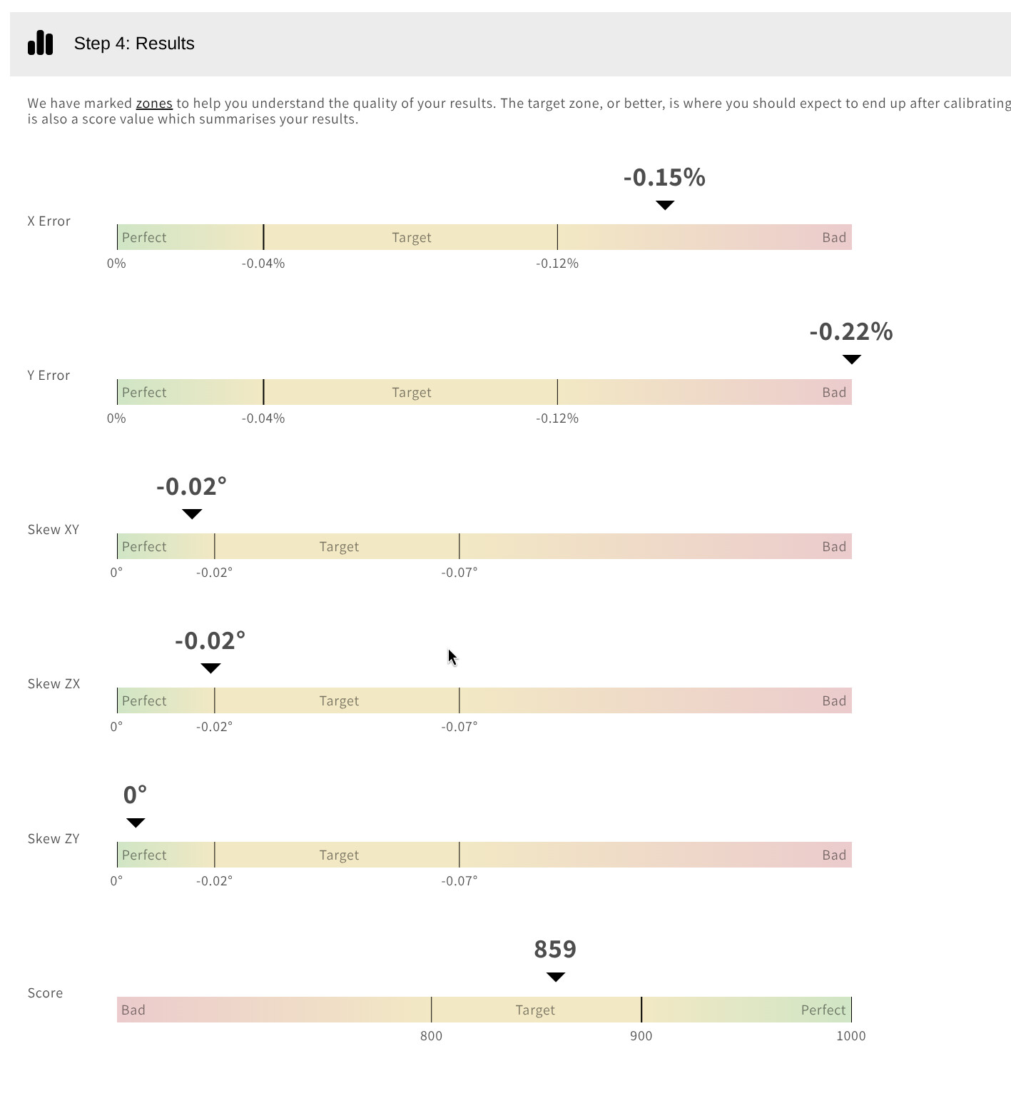

I have corrected my skew on my X1C but my X and Y error do not match very well. Could this be an e-steps issue at this point?. 100 mm calilantern. The -0.02 XY skew is not creating this either as pushing it up a lot higher doesn’t change the difference between X and Y much at all.
The part is symmetrical of course and measures inside and outside. My P1S X and Y error are matched.
Same here, we compensate X,Y and skew independently. Why there is difference in X and Y error is beyond me, but seemed relatively consistent for given material type. We just went with it.Possibly something about chamber temperature? We have simililar ratio between X and Y errors by the way. My 5 cents on the topic, good luck!
