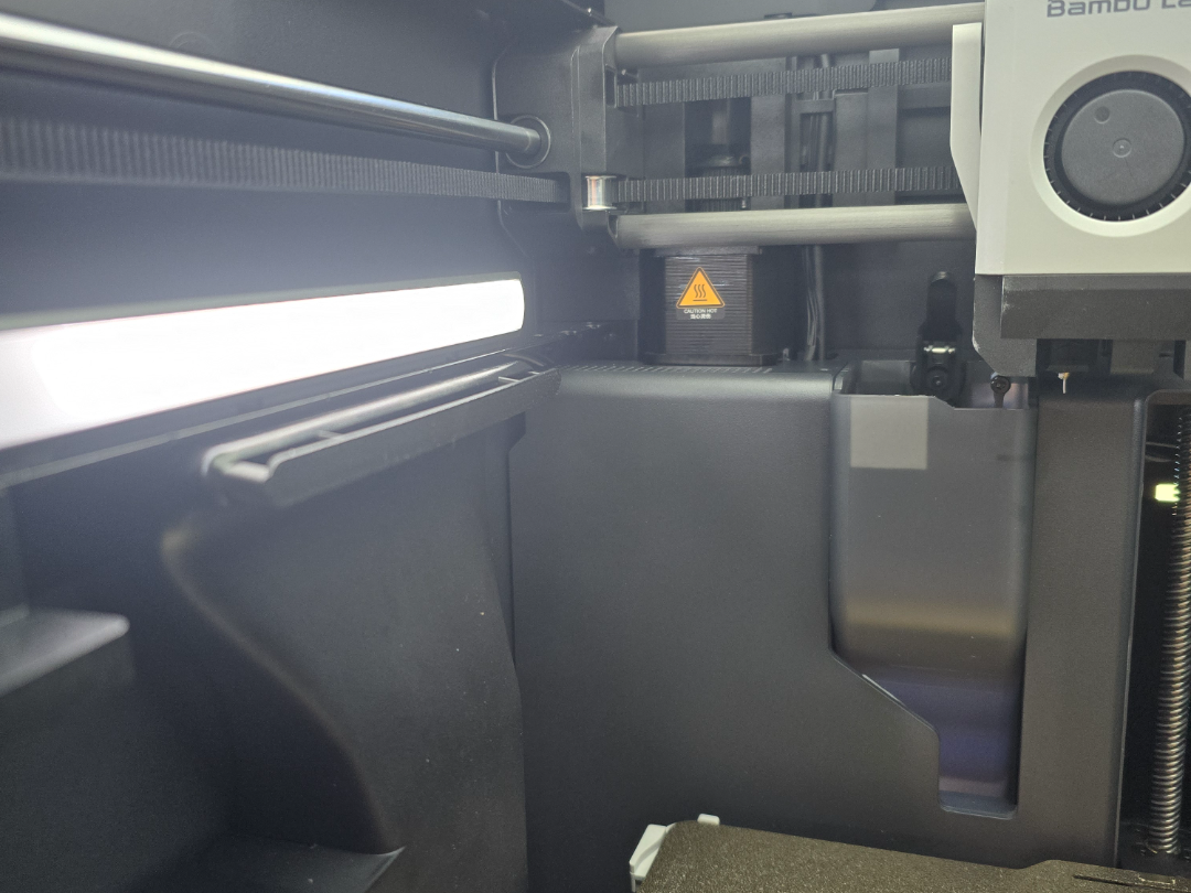

Not sure if it’s a bug, or something to do with the new intake system, but I can’t find a way to turn off the right side aux fan.
I always immediately turn it off on all printers as it causes so many issues, and adjusting the Bambu Studio settings isn’t doing the trick.
On my H2Ds, I simply set the aux fan speed to 0 within each filament profile and they don’t operate anymore. The P2S seems to be ignoring the setting completely.
I wonder if the new intake system which blows air into the chamber about half way down the right side is causing the aux fan (which shares the same intake) to also push air directly onto the print bed.
No matter what I try, the right side of my bed always has failures, and it’s due to the aux fan blowing excessive air onto it.
Any suggestions?

That is not what he was meaning , the p2s had at the middle section off the aux fan an opening which controlls the cooling or heating section which blows air at middle height to the bed.
I’m referring to both.

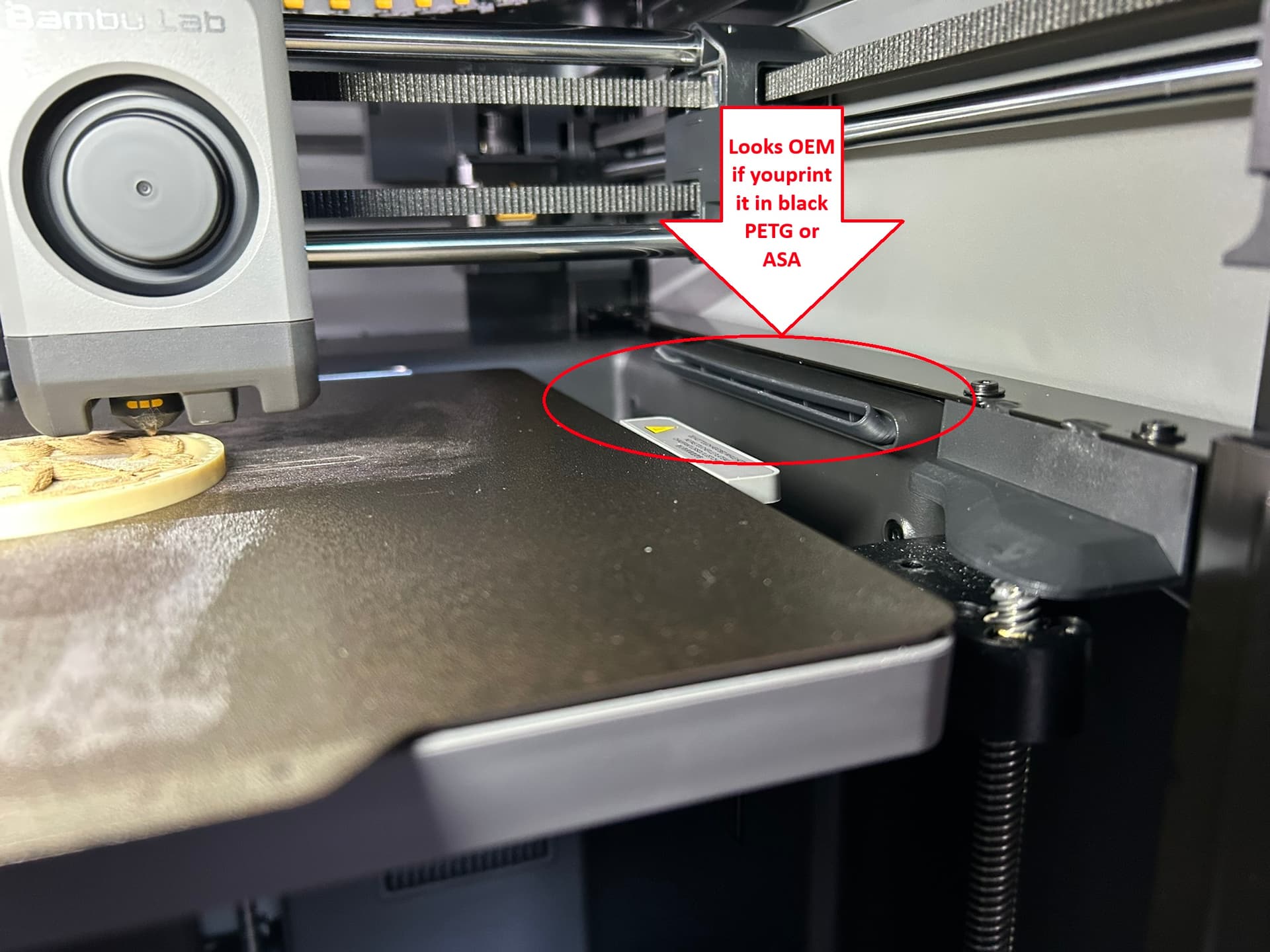

The top vertical slot seems to be creating the biggest issue and refuses to turn off. The vent is slightly different than the previous series printers but I found a deflector specifically for the P2S I will try.
The bottom rectangular vent is less of an issue only because many of my prints don’t get the plate that low, but I also found this that I will install P2S Aux Camber Fan Air Deflector | Reduce Warping by S__o MakerWorld: Download Free 3D Models
Still annoying that I can’t simply turn it off, but at least this way I can still get cool air drawn in from the outside without hitting the prints.

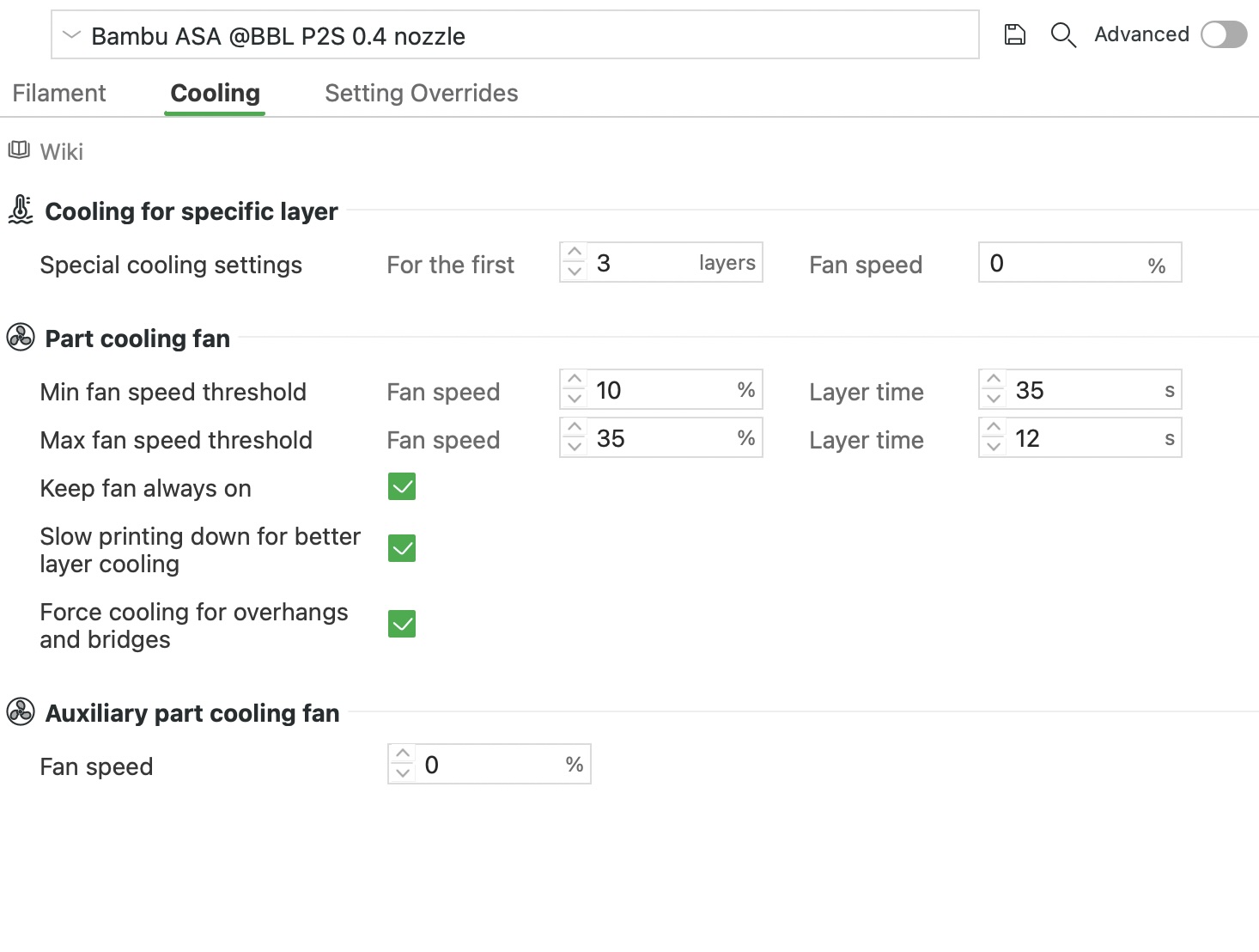

Update for anyone else interested: setting the aux fan to 0 in Bambu Studio isn’t actually zero. It seems to mean “auto”. If you set it to 10, it will stay at 10 for the whole print. At 10 you can barely feel any air being pushed out, so it’s a decent solution.

I also experienced an AUX fan problem on my P2S. I printed an ASA project (with standard Bambu Lab ASA) and according to the filament specification the AUX Fan should be 0%. But During printing the AUX Fan was running full power and I had to manually set it to 0% on the Device-Status page while printing.
@AussieGrit When you talk about “setting the fan to 0, it means auto”, which setting screen do you refer to? Is it the filament setting (as shown below) or do you refer to the Device/Status screen where you manually set the fan on/off and set the speed?
The “auxiliary part cooling fan” is what I was referring to. It’s either a bug, or 0 is intended to be some kind of automatic setting.

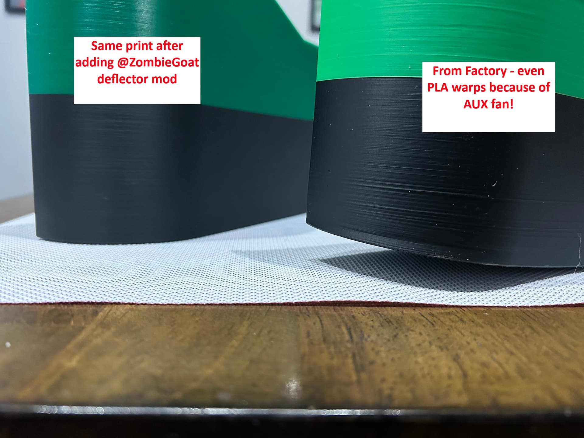

I had the same problem. I set my bed temperature for the textured PEI plate to 65 degrees and I designed an air deflector for the aux fan. It works perfectly now, but the filter issue is something that also needs to be addressed. Here’s my model if your interested. It has a 45 degree and a 90 degree deflector.
@AussieGrit Please review the post by @ZombieGoat . He designed an air deflector that points the AUX fan air up 45 degrees so it does not blow right on the build plate. Using this deflector, you do not have to turn AUX fan off and on. Instead, everything just prints great! This quick mod solved my problem!
See attached photos.
looks like a greast idea…printing it now.
