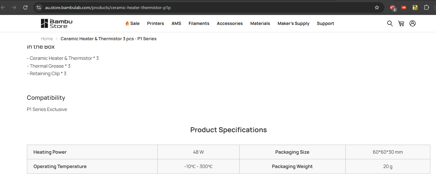

From bambu lab store

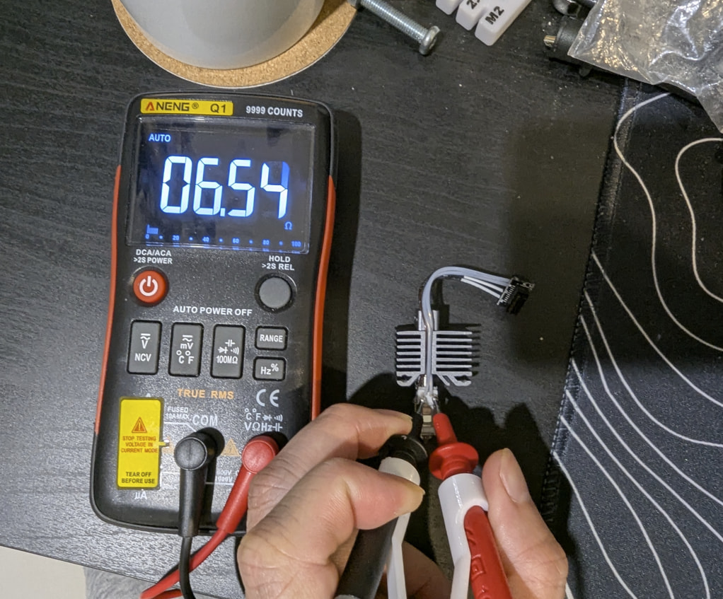

From my measurement
Theoritical max power consumption of the heater
P = V*I = V^2 / R = 24 * 24 / 6.6 = 87.27W
But since this is PTC heater, positive thermal coefficient, resistance increases as temp increases, and that roughly limits the maximum power the heater can take. I don’t have data on how thick the wire on the heater as well as the length of it, so I can only trust the number from BBL store: 48W, unless BBL lied to us and use lower wattage heater in our printers.

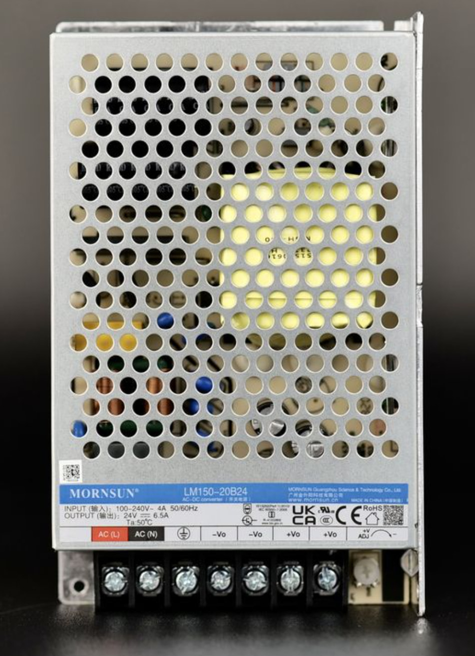

I can’t go through all the printer models right now, but to stick with the weakest model - A1-Mini for a moment: The built-in power supply: Output: 156 W at 24V - even with these specifications, there is a power buffer.
I can’t check that right now, but I’ll go with your number: That still leaves a buffer of: 48W

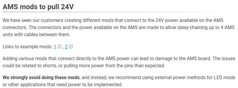

Bambu has a wiki entry about using devices like this. Follow it or don’t but they do have an opinion on them being used. :person_shrugging:
Just like every other company does, they don’t want you to modify their devices that belongs to you and that you paid for. I just took a quick look at the wiki:
  • Bambu doesn’t want you to use cardboard spools.
  • Bambu doesn’t want you to use nozzles or print plates from third-party manufacturers.
  • Oh, I could list everything here, but basically, the short version is: Only use Bambu parts.
That’s understandable - they want to protect themselves legally.
It’s similar to the debate surrounding the right to repair. But here’s the irony: Bambu almost always wants you to repair your own devices, like replacing the power board, even though many of the steps require the expertise of an electronics technician and should legally be performed by a professional rather than the customer. They even state this in the small print.
We’re talking about 24 volts here - this project. Bambu wants you to tinker with the 230V circuit. In many countries, it is even illegal to tinker at 230V by law - if you haven’t been trained for the job.
As you said earlier, whether or not to modify your device is a decision that everyone has to make for themselves. :+1:
Getting back to the model: Anyone who modifies their devices or cables does so at their own risk. Based purely on the technical figures, there are no concerns. Does anyone have the technical skills for that? Well, that’s another question, but there are even more complex modifications on MakerWorld.
