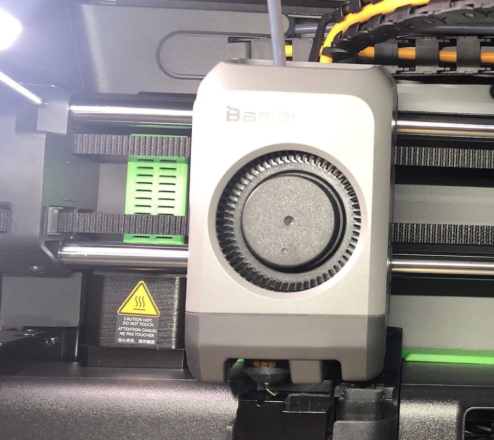

  2. grille for the stepper motors recess
I’ve attached maker world images showing the parts in question (the stepper motor grille is bright green)
What’s the general opinion on those plugs, are they good? Are they bad?

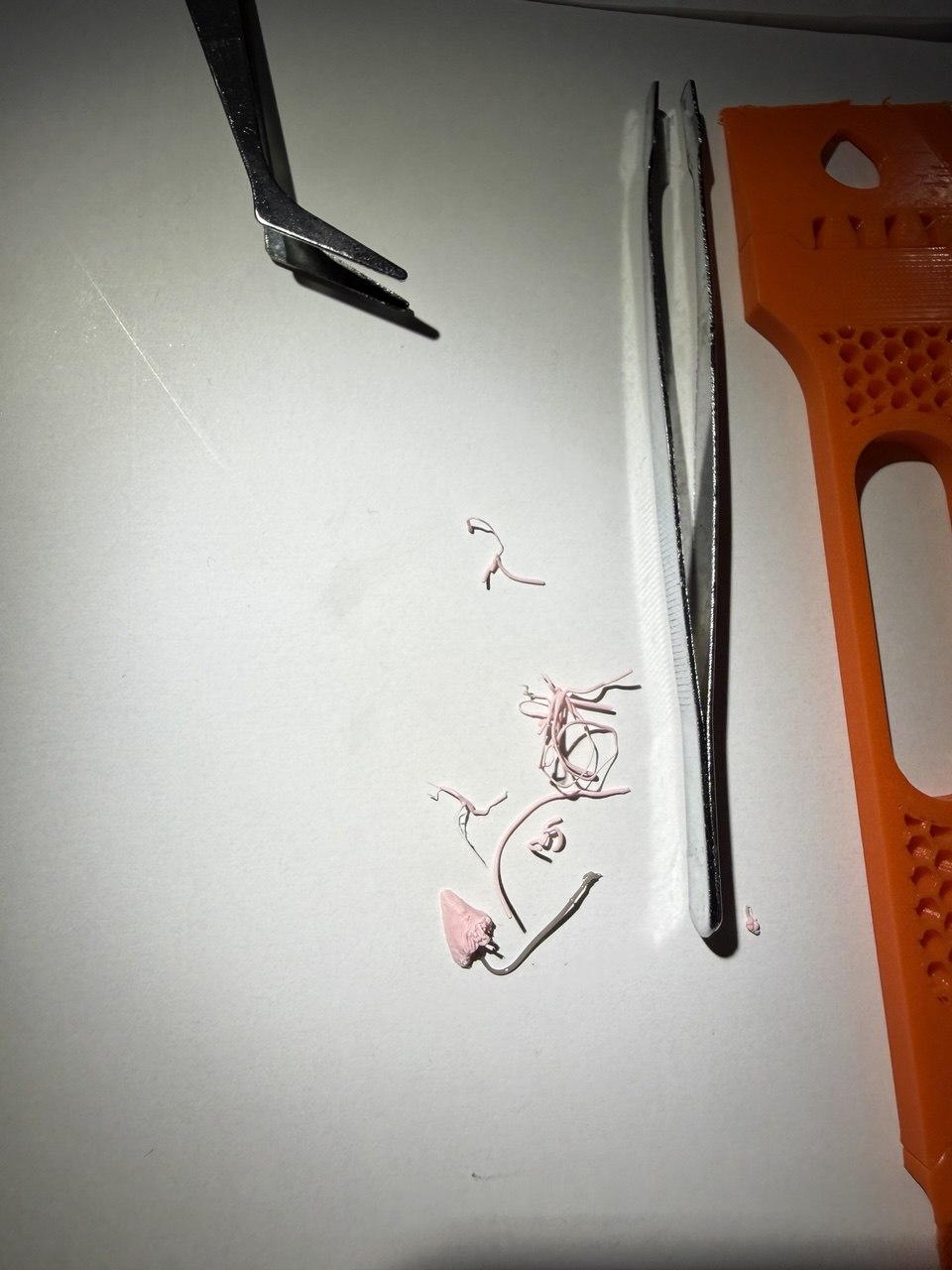

Okay, I guess I will be sort of answering my own question to an extent, but maybe it will help someone in future. Despite my nickname, I removed the AMS and top glass to get to that recess near the poop chute.
It all turned out a bit more simple than I expected.
First off, there was quite some filament inside, for just 100 hours of printing. This is what I managed to pull from out there.
Funny how most of the filament that got stuck is the pink PLA and almost nothing else despite that I went through about 600 grams of PLA, but about 1500 grams of PETG (mostly grey, also blue and orange).

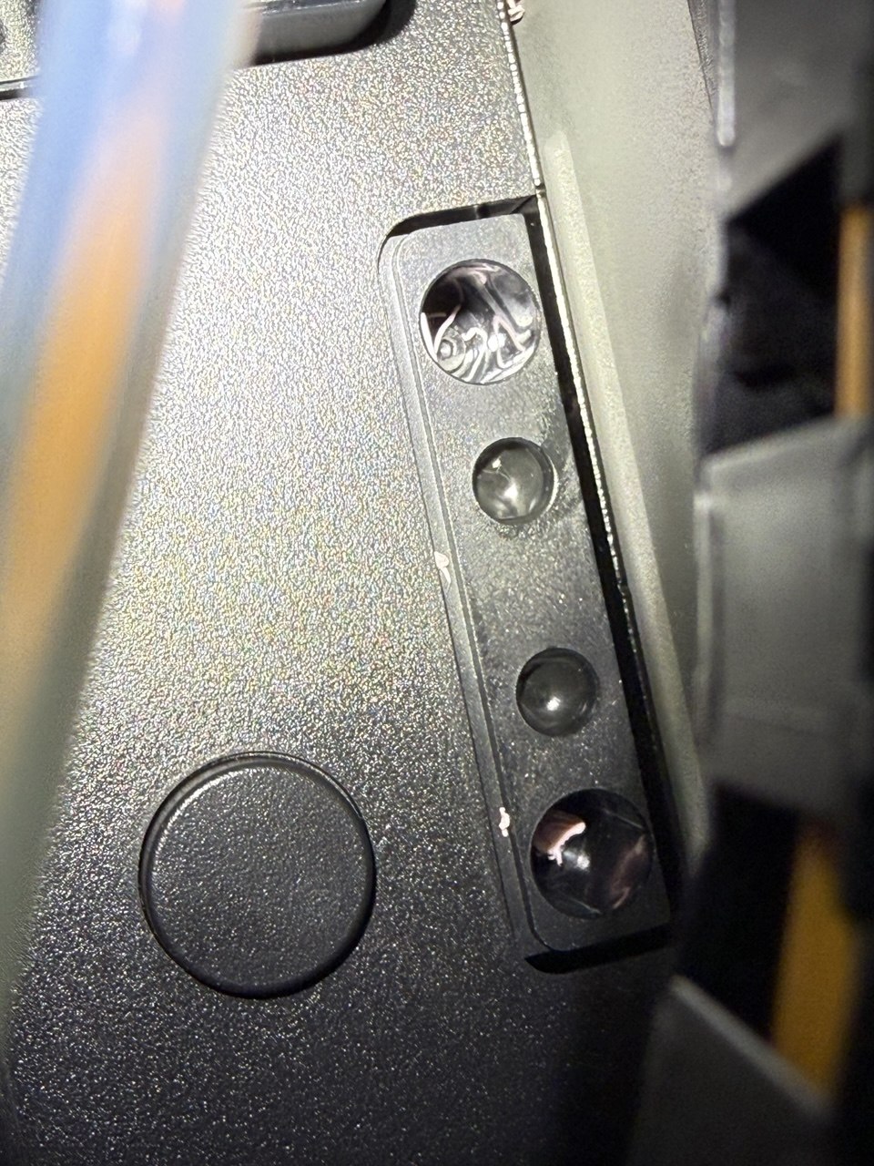

At the same time, I was able to peek inside the holes… and to my surprise, inside is a dead end with bolts that seem to be there for the sake of having something mounted from the other side of the panel. So what we have is:
  1. There’s no point in covering the holes as there is nowhere for the filament to go. However, the thin flat gap between the part in question and rear panel allows filament to drop to the Z-axis lead screw.
  2. A cover for that particular spot is unlikely to mess with cooling as there are no holes, and below that horizontal panel is a huge opening for the Z-axis anyway.
Thanks! I assume some of the stepper motors covers touch the belts as the space is pretty tight there on the sides. Definitely don’t want to interfere the with the mechanisms with those “add-ons”.
