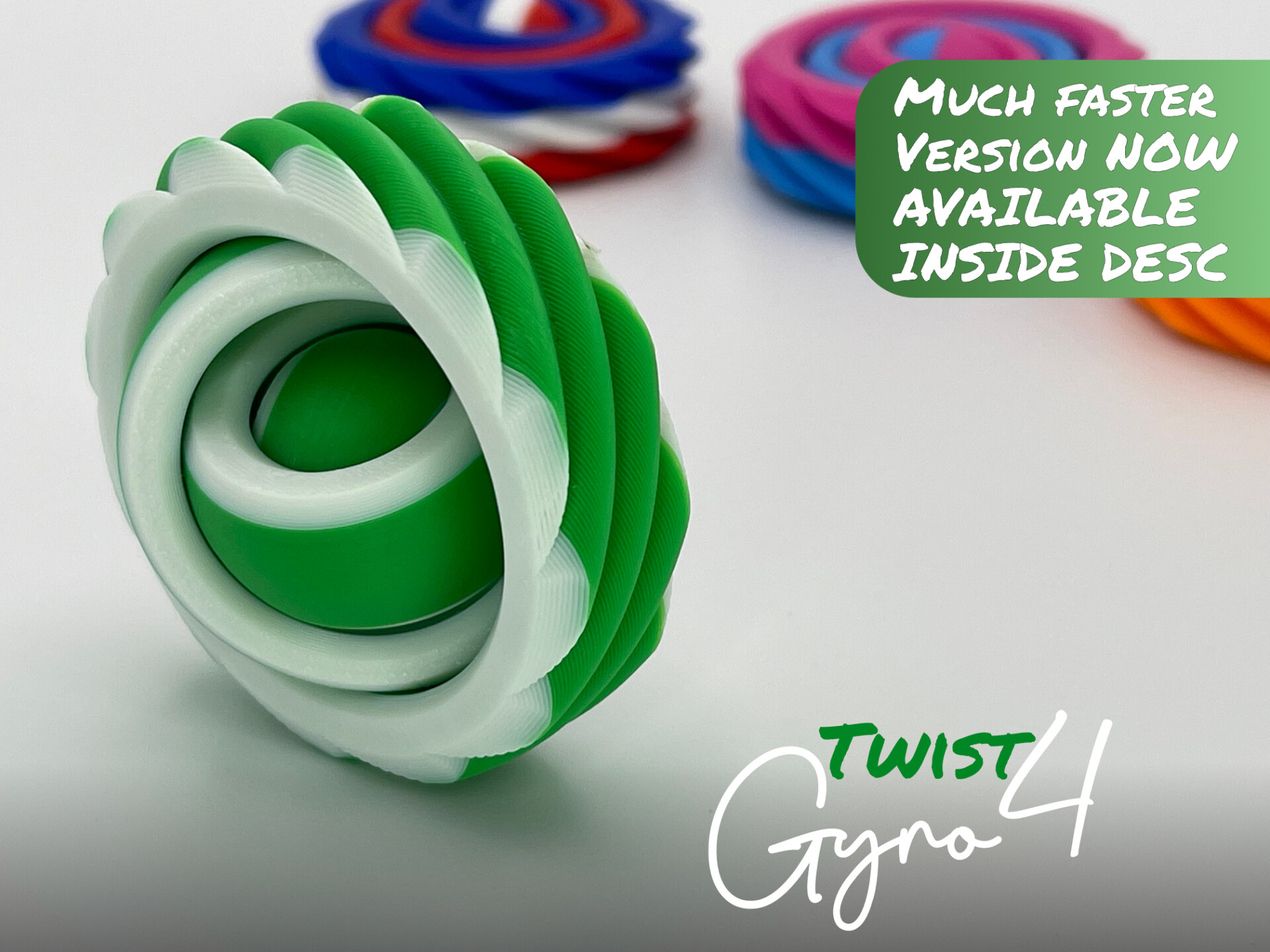

I know one designer who rarely uses prime towers even when 4+ colours are used in the same layer. It is possible, it just takes experience and lots of testing.
One of my more popular models:
It has many profiles, all using more than one colour; each layer has only one colour before a new one is introduced. I do this in part so those without an AMS can also enjoy the styles I produce.
This more recent one has a special profile version that disables the prime tower and yet prints without issues despite changing filaments 22 times. This was despite having two very different, contrasting colours. You will observe no bleed between the two colours in the photos and no artefacts. Infill wasn’t used for the other colour during swaps either.
It can be done, it is being done by more than just me.

It has everything to do with the surface area of the layer. even if the entire layer is a “single clean layer” with one color. That’s a fact. there is no way around this.
Everyone else in this thread agrees. Why can’t you just admit you are wrong and move on? instead you say I’m attacking you
The models you posted have a large layer surface area so of course they will print fine. You have yet to prove me wrong, and are trying to spread bad info.
The key factor in determining if a prime tower is needed is the layer’s surface area. End of discussion.

Expect the second one doesn’t, it has less coverage than the shark model you showed with teeth. The purple sections start and stop, and are tiny in comparison. The purple areas that swap with white have barely any filament; there is no large surface area that you speak of.
