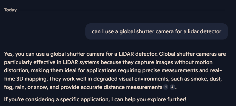

Assuming it’s a “global shutter” sensor, the emitter is pulsed and an exposure is made around the “expected” reflection time. The distances being measured are small. It might be that the intensity of each pixel in the camera image’s correlates to differences in distance.

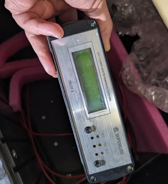

As to whether it could be done with “any old light source”, that isn’t true. That would make it impossible to detect the interference. Because lasers are cheap and work well, of course you’d just use a laser. It is possible to use incoherent sources, in fact I have one on my bench that would work, it’s called a SLD. It has the unusual optical property of having a short coherence length that make it desirable for this sort of application. We used them for making a type of measurement related to a Schlieren but simpler, called a shadowgraph. Anyway, their controller is about the size of a brick and they costs a couple kilobucks, I guarantee you there isn’t one in a X1. They’d just use a laser.

Unfortunately global shutter cameras don’t have this kind of extreme shutter speed, you’d need picoseconds. Frame times for the sort of consumer camera in an X1 are measured in milliseconds.
Here’s a picture of the SLD controller. Not going to fit in an X1.

But wait… I asked AI.
