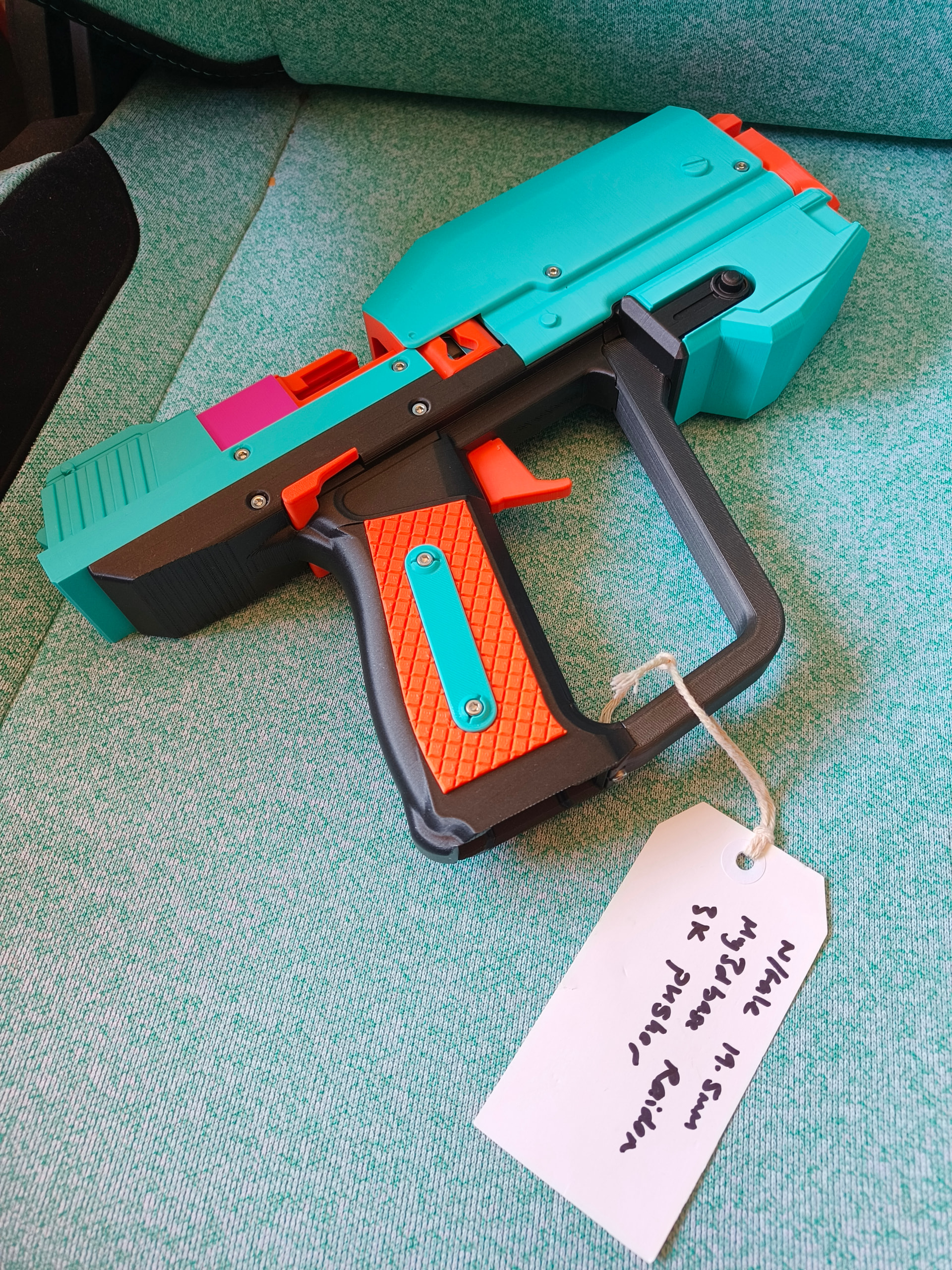

People tell me my prints are good and ask whch printer was it, and I don’t do all that stuff. All I do is use Bambu RFID tag and turn on all the automatic stuff the H2 series has. Takes a few minutes to start a print but that’s OK. This being said, I do have a vision encoder plate.
For precision engineering prints you might need to calibrate for dimensional accuracy.
(This thing looks OK and slings Nerf darts with reasonable accuracy, meaning the dimensions were accurate)
edit Yes 3K Pusher LOL. It was hilarious at the time, but 3K darts per minute is too fast for a 10-dart magazine. Not sure what the real rate of fire is, but mag empties in under 1/3 of a second. I need to “downgrade” that pusher motor but not only can I not be bothered, but it is hilarious.#
edit The model is a paid file by Fowler Concepts on blasterdownloads dot com. I believe it’s from halo video game.
