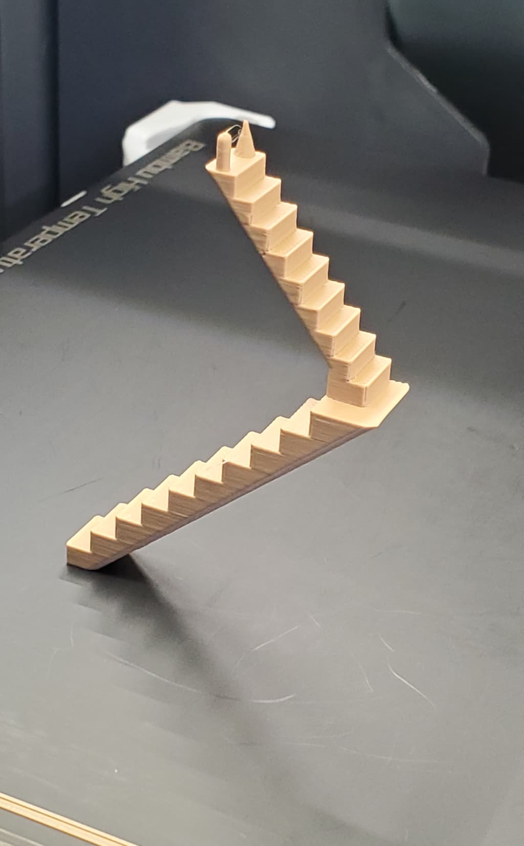

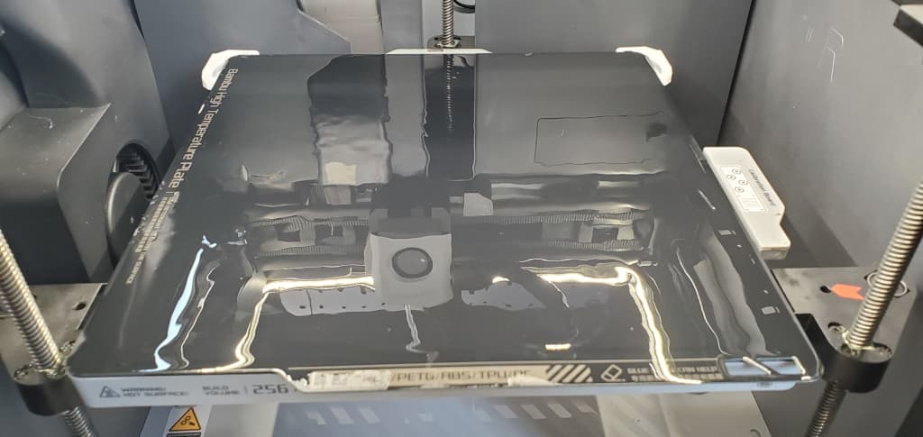

My initial thought was that this has some pretty dire implications for my build plates. I only use water and Dawn to clean my plates, but I always use a solution of 91% IPA and glue on all of my plates. It is like a thin syrup, sprayed on in a thick layer and then allowed to evaporate, leaving a thin, even, glue layer. Plates often go back on the bed wet, and I heat the bed to speed up evaporation. So they are frequently exposed to a lot of alcohol.
Adhesion is still very good, but maybe that is just the glue working?
So I washed my most used plate, High Temp (smooth) PEI. I printed a 185x185x0.20mm PLA single layer “cube” on the bare naked plate. Adhesion was 100% over the entire layer. Then I printed a model that put a little more stress on the first layer.
There were no problems with the print and it required a moderate amount of force to pull it off the plate after it had cooled to room temperature. The plate is about 18 months old and the alcohol has not prevented good adherence without glue.
Maybe that is because I’m not actually scrubbing and polishing the plate while it is covered in IPA - it just evaporates. Or maybe the degradation caused by IPA is mostly theoretical, and not a practical consideration.
