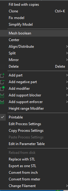

Nice work, but just a tiny correction in your ritual there.
“Change type” is already available in the right-clicked menu in the objects tab. No need to change filament first. It’s even there in your screenshot
I don’t know if anything changed in an update that the OP didn’t get to respond to yet, but you can also see in your screenshot that “edit text” is available.
