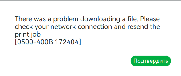

Yesterday, the ability to send print jobs from Bambu Handy, Bambu Studio, and LAN mode stopped working on two of my A1’s. The process stops at the download stage, and then error 0500-400B appears. Decoding the error does not lead to anything. I tried another router, tried a mobile hotspot, another SD card, tried downgrade. Nothing helps, but I’ll point out that this issue is on both printers. So it’s not about the sd card, for example. I can send a file from Bambo Studio to the sd card itself and select a file on the printer and start printing, I can see through the camera, I can control the printer, but I can’t print directly from either Bambu Studio or Bambu Handy, so as not to approach the printer

There was a problem downloading a file. Please check your network connection and resend the print job.[0500-400B 095505]

Looks like russian Megafon and Mts can’t resolve host for Bambu storage services. Everything is working except starting printing. Printing from slicer works only in lan mode

I was able to solve the problem. I am in Russia and use 4G for access, we can with the operator Yota. Blocking occurs at the level of mobile network operators. I installed a VPN on my Router and sent traffic to printers through the VPN. Everything worked.

I think it stopped working when I changed routers. And I suspect the issue is MTU settings. When I was setting up my modem and router, I could ping sites, but couldn’t load any pages. Seems the culprit was MTU setting for my cellular provider needed an MTU of 1420. It seems possible that larger files, like gcode or firmware has too many fragmentations or something that causes it to think it works for a little while, then fails.

Then today I tried connecting my a1 to my phone hotspot and that somehow worked! Handy app was able to send a print and file downloaded in a second on my poor cellular connection. So that tells me it’s the router or modem setup.
I’m curious if yall try lowering MTU. In an OpenWRT Router, it’s in Network → Interfaces → WAN → Edit → Advanced Settings → MTU
You can use ping to find the lowest MTU that will work for your setup. Use this command in command prompt and then lower the last number until it works.
