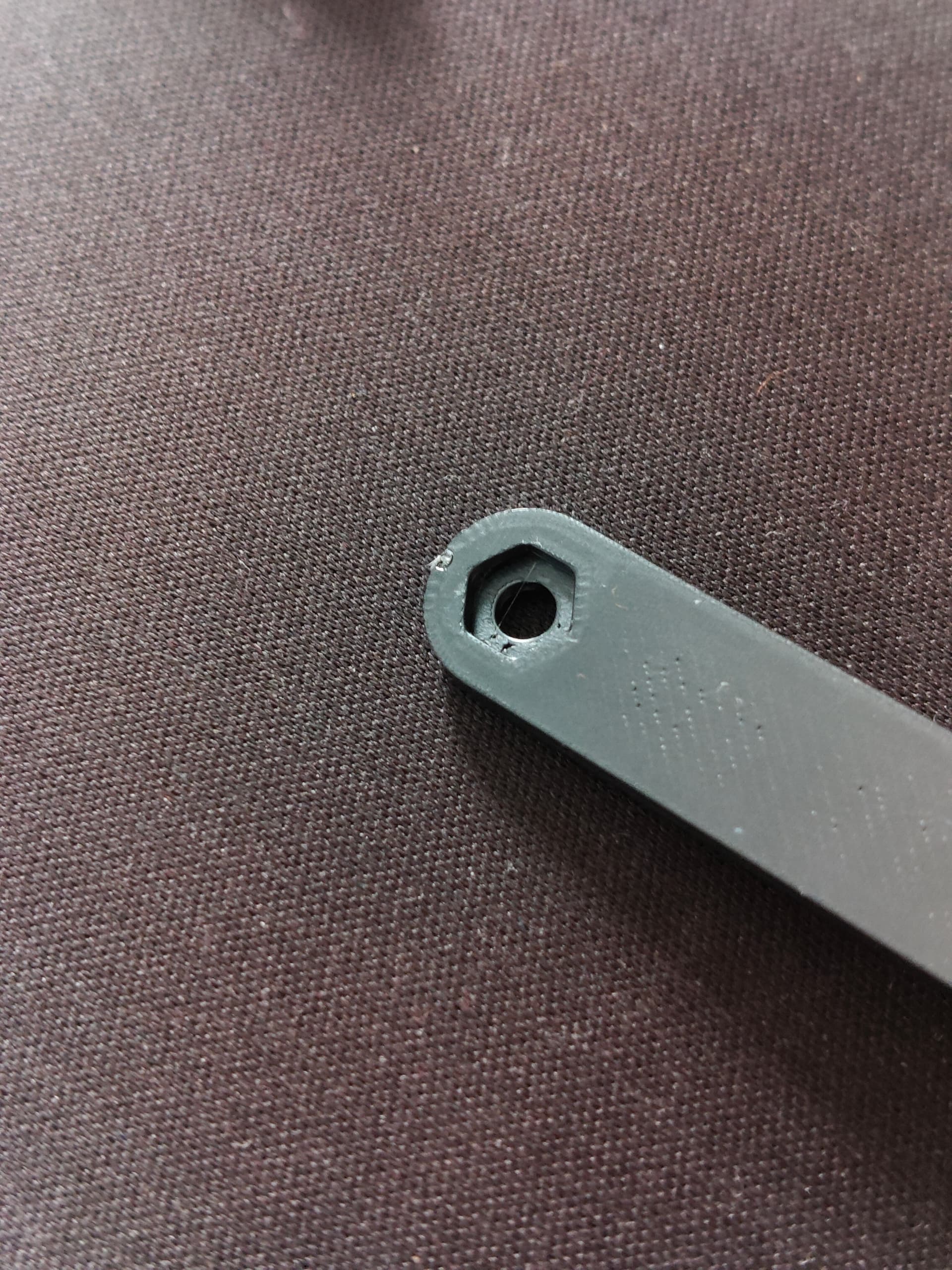

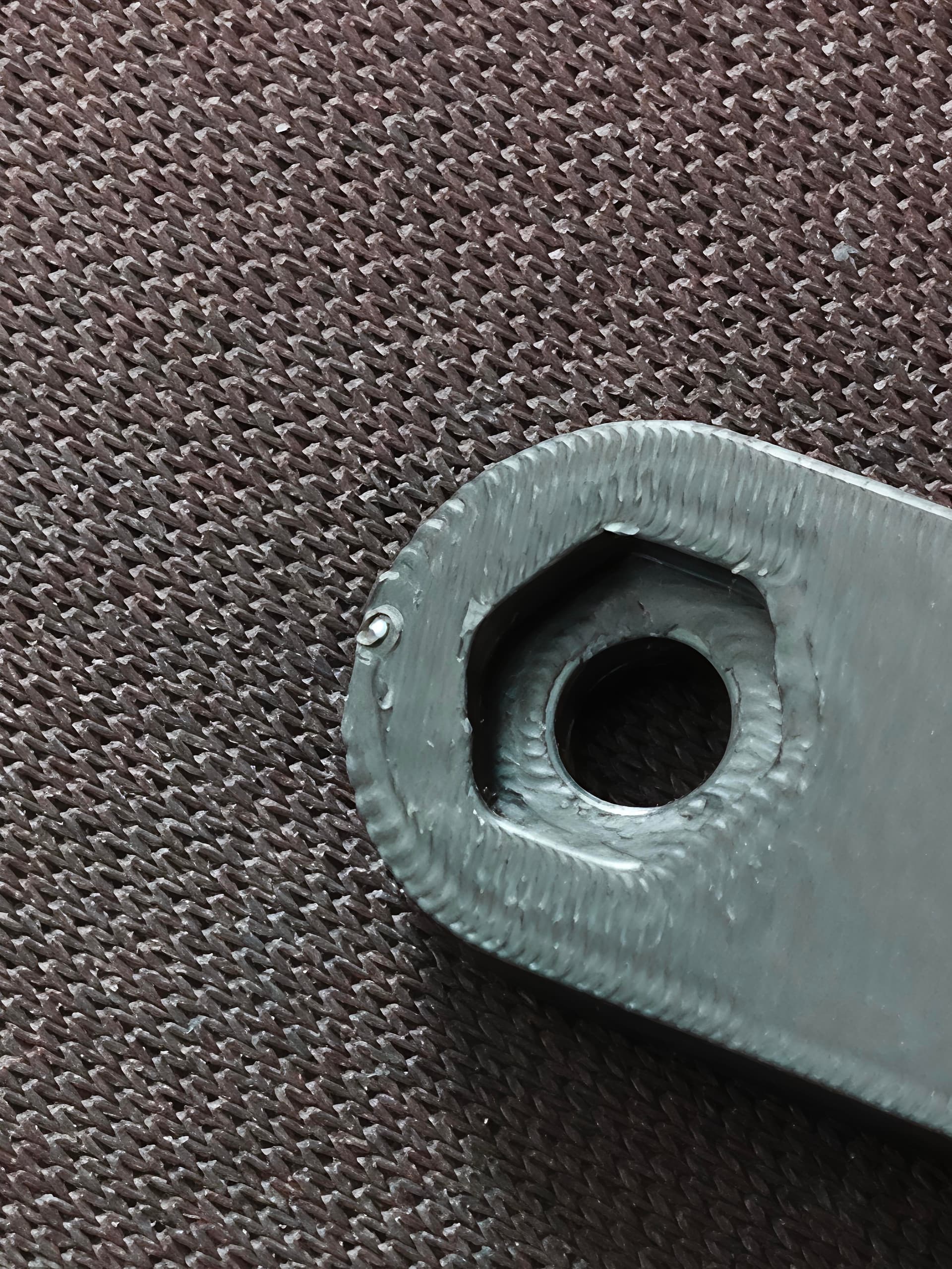

Extruder Pauses at End of Print and Leaves Artifact

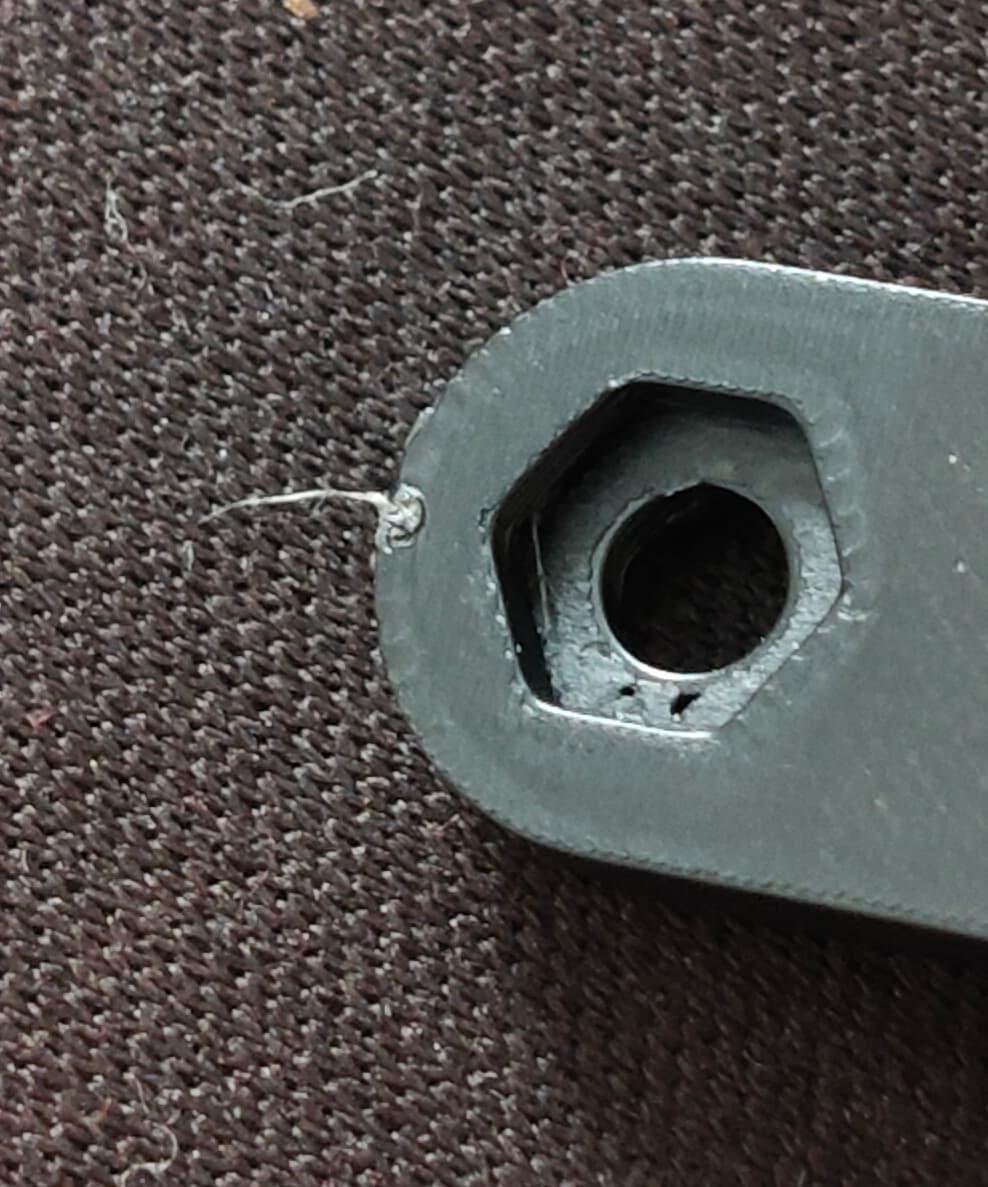

I’m experiencing an issue with my P2S printer where, after the model finishes printing, the extruder stays at the last printed position for about 1–2 seconds. Because of this pause, it leaves artifact on the finished model.
Has anyone else encountered this issue?
If so, I’d appreciate any insights into what might be causing it or how to fix it.
Thanks!

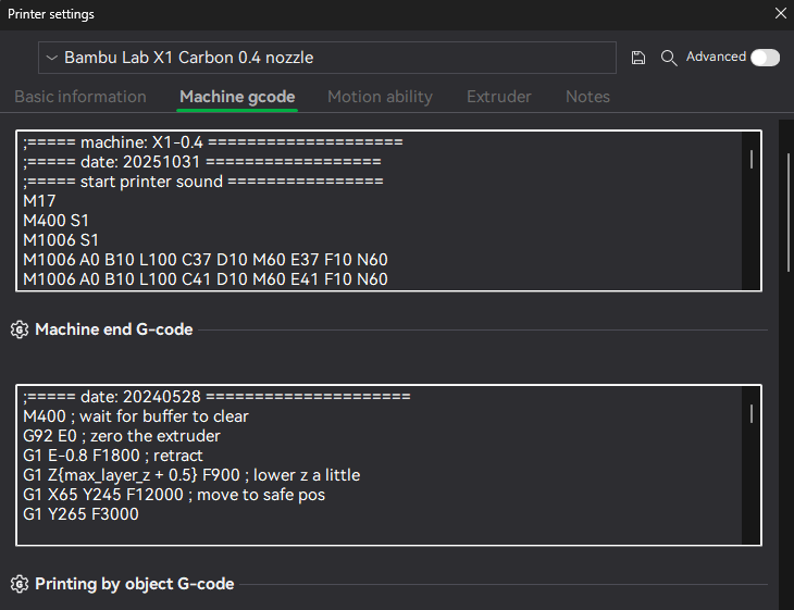

What program are you using to slice models for your printer. If you are using Bambu Studio are you able to post the “Machine end G-code” in the Printer settings?
Below is an an example of where you would find this (image of the X1C instead of the P2S but it is in the same location)

I have the same happening on my machine. Stock P2S machine gcode. No usb drive, no timelapse, all AI detections turned off.
My workaround has been to add a square and make it as tiny as possible so it still prints, then i put it last in the printing order (Per object printing required). It’s like 1 layer, 3x3mm. Printed in not even one second and since it’s the last model it gets that blob/artefact.
Probably worth creating a ticket as it seems there might be a bug in the firmware.
Thank you or reporting this problem.
For everyone who is experiencing this problem - Please open a ticket and share details about the issue including pictures and the printer log.
Our dev team will be able to quickly troubleshoot the issue and patch it ASAP.

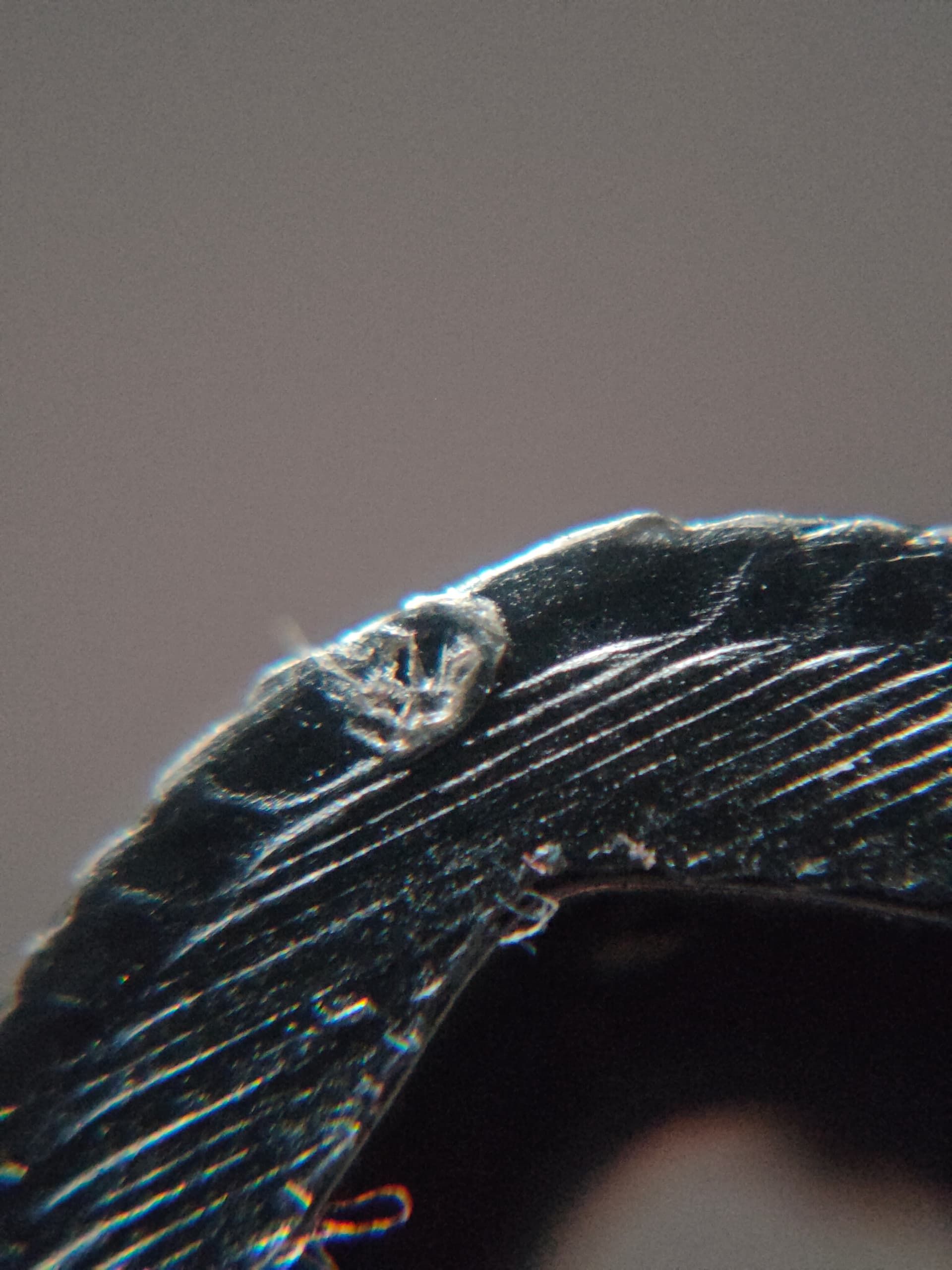

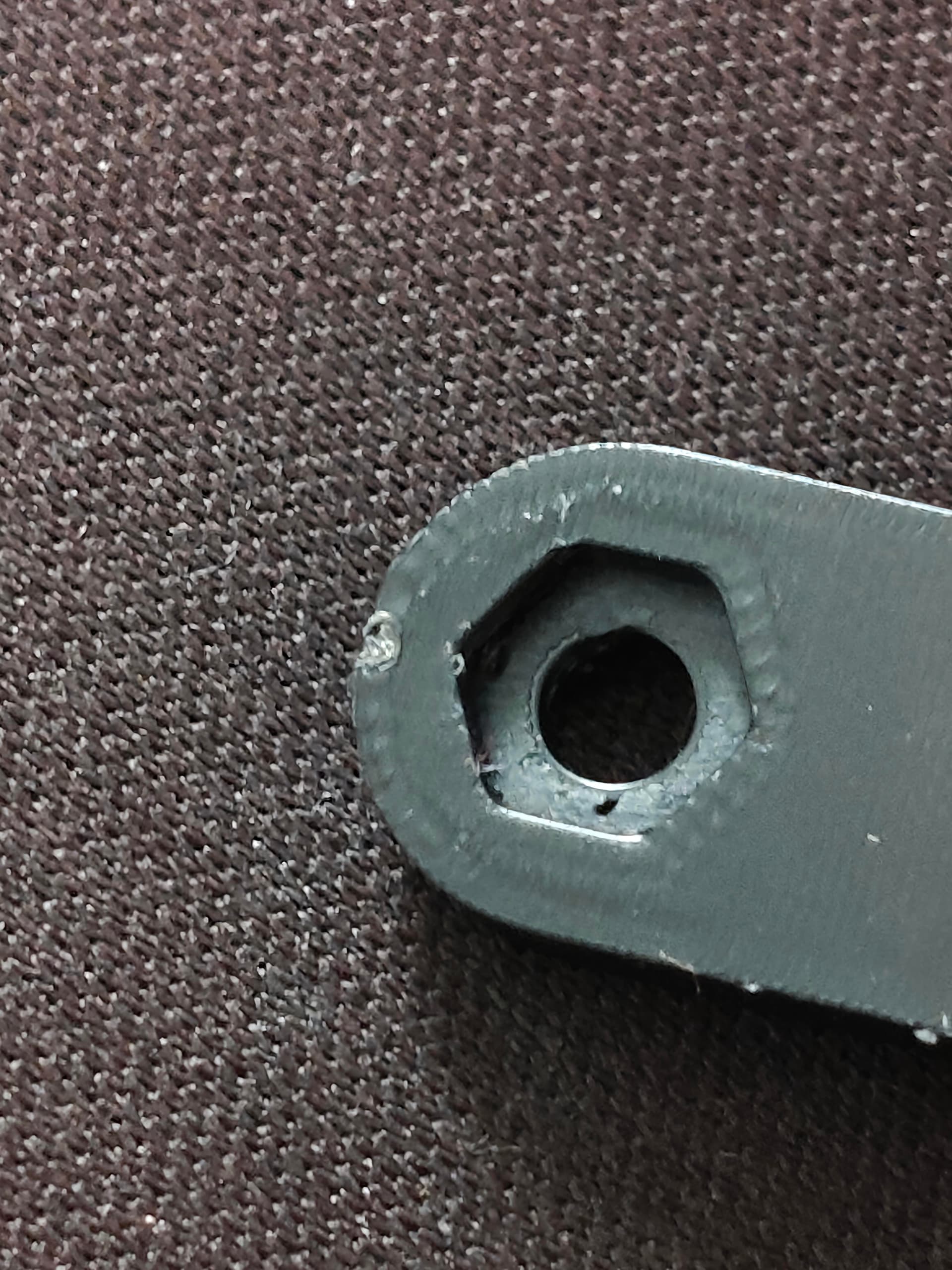

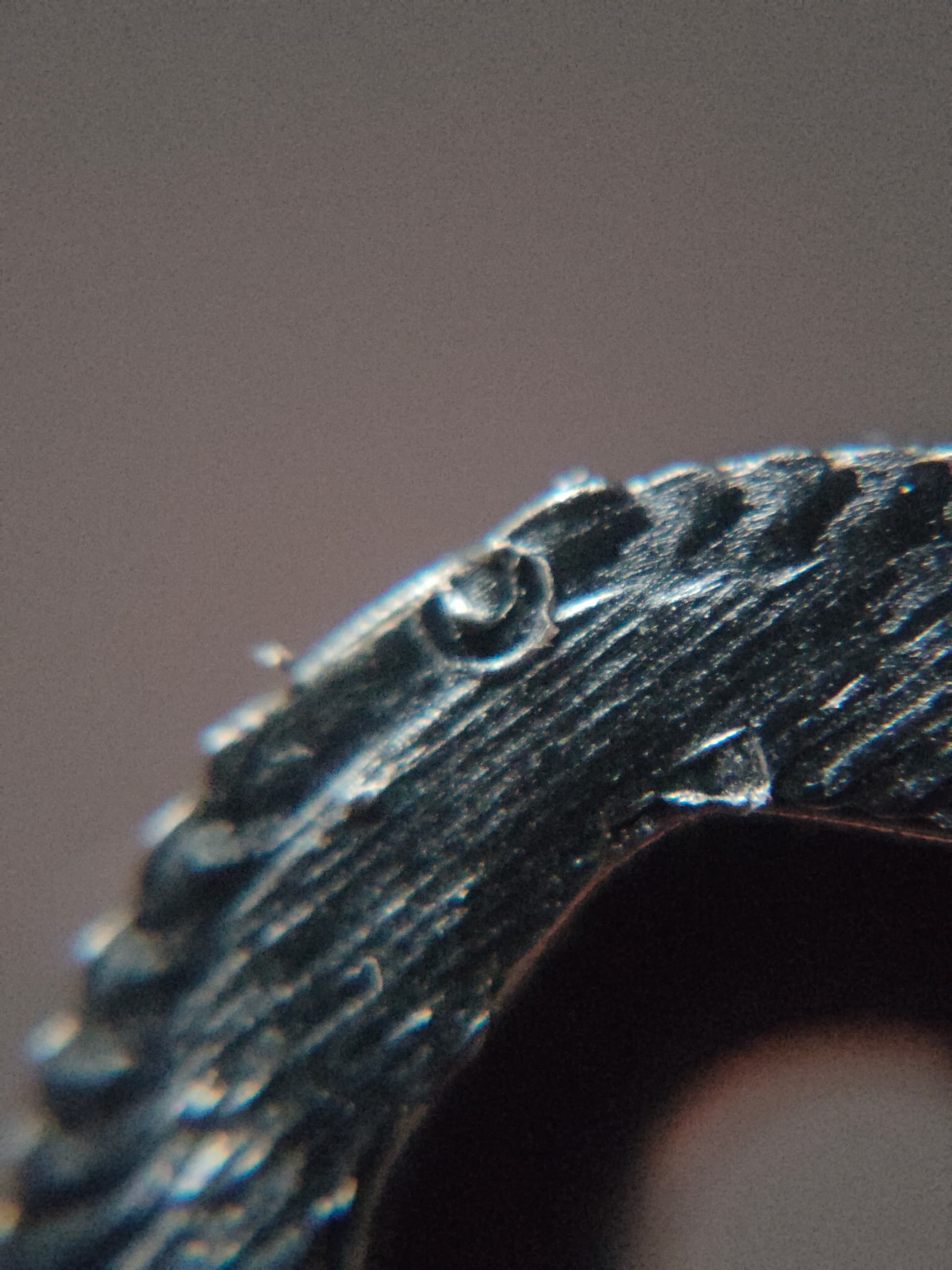

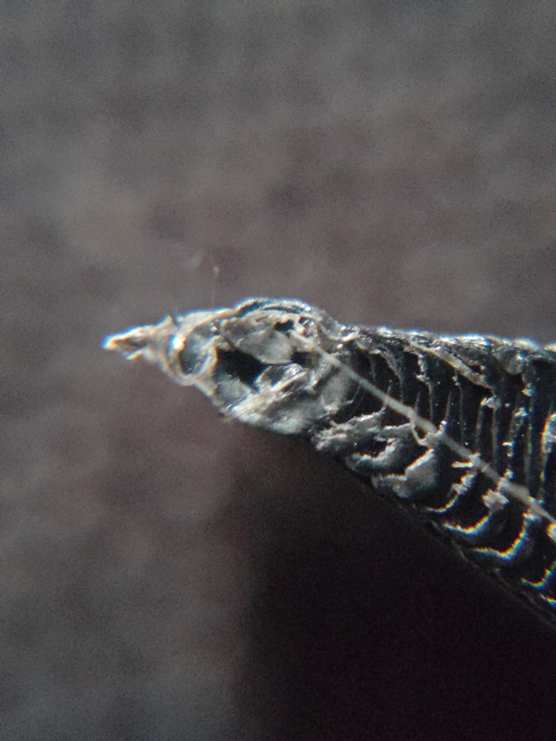

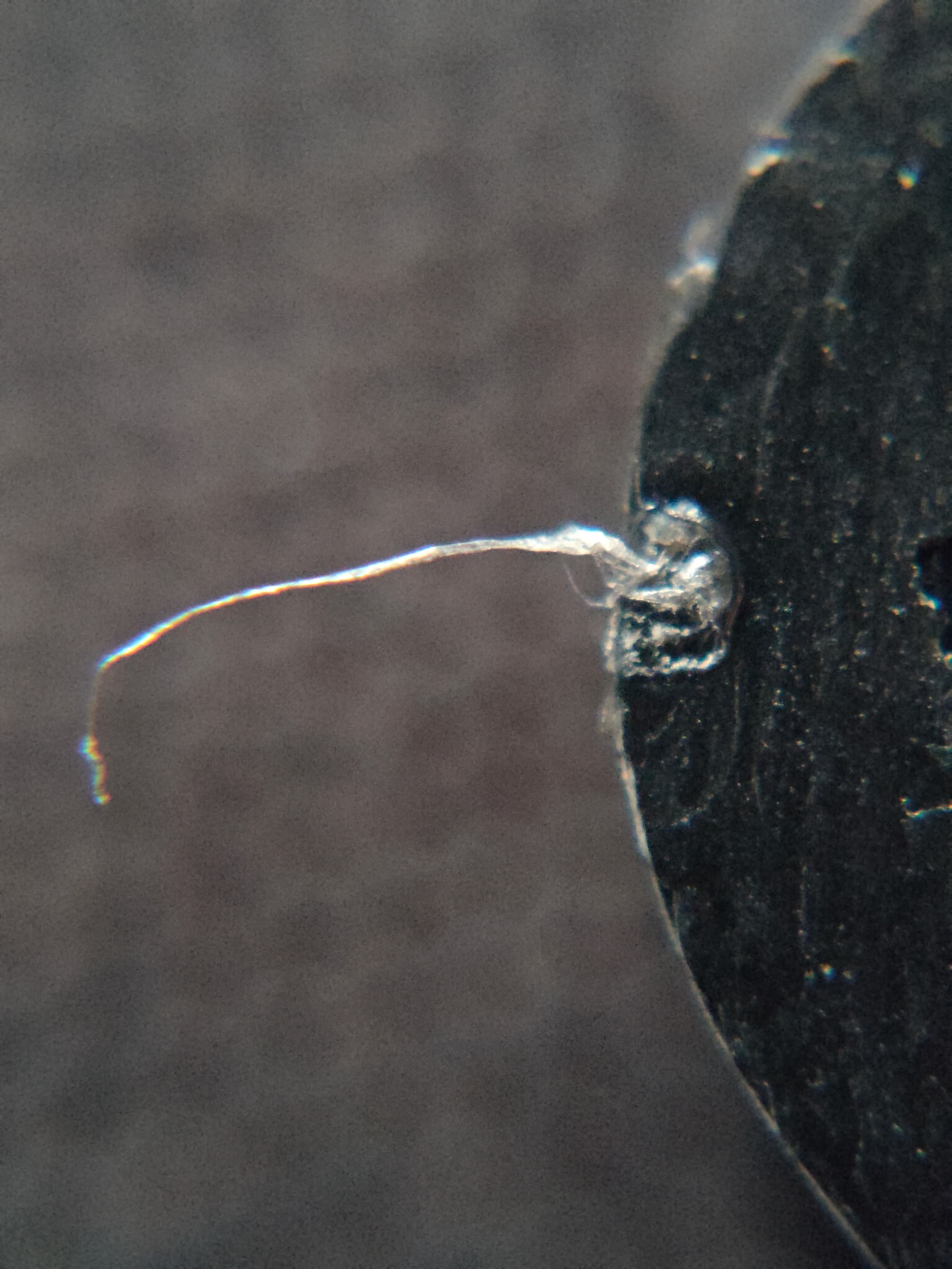

Those are unfortunately the only parts i had on hand with those marks.
Not sure how similar the ones are for @John_The_Mesh
Yep, almost the same view :+1:

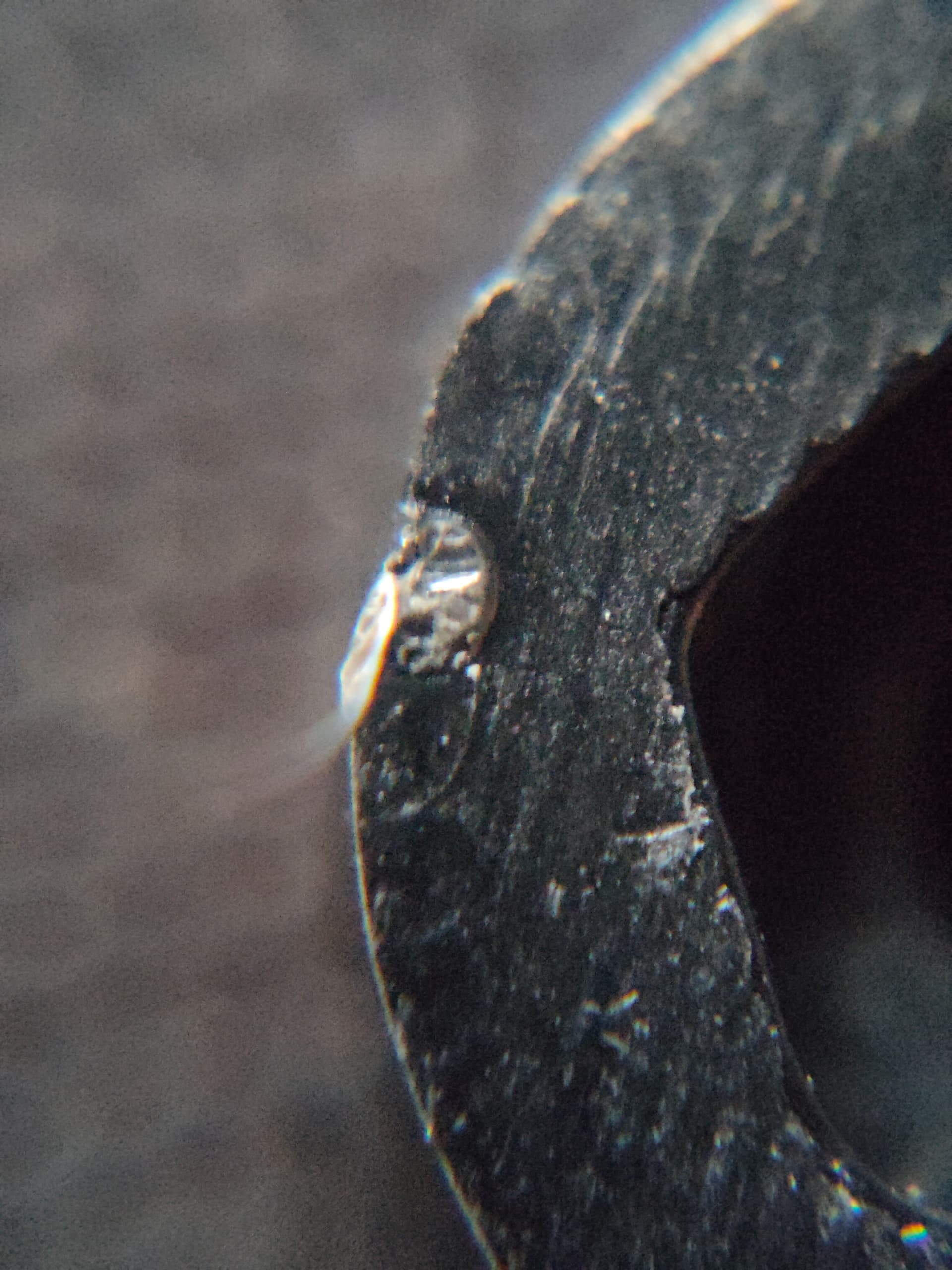

Same issue here on my new P2S. Newest firmware and Bambu Studio. Quite a contrast with how it and my A1 finishes prints. The A1 nozzle moves away immediately at the end while the P2S nozzle just sits for a bit, leaving a blob on the print.
