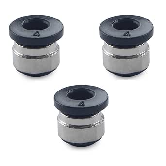

Hi,
I’ve been experiencing some issues where it was very hard to get the filament out of the extruder, like something was binding. Also the filament detection sensor started acting up and kept detecting filament even when nothing was in there. Sometimes when running filament through it, I had hard time getting it to feed - it was suddenly more fussy about the angle I inserted the filament at.
I did the usual - blowing it out with air without much disassembly and it fixed itself for a week.
Yesterday I had a clog, and while dismantling it, tiny filament “guides” fell out of the extruder. It was formerly on the inside of the PTFE connector on top of the extruder and they were just ripped out and all over the place. I think this was the cause of my problems and thankfully it didn’t get deeper inside and didn’t destroy anything.
I’ve removed the filament detection part and got the PTFE connector out, it is simple to replace.
The purpose of this post is
  1. if you are having problems, check your to see if your guide have disintegrated. In my case it was almost certainly caused by abrasive filaments and clearing clogs by cold pulls through the extruder
  2. anybody know what the replacement part is? I can’t find a “header” like this
Ya those ptfe connector must be Bambu only I have never seen that type also.
I don’t know if you can get something like this to work by removing the internal parts and repairing the Bambu connector internals or by 3D printing an adapter.
Small PTFE Connector
Or maybe lock your ptfe tube into one of the Bambu ptfe guides for now until you get a part.
Thanks for the link. I’ll try and see if it fits.
The connector still works, it just has that broken “guide”. In fact, that metal part can be removed from it and could be replaced, but I think finding that one would be even more tricky :slight_smile:
It is a bit chewed up, I think it’s the most consumable part of the extruder by the looks of it. Maybe I’ll try BL techsupport to see if they want to provide it as a spare part.

FYI, the dual PTFE connector on the back on the printer can be split open and the connector can be easily swapped in the filament sensor. I have three extruders where this sensor failed.
Also, when this part fails, the metal parts from the inside of the connector get stuck in the filament sensor because it’s magnetic, so check yours if you have any weird feeding errors.

Just as a small side node: it is the PTFE tube connector.
In the extruder you can simply slide it out to the side.
And then use the black labelled connector from the back. Useful when you plan to install a Y splitter in any case.
In my case, the filament sensor’s ptfe black connector wasn’t able to latch on to the ptfe tube anymore and I was contemplating ordering a bunch of new filament sensor and even the whole extruder unit.
Thanks to the above comment I tried breaking apart (if there’s a non destructive way to do this please let me know) and extracting the black end of the ptfe tube connector, replaced the one in the filament sensor and now everything’s working perfectly!

Where do you get a replacement pneumatic connector? It’s not on BL spare parts site, the Wiki doesn’t give a link, and Amazon has a thousand shapes and sizes. I don’t have an AMS right now because of this little fitting.
They aren’t pneumatic connectors - just tubing connectors.
Yes, totally the same! I’ve cut up one, and change the broken one in the sensor.
Try these sources for the bare coupling;
https://www.aliexpress.us/item/3256809319442958.html?gatewayAdapt=glo2usa4itemAdapt
