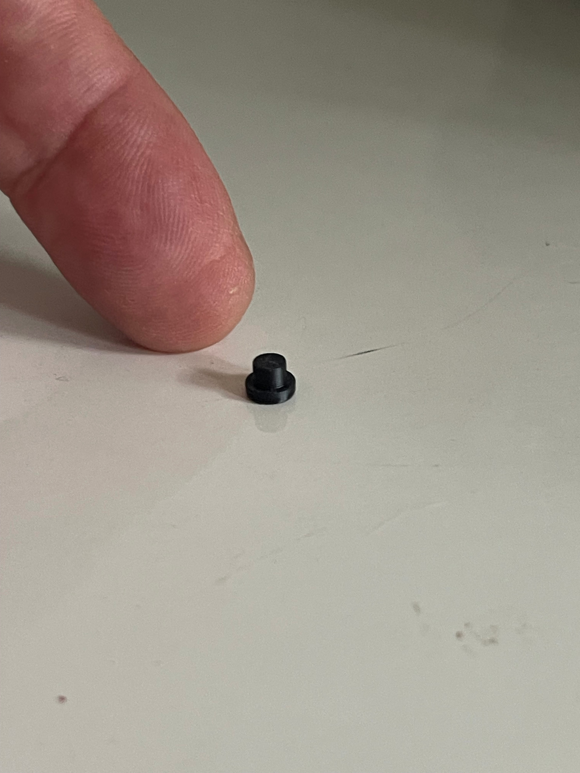

I’m thinking a ASA part with a washer on top , until i get the kit, do you know the dimensions
I printed one in ASA, and it’s printing fine. I swept the floor and found the metal cap, JEEZ its small. Why dont bambu offer schematics drawings of each part , if i had known there was a spring in there i would have done things differently
This is the ASA one, im going to keep using until it fails

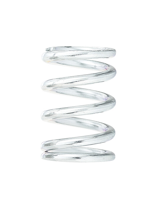

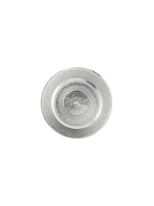

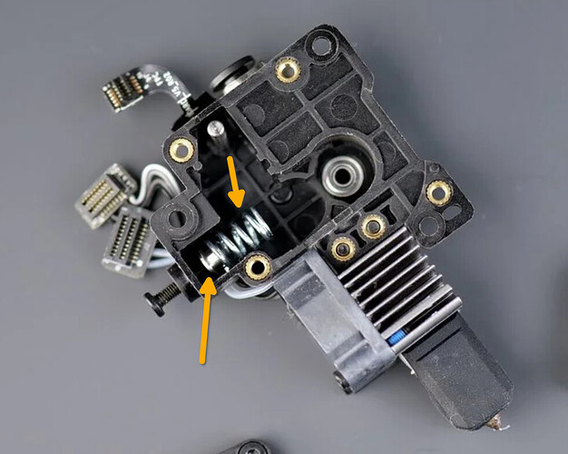

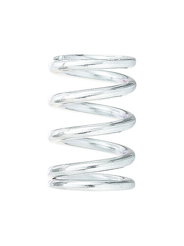

You could have ordered the P1/X1 screw kit, it has 5 of those caps in the kit, bambu calls it pressing plate
and it has 5 springs as well
17. The pressing plate & spring for the extruder gear assembly
The complete kit:

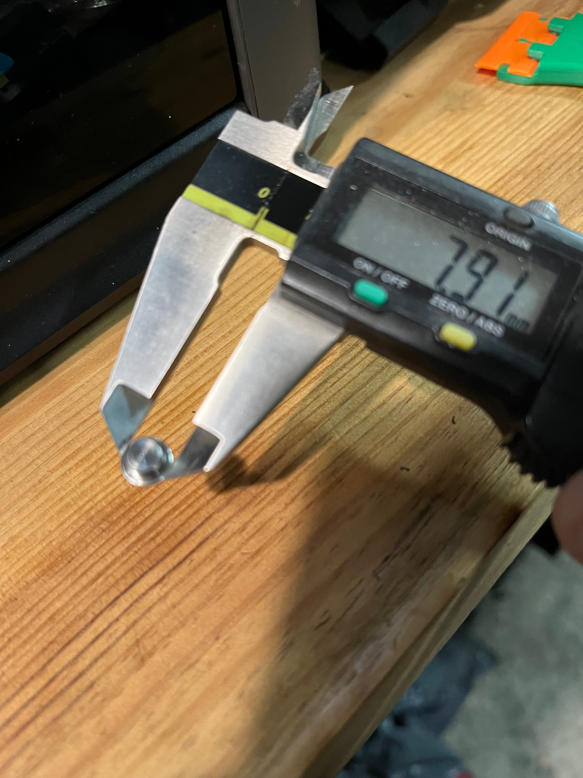

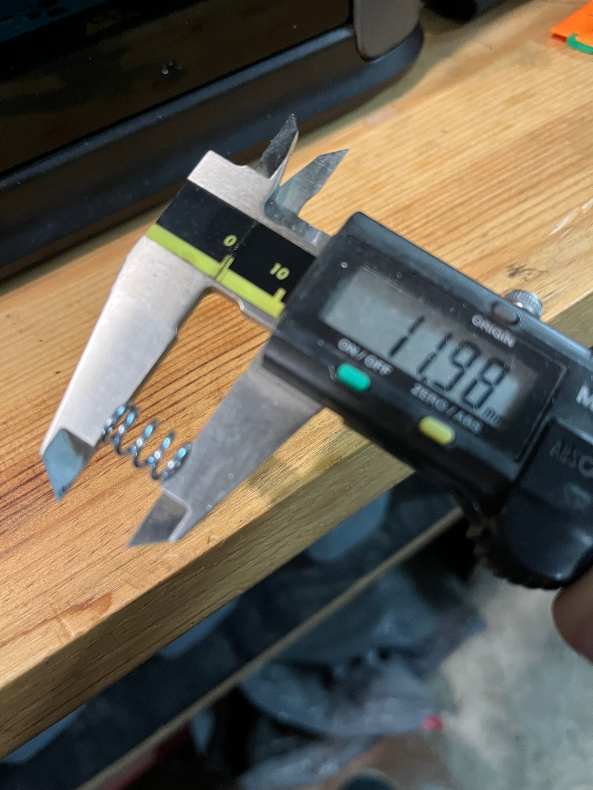

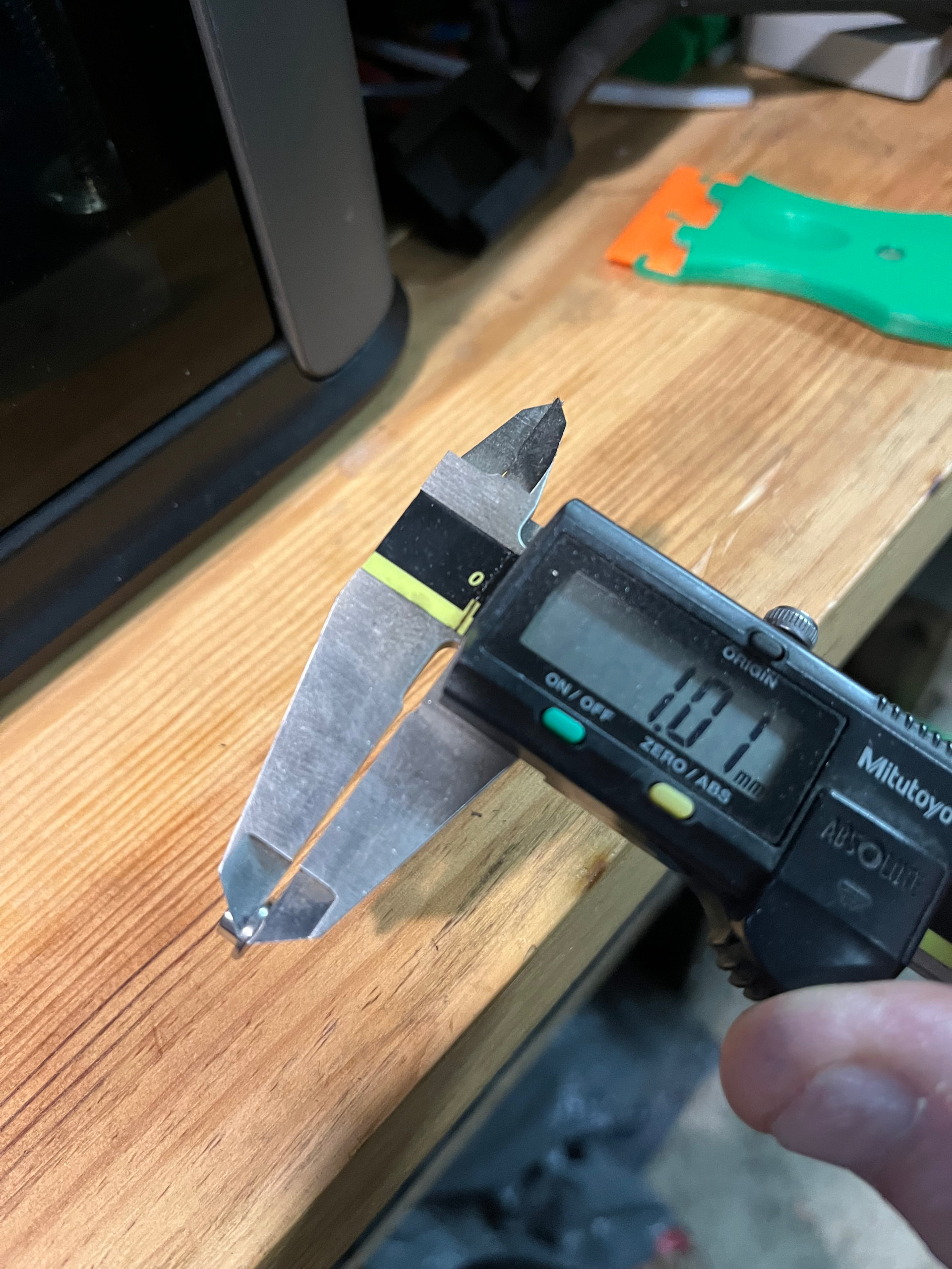

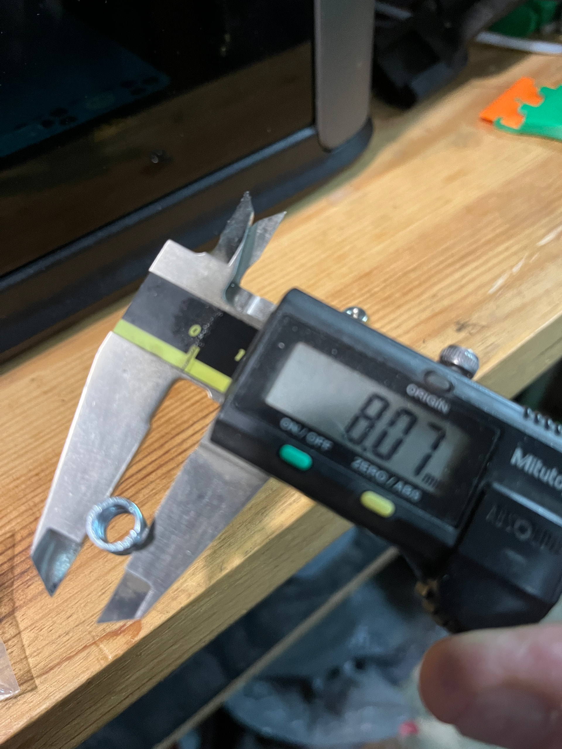

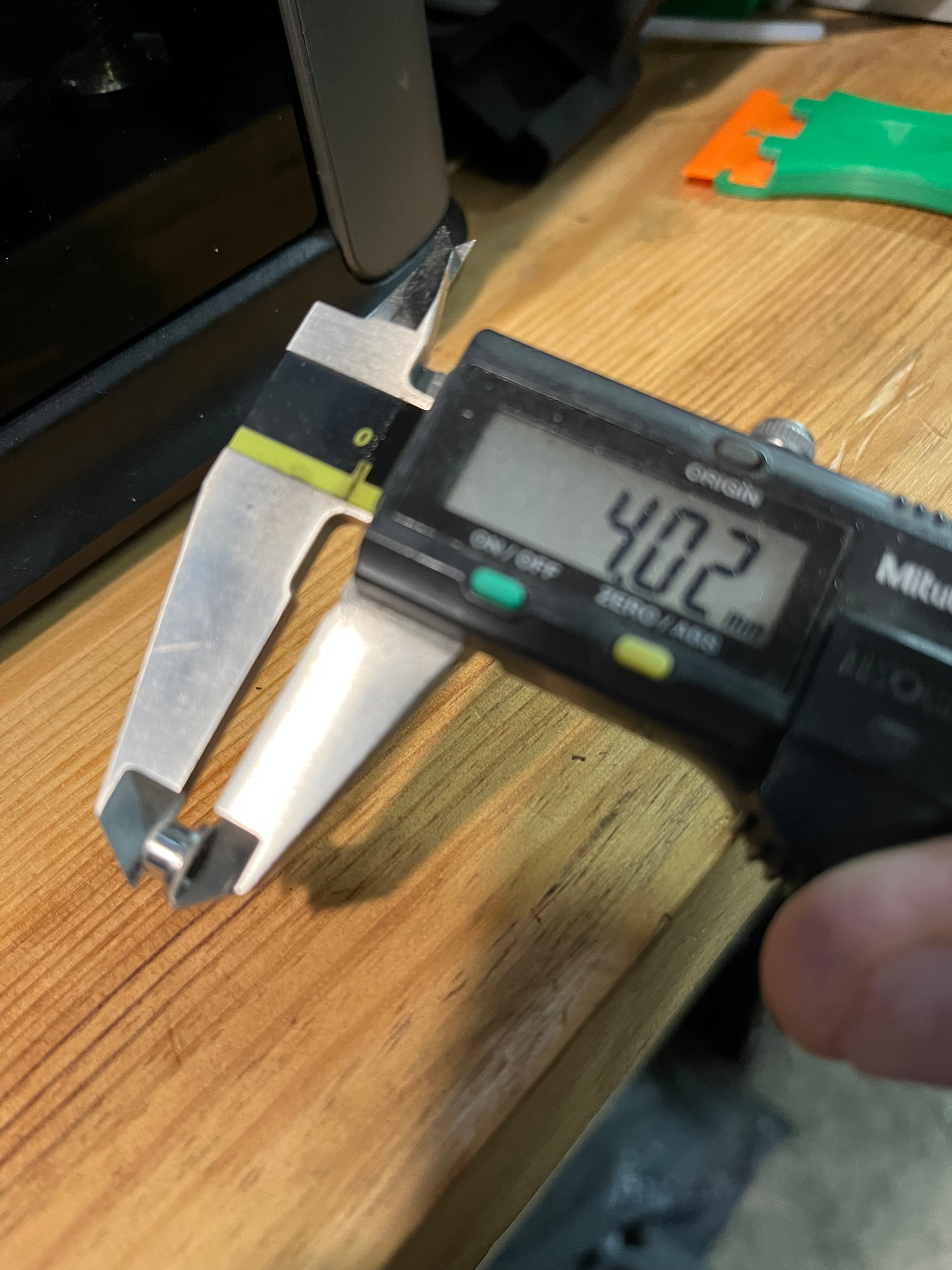

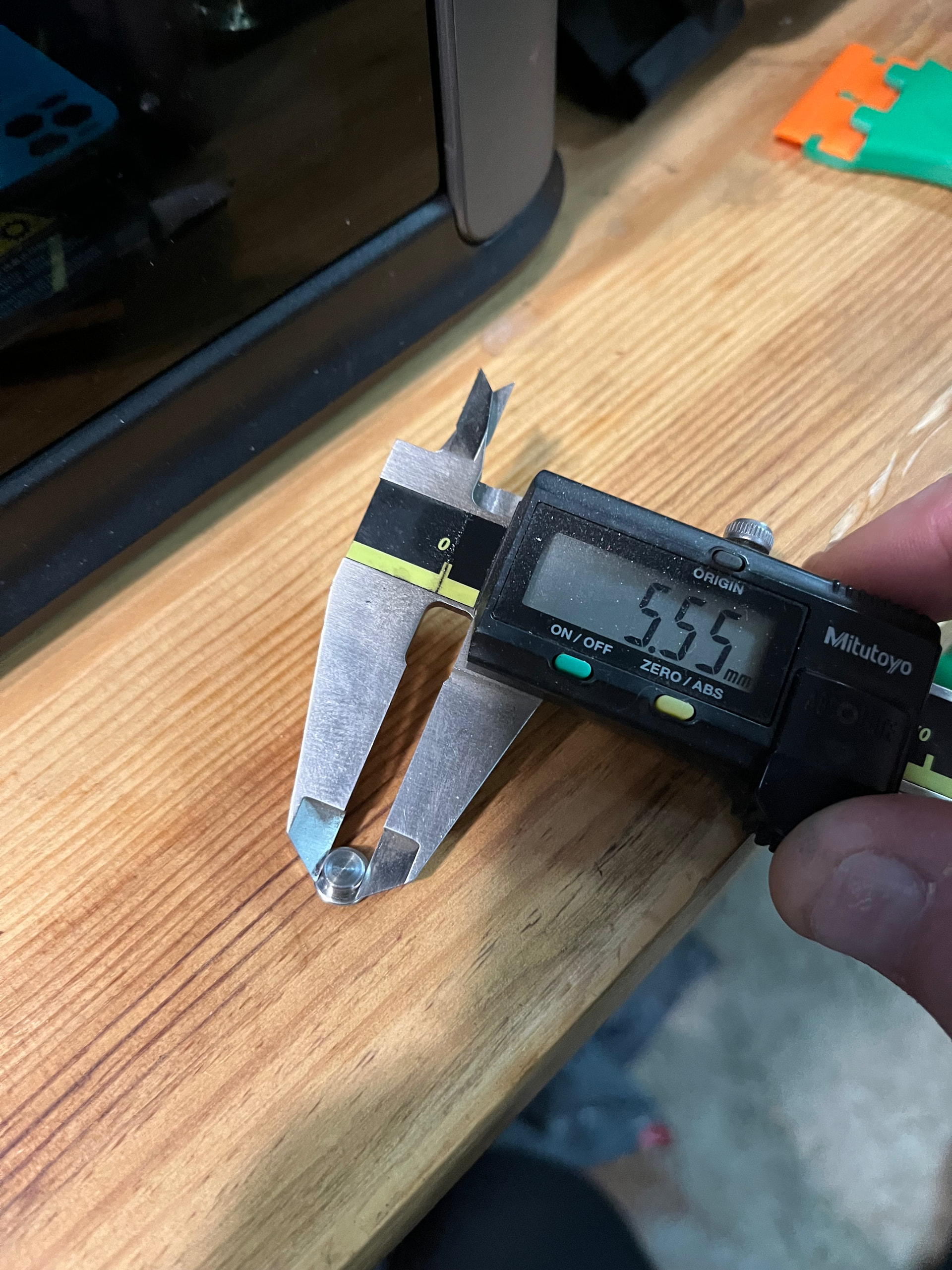

FWIW, here are the dimensions of the spring and cap from my P1S screw kit. You can check if they’re the same
Thanks for that , but this one is even smaller, diameter is 5.6mm, and spring only 7mm long
OK spring is shorter but cap is also 5.6mm in diameter
