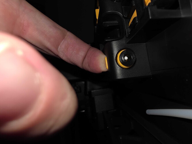

I loaded in some white PLA on the external spool. Maybe this was the mistake, not having it in a dryer…but for whatever reason, the PLA got stuck in the left extruder. Actually, no…it got stuck in the extruder guide box - the thing you take off to get to the extruder. 3 hours later, I finally got it unstuck after multiple different attempts. I thought “Yes, I might get out of tonight with a functioning printer again”.
So I go to load the PLA, and can’t get it to be taken into the printer. Finally, I realize the PLA I have is stuck in the filament buffer and jiggling it, pushing the black buttons on the orange filament buffers, nothing is getting this out…ultimately, it breaks off inside the filament buffer.
I then disconnected the filament buffer, tried to poke some ABS filament, PLA filament. I can’t get this thing to budge. I tried a few different paperclips, and it is stuck in there.

I suspect your issues were down to not having your PTFE tubes fully inserted into the machine inlet at the back and into the buffer. I can also guarantee that it will take longer to replace the buffer than it would take to remove the broken filament.

I mean they were all pushed until they stopped, which i thought was what the instructions said.
@Gerrit thanks for that link. I’ll pull the filament buffer out and try jiggling it before disassembling further. It indeed was non bambu pla white plastic which that link also mentioned. Literally the only spool I’m using that is not bambu labs.
You have to check through the tiny rectangular hole on the inside of the printer to see if the tube is fully inserted. Sometimes it feels like you reached the end, but some retries let it go further.

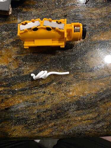

no amount of jiggling or paper clipping was removing that…Jesus…and instructions were scarce on how to disassemble the filament buffer. Now to get it back together. I’ll try to post disassemble instructions as I get it back together.
I think i know how it happened…I loaded pla right after a 4 hour abs print and I think the pla got all oozy everywhere.

This picture also gives me the feeling that you didn’t insert the PTFE tube far enough. The fact that is was able to curl up like that indicates that there was a part in the path that was far wider than 2.5mm.

Looking at the picture again, this is the moving part of the buffer and not the orange inlet on the back of the printer. My mistake!

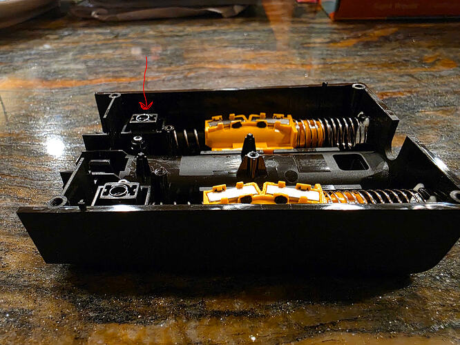

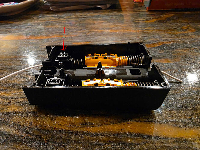

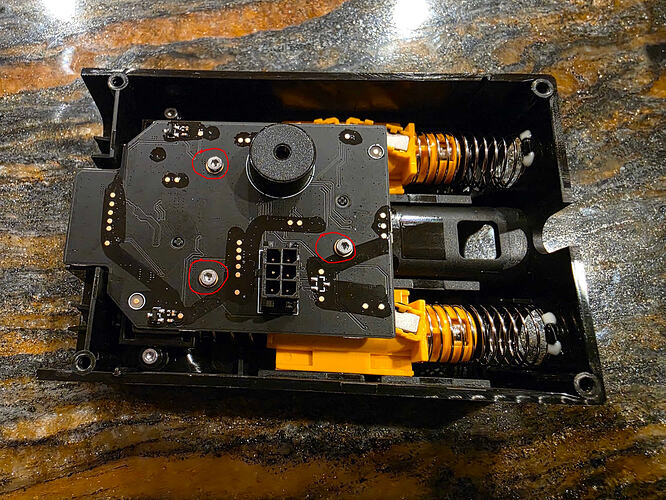

Filament Buffer Disassembly (I didn’t find this anywhere, but I found a reddit post text describing it, so I tried to take pictures as I was reassembling it for others in the future)
Once you have your filament buffer out: Replace H2D / H2C Filament Buffer and Cable | Bambu Lab Wiki
Remove these three screws
If your filament is working well, the spring should be down when filament is not in and up when it is in. Understanding this will be crucial if you (likely) pull the magnet out.
Note, if you have filament stuck in there, you won’t be able to demonstrate this picture, as the filament won’t run through the whole filament buffer, but it’s a good test when you are reassembling it that you have it right back together correctly.

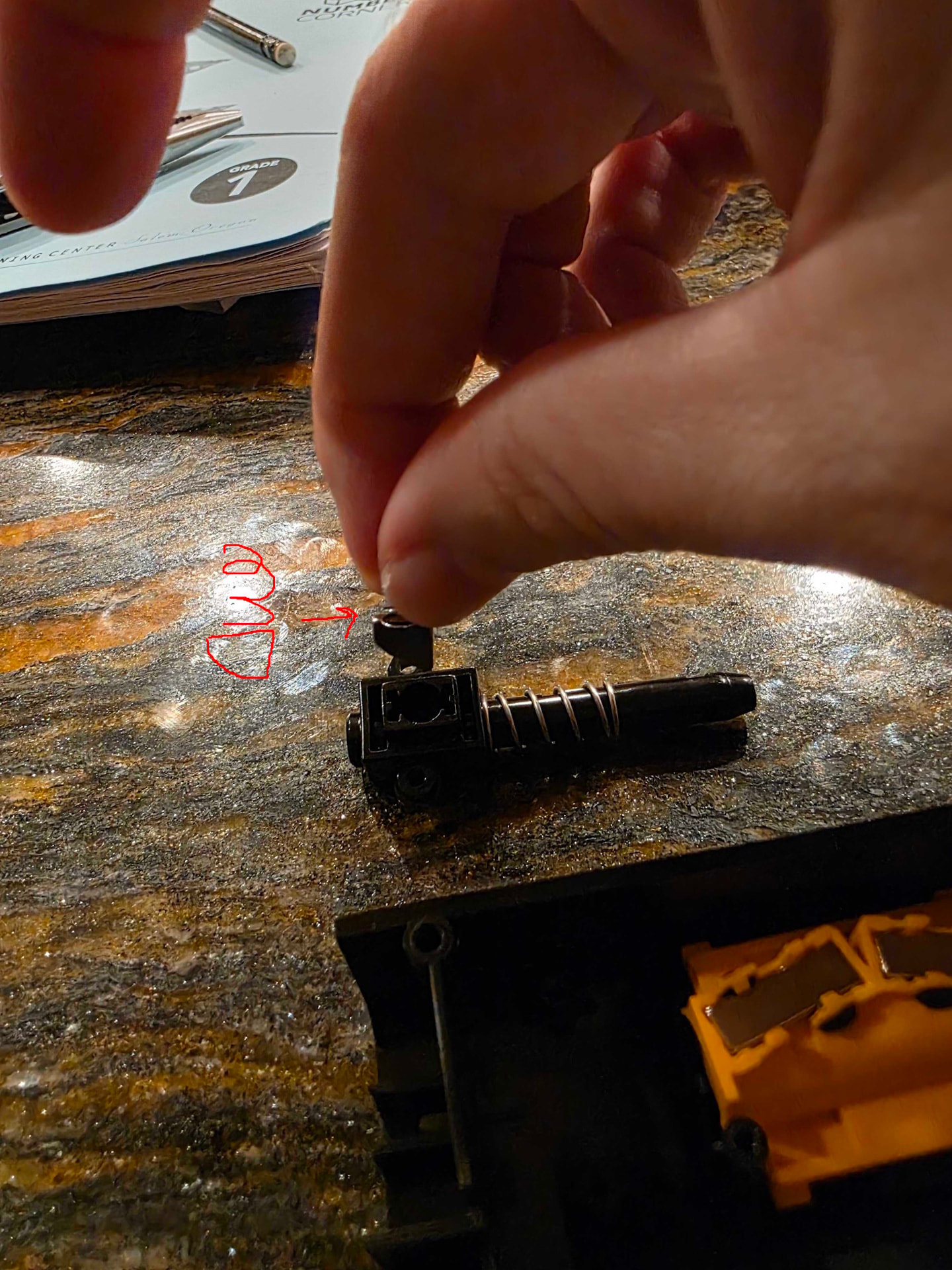

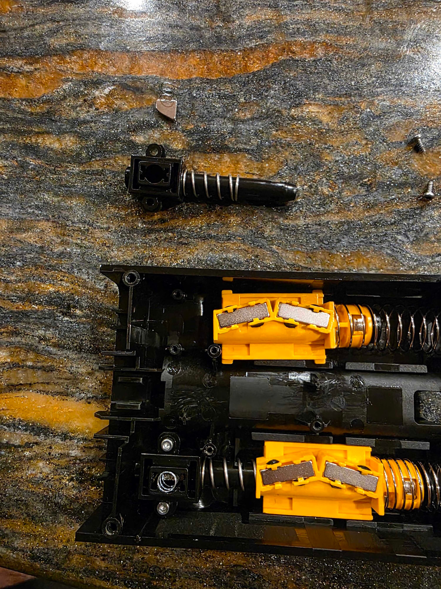

Next, you’ll want to remove these two screws here. This allows the whole black rod assembly to come out and easily allows the orange slider to be removed. (It’s during this step that magnet is likely to jump out and attach to whatever tool you are using)
If the magnet does jump out, this is the orientation it needs to be in, with the wedge side facing towards the external/AMS unit, and the hard flat side facing inward towards the printer. In this way, as filament is pushed from the left to the right (in this picture), it will raise the spring as we saw before. Otherwise it will stop your filament.
Once you have the black rod out, the orange slider should slide out easily, and you’ll be able to reach whatever filament is stuck in there much easier, using a piece of filament, paperclip, etc to push the filament out.
