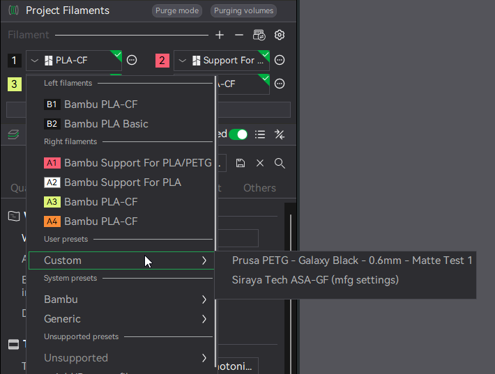

Question 1 - Now i’ve added the H2C all my filaments that I have calibrated previously are now “Unsupported”. Is this a glitch? Am I seriously unable to select these for this printer now?

You’re able to manually enter Custom Filaments from different Brands if you click the cog wheel on the right side of your filaments aka ‘Project Filaments’ then there are tabs at the very top that say ‘System Filaments’ & ‘Custom Filaments’ and I’ve made a few that actually pop up under ‘Custom’ but I can never import any one brands config’s and choose from their filaments.
I hit the same thing moving from a P1S to an H2S – all my calibrated presets ended up under “Unsupported presets”.
What’s going on (user_1329389890 was on the right track): a user preset only stores your changes and inherits the rest from a system preset tied to one printer family – e.g. “SUNLU PLA+ @BBL X1C”. Bambu didn’t ship SUNLU / eSUN PLA+ / PolyLite / Overture system presets for the H2C, P2S or X2D at all, so that parent doesn’t exist there and Studio hides your preset. Newer printers also keep one value per nozzle type (Standard / High Flow / E3D High Flow), so the arrays have to match.
Manual fix: open the preset .json (%APPDATA%\BambuStudio\user\filament), change inherits to a preset that exists for your printer (e.g. “Generic PLA @BBL H2C 0.4 nozzle”), re-import via File > Import > Import Configs. Your own overrides (flow ratio, temps) stay.

Fair question. The porter doesn’t copy the P1S profile wholesale. A Bambu user preset only stores the values you changed; everything else comes from the system preset it inherits from. The porter re-points inherits to the matching system preset for the new printer (e.g. “Bambu PLA Basic @BBL H2S”), so all the H2S-specific defaults (cooling, chamber, speeds, volumetric limits) come from Bambu’s own H2S profile.
What does carry over is only what you tuned yourself: say a nozzle temp or flow ratio. If one of those overrides was a P1S-specific workaround (like extra fan because the P1S ran hot), it will carry over too, so it’s worth a glance. The porter lists every change it made, and warns when it had to fall back to a different parent.
