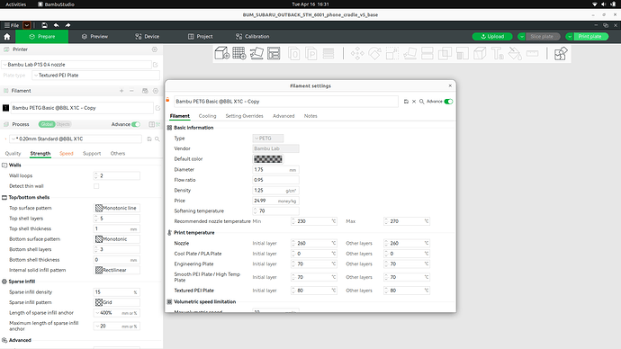

So I tried changing my filament settings to change the volumetric speed and various temp settings. Sometimes I can, but most of the time the settings are grayed out, or while I’m changing them they will gray out. Then I can’t adjust anything.
Any ideas?

I was able to change the settings for about a minute and then it locked them. Tried a new profile and restarting multiple times. Not sure what happened.
Tried the Ubuntu AppImage as well as the Flatpak. Every time I try to go to the “Cooling” tab in “Filament Settings”, all options become un-editable. All I can adjust sometimes are the temp and volumetric settings on the first tab.
I’m having the same issue with Bambu_Studio_linux_fedora-v01.09.01.56.AppImage and newer, but BambuStudio_linux_fedora_v01.08.04.51_20240117.AppImage and lower works. I’m using Fedora 39, and X11 (Not wayland, due to nVidia issues)
Also I saw that the filament settings file that 1.08 wrote, is not written when using 1.09 (under ~/.config//filament/.info and .json
In 1.09.01.56 and newer I can edit on the filament tab until i switch to a new tab, then pretty much everything becomes read only after that.
1.08.04 and lower works as expected.

Workaround that seemed to work for me:
  • Create new custom preset
  • Close Bambu studio
  • Start it again
  • Now the new custom preset is editable.
Sometimes this works, until you go to the cooling tab or anything else. I’ve been able to just modify volumetric and some temp settings on the first tab before it seems to lockout again.
Another workaround is diving right into the json file and manually modifying.
Agreed, I have this now too, it seems if I start BS, select a filament, go into the settings, I can edit the max volumetric speed… but if I start BS and instead of editing max volumetric speed, I go to the cooling settings, do nothing (!) just then go back to the filament tab, the max volumetric speed and everything else is not not editable!
It seems like just going to the cooling tab breaks everything, for all filaments, until I quid BS and restart it… then I can edit everything until the filament settings again as long as I don’t go to the cooling tab.

Agreed, this has been some fun, I am manually exporting multiple json files right now for this reason. About my only tip is if you hover over a setting in Bambu Studio for a second, it will show the parameter name that is in the exported json file. So for example, if you open up the filament settings, click on the cooling tab and hover over the value for “no cooling for the first” value, it will show the parameter name , “close_fan_the_first_x_layers”. Export filaments, choose whatever ones you want or all, and then edit the json file in the last directory, the Bambu directory with the bundle_structure.json files. for checkbox’s 0 is unchecked and 1 is checked although I think most here know that. After saving the json file in something like Notepad++ or something equivalent (notepad and basic text editors can mess up the encoding and formatting when saving after changes are made, rare but it can happen), import them back in, say yes if it asks to override setting and new values will show up.
