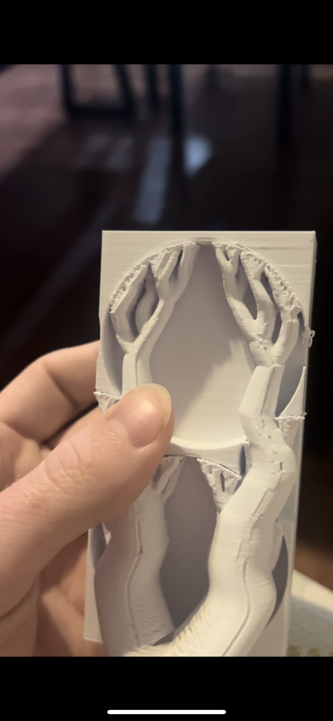

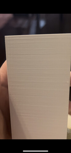

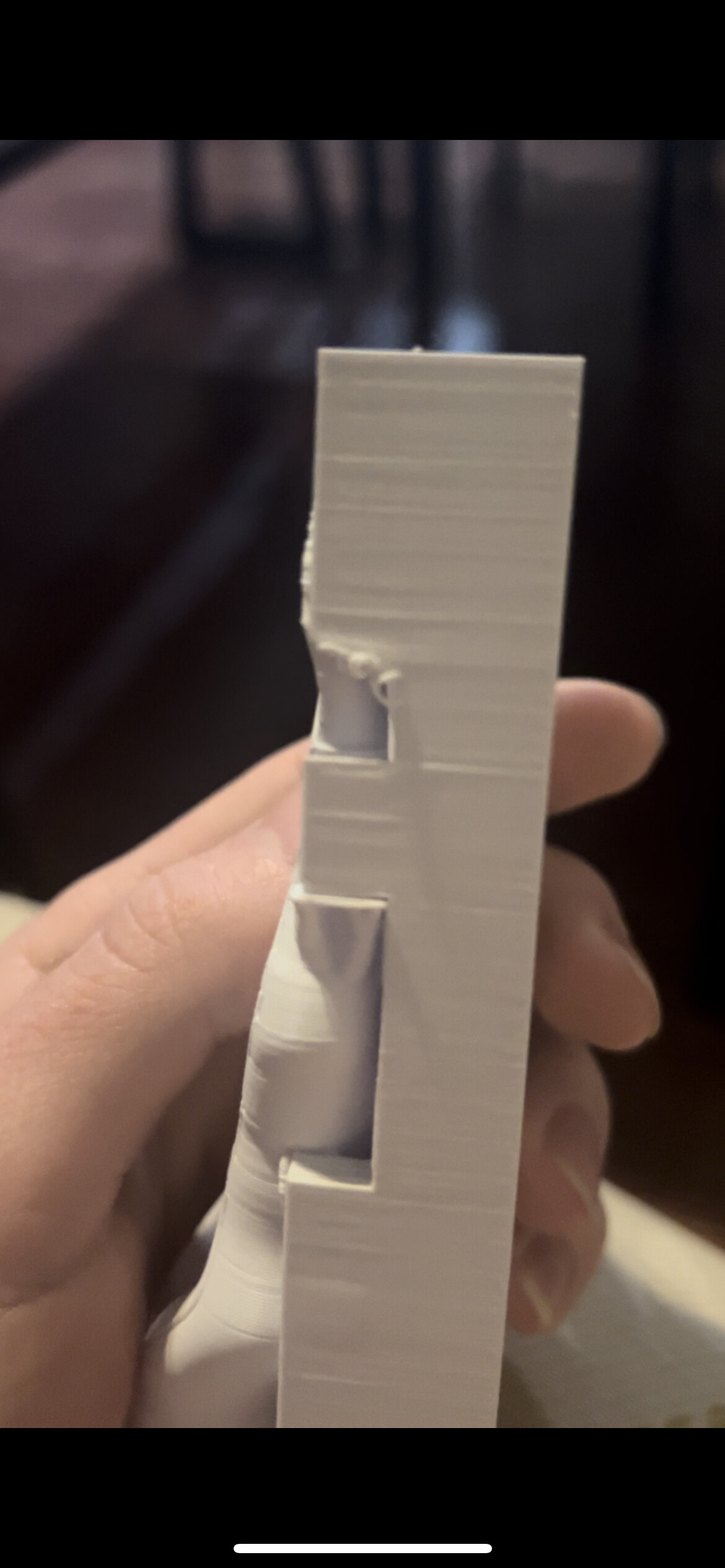

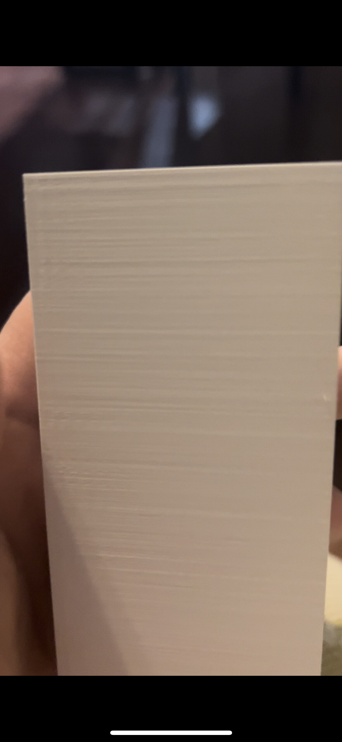

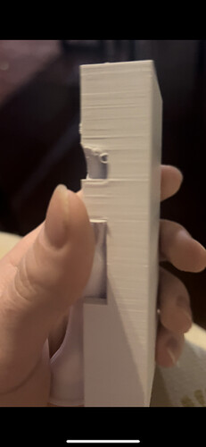

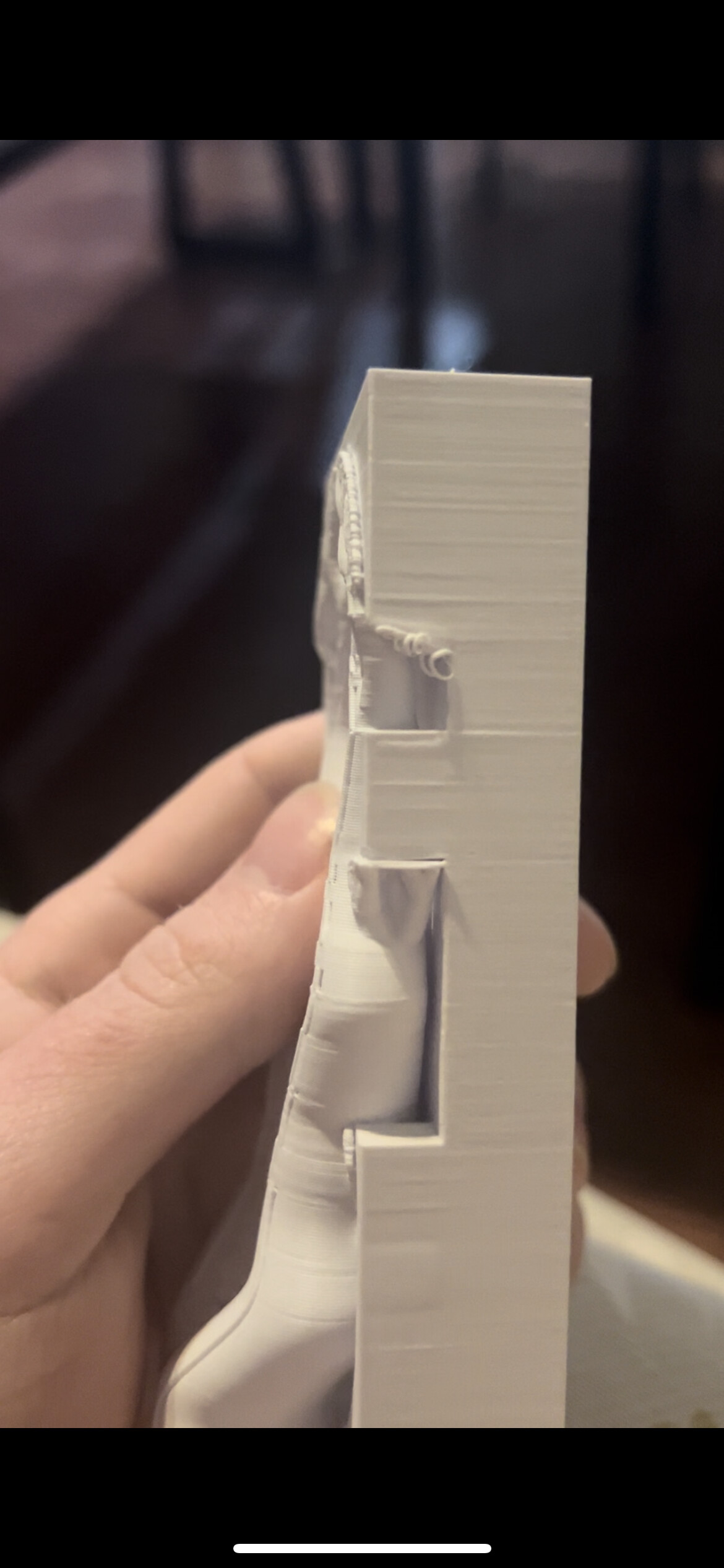

I have print this with esun pla + on my bambu lab x1c with 0,16 layer height and a 0,4 nozzle the result is clearly not normal right ?
