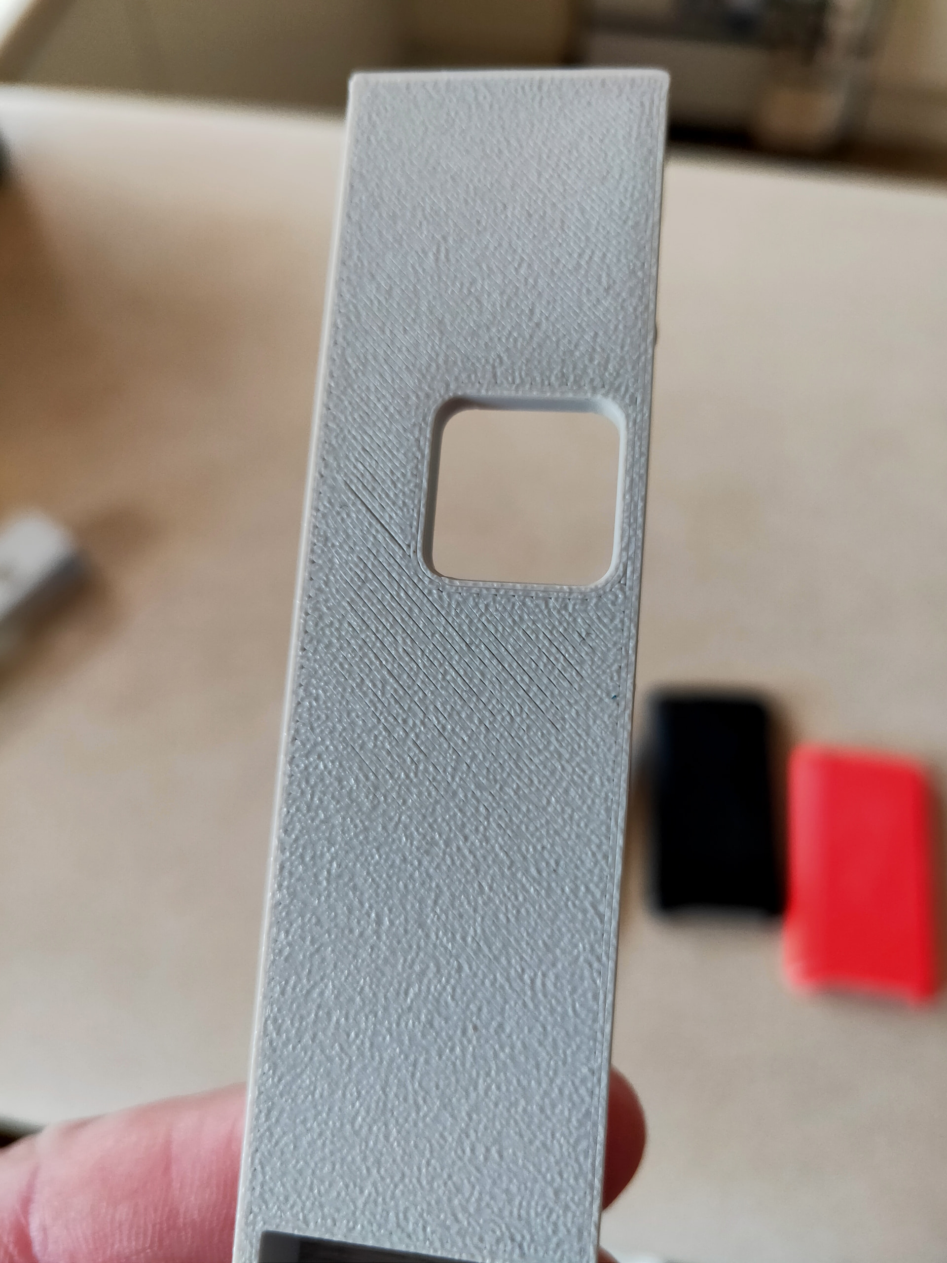

My machine produces near-perfect results on internal test prints and simple geometry. The defects appear consistently on complex geometry sliced in Bambu Studio.

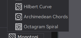

Have you tried changing the top surface pattern from lines to one of these three ?
I found in slicing, these would fill any holes left by straight line travel issues

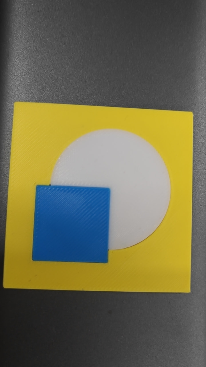

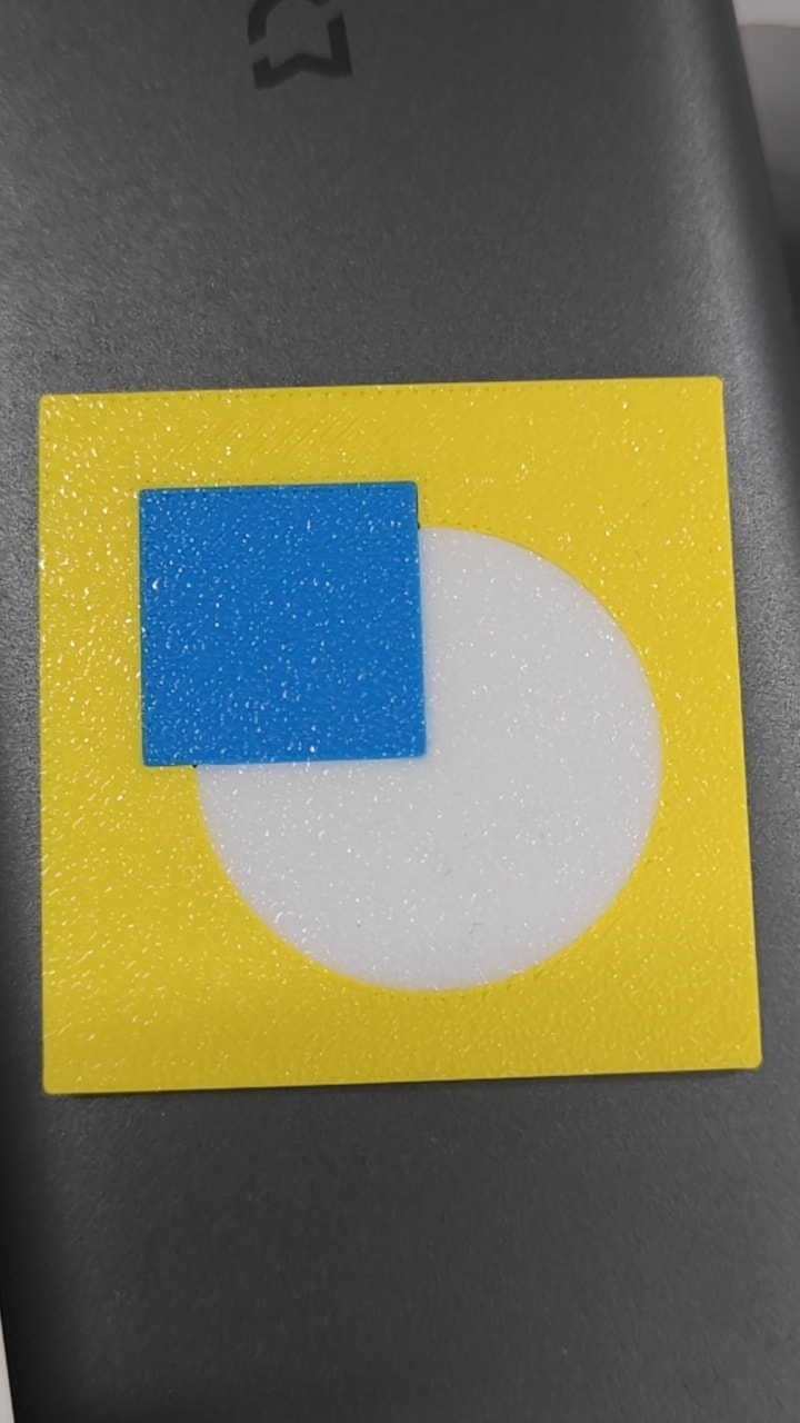

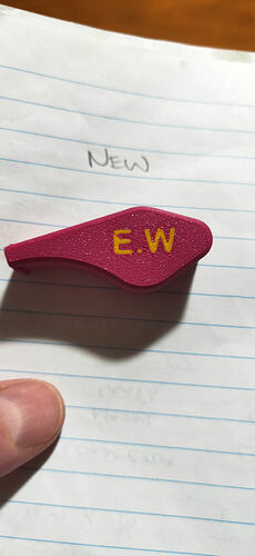

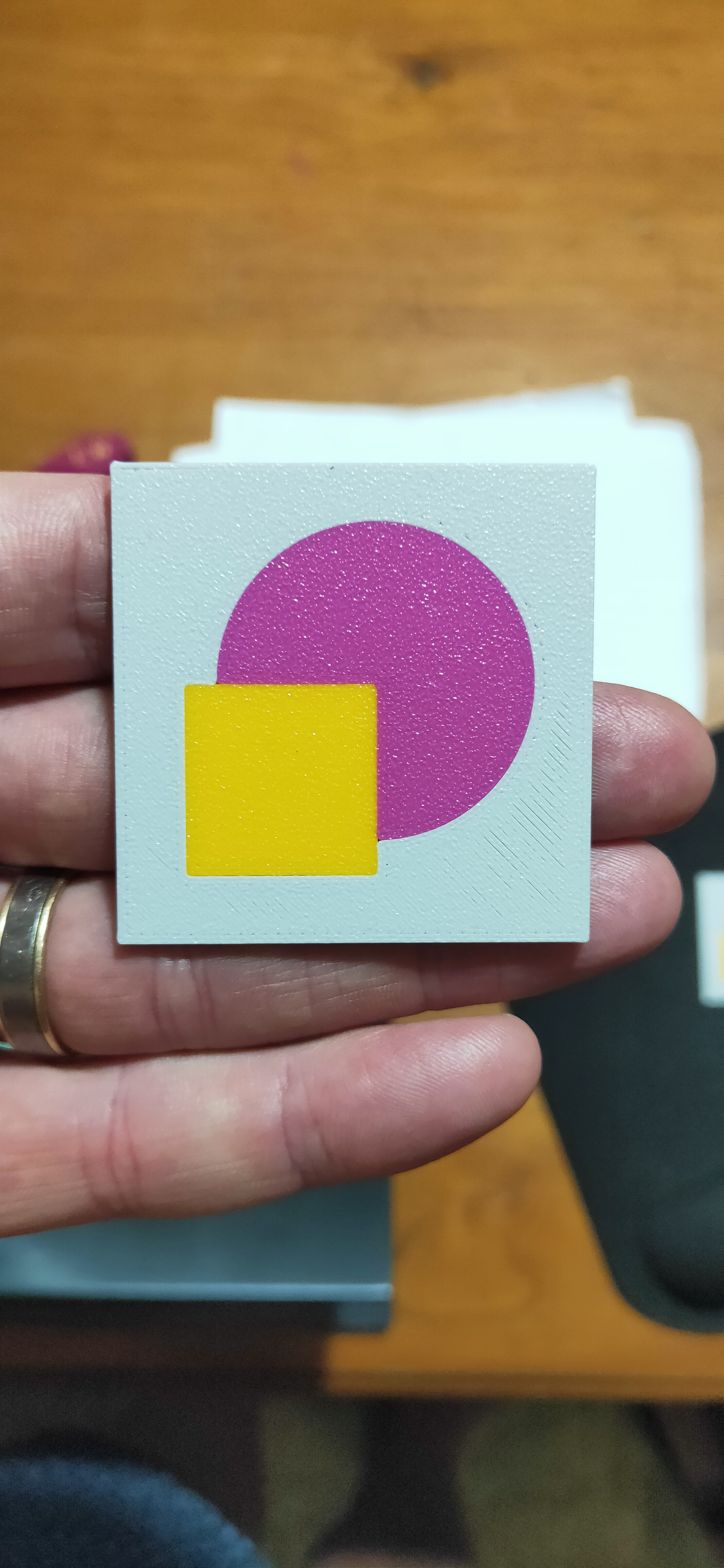

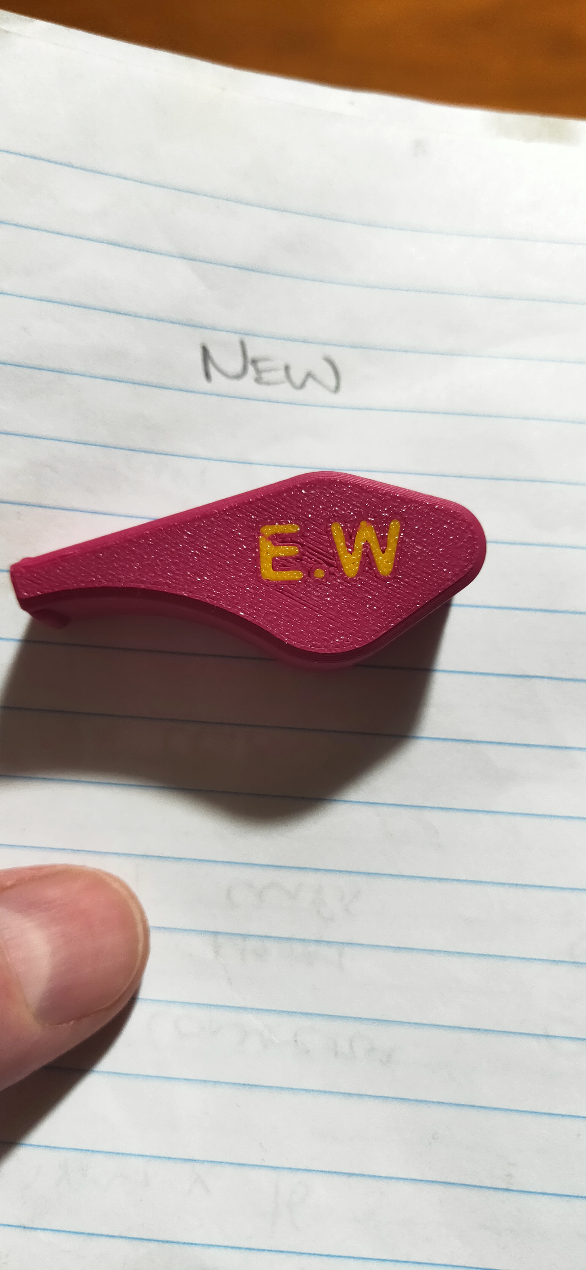

Here are some example photos of my current results,
The purple whistle is with all of their parameters to slow initial layer speeds and i added increase flow 1.05 and tried 1.1 no better:
The yellow square with Blues square and white circle is their results.
What you’re showing is inevitable for FDM.
There would be some workarounds, some band aids, but there won’t be a full solution. Remember that you’re plotting 0.42mm lines and they should not cross each other. Now use that rule to draw something like this:
You won’t be able to draw without any holes either.

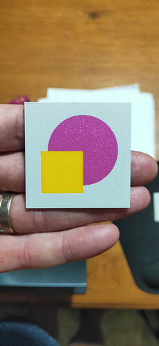

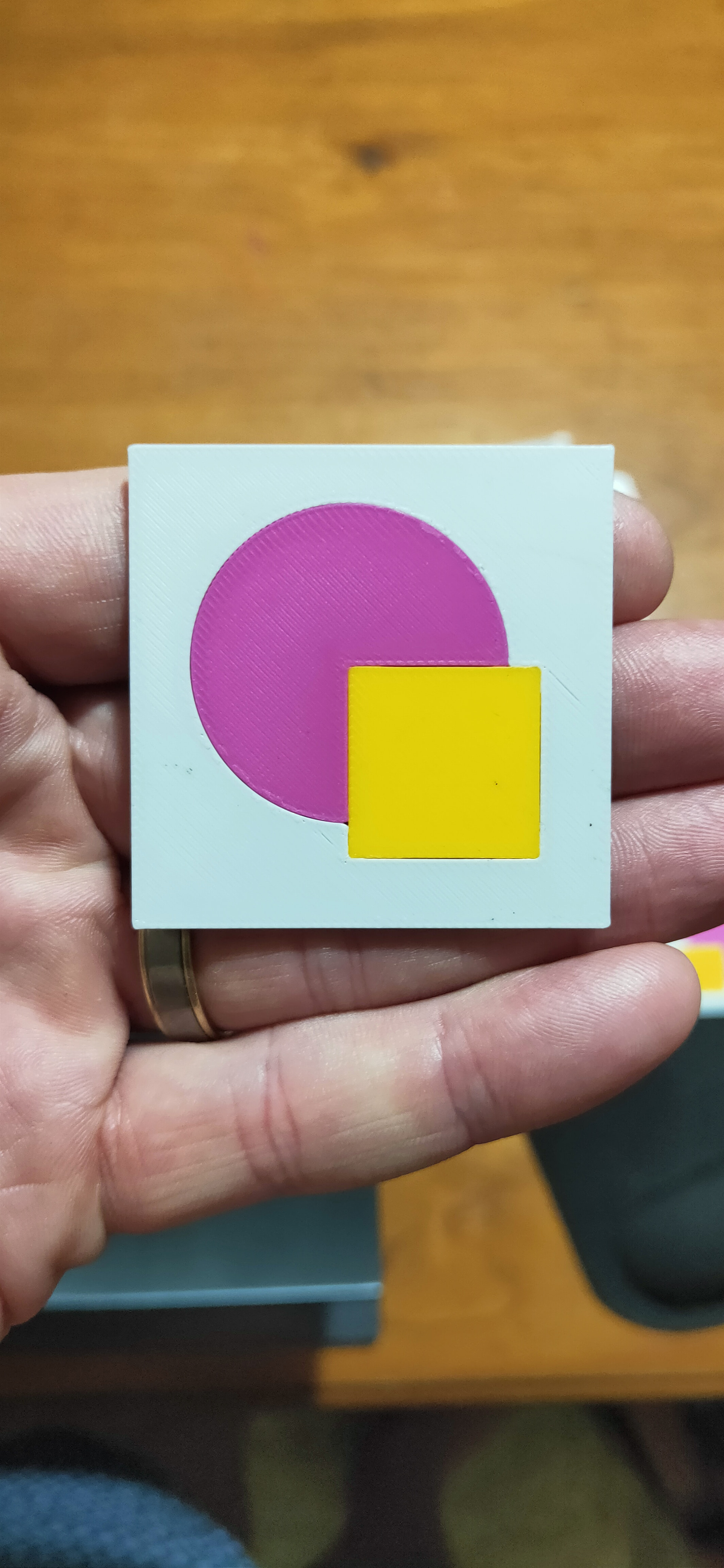

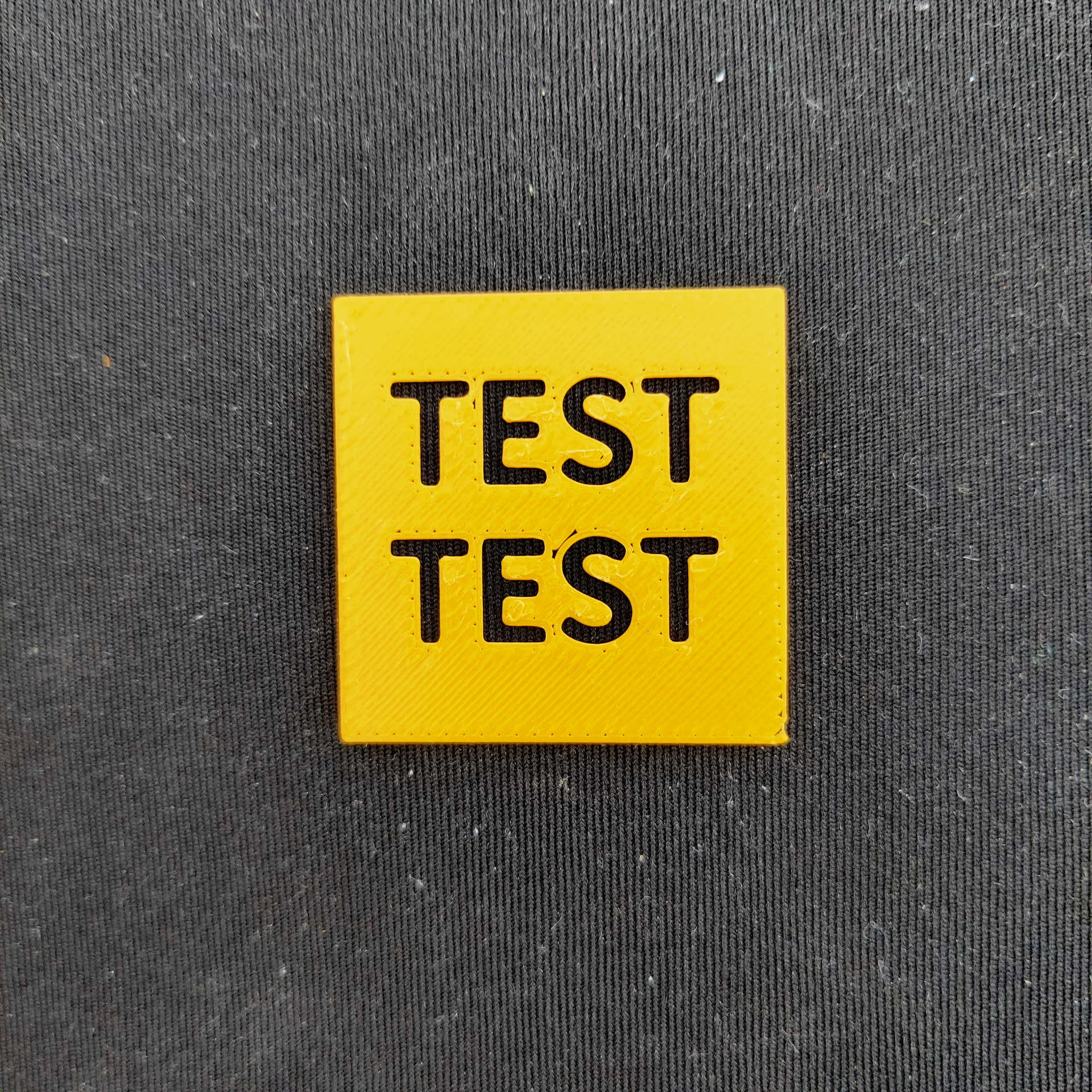

Here is just one example I printed tonight on my A1 all default setting:
And another with an increase to initial flow to 1.05:

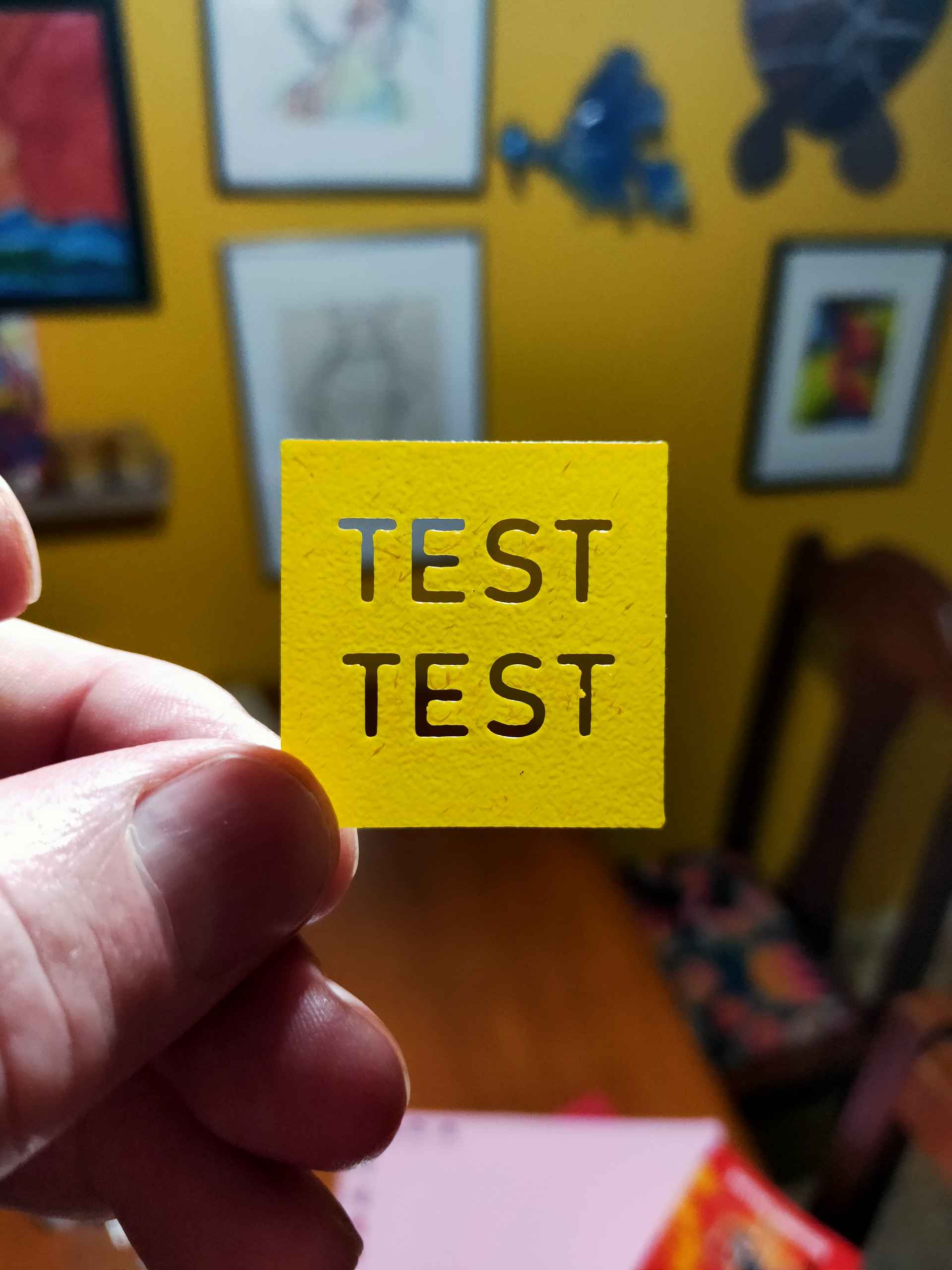

and here is the example printed on my H2C, initial flow 1.05, initial layer and infill speeds reduced:
I understand that some small gaps are an inherent limitation of FDM printing, particularly around complex colour boundaries. That’s not really what I’m questioning.
My concern is the overall consistency and quality of the first layer.
Every comparison I’ve submitted has been printed using the same Bambu filament and the same print files. On my Bambu A1, those same files produce a much cleaner result using completely default settings.
As another example, I printed the “TEST TEST” model on my A1 tonight using entirely default settings, and the result was near perfect. By comparison, the H2C example previously shown was printed using Bambu Support’s recommended changes (20 mm/s initial layer, 30 mm/s initial layer infill, plus an increased initial layer flow of 1.05) and it still produced a noticeably poorer result.
I’m not expecting a flawless first layer with no microscopic gaps. My concern is that the H2C consistently produces significantly poorer and less consistent results than another Bambu printer using the same material and print data, even after three months of troubleshooting and following Bambu Support’s recommendations.

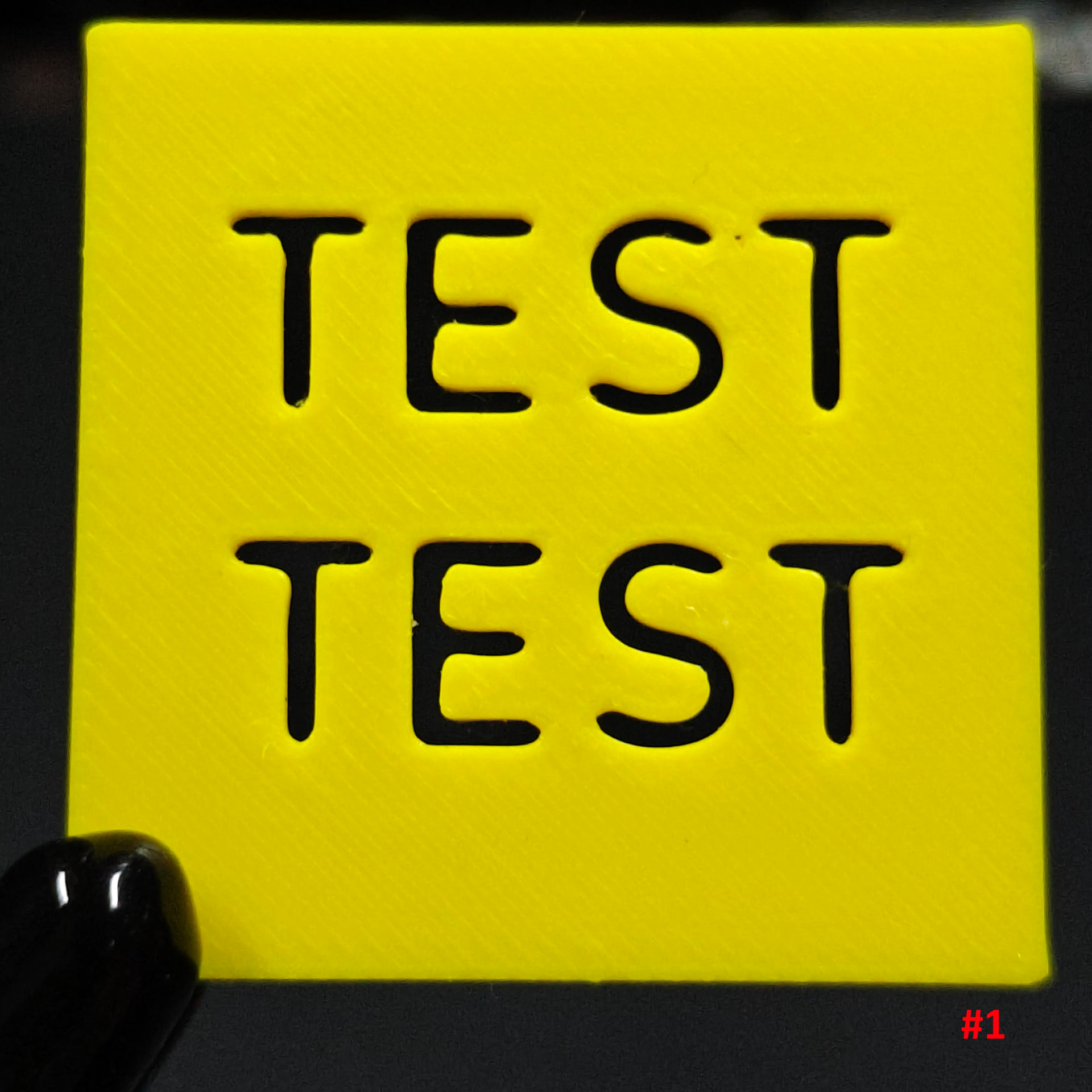

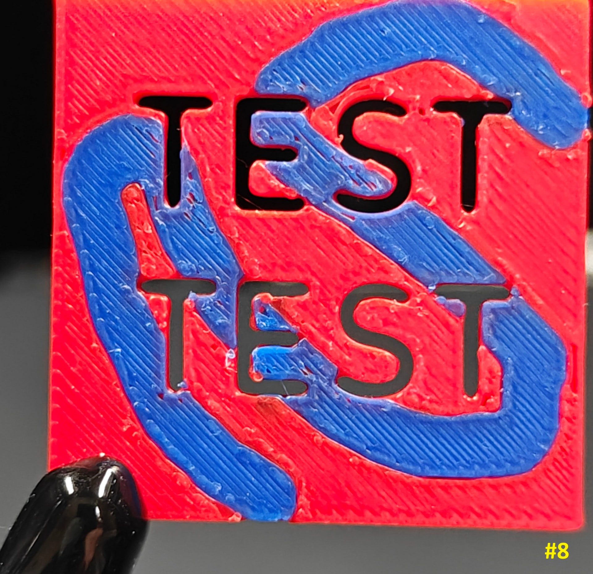

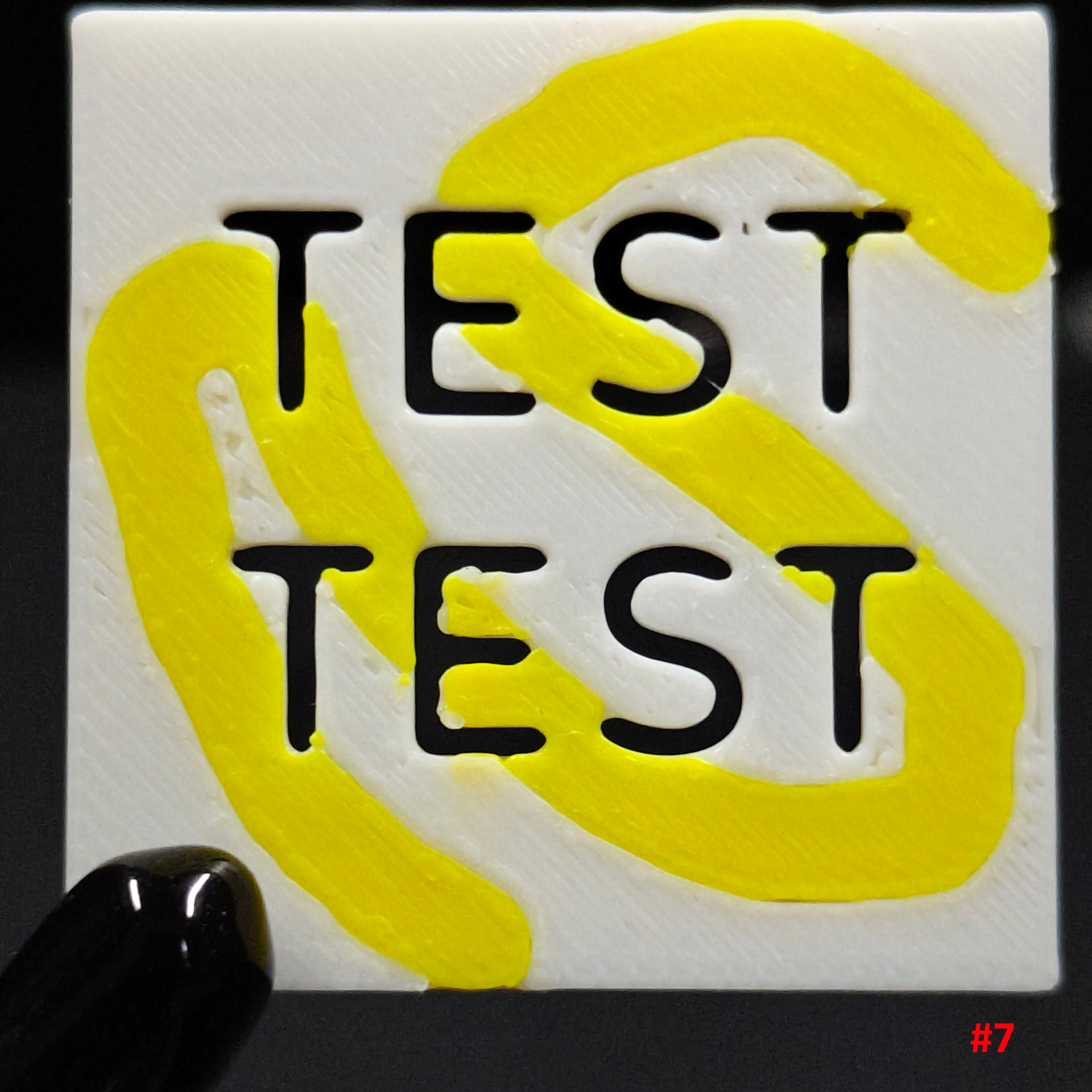

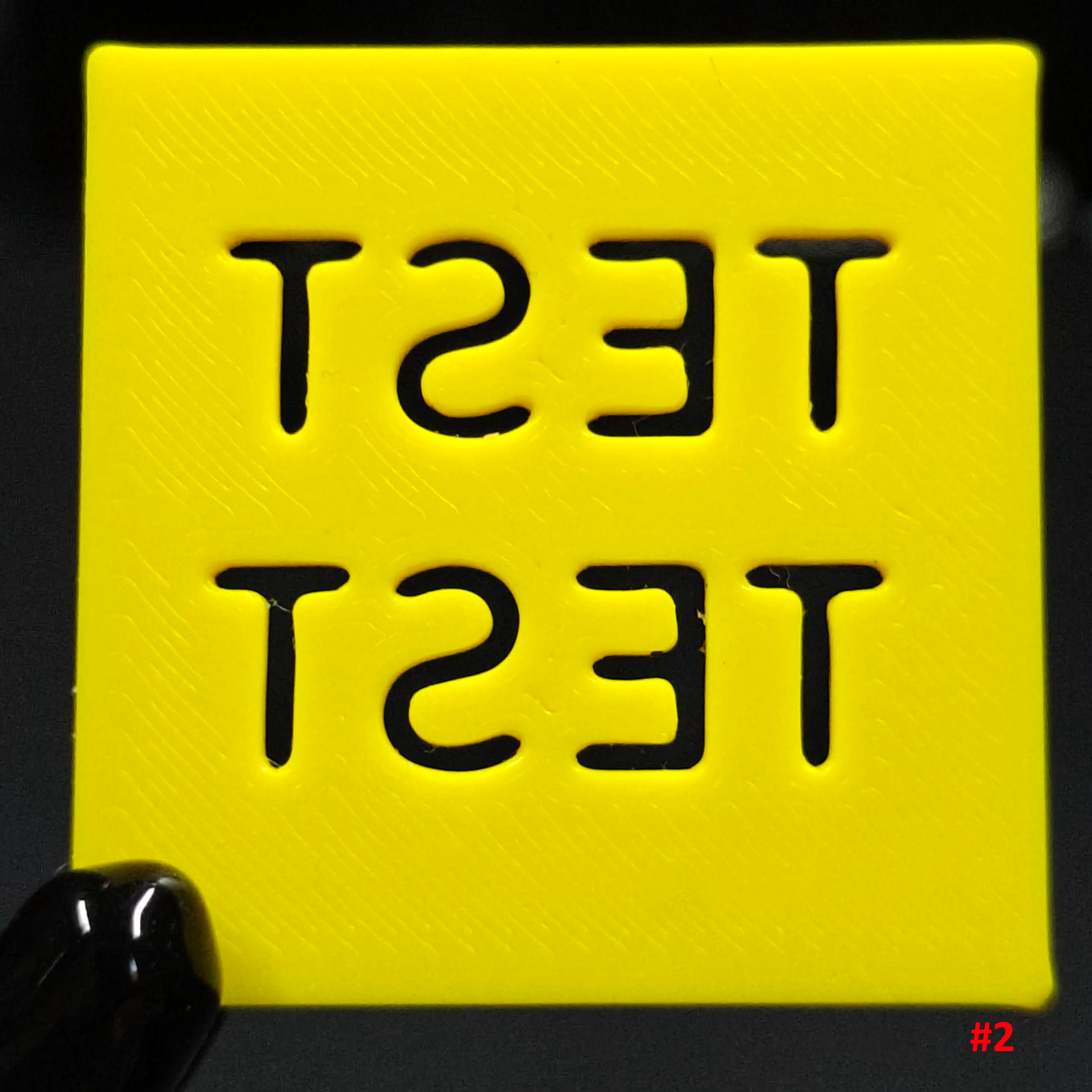

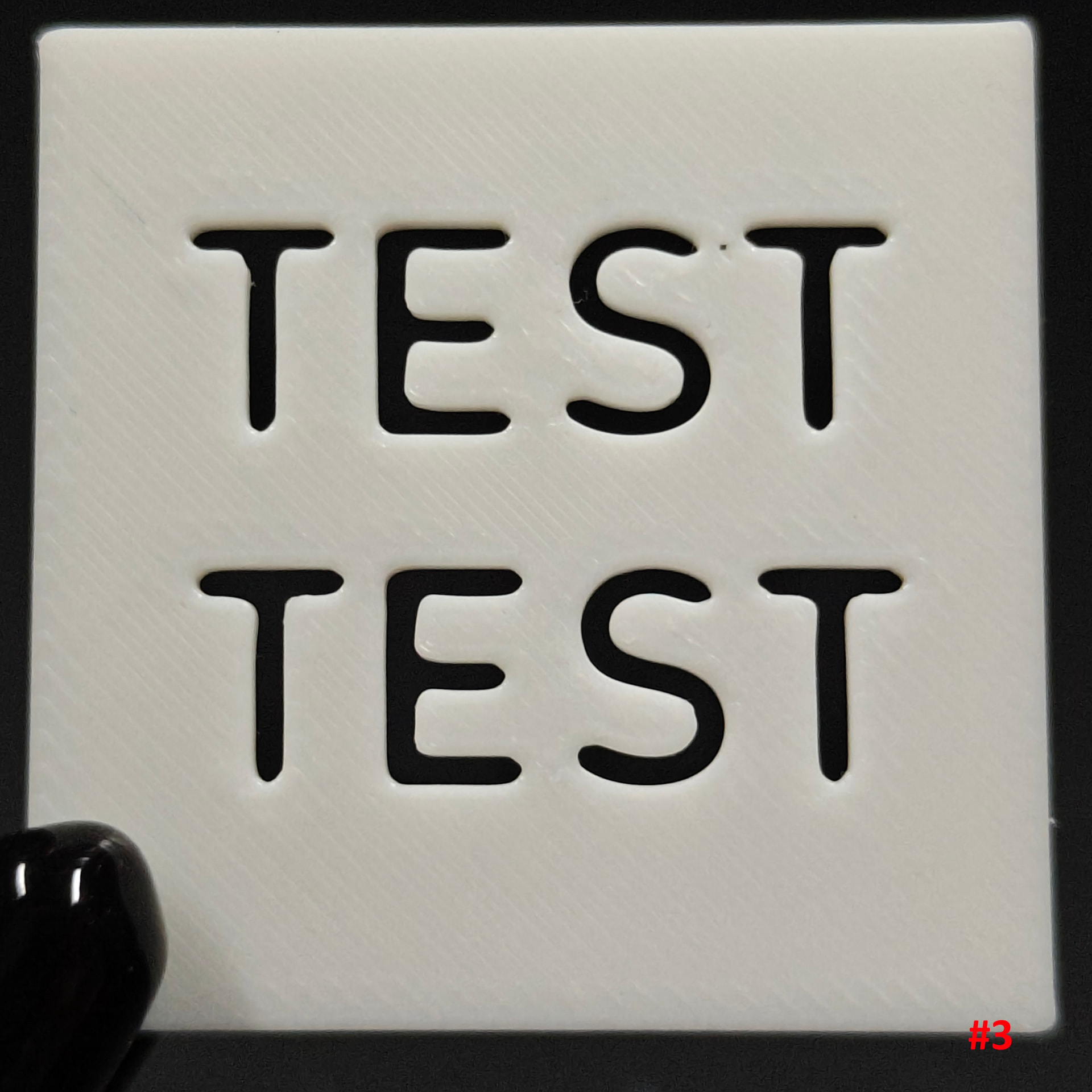

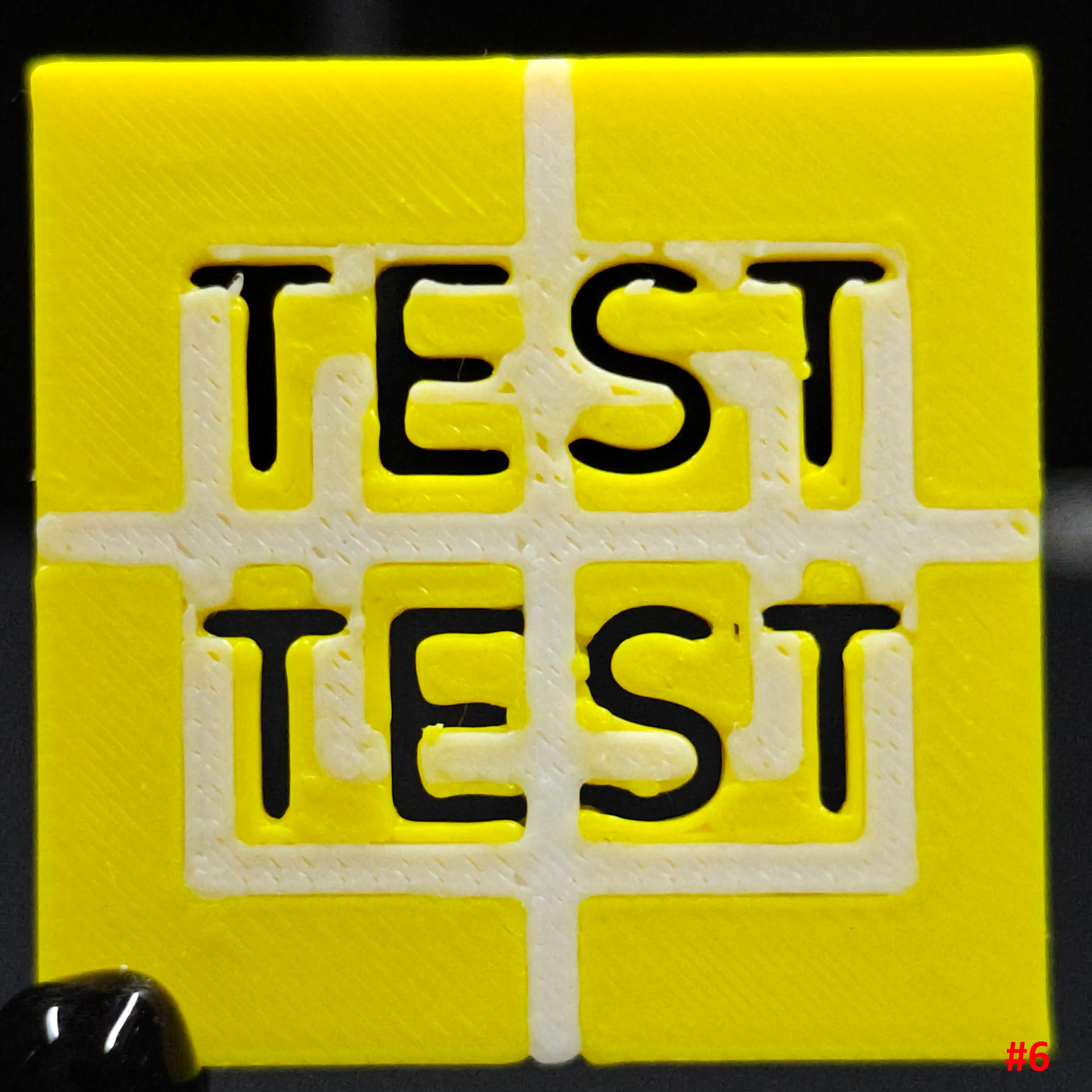

Great, thank you. I started a 35 hour print 60min ago so unless it fails early I’ll revert in a couple days with pictures.

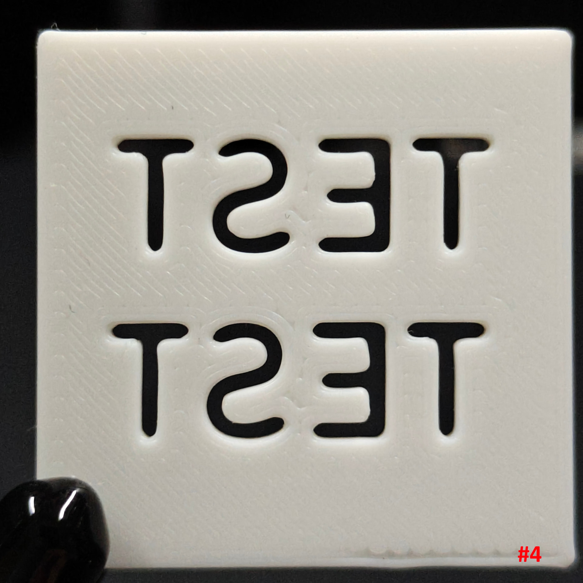

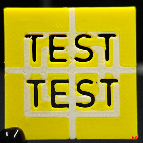

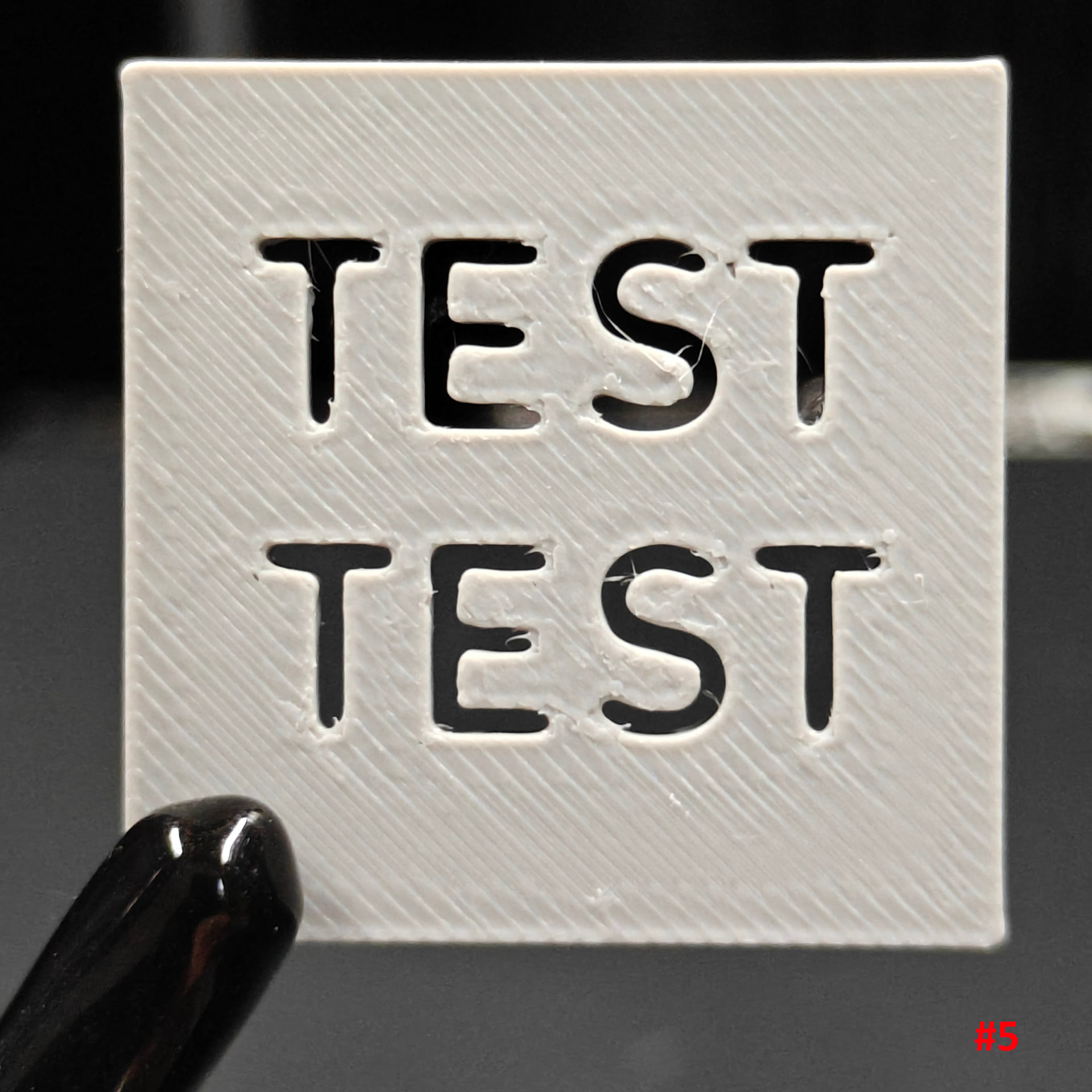

@RogueOhio The model is on it’s back in the 3mf (TEST not spelled backwards) so I also took pictures of back in solid yellow / solid white pics to show initial layer.
Default filament settings used except #5 and #8 (blue)
H2C; 0.4mm nozzle; firmware 01.02.00.00; Cool Plate SuperTack Pro; Bambu Studio beta v2.8.1.55
I used Bambu Studio paint tool for multicolor models. No other slicer settings were changed in 3mf you provided.
  1. BL PLA Basic; Flow 0.99
  2. BL PLA Basic; Flow 0.99 (back of #1 to show initial layer)
  3. BL PLA Basic: Flow 0.99
  4. BL PLA Basic; Flow 0.99 (back of #3 to show initial layer)
  5. BL PETG HF; Flow 0.9894
  6. Multi color #1 + #3
  7. Multi color #1 + #3
  8. BL PLA Basic: Red Flow: 0.99 / Blue Flow: 0.9999
I’d say your prints are significantly better than @RogueOhio . Which slicer version are you using? I’m going to print this myself now, too.
