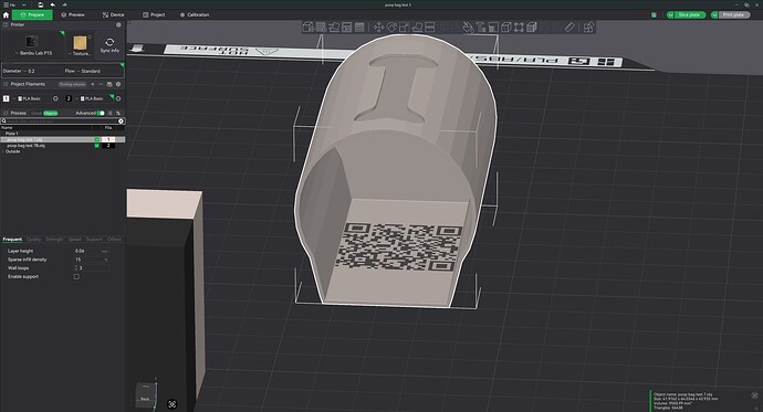

I am having some trouble slicing an image. I keep getting the same error “Conflicts of gcode paths have been found. Please separate the conflicted objects farther.” I have tried right clicking and chosing fix model but get the same result. Is this a glitch in the slicer?

This error is normally because two parts are touching, a part is under/inside another part or the prime tower is touching a part.

And you’re getting the “Conflicts of gcode paths have been found” error? Could you post a screen shot of the plate in Bambu Studio?

This error will also happen if two different objects are touching. You will need to “Merge” them together.
Select these two (the white and black parts), right click and select “Merge”
Wow Thanks, I’mpretty sure this worked. Ill circle back and update if the print is a success
Is there a way to make the black print 1st? It might work either way, testing now and it started laying white down first.

  1. Click on the “Plate settings”
  2. Select “Customize” in the “First layer filament sequence”
  3. Drag the colours around to the order you want.
This is with white first, going to try black first later. do you think it will fix this bleeding? Any tips to fix this before I try again?
It looks a bit like you might be getting normal mixing at borders between colors. If you look close in preview after slicing, how many lines get created in the small black single square details? Posting a screenshot of the first layer preview and your line width settings could help.
