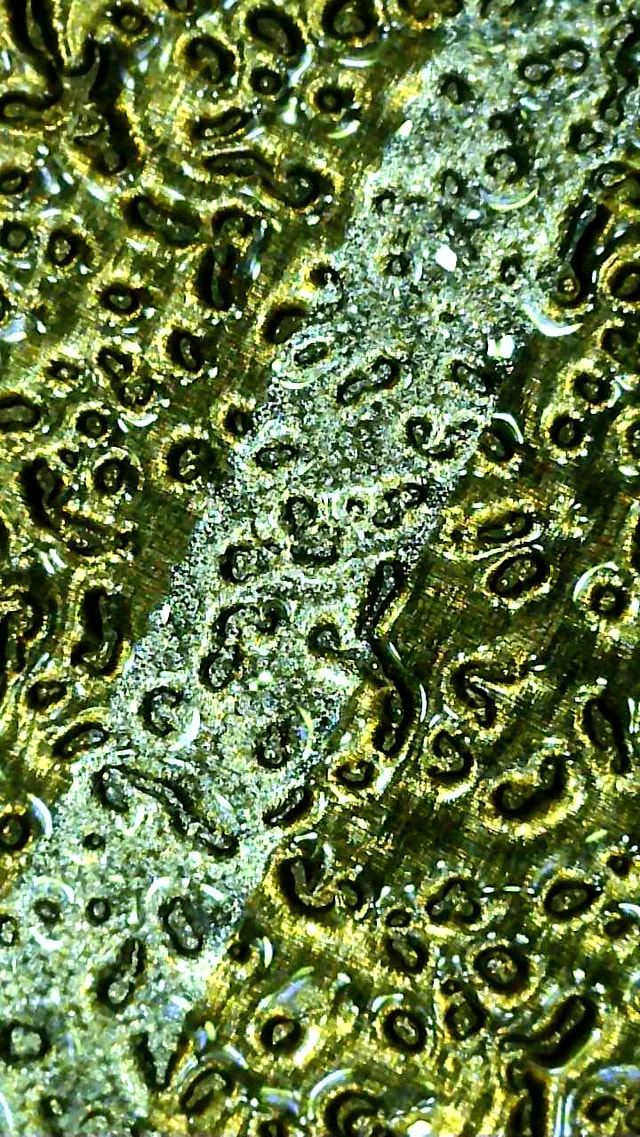

This is how Textured PEI looks like -
It has a lot of pits and that’s how it holds the material in it. Soft sponge rarely does it well as you want to get in there and dislodge whatever oil or residue is left on the plate.
The last step, when nothing else helps - take a scotch-brite pad or a sandpaper and lightly scuff the plate. Yes, scuff the plate, you’ve read it right. Sanding down the plate helps to “renew it”.

Sanding time. I still have the original textured PEI plate from 2023 that went through ■■■■. I used 400 grit pad on an oscillator and did a light pass - now it works much better than a brand new plate for X2D.
