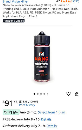

I use this Nano 3D glue stuff though. I use it on the textured, smooth, and engineer plates. @maxim3D got me going on this stuff, and I haven’t been able to look back. It works so well. It’s so easy to apply. I’ve used glue sticks and stuff in the past, and there’s just no comparison as far as ease of use and mess. I use cotton gloves when handling my plates. It’ll be dozens of prints between reapplication of the glue layer when using that nano glue. That’s what’s been working for me at least.

Maybe it’s because I am in Canada, but the glue is almost $100 on Amazon for me. It looks incredible, but that’s a bit costly.

The 50ml bottle lasts me about 2 or 3 months. For 20 USD that is pretty good
Yeah, it shouldn’t be 100! 20 USD is more correct, as mentioned. Which is a good deal. I think @CincinnatiDesigns is printing more than me! Mine has lasted me a little longer. I just picked up a third bottle in about a year’s time.
Maybe time isnt a good measurement for it.
A 50ml bottle is good for 30 to 40 applications and an application lasts 3 or 4 prints. (A lot of the time an application isnt covering the whole bed anyways)
This is what I found on Amazon Canada (Price in CAD)
About 33 USD. Showing as not available though.
Ohh I see I was looking at the 120ml!
