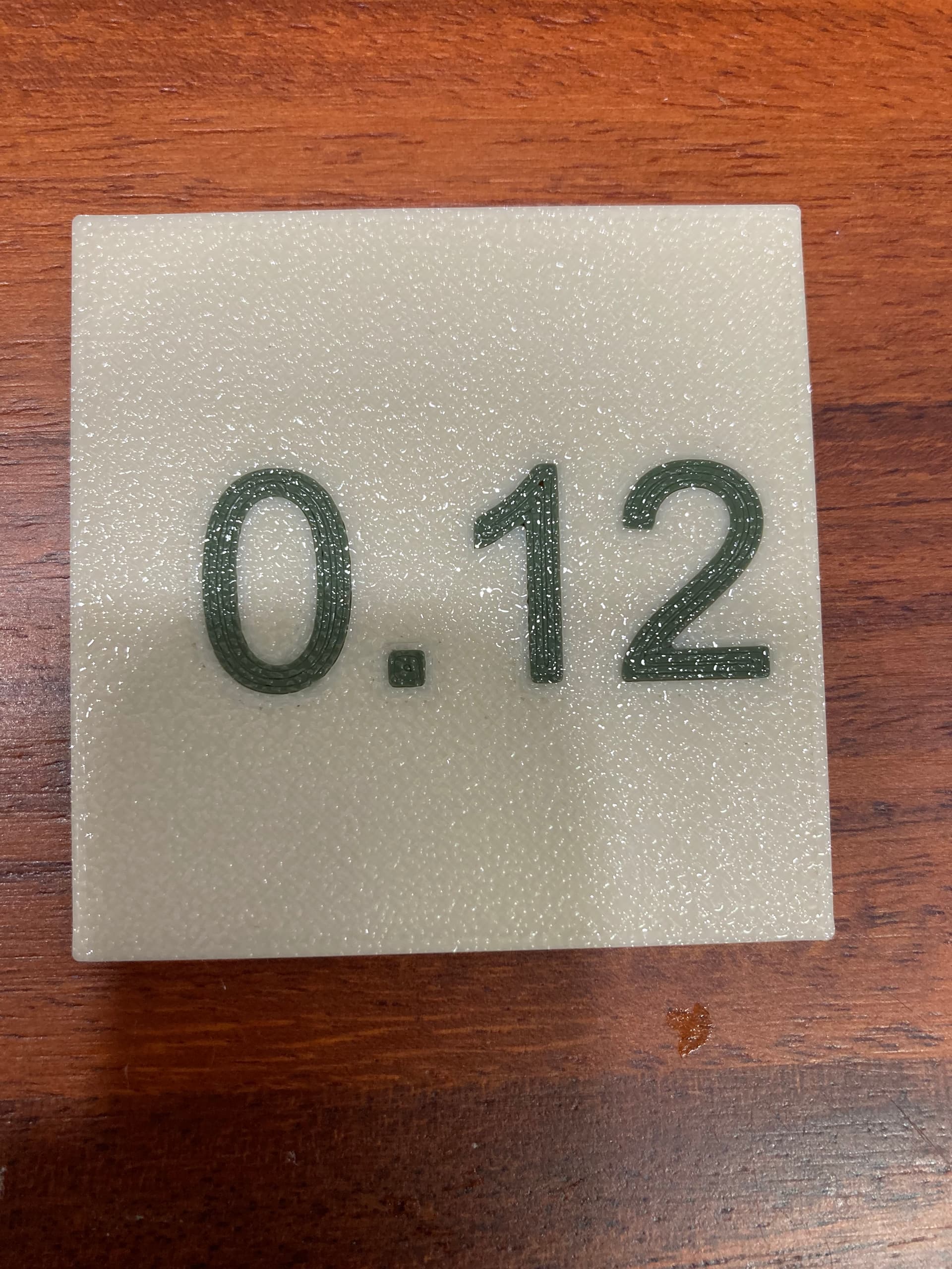

I’m printing PETG on my P2S with AMS. I have two of them. I’ve used both printers with PETG and PLA and cannot get my flush text to come out right. And the weird thing is… on one occasion it actually came out great (the 0.12 one). I’ve made a sale if I can get them done in the next day or so. All of them were printed with 1.2 layer height and everything else default. I’ve tried some ChatGPT advise which had me going down rabbit holes for hours with setting changes that did nothing. I’ve tried different colors to no avail. See all the little holes around the letters? Any help will be appreciated.
Looks like your Flow Dynamics calibration is off. Did you dry and calibrate the Filament?

Flow rate is not it what you want to adjust, flow dynamics is what controls the point the extruder stops extruding during a linear move. Also know as pressure advance.
IMO this is a Pressure Advance issue, not a flow issue. The printhead has to slow down to change direction. So extrusion has to be slowed down, too. But when the direction has changed and the printhead is accelerating again, the extrusion flow rate isn’t speeding up quickly enough and you end up with a small gap until the extruder catches up.
The calibration you want to do is the Pressure Advance calibration.

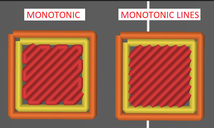

You can also set your bottom layers to monotonic, instead of monotonic line. I think it will help.

IMO I agree, the printed bottom shows flow dynamics / pressure advance problem. The automatic calibrations are sometimes not good enough, run the test yourself and plug in the value to the saved filament.
Everyone seems to agree on the manual cal. Maybe I’m doing it wrong, but when I ran it, the printer printed a bunch of lines and ask me to judge when one was best. And apparently the best translates to a number which is the k factor. My 80 year old eyes couldn’t tell the difference, so I sent it up to Chat GPT which gave me its opinion. At any rate, my problem is only worse. I’m dead in the water because good text is an important part of the product. I’ll keep trying, and thanks for all the responses.

the k factor is usually between 0.010 → 0.060 , the leading .0 is important for scale, its a small number. if you put a huge number like 1.0 it would explain flow problems. That number is measuring seconds
You could send a pic of the test here, and we could try to highlight our opinions.
That’d be wrong. That number might be OK for “Flow” but not for “Pressure Advance”.
That ^^^^
Yes. Here it is and thank you. But since I didn’t know what I was doing which led to entering a K factor that might have been way off, does this pic really help with my problem? Any how, here it is:
