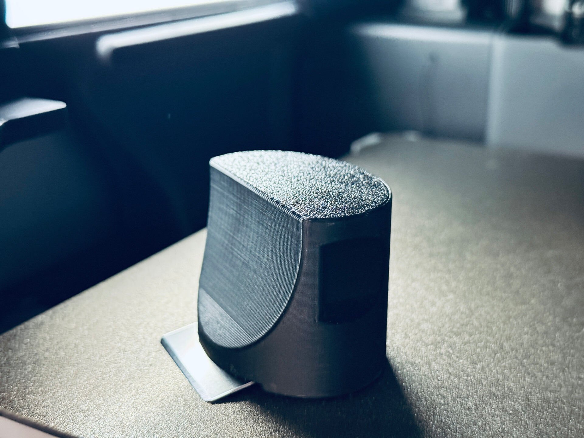

I don’t agree with this at all. I find the Bambu scraper blade works wonderfully when used with this holder and it’s near impossible to damage the bed with it.
@JonRaymond Yes, but that’s not the scraper Bambu tells you to print. :wink:
I haven’t seen that one before. Still, I’m not going to chance gouging a ~$40 plate with a metal blade of any type. But hey, that’s just me. I’m on a retirement income. :sunglasses:
Besides, no scraper is needed on a PEI plate except for maybe the calibration lines. A plastic scraper works for that too.
Thanks. I was using an actual razor blade and it was in a holder that forced me to have a steeper attack angle than I wanted.
I have a metal “3d printer” spatula on order from Amazon that I suspect will be a good middle-ground between “razor made at a bad angle” and “printed spatula that deforms before it can get the part off”
