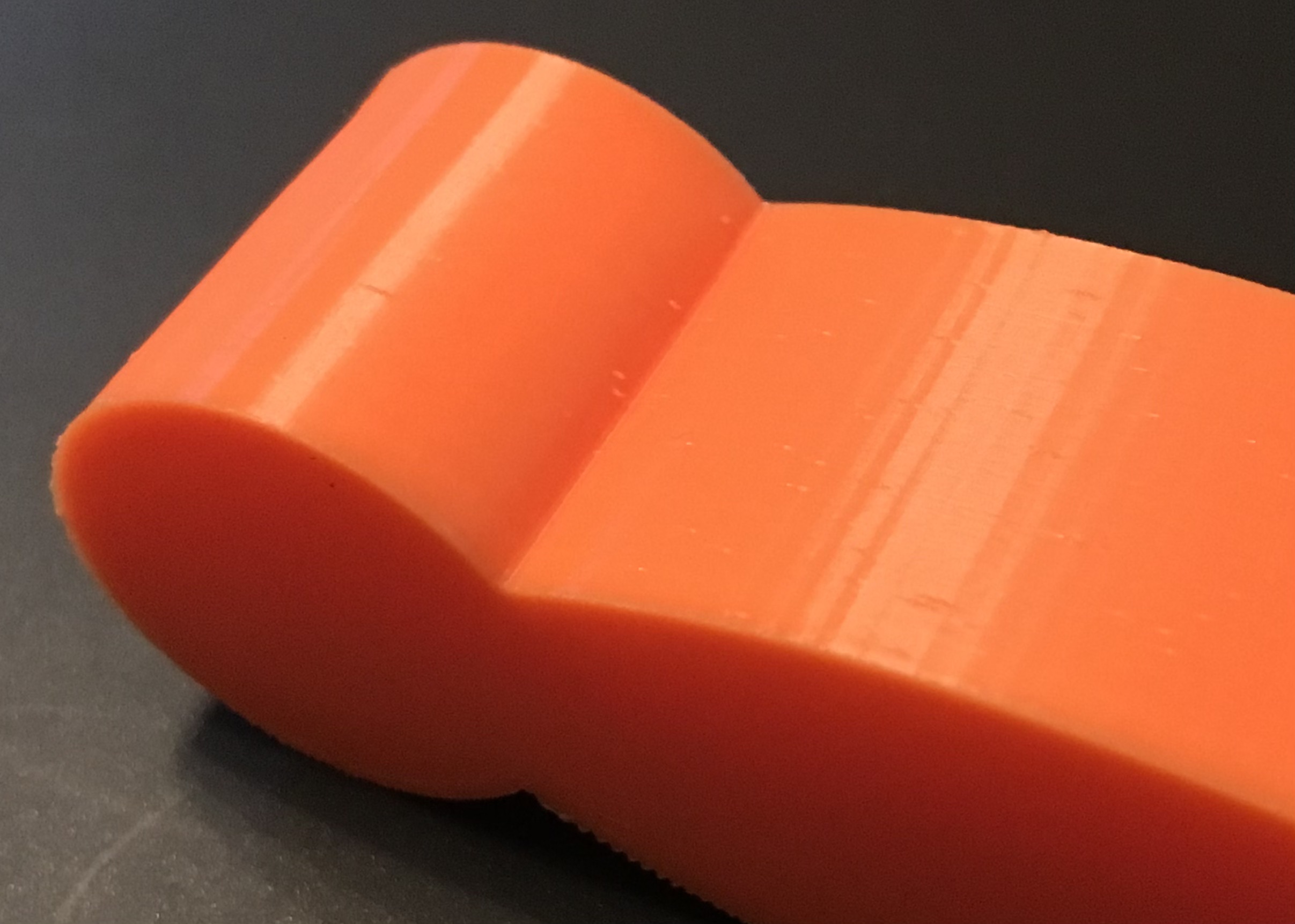

Grooves in the linear surfaces

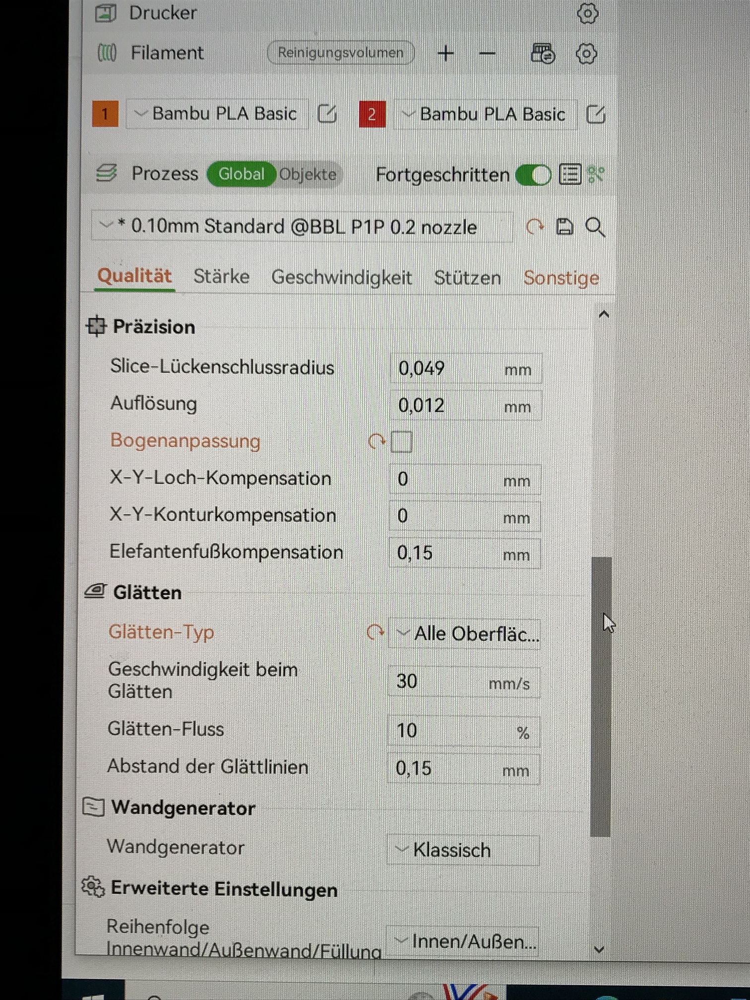

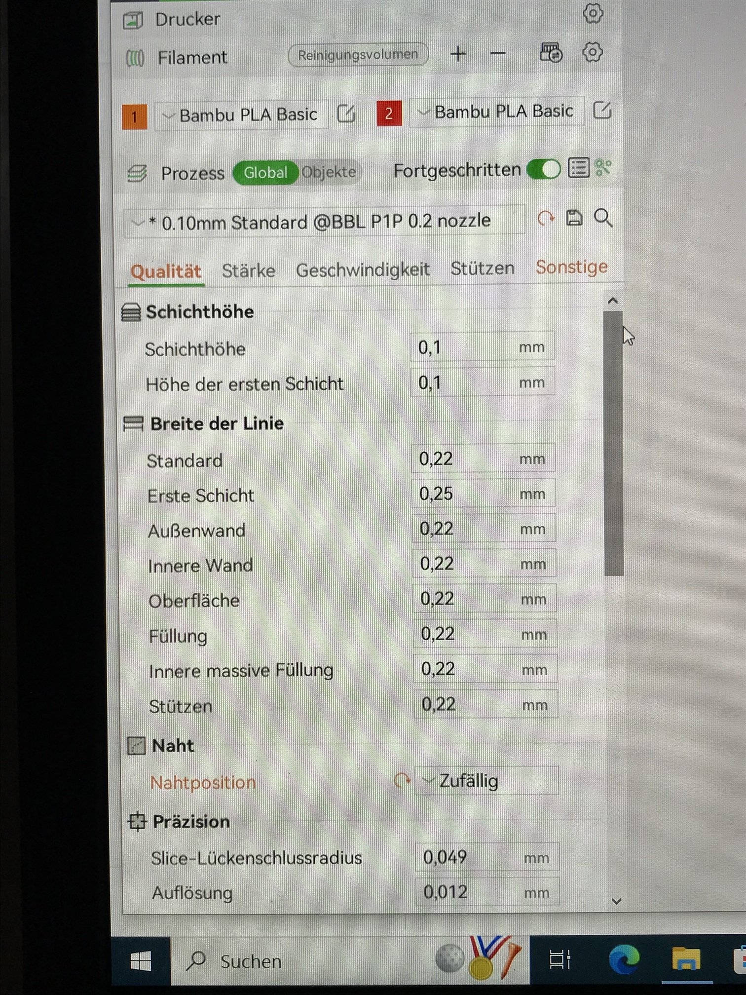

hi guys, i print this modell with P1P, 0.2Noz. Pei, with original values.
The direction of the model is parallel to the carbon rod.
In the German Bambu Forum it is said that this problem comes from the toothed belt and cannot be remedied. As far as I could find out, this does not apply to all P1P. The printer has been here for 3 weeks and I am not willing to accept the problem if it only occurs with some P1P.
And the longe grooves are possible to feel.

Hi, but this are not artefacts, I can feel it with my fingernails, an this are real small waves/ grooves. Some user in the german FB forum says the reason is the timebelt.

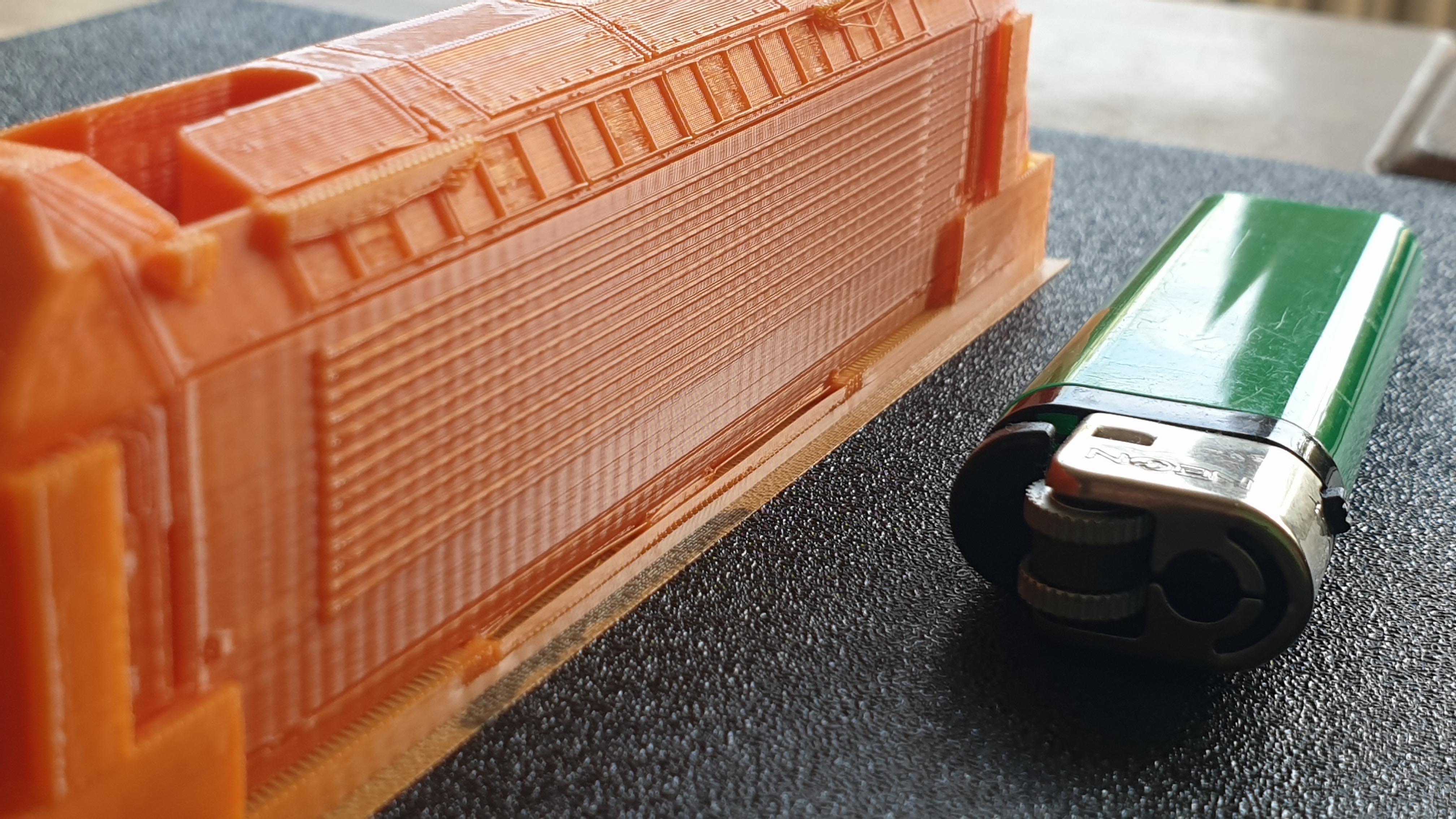

So I think I give up. Today a guy trigger me to print this objekt to compare his P1P print about the steps on the surface.
So I have still the same problem. What should I do to get a better result.

There are many things you can try. This is RINGING not VFA. So its the belts creating this pattern. VFA is way smaller and finer. Look on printables for a gantry squaring tool. Loose the belts. Push you gantry against the back or the front. See if one side is racking. If yes try carefully to align both sides through force. After that use the squaring tool and retension your belts. Do a calibration and go for 2000-3500 accel if you want to avoid this pattern.
