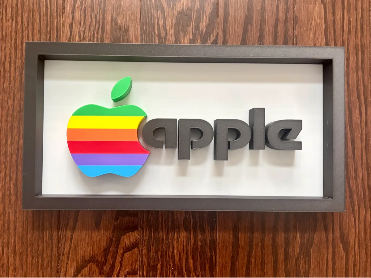

I printed the Starry Night vase that won the Vortek competition and it went great, 4500 filament changes. Also designed this to test the Vortek, printed great:
