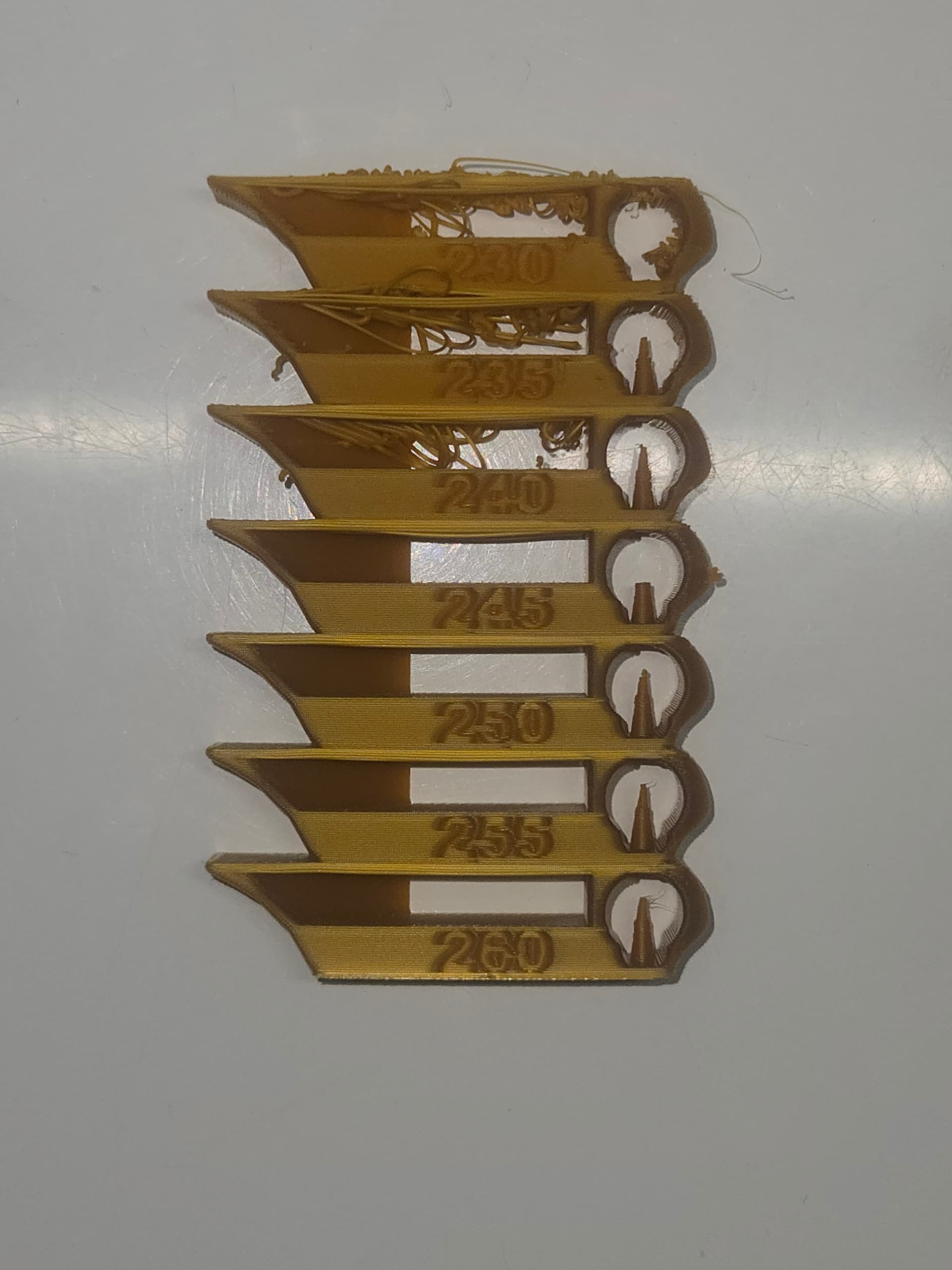

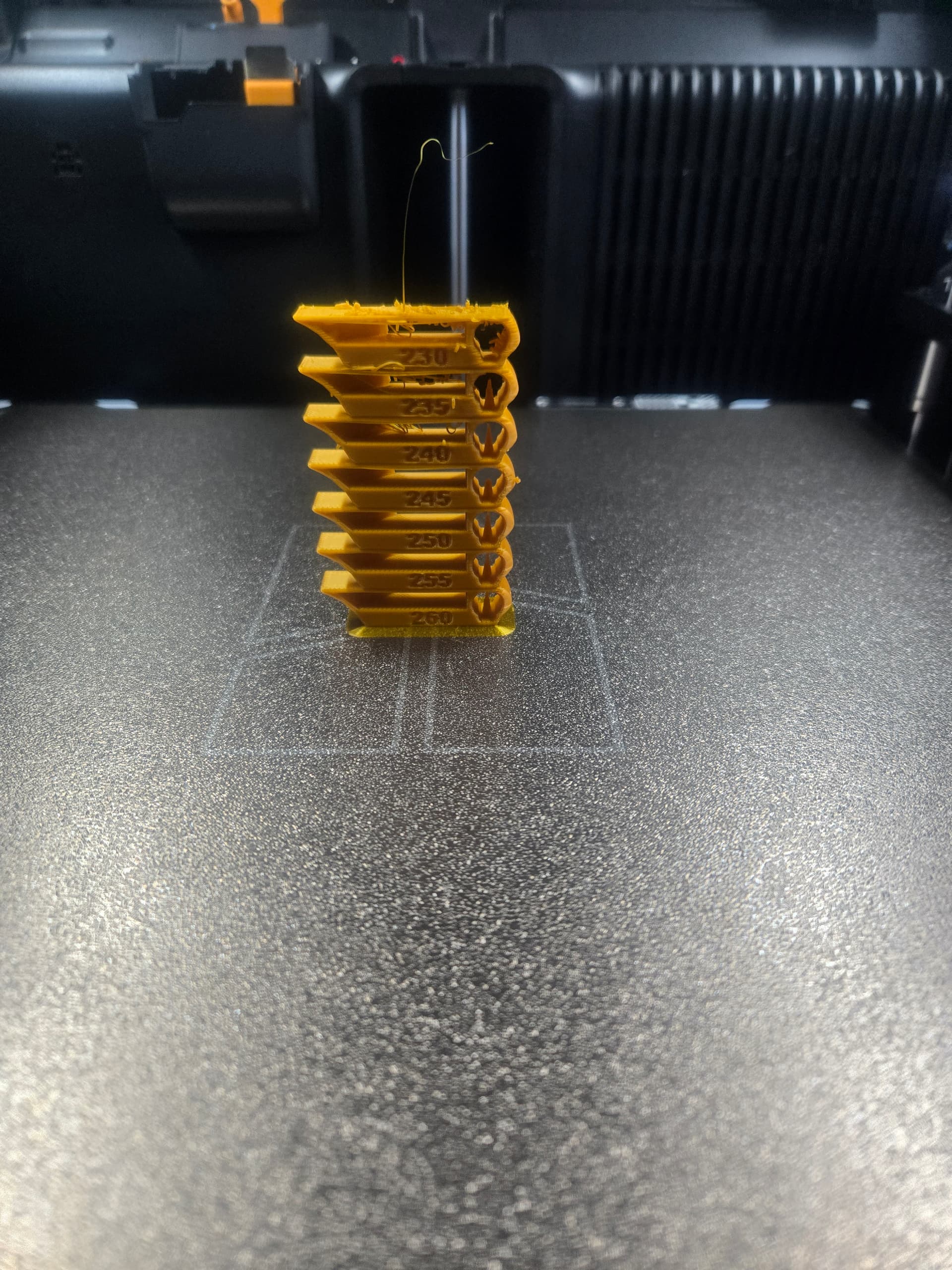

Test complete. The setup was as follows: PETG straight from the box, undried, into the AMS. The heat plate was cleaned as usual with generic glass cleaner. The Vortek nozzle was previously used with PLA, no cold pull. Then I simply selected the temperature tower to see how the filament would behave. Overture specifies 230-250 degrees. I set it to 230-260 degrees. As you can see, adhesion wasn’t a problem, but the filament needs at least 250 degrees, preferably more. I stopped at 230 degrees because only garbage was coming out. The heat plate was at 70 degrees. Perhaps the temperature was your problem, or your heat plate, or the cleaning. Glass cleaner works great on my printers.

I recently repeated my test using all the default generic PETG settings and changed only the speed. The print was successful.
I believe your finding about temperature alone and my test involving speed alone lead to very similar results. The main difference between our prints was model height: mine was about 60 mm tall, and in my case speed proved to be the decisive factor.
Thank you again. Clearly, this is about respecting Overture’s material parameters (not only Gold — I had similar issues with an Overture Grey filament). I have used many other brands from various vendors without problems, so I will simply be more cautious when using Overture.
The temp tower is also 60mm, and as you can see in the pictures, you dont have to take the overture settings, thos needs more temperature, 260-265 degrees, and with higher temp you can use higher speed. I alway do temp towers with non bambu filament to check how it reacts. And the overture surprised me, because their recommended settings didn’t work.

After lowering only the speed to the required values, I achieved a perfect result.
Stringing during fast extruder moves was ruining the model—starting from the support trees and continuing up to the first layer and/or beyond 10+ mm, always tearing my prints off entirely. All of this clearly indicated the need to slow down (or use glue, which I tried, with only minor improvement).
If slowing down had produced only partial improvement, I would have proceeded with temperature adjustments. However, based on how my prints behave, I tend to avoid Overture filaments altogether; they appear to be designed for the era of slower printers.
The issue is not about combining speed experiments with your valuable temperature research. It is about using Overture alongside other filaments in the AMS (none of them are Bambu-branded—just a mix of random brands ranging from very cheap to budget). Because of this, I will keep the few Overture spools I have for H2S or H2C single-color printing only, which happens very rarely for me now.

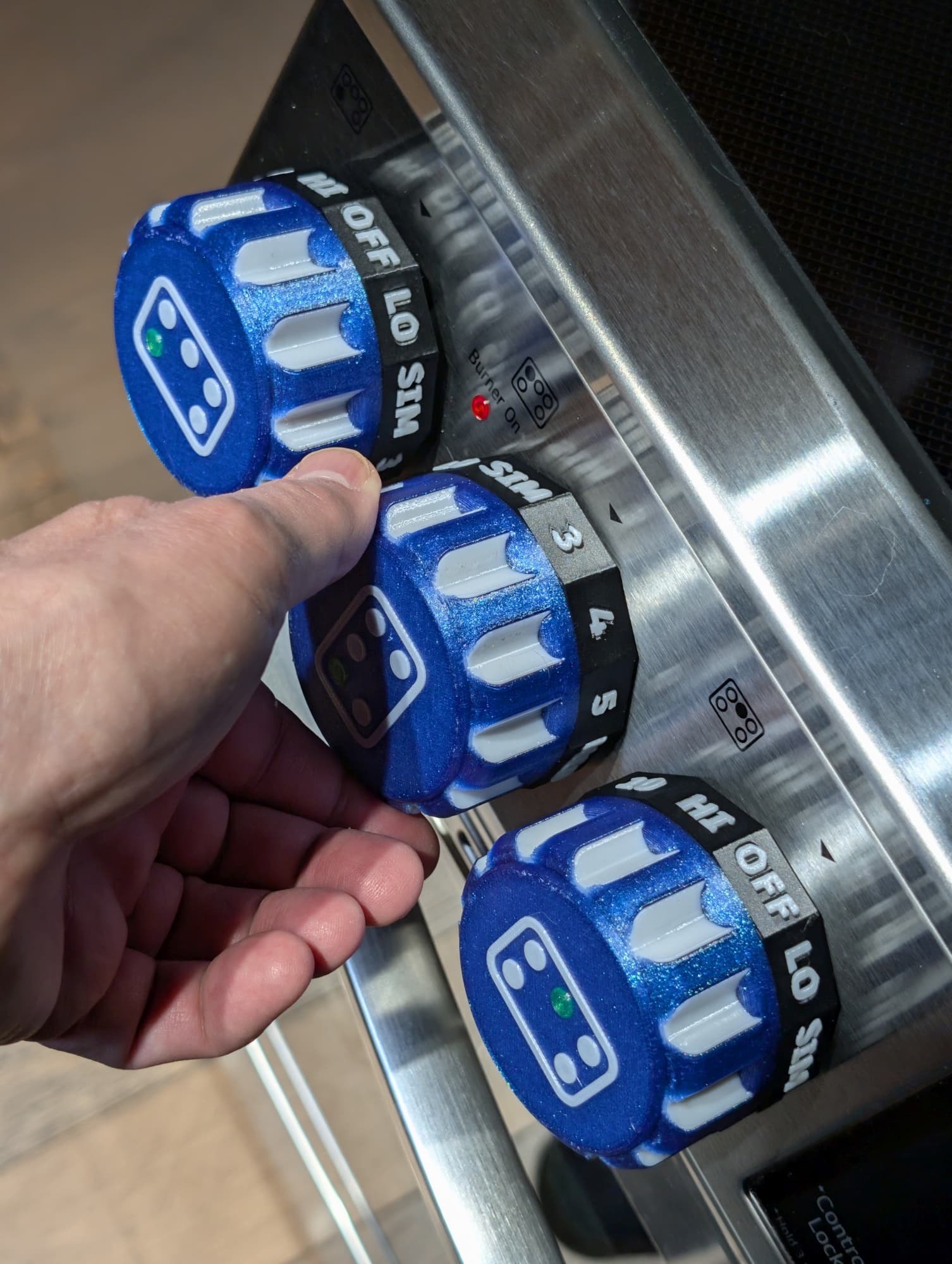

I’m new to multicolor printing, and surprised how easy it is to assign colors in the slicer. I’m also surprised at the quality of the prints. So far, perfect.
I’m curious, was that PLA or Petg? They look great BTW
PETG FTW! Thanks! I don’t print anything with PLA. I designed these knobs around the inserts from the original knobs- they snap off so the prints can be put into a dishwasher, then snapped back onto the inserts. PLA would not survive in a dishwasher.
