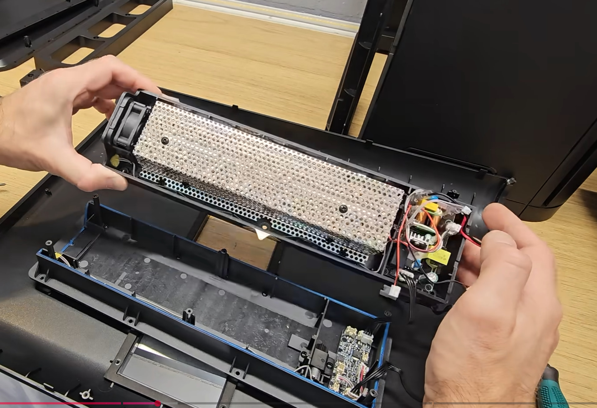

Basically i am trying to figure out if i can store “loaded” filaments like PA6, PA12, PPC, PPS, Plycarb, ASA at 10% humidity provided by tons of desiccant or if i have to keep them vacuum sealed? Granted they were heat dried at some point first.
I have Sunlu cabinet on pre-order, which should keep inside at 10% humidity, i am wondering if i can just store moisture sensitive filaments loaded into AMS inside of that (yes, i’d have to drill a hole).
