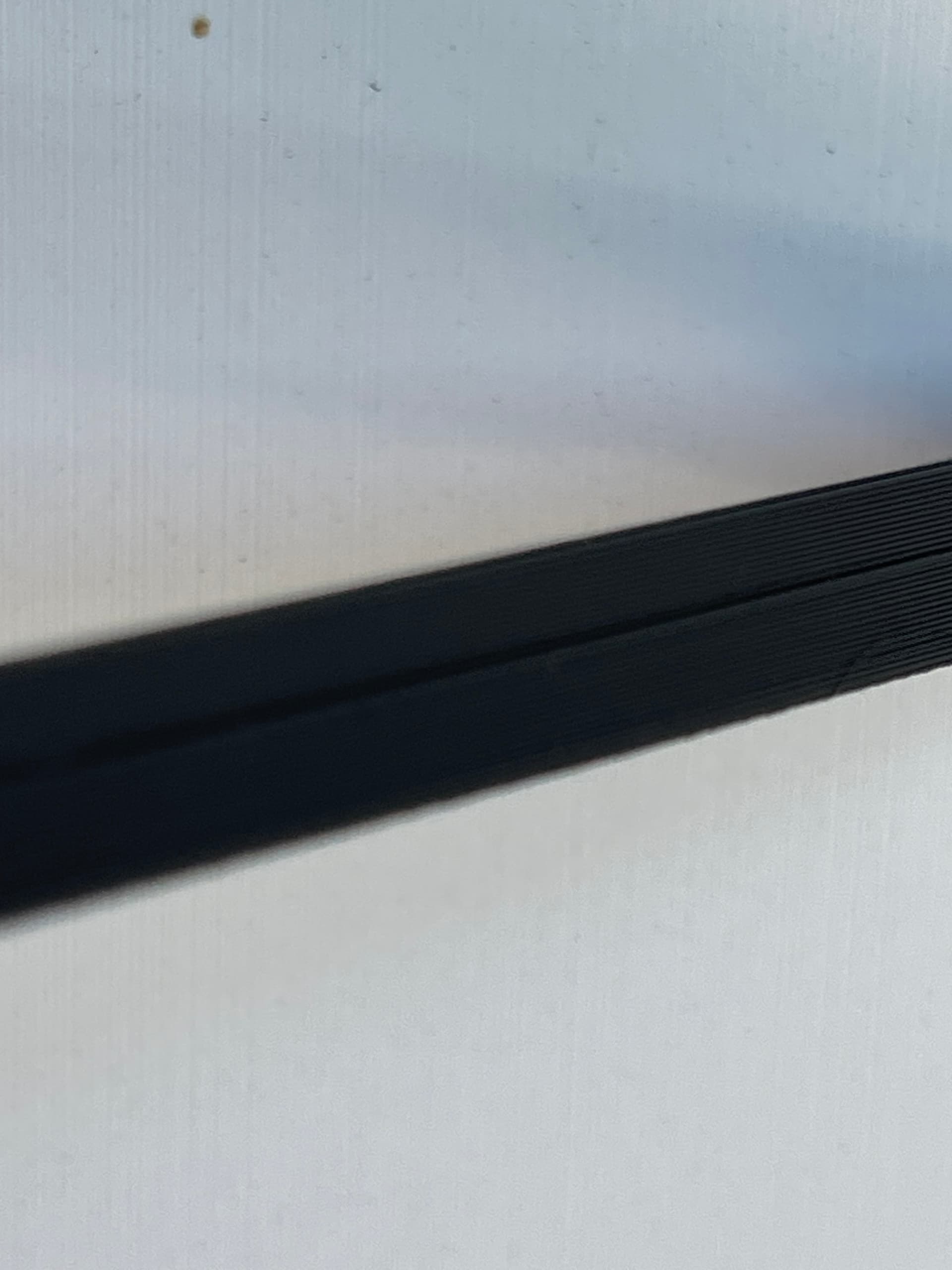

I also posted this information in the Z band thread, but since that thread is so long, it might get overlooked so I wanted to share it here as well.
The filament I used for testing was eSun Pro PLA black @ 215c FYI.
Bambu filament fan settings you can see lines and also feel the big middle line with your fingernail. I was trying to capture the photo to highlight the big lip.
I adjusted the fan settings on this test part to eliminate the big 0.2 mm wall band that appeared in the middle. The wall thickness was scaled down from 10 mm to 4.40 mm and then to 2 mm, which caused the plastic to cool at different rates the infill was 15% rectillinear so the wall looks smooth and great now.
The lower fan settings I used in this test aren’t a universal solution for PLA or other prints, but they offer alternative cooling strategies that are worth exploring when working with PLA filament and various part designs.

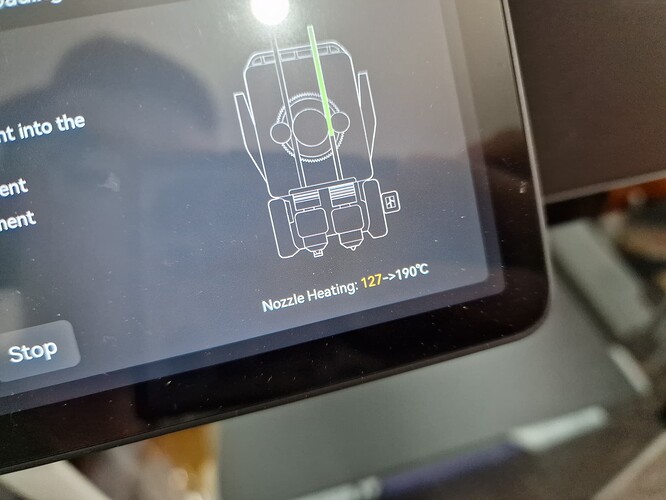

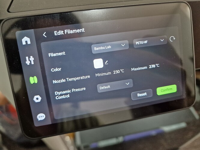

Hi all, I ran into a strange problem with my H2D on the latest firmware (08). Though the printer prints well, it seems that when loading/unloading filament, the printer uses the minimum temperature of the filament previously loaded into the printer as opposed to the normal printing temperature, and on some filaments (the problematic filament for me is the support for PLA/PETG), the low temperature creates too much resistance for the extruder to melt the filament already in the nozzle. In this case the extruder makes clicking sounds and nothing is extruded. In one instance this happened during the preparation stage of a long print, and I was shown the dreaded ā€˜extruder overloaded’ error.
For example, if my last filament is Support for PLA/PETG, with a minimum temperature of 190, I can try loading another filament, and the printer will then only heat up the nozzle to 190 degrees before trying to extrude and purge. A lot of times, 190 degrees is not hot enough to allow for Support for PLA/PETG to extrude, so the extruder clicks and the loading process fails.
I initially suspected maybe the left nozzle (which this problem occured on initally) slightly colder than the thermistor reading, but after cross checking the filament with the right nozzle (and an A1 mini for good measure), I found that none of them were able to reliably extrude Support for PLA/PETG reliably at the minimum 190 degree temperature. Raising the temperature by as little as 5 degrees sometimes allows it to extrude.
The loading & purging routine on the A1 in my experience will always raise the nozzle temperature to 250 degrees even for relatively low temperatures such as PLA or Support for PLA/PETG, so there was never a problem like this.
Has anyone else experienced this issue? In my opinion Bambu Lab should probably increase the filament loading/unloading/purging temperature from the minimum temperature to the normal printing temperature, or even the maximum temperature (like the A1), which would be more reliable.
I’ve attached some photos to show the printer attempting to load PETG HF (230 degrees minimum temperature) while only heating thr nozzle to 190 degrees due to the previous filament being Support for PLA/PETG.

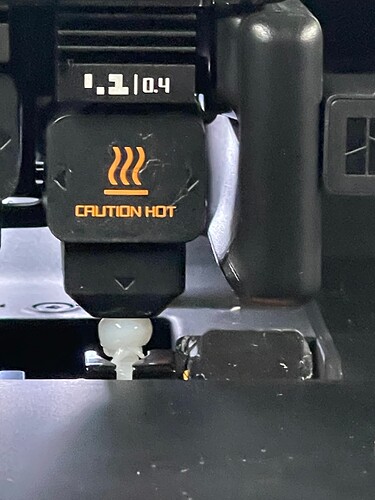

I only saw it use the maximum temp. The only reason I know this is because it keeps foaming my TPU at 250c even though the filament profile says to print at 190c. It seems to take whatever the maximum value is for the filament based on the AMS configuration. At least that is how it behaved for me with TPU on an external spool.
I never did figure out a good solution to prevent the printer from foaming a bunch of TPU in the nozzle when ā€˜changing filament’ which it doesn’t actually need to do since the filament was never switched out.

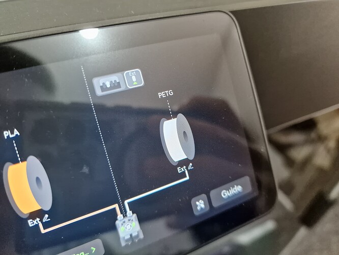

Glad I saw your post, I just realised I have the same problem with PVA. I’musing left nozzle to print PLA and right to print PVA support, and when that starts heating up to do the interface layer, its ramping up to 250C and spending ages cleaning and homing and whatever… meanwhile it’s burning the PVA in the hotend. When it comes time a minute or more later to extrude, its jammed and I hear extruder clicking and ā€œextruder overloadā€ error pops up.
Then go through manually clearing it, and the blockages is a burnt yellow, and because it’s PVA it also swells up which jams it up harder.
I can’t figure out why it goes to 250C when I’ve set upper limit on the PVA filament to 230C, Maybe I’m not seeing some extra setting? Also, not sure why it lingers so long either, I expected the filament (already loaded) to ramp up to 230C, immediately start flushing about a cm or two, wipe, and get straight to printing. Is my expectation faulty?
It’s spending ages to clean and homing because you have demp pva. demp pva easily jams any motors and gears. it’s not because of temp, it’s just what it is…
Also demp pva makes it impossible to do pressure advance (K value) test. So the sensor can never get a usable value from it. So it just repeats and eventually get wrecked.
Support claims it’s a known issue. They plan to correct in the next update, and until then they recommend removing the plastic cover over the nozzles (extruder cover).
