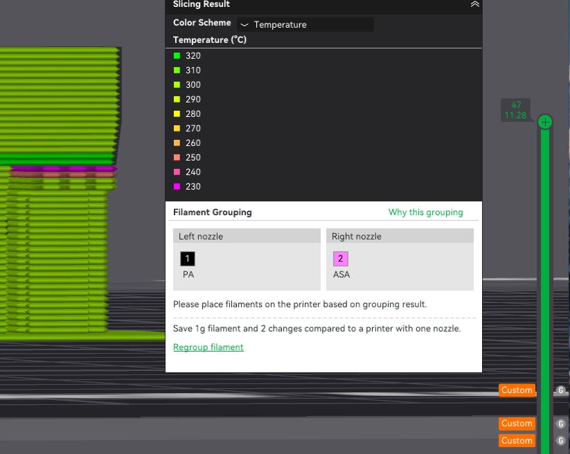

I’ve done this with my X1C, but since the H2D has two nozzles, you need to include the tool head in the G-code.
This is a sample photo. To change the temperature at a specific layer, right-click on the right slider bar at the desired layer and select 'Add Custom G-code set your nozzle specifications for the left, right, or both nozzles as needed.
M104 T0 S230 ; Set Right Nozzle (T0) to 230c
M104 T1 S320 ; Set Left Nozzle (T1) to 320c
M104 T1 S300 ; Set Left Nozzle (T1) to 300c
The support interface temperature was set to 250°C in the filament settings for the sample photo. To use high-temperature support filament, a high-temp material type (ASA) must be selected until the slicer includes an option for HT-PVA or HT-BA
The PA was temperature was configured to 300c in the filament settings for the sample photo.
