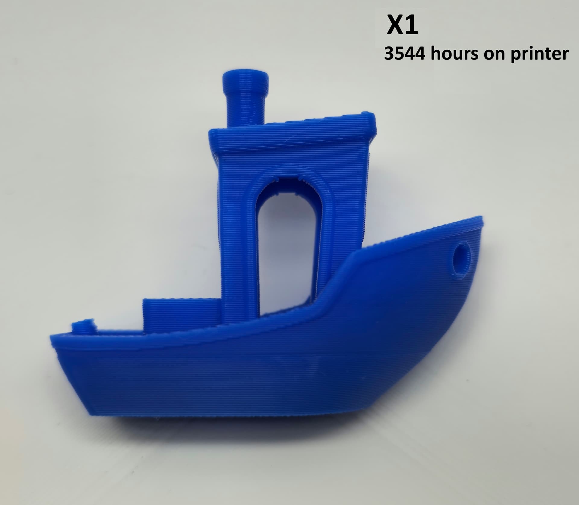

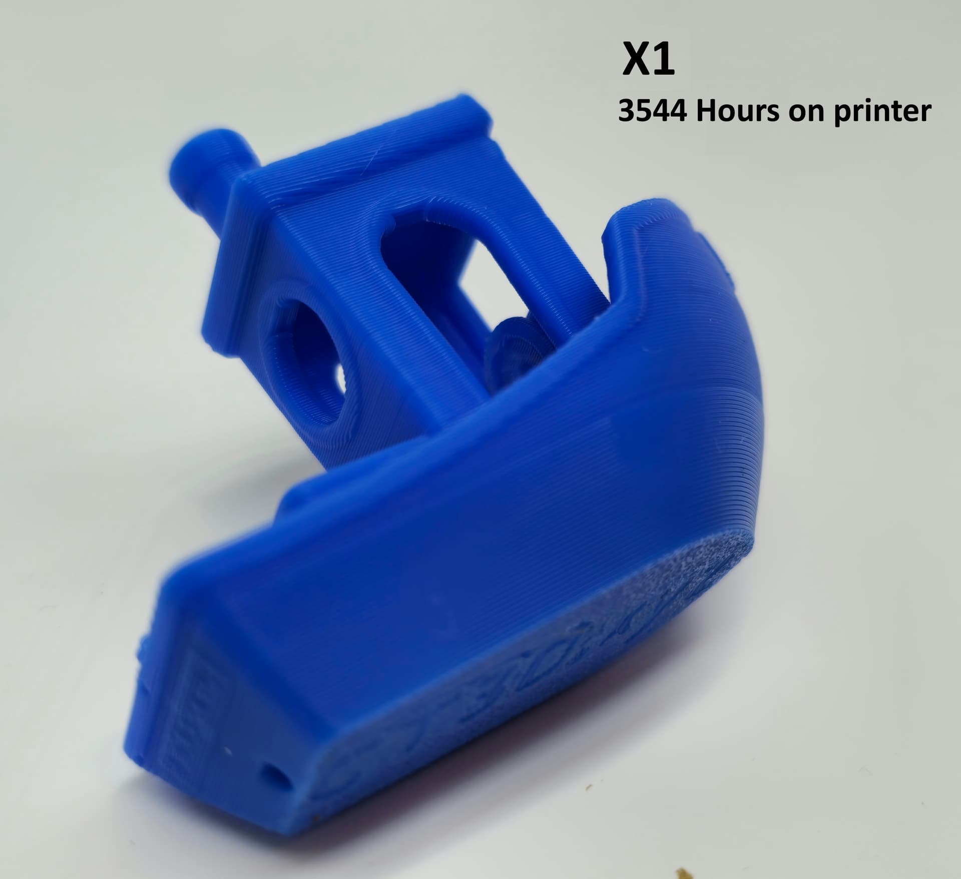

Can you post comparative prints on the same material between two printers? i.e. benchy from one and another.

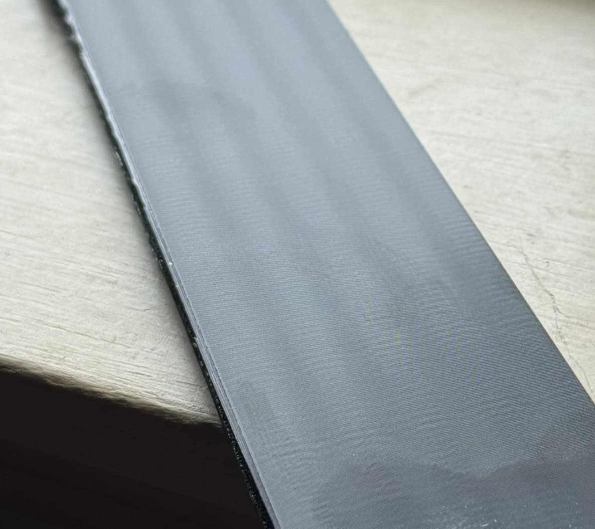

I’m actually finding this is my worse Bambu for VFAs. The two P1S’s I had, were stacking layers like champs. This is the first Bambu printer I actually noticed VFA’s on. Its not bad, but they are there. But oddly, they aren’t super consistent across the print for me. I’ll see a band or swath in the middle of a face where it fades to nothing later. A little odd, but honestly the magnitude is very low. Not sure I would have noticed them if the lighting wasn’t so good :laughing:. My guess is it might be related to a specific stepper speed. But again the magnitude is so low that I’m not going to put a lot of time in to it.
Can you do a small test and print a tall vertical wall with black or dark colored PETG positioned along the X-axis?
Or if you want, I can prep a file for you to print.
Some people are saying something about VFA, yet nobody posted a single picture of that.

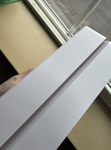

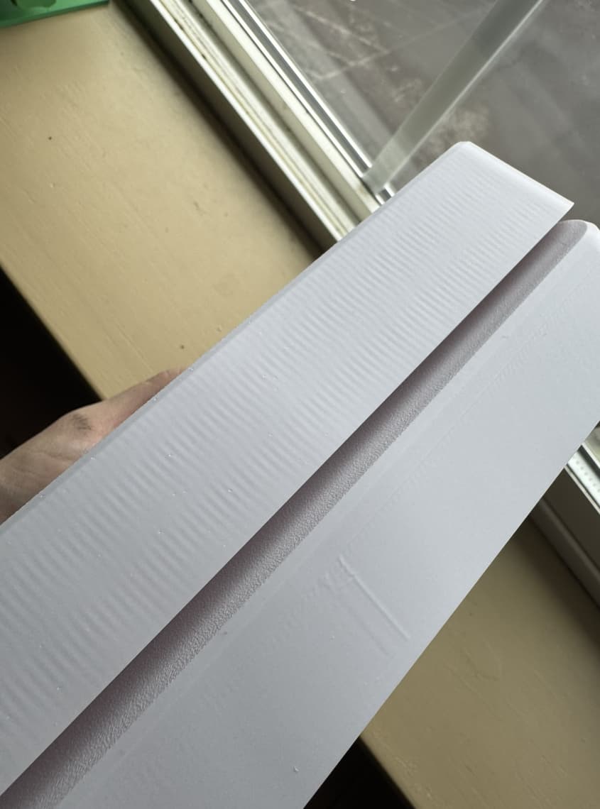

I’ve been printing trays in white PETG-HF, and on there, there’s been a noticeable difference.
Thank you! Appreciate the help trying to figure it out. It’s only 30g of material.
X-VFA Test.3mf (28.4 KB)
I’ll post up once I get it printed.
I’ve got some PETG-HF and PETG Basic in black. Both Bambu. I’m gonna try the PETG-Basic, but I’m not 100% sure the condition, so we’ll see!

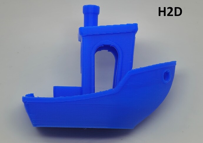

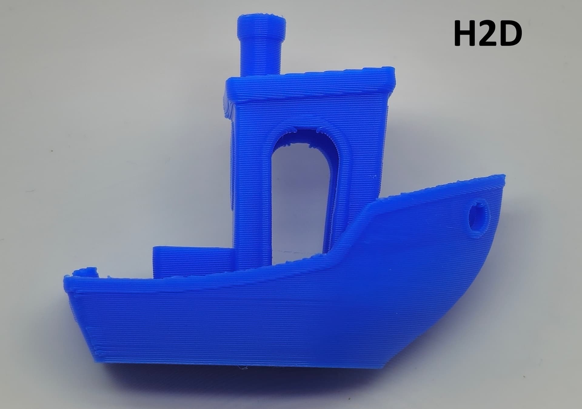

Same Sunlu PLA blue with the same print profile.
I’m curious how this will look with some of my models that are prone to VFAs. Those white trays, it was more or less gone it felt. Although not perfect. Partly from it being white and a little matte, I’m sure.

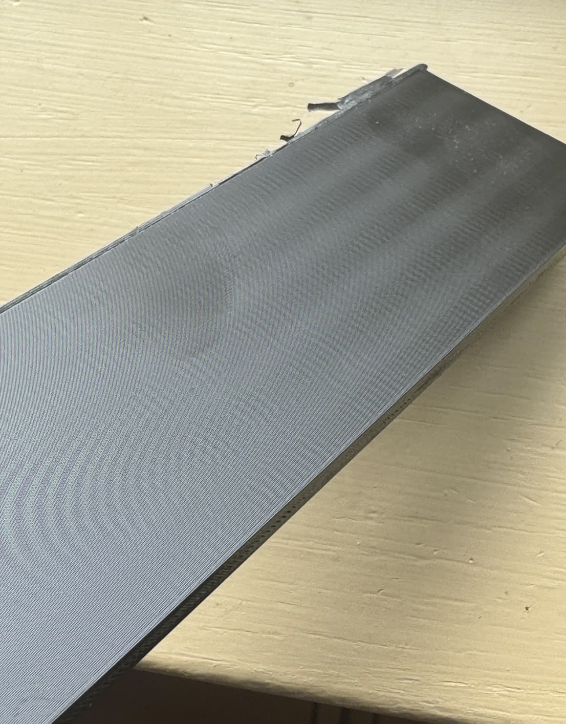

With this black PETG, it’s more noticeable. I’m not sure how it’d compare to the X1 doing the same print. It’s hard to get a good photo of. There’s regular bands and those bands have the wave. It’s easier to see in person.
Welp, that’s what I was talking about. Those look exactly like 2mm VFA from X and P printers.
Can you measure the pitch between ripples? It should be 1.5mm, right?
And yes, of course it’s worse with X1, since the stepping is 2mm and will be bigger. But we all knew about those VFAs…
@StreetSports and @Kenny89 , you were so sure that 1.5mm resolves all the issues. What would be the consensus?
ive never said anything about pitch size. the thing you see here looks like top bottom images… i can also tell that the first layer looks burnt and crappy. no idea what he did or how he sliced the model and what kind of calibrations he did, but imo top layers wouldnt show vfa it would show over or underextrusion
You know, I’m right here, you can say my name instead of talk about me like I’m not in the room.
It was from the brim. I ripped the model off the build plate, but the brim didn’t want to go.
ahhh i seee the brim now makes sense. Sorry ill mention you next time as i was replying to him, wasnt meant to be rude
