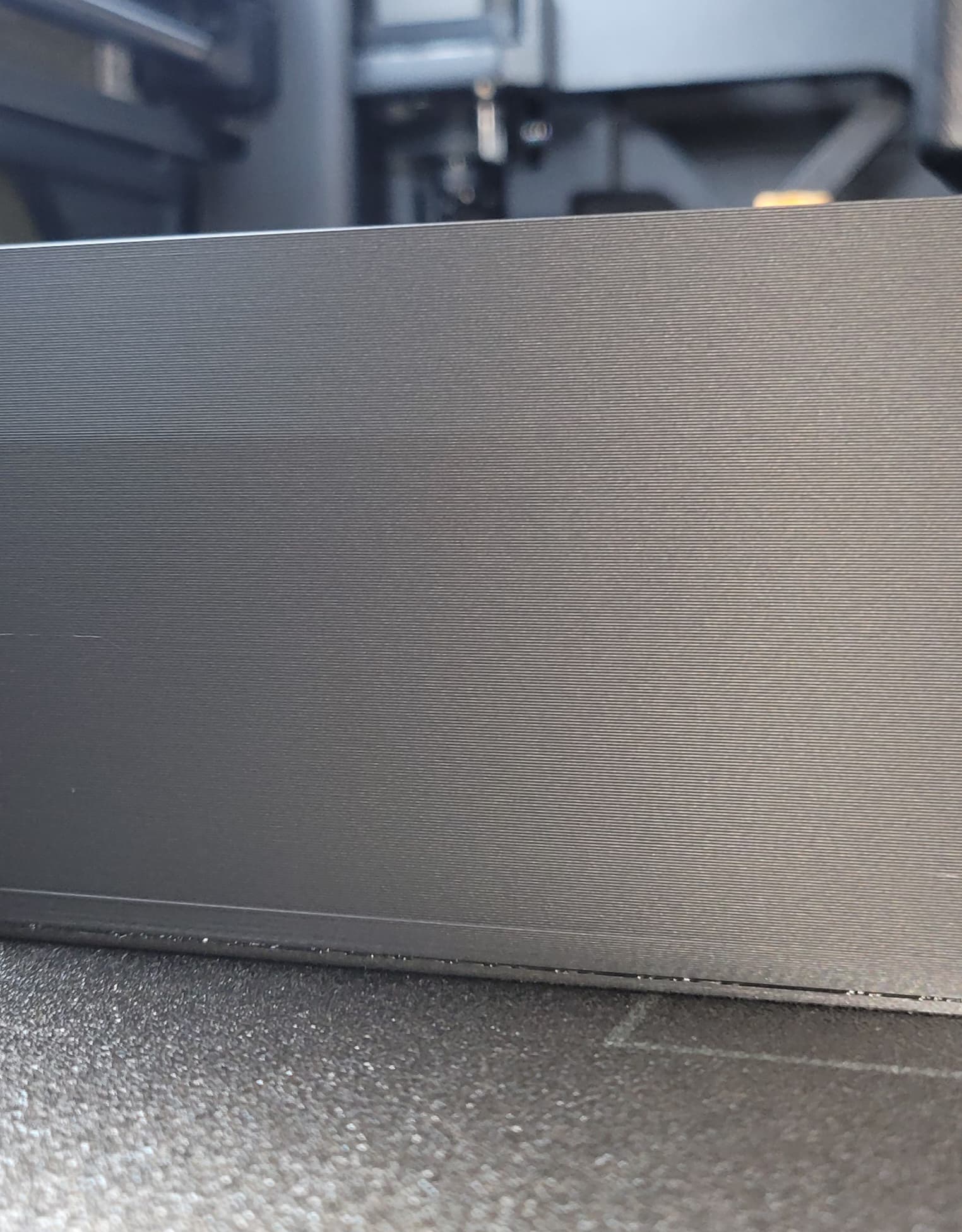

What directionality are the artifacts most prevalent? I’m not sure its as simple as a the pitch or thickness of belt. I’m finding them on some tall flat surface but not on others.
For example, this is flat to the Y Axis and the layers are effectively perfect (approximately 70m tall).
But I had a print with a curved vertical face that had them.

No, they are not, since they can be observed on a straight line prints and a perfectly aligned with a belt tooth pitch. And only on one axis (X)
Correct, CNC Kitchen pointed them out in his review. I think they’re PC. Definitely not as nice as the glass ones, but I guess that’s just a tradeoff of having a laser.
It’s happening only on X-axis, where the belt for X-axis movement is. See the 3MF file I’ve uploaded above. You can also print it out and see the results. VFAs are more visible on a glossy dark filaments (i.e. Black PETG). But can be seen on pretty much anything.

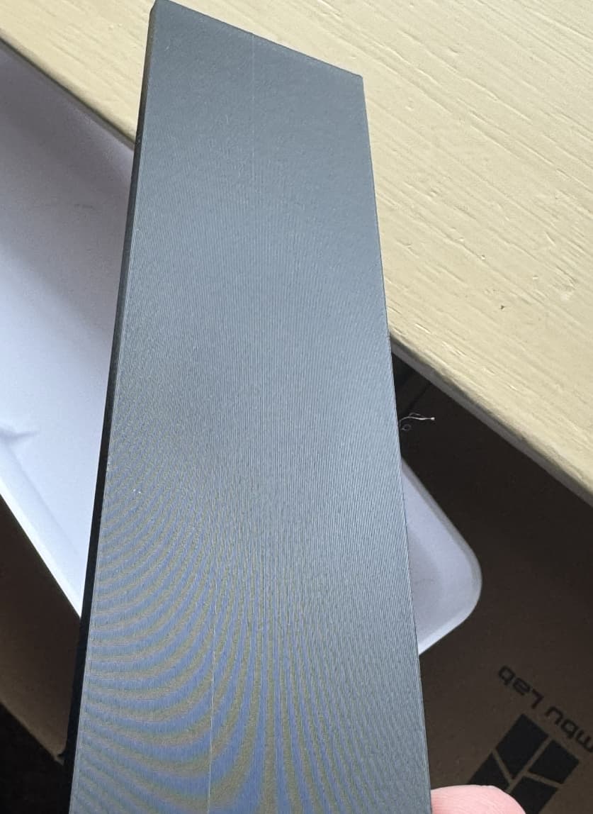

Here’s that test again, with PETF-HF. I used my typical settings too, which are mostly stock, but I also use an outer wall speed of 100mm/s.

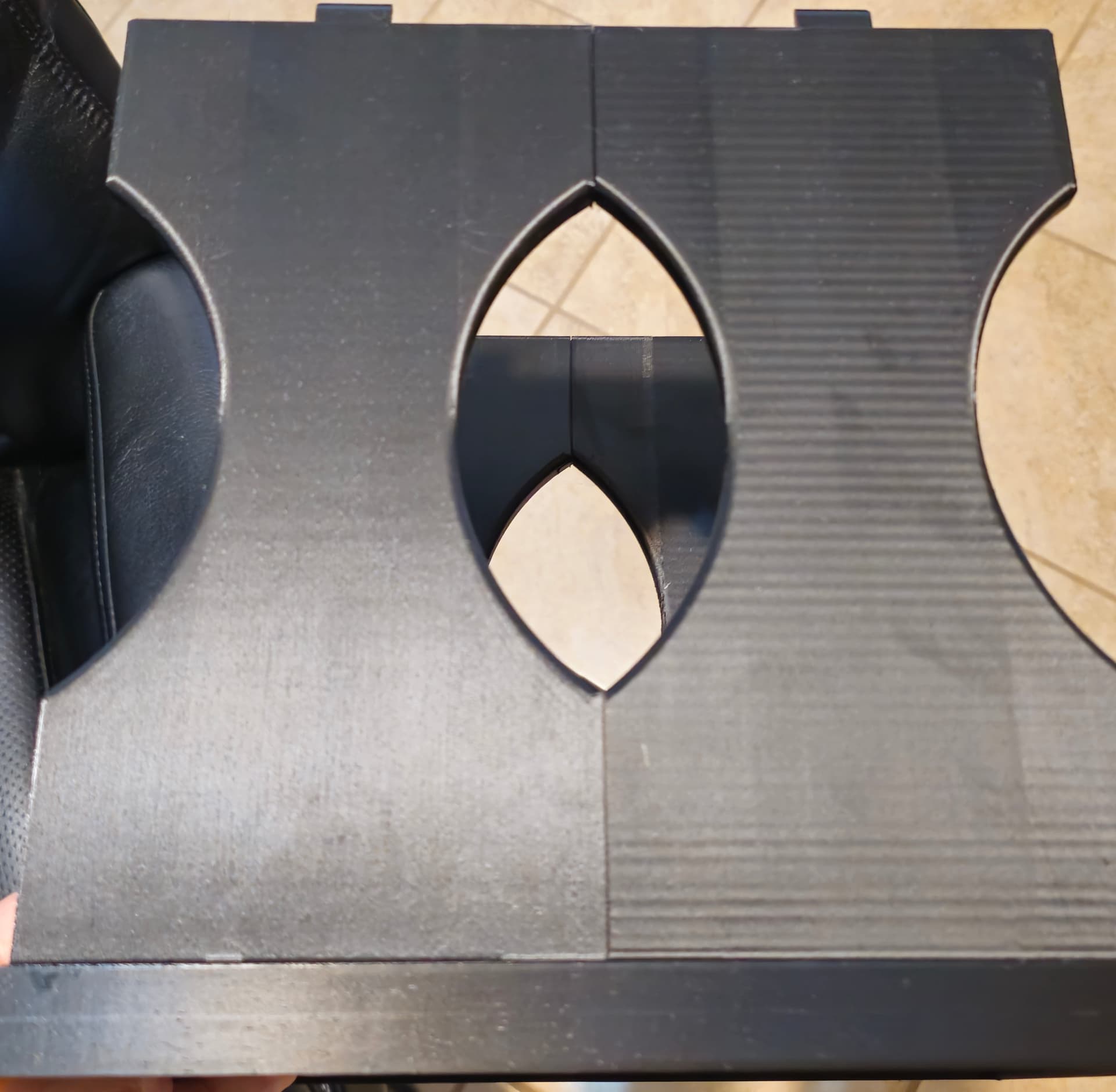

Same orientation, same PETG filament. The right is X1C and the Left is H2D both printed in Sport mode.
For clarification, this is a stand for my creality filament dryer so it will sit in the corner. Because its not going to be seen, I printed them on purpose to show VFA on the X1C vs the H2D. Both diagonally across the build plate.
