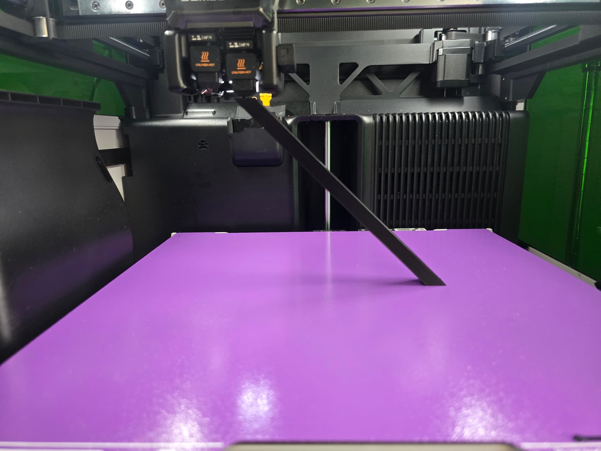

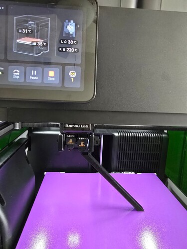

So I lied, I decided to do a test with pla after all.
ESun PLA+, plate 35*c
The part was pretty easy to remove(at 35c without cooling) but it finished just fine. I would probably print at 40-45c for a little more grip with smaller stuff. The bottom finish is a glossy texture, if that makes sense.

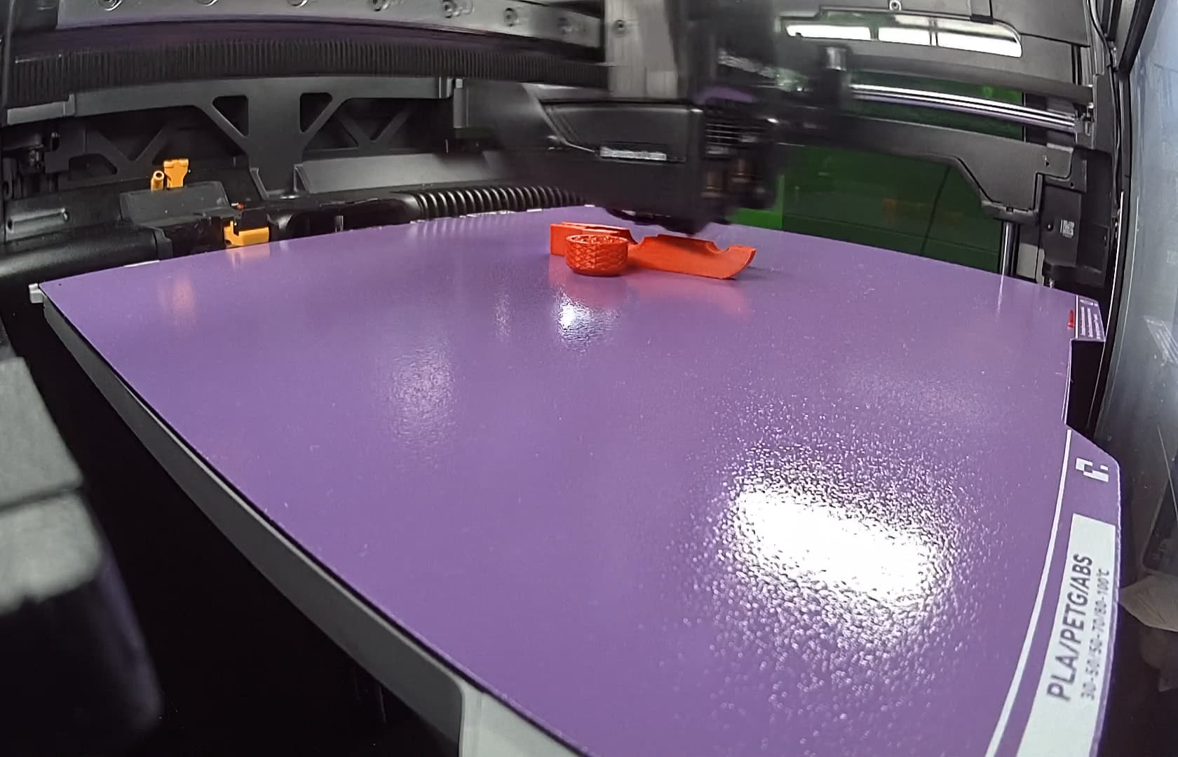

This is generic petg, the bed is currently at 60c. This isn’t any special test, just some tarp clamp that I’m going to use this weekend. When it’s done I’ll try to time it where I can see what the grip is like before it cools down

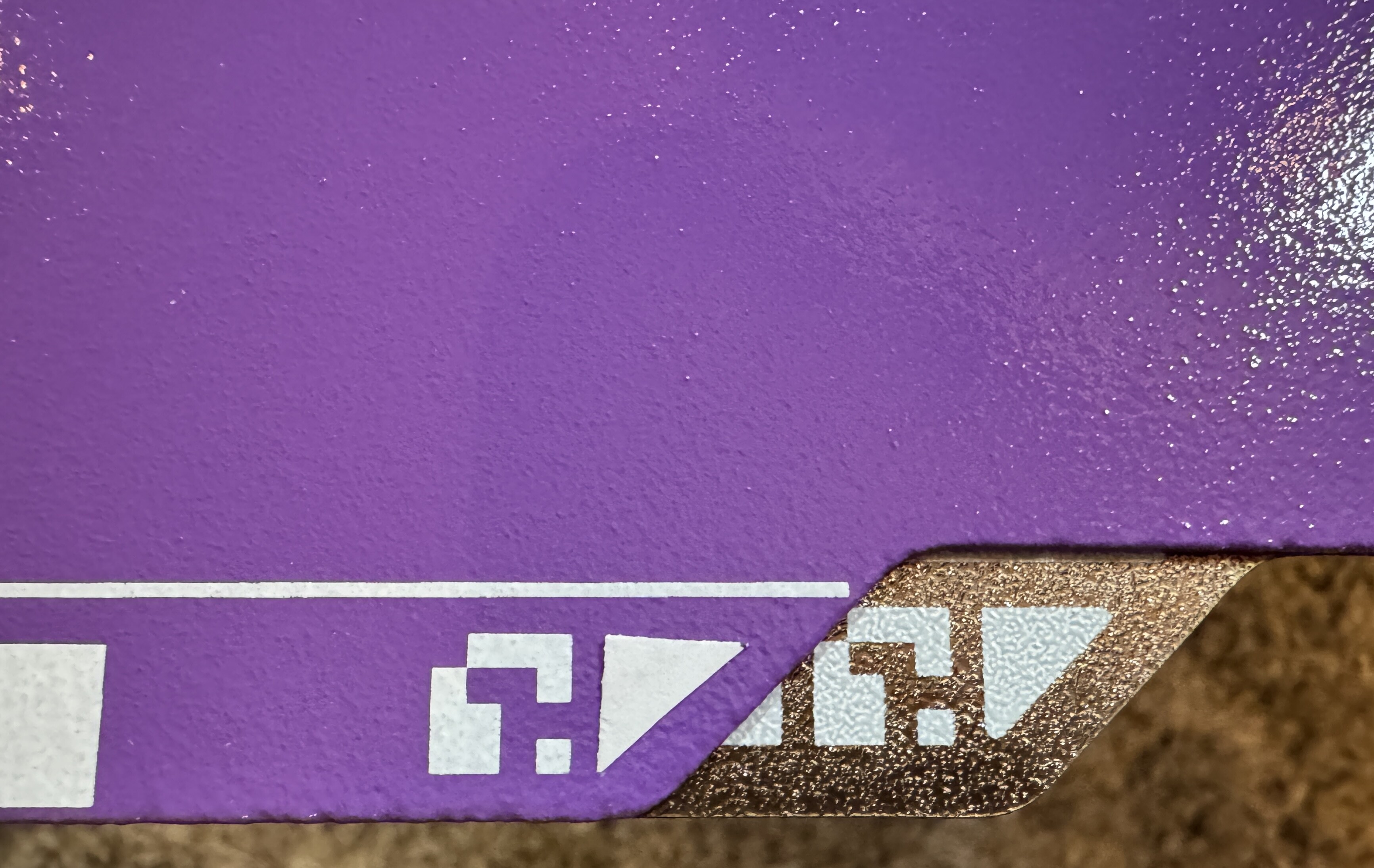

Well it looks like it’s not the triangle. I cut a triangle and stuck it on the build plate. It now detects the build plate but says it’s the wrong type. If you line them up, you can see it’s a bit too low, so it’s not reading it correctly.
Not a massive problem to turn build plate detection off, but it’s saved me a few times so I’d rather keep it on. :cry:

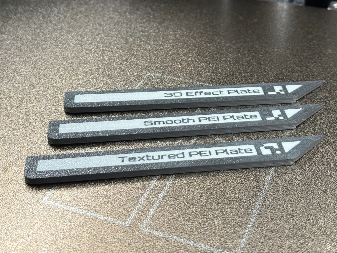

I was looking at printing out one of these. Maybe it just doesn’t like the purple or it needs the white box on the other side as well. It looks like this is magnetic so you could take it off to clean the plate.

Very strange. I printed these and the quality is excellent, however the textured plate refuses to be recognised. The 3d effect one on my 3d plate worked no problem at all. Not sure what’s going on.

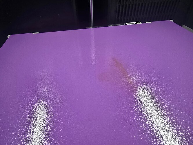

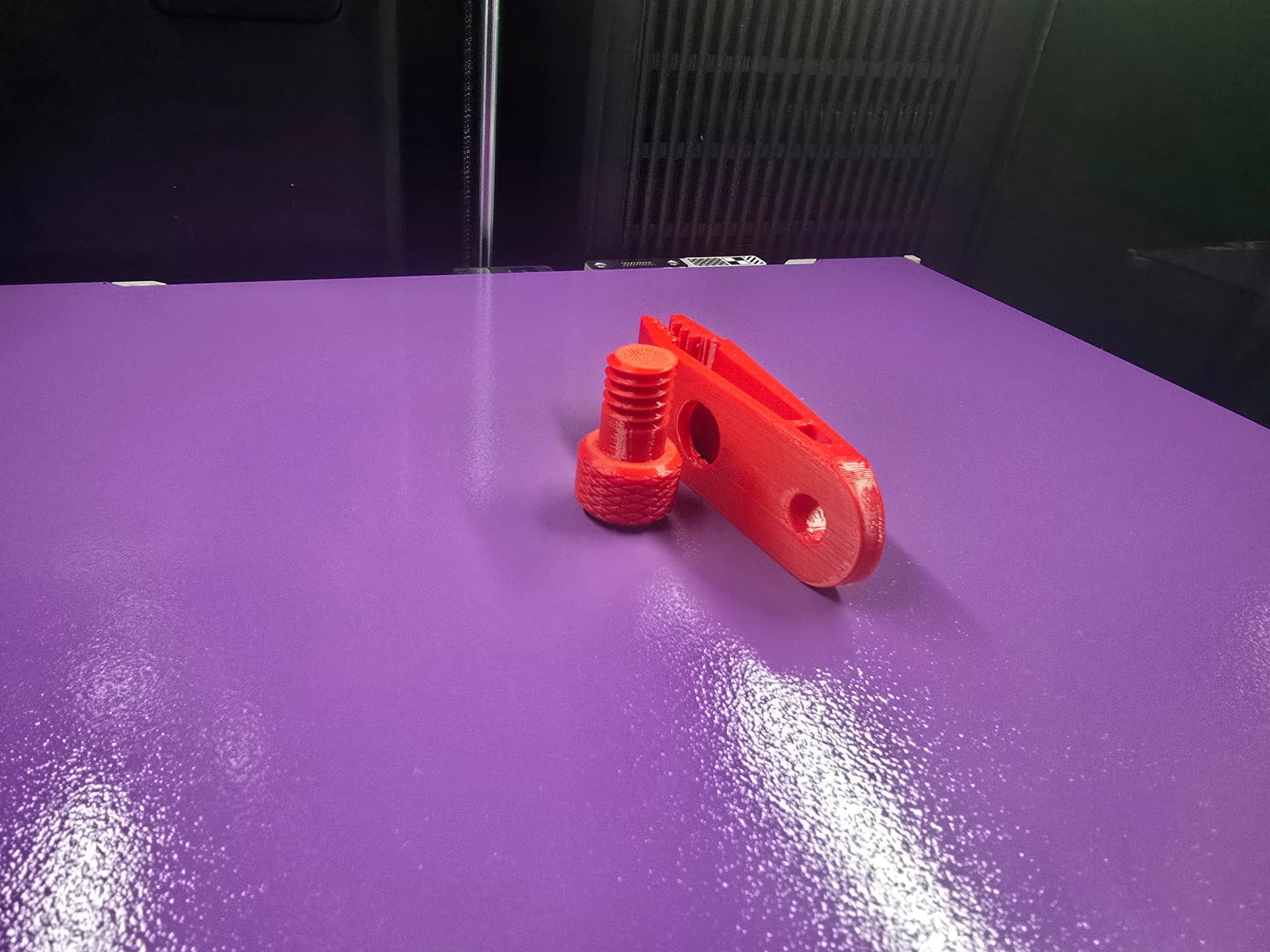

This is duramic3D petg filament. I printed it out at 60c and it was really hard to take off the bed, I noticed the bed was then stained red. And I remember I had the same issue with this filament on my super tack a long time ago. So I think it’s something to do with the filament. I decided to print out another set exactly in the same spot to see if it affected bed adhesion. I then reprinted the part at 50 c and when it was completed printing it was a considerable amount of force to get it off the plate. So I think 50c would work well for most items with petg. And the staining doesn’t seem to affect the adhesion at all. I totally forgot that this same filament left red marks on my super tack. But that plate was never that great for me. Washing with Dawn dishwashing soap lightened it up but didn’t remove it. Has anyone else ever had petg stain PU plates? This filament does not stain Pei plates.
It is printed face down and from reading the comments that said it is not working I notice they printed it face down on the oem pei texture plate. That texture makes things harder to read. You say you were able to print it on the effects plate? Other people printed it on the smooth plate. If someone doesn’t have the smooth plate I’d recommend trying to print it face up. The holes for the magnets should be easy to bridge.
