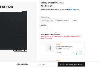

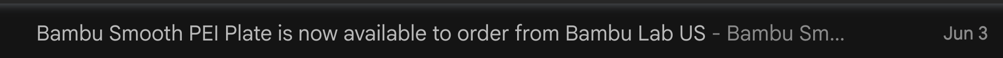

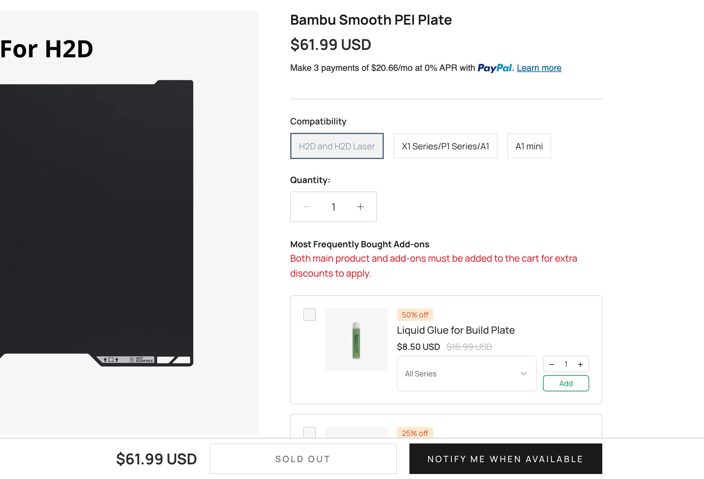

Did you’all see that the bambu smooth pei plate became available?..not sure how long because 18 hours after the email and it’s sold out.
By the time I checked email boom, gone
gawd damn it, and I was sleeping like some kind of human creature that needs rest… if I just stopped with that nonsense, I could have caught this.

I checked 1h after the email and it was gone!

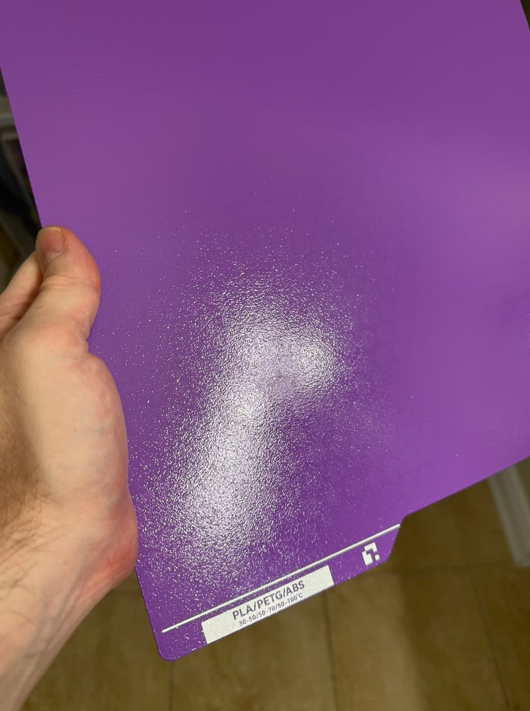

Plate arrived. Its nice and sticky but I have not tested it yet as I have a 3.5 day print thats about to finish. Looks and feels very similar to frostbite and generic grey PEZ plates.
