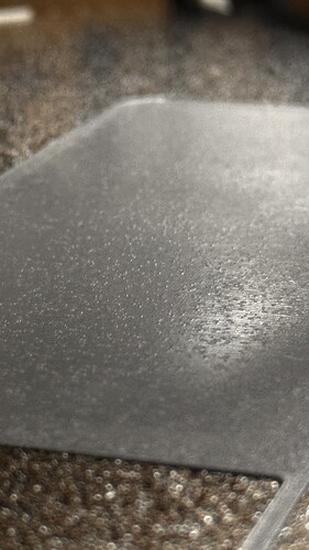

H2D print quality is horrible
New H2D. I am so frustrated.

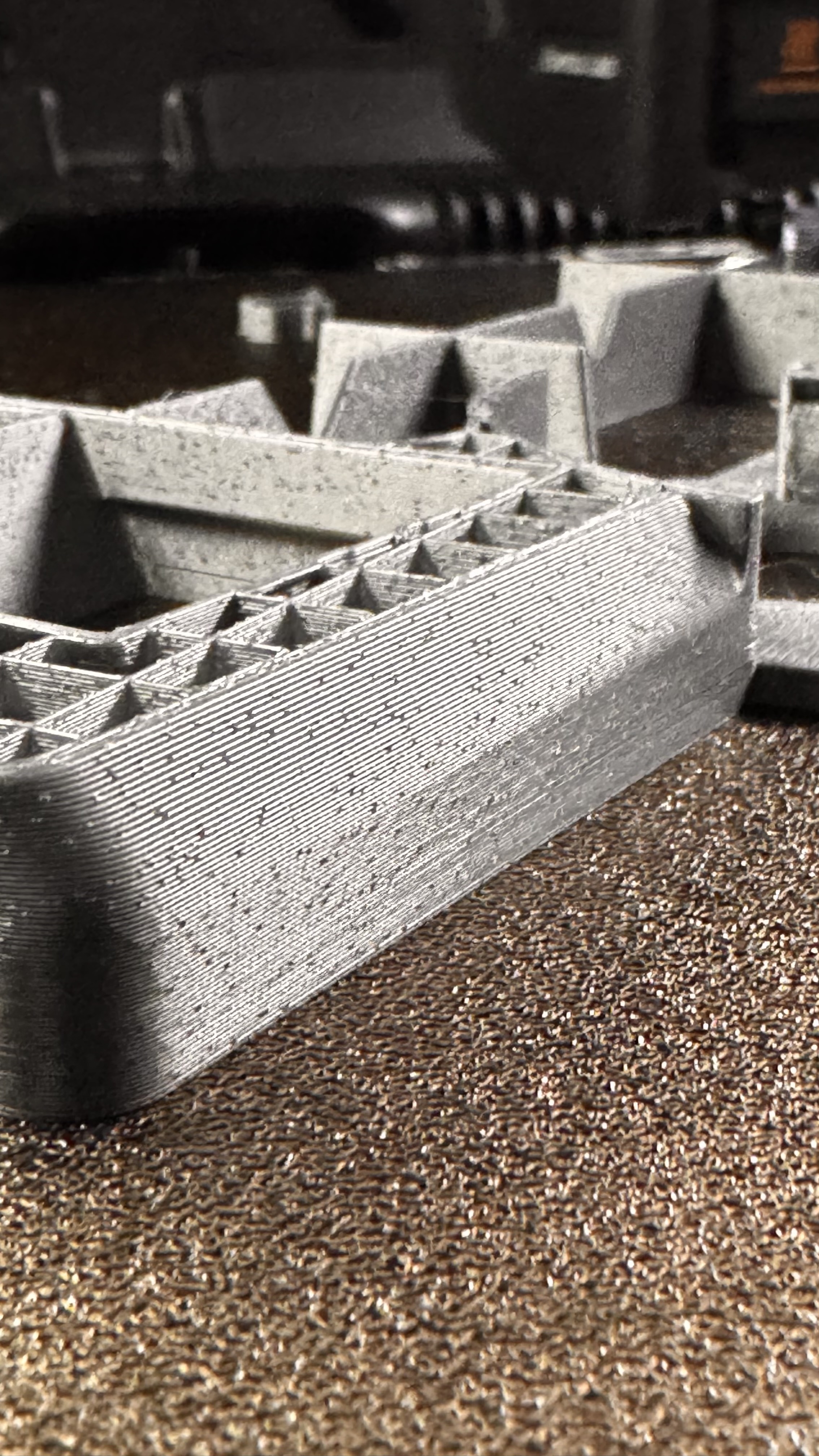

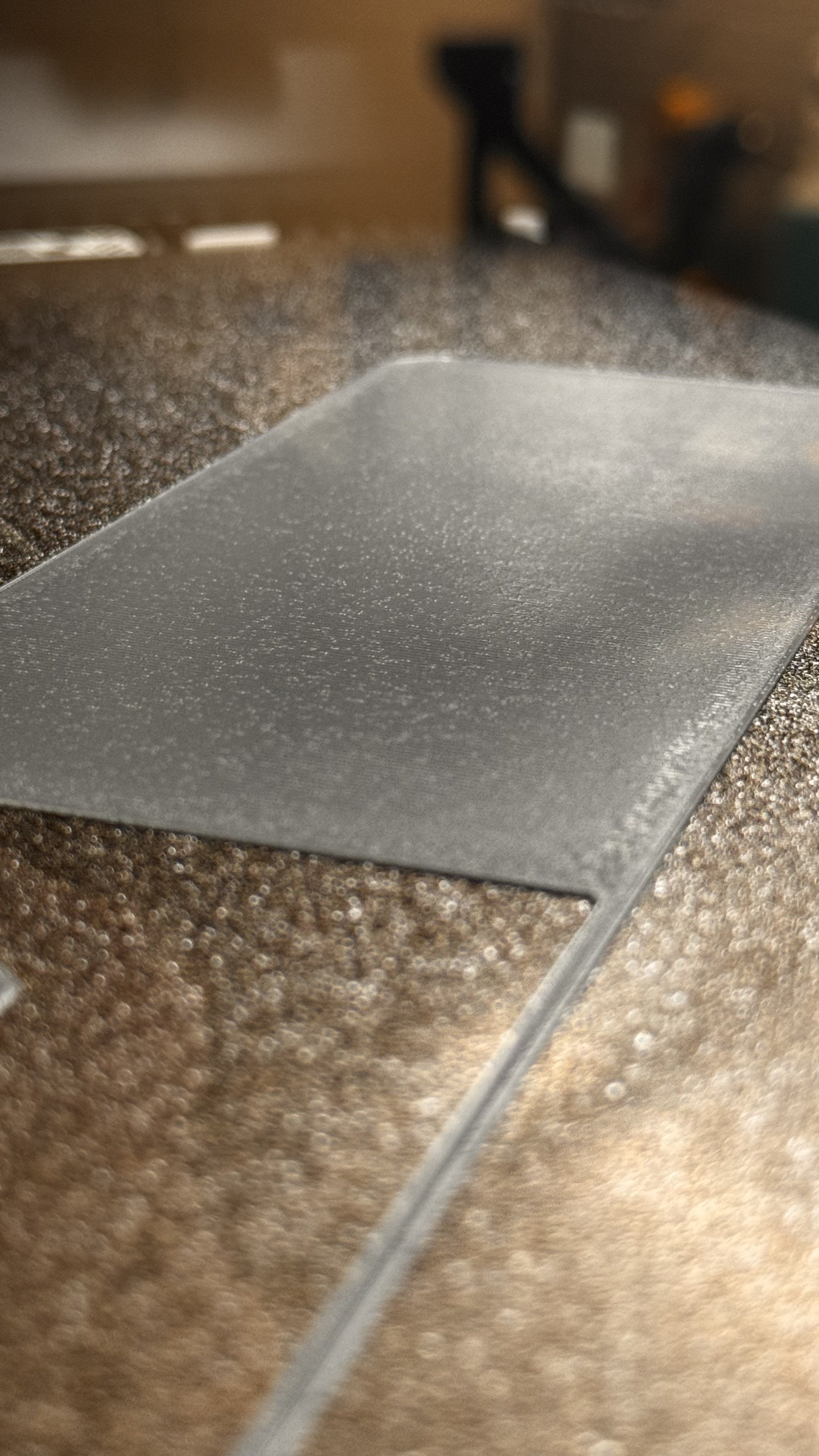

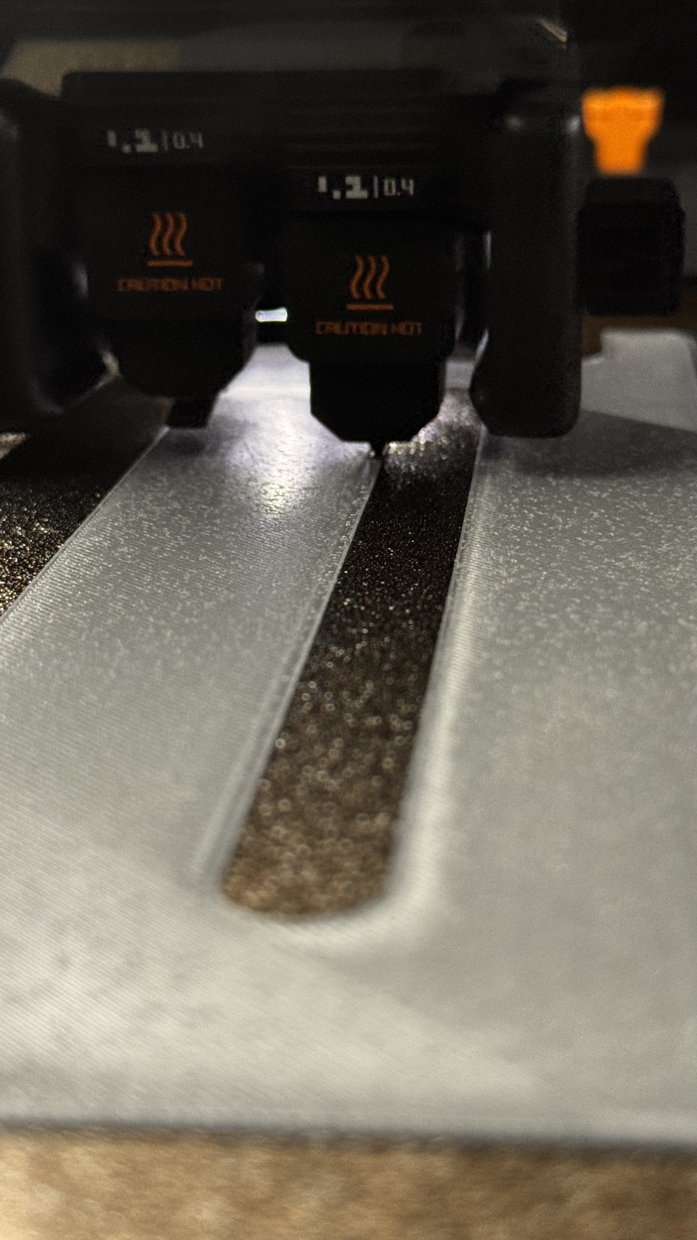

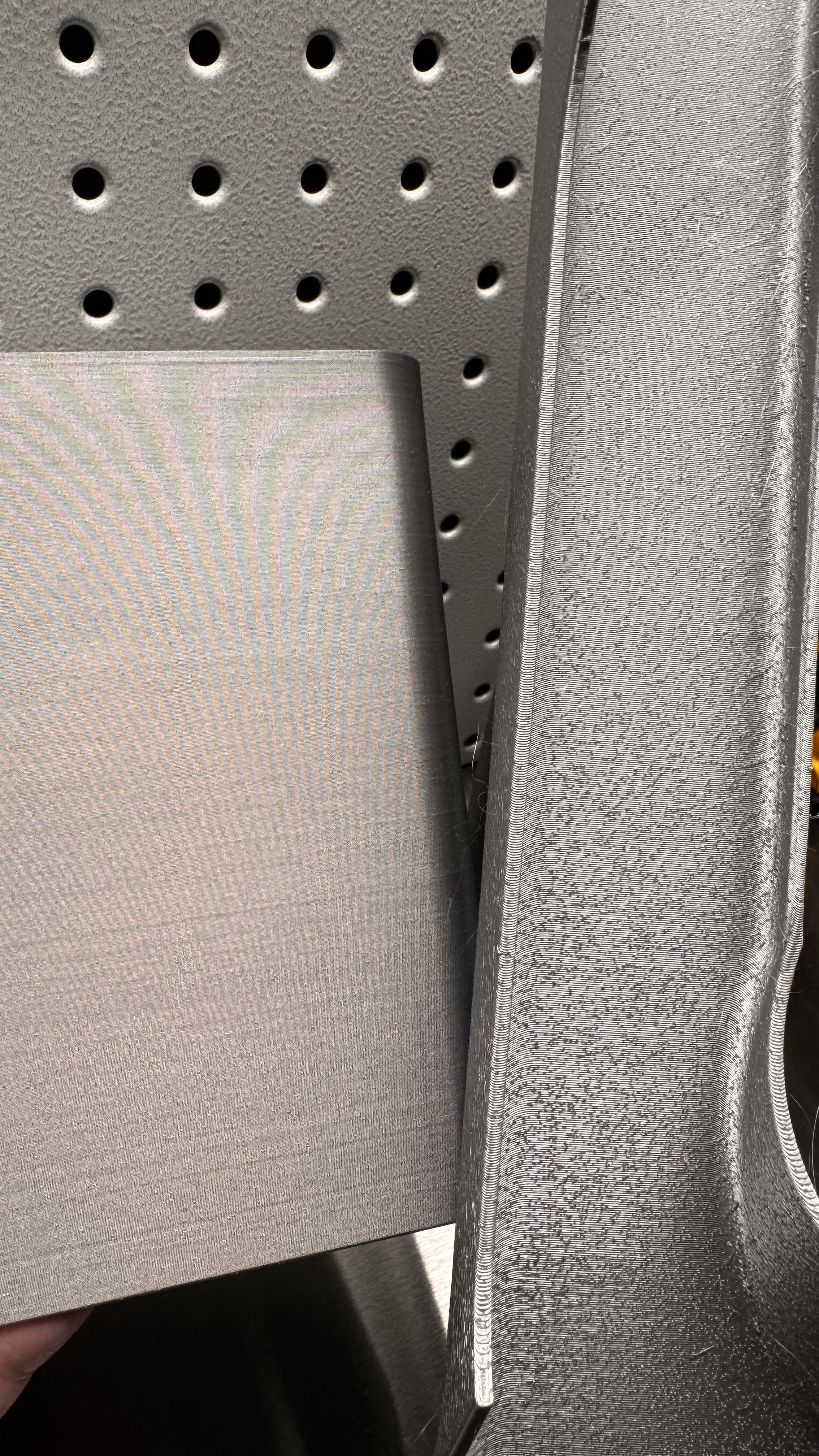

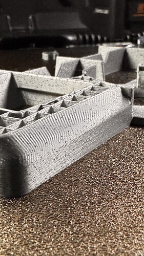

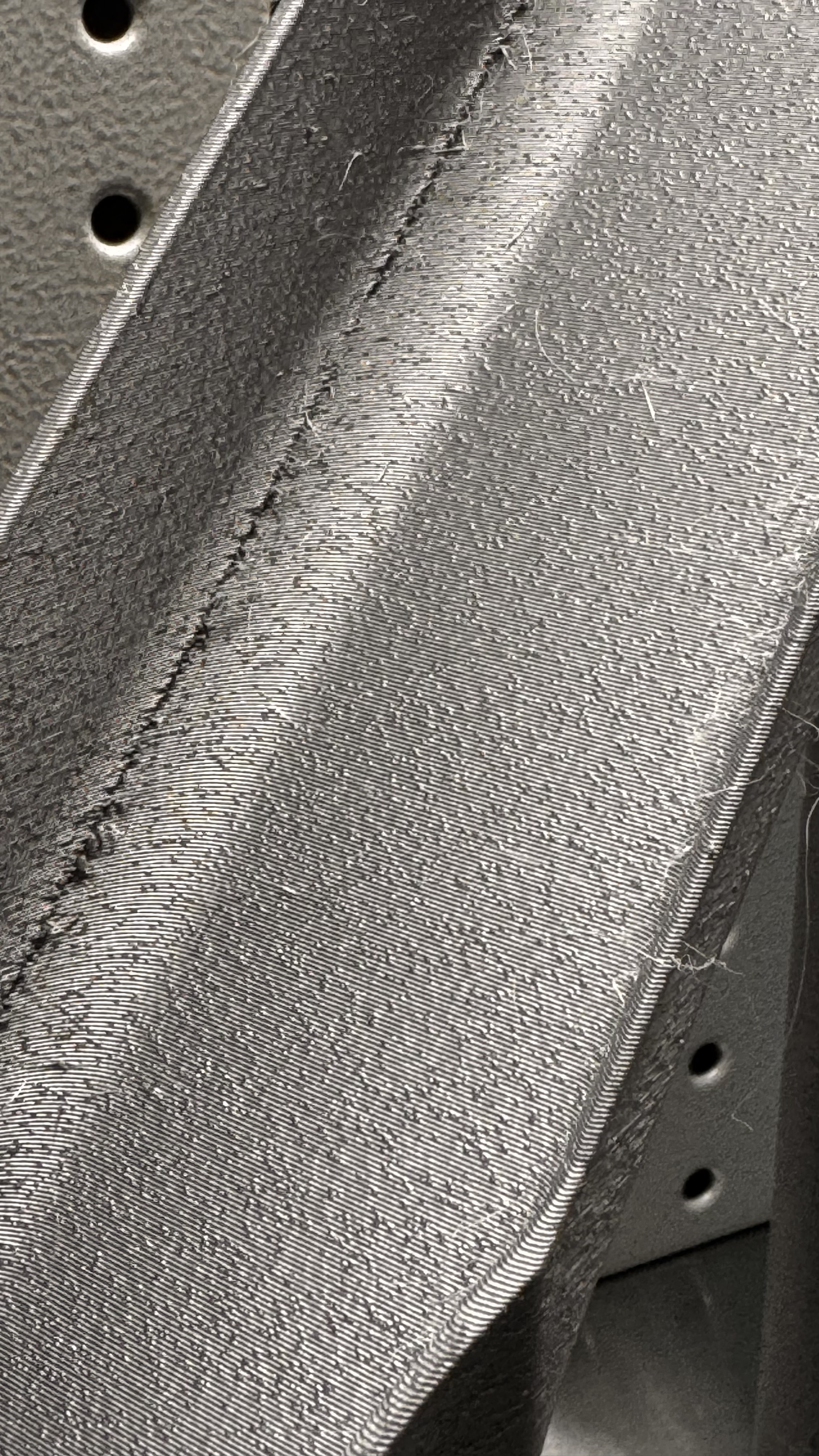

This is not needing to dry the ABS filament. I am using the exact NEW Bambu Labs abs filaments between an X1C and a new H2D. I have even moved the filaments from one printer to the other. The surface and walls on the H2D are garbage just as pictured while the X1C is perfection.
This is nonsense.

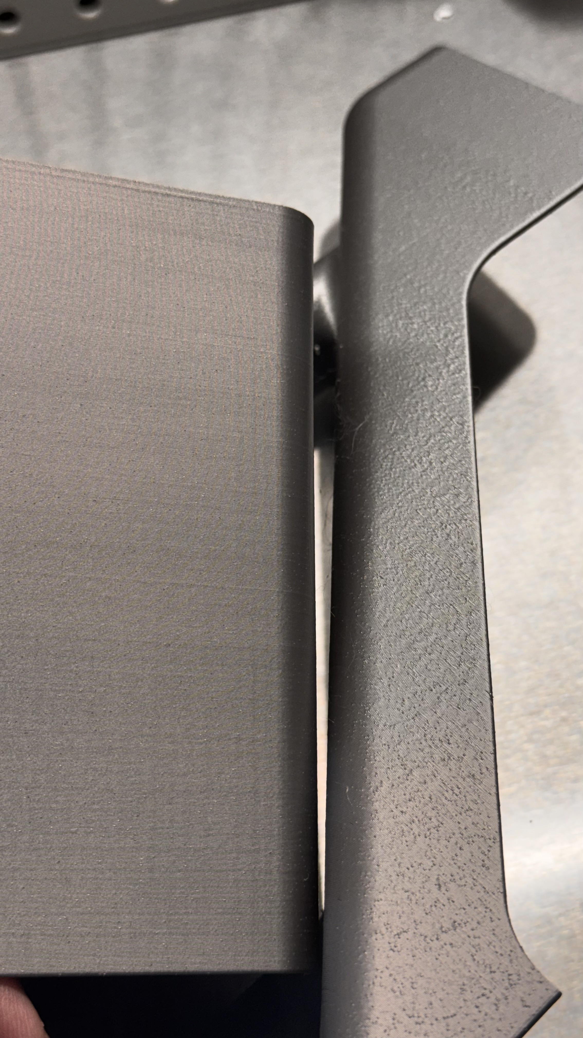

I would like to see the comparison to the X1C.
My guess is that is is an issue with flow rates. The X1 uses its lidar to automatically calibrate. The h2d uses a hall sensor which is less accurate.
Someone is going to jump in with “dry your filament” or “how are you drying your filament”, but that is most likely not it unless you live with SpongeBob.

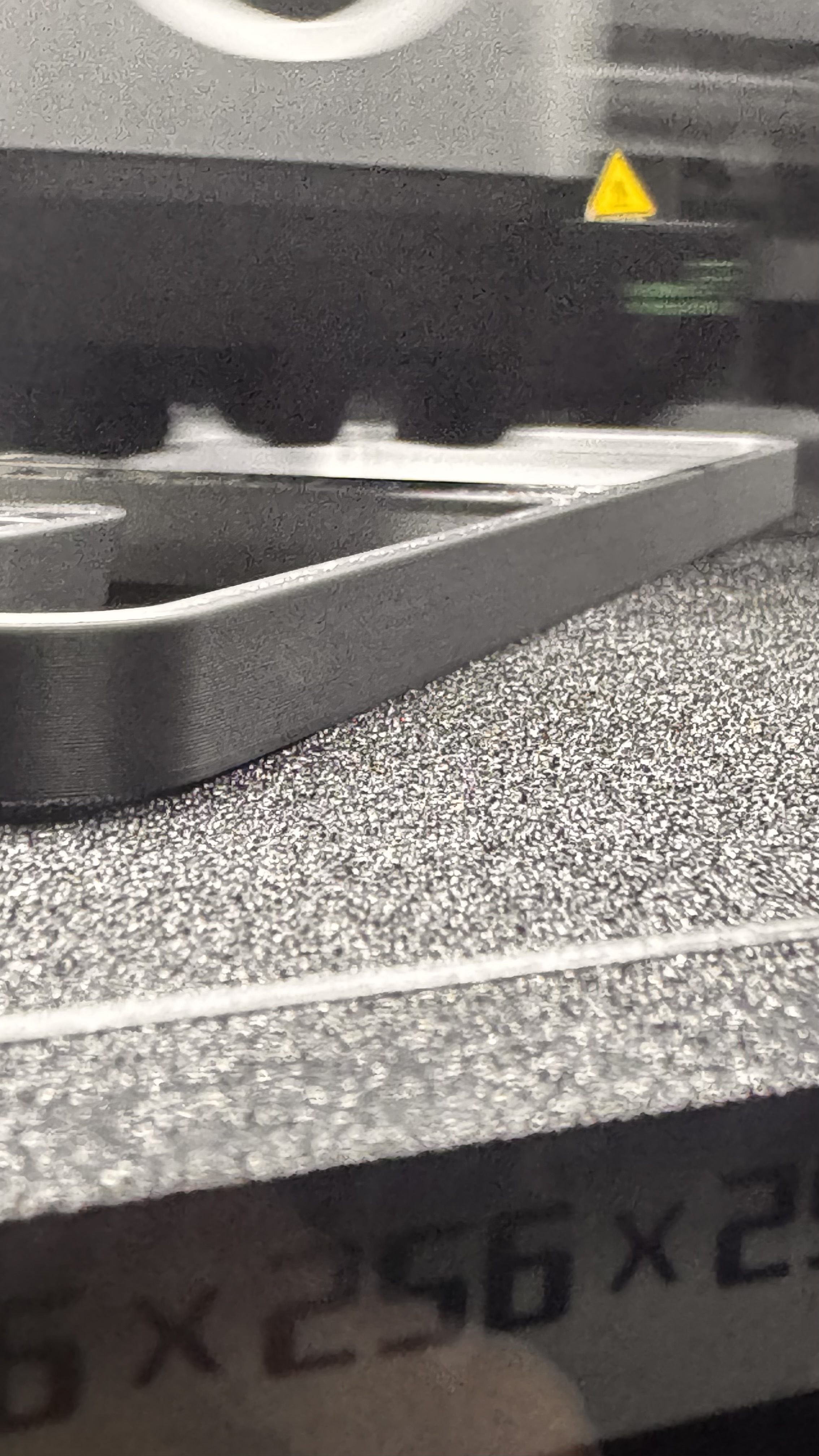

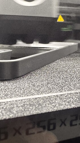

Here it is in the X1C while printing and side by side after.
Also, I have eliminated the “dry your filament guidance”. I have switched filaments from one printer to the other, and the result is consistent. Anytime the same ABS filament is used in the H2D this is the result. I can put the exact same spool in the X1C and it prints fine. Additionally this is fresh new ABS filament taken out of the package and put into the AMS / AMS 2 Pro.
Ok. I am still guessing this is a flow rate issue and the pressure advance (because of how bad your seams are).
I would run a calibration on this filament then run a benchy.

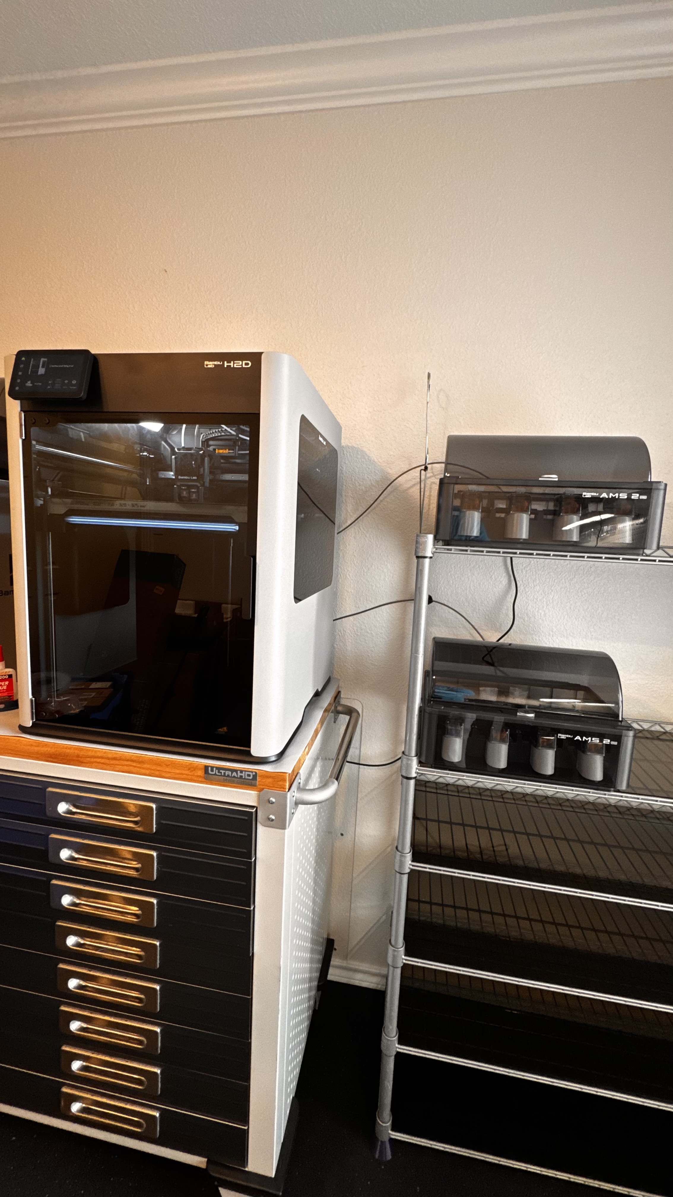

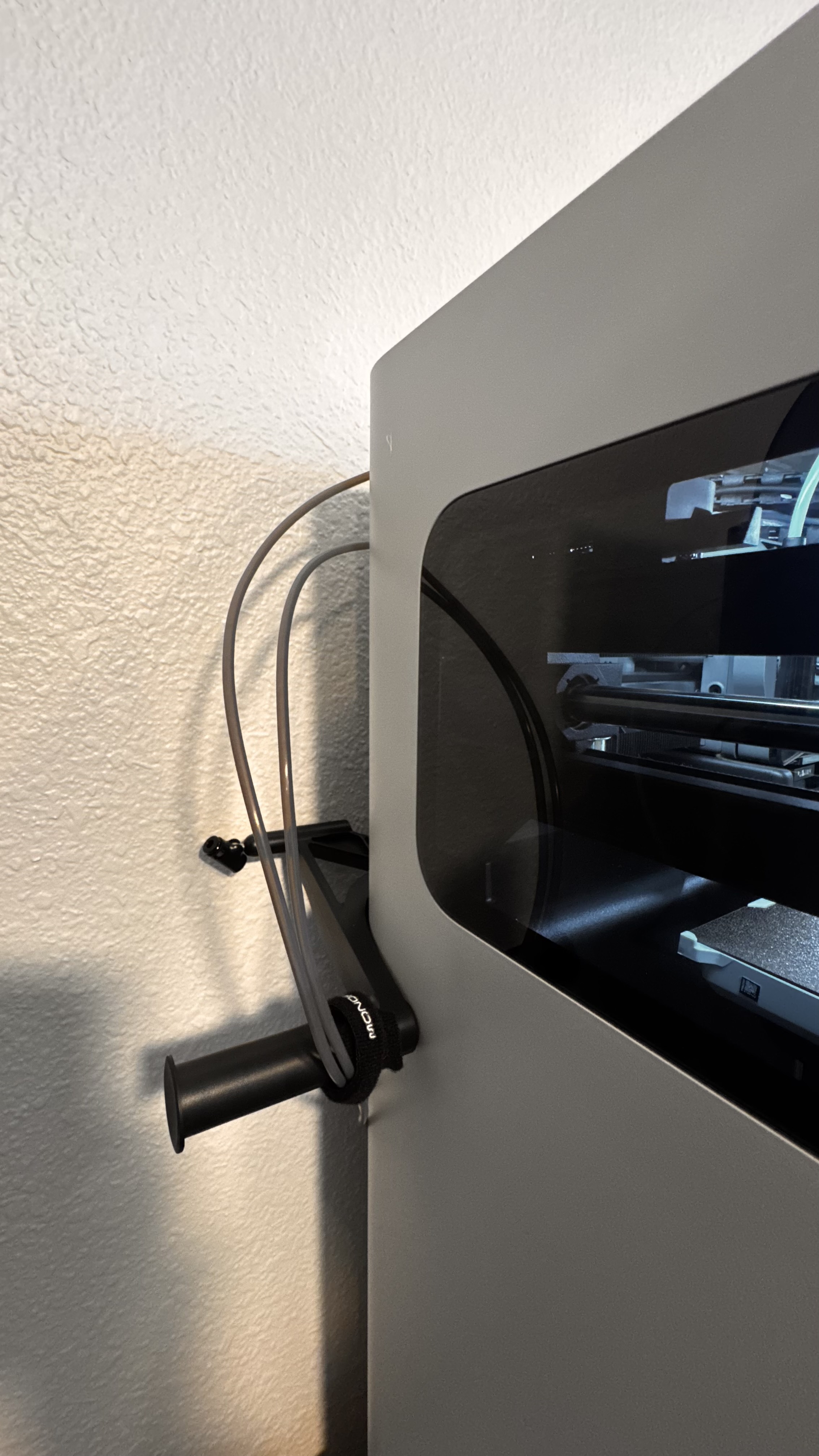

The PTFE tubing from my AMS2 is about 3 feet long. Perhaps this is contributing to this result?

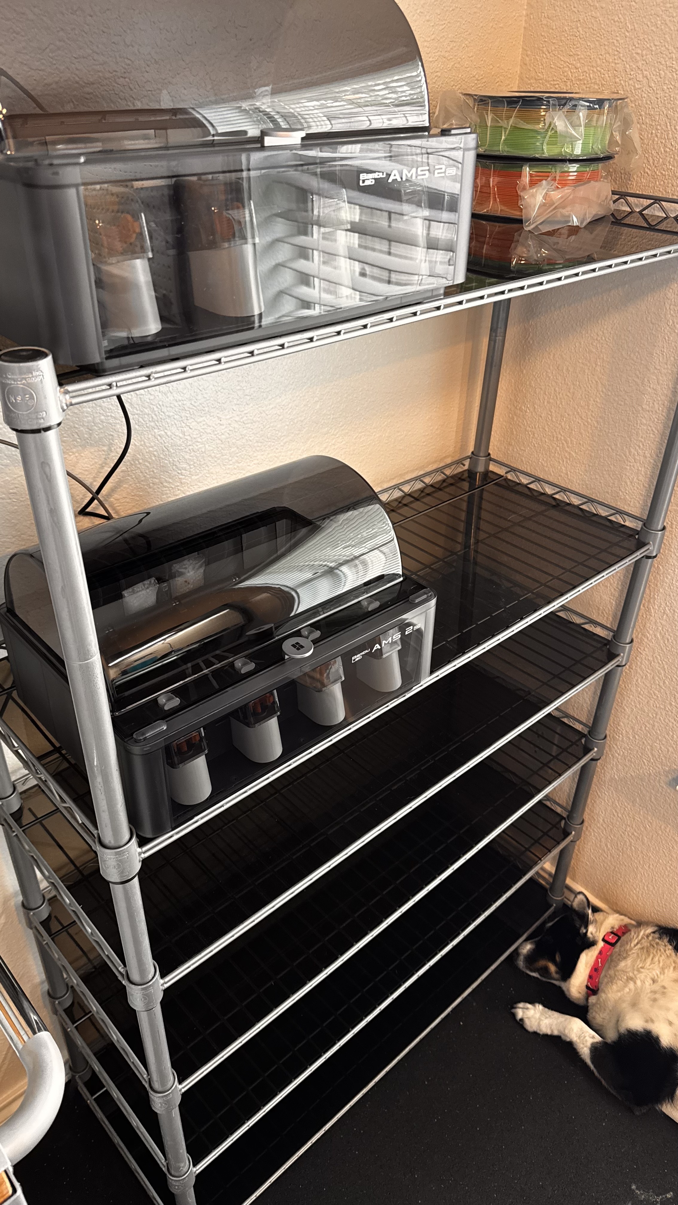

ABS is a bit of a water magnet though. And fresh from the shipping box and bag is no guarantee of dryness. How long did it sit in the AMS2 before you started to print from it? Also, max temp on the AMS2 is 65C. ABS is recommended to dry at 70-80C by filamenthub (edited - the 90-100C is what Bambu recommends for bed temp if using their wiki method with a printer heated bed). 65C is going to be less effective at drying ABS and may require longer periods to dry at 65C.

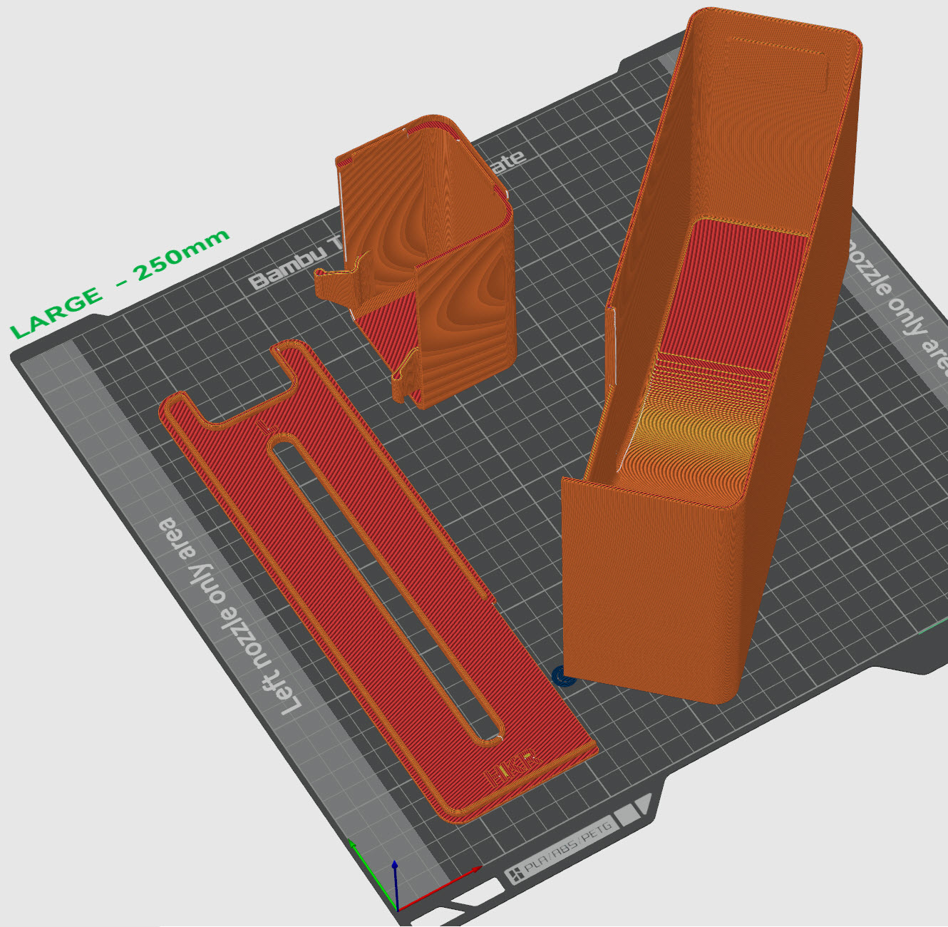

This right here - you have random seams turned on, but also you appear to have scarf seams enabled as well. That combination of settings produces exactly those zits.
To be fair to you, Studio really doesn’t make the settings set intuitive, they really need to auto-set the related settings as soon as Random is chosen, similar to how support interfaces get auto-set to the correct settings as soon as an interface material is chosen.
The wiki article goes into depth on this:

Those bumps everywhere are pretty wild but haven’t seen water cause that regular of irregular defects.
And those bumps should also show in the preview if seams are turned on to visualize?
It means I will take the initiative to take action and dry the filament even if I may doubt moisture as the cause. There is always a chance. When I start to consider the hotter environment of the H2D, perhaps the same moisture content reacts differently between the two printers.

In comparison, no it is not.

OK - but you have random seams turned on. That’s not a default print profile setting.
But do you see the seams at those same locations in preview mode in Studio? That will tell you right there. Just make sure the check is selected to display the seams.
I just checked. Seam position is aligned. Again, I’m using the default 0.24 Standard @BBL H2D profile. Verifying in preview, seam position is not random.
I will also add that layer adhesion is very poor as well. I can easily tear the layers apart. I think I just need to bake the filament and update this post.
