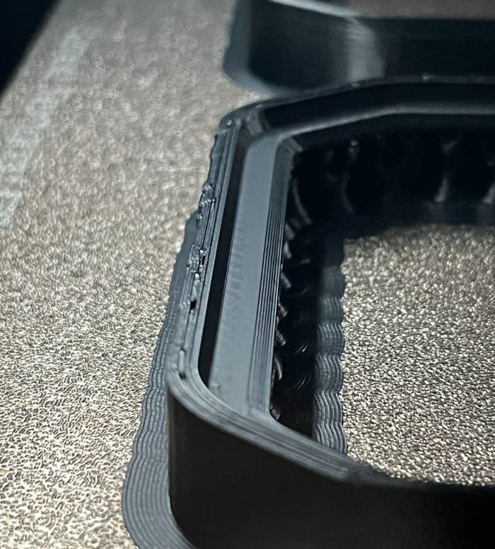

So for context, THIS is the result I expect and get when supports do their work.
Any time the ironing is failing there, I ALWAYS know the supports failed one way or another.
On this job I attempted to fix the previously stated kinda failing tree supports by slowing down bridging to 35mm, and 0.025 more flow. Forgot to turn down ironing flow from 30 to 20 tho, thats why i got that wringles on the ironing, but thats ok, onces it cools down thats minimal and will go away/hide.
If the supports fail though, its immediatly evident in the ironing because it being so thin and delicate the subtle lower position of the layer ends up in the ironing looking like scratches.

It looks like support is sagging here. Have you tried increasing part cooling? Increased part cooling and slowing down on support printing might help.
HO finally a guy with eyes! Yes thats exactly what im trying to find out why its happening. Cant really bump cooling , as its abs and it will just warp away, producing negative results, but im trying to find WHY they shag on the H2D but not on 4 other machines

No it won’t help. I had similar experiences with a1 and x1s. A1 was printing PLA and X1 was printing PETG CF, abs. It’s basically as simple as the single layer support wall is just not that reliable, so when you draw a long wall in fast speed with high extrusion pressure, it bows.
Not really. One big difference between your Voron, P1S and H2D is the active chamber heating. ABS really like hotter ambient so the stress don’t build up the part. Because of the chamber heating, you can increase the part cooling.
Try either increasing the part cooling or reducing the chamber heating temperature. I have not tried printing ABS on my H2D yet, but I printed bunch of parts with ASA with chamber temperature set to 50C. (default setting was 60C).
