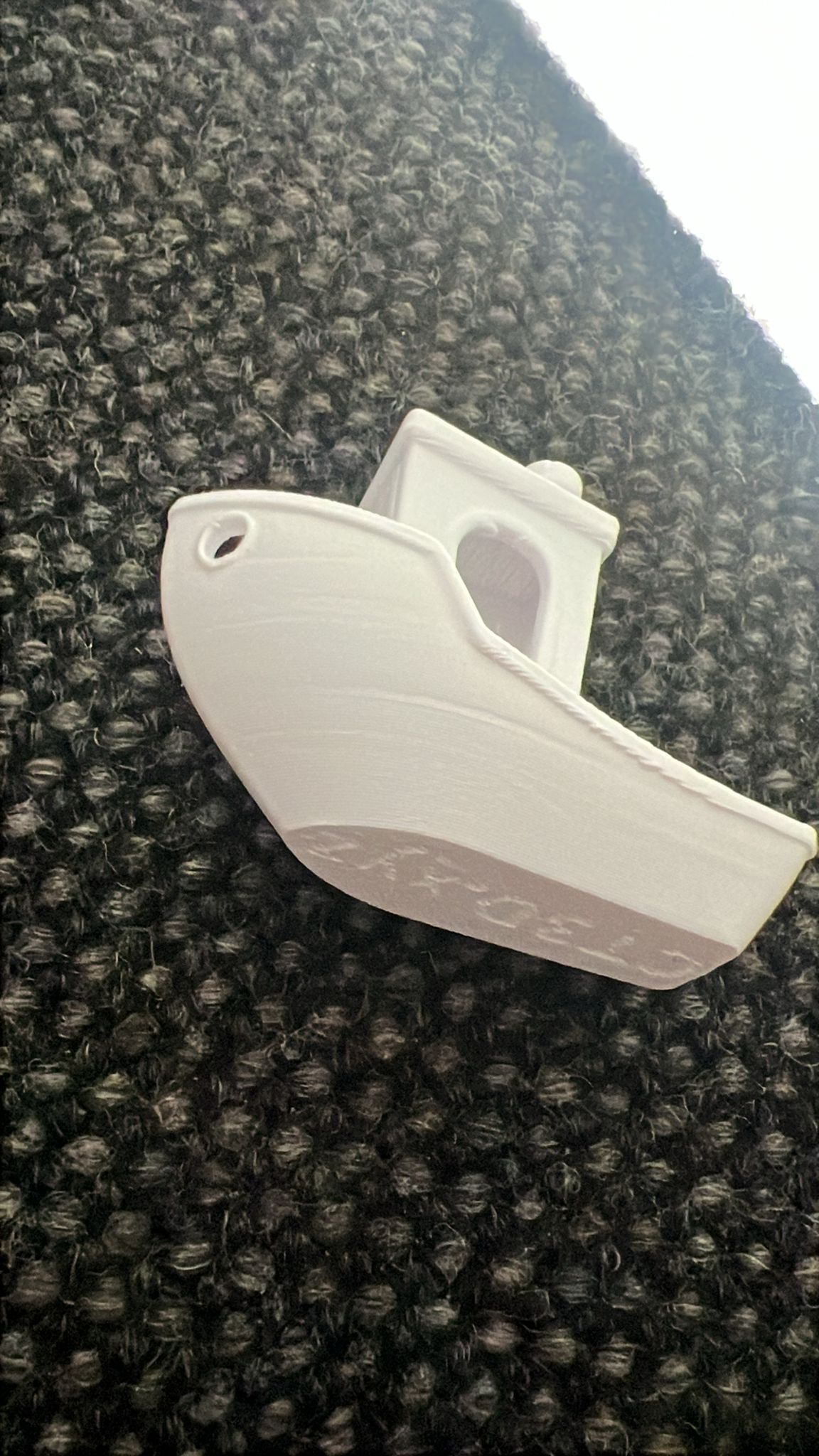

Same exact results on the benchy on my H2D as well for banding, but I’m new to 3d printing so I just assumed it was normal.
I haven’t ran the encoder plate calibration yet though to see if that fixes it.

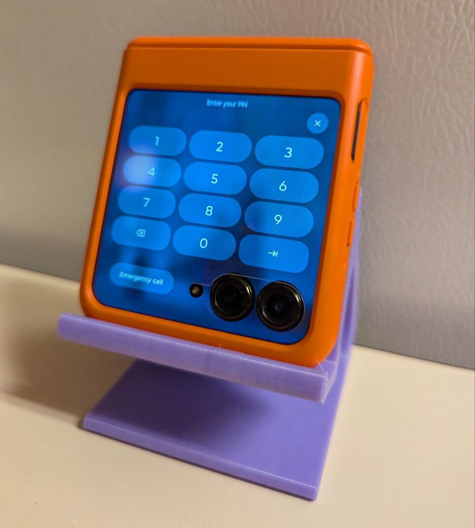

I just finished this phone stand a few minutes ago and it’s absolutely flawless:
So for me it’s seems to be an issue with the firmware/software in general because if this would be a hardware problem it should be more consistent.
