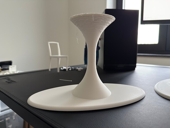

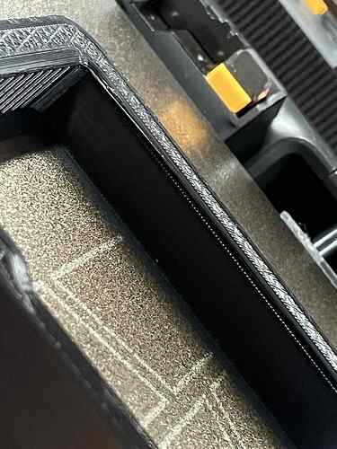

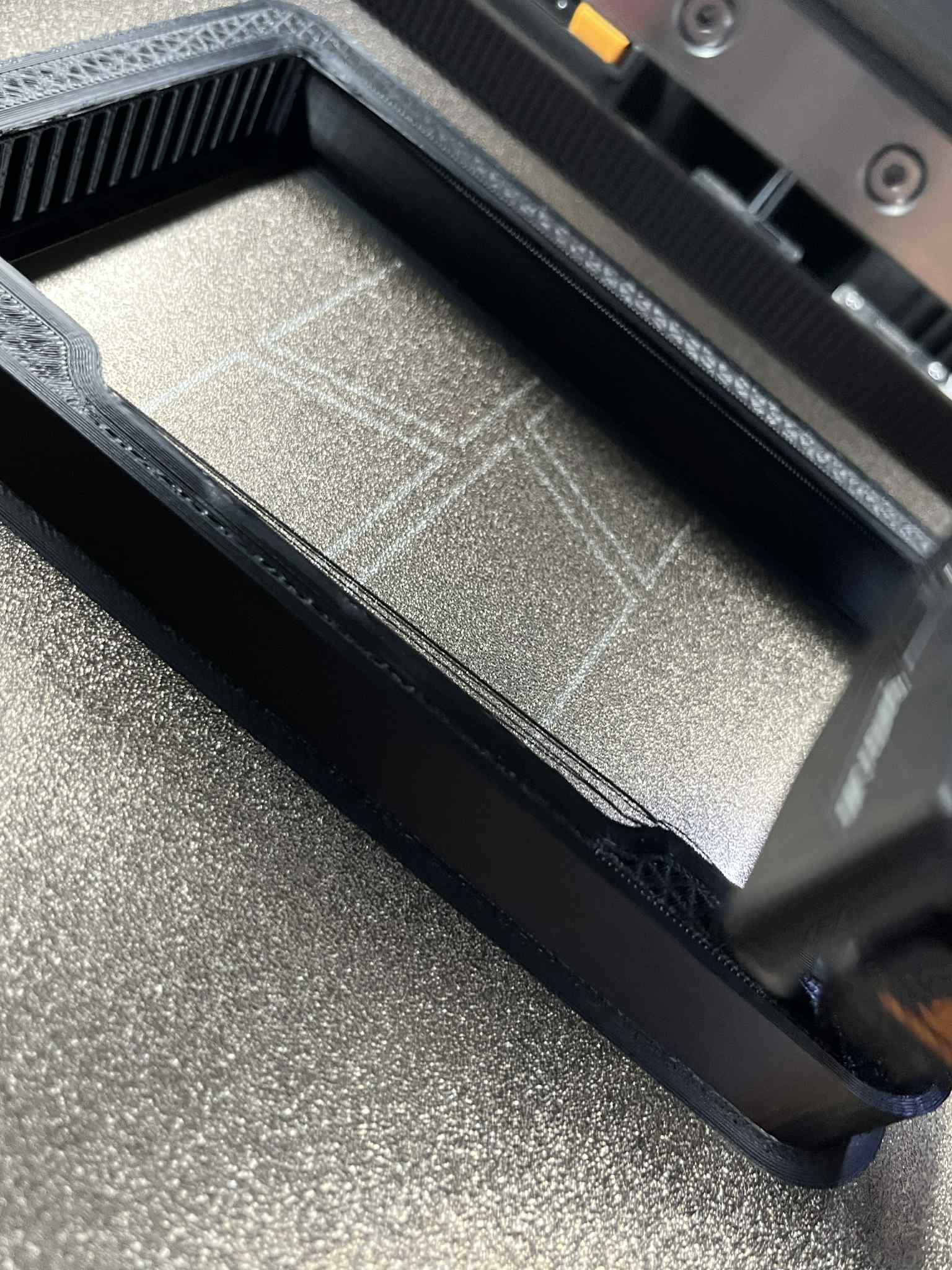

Is this what you would call “Z-wobble”? The moment it starts printing that overhang it seemingly pushes against the model. Already did the full bed calibration. This particular model has 5 walls so it’s already pretty sturdy but it still seems to make it wobble.
what infill was that?
25252525
Was using 10% Cross Hatch. Now trying the same but with Adaptive Cubic + also disabled “Reduce infill retraction” (I could hear it scratch the infill).
EDIT: same problem using Adaptive Cubic, I can hear it scrape against the infill and I get those pushed out layer lines. I guess the last option before modifying the geometry is to slow down the speed once it gets to the upper part?
try share 3mf file with your saved settings.
The nozzle should be pushing downwards and press on the part, that’s for sure (it’s pressing the melted filament to form the line width you set, e.g., 0.42mm for walls, 0.45mm for sparse infills… Etc)
Sure, here’s the file. Note that the increased wall loops and top/bottom shells are to reduce transparency of the model. It’s supposed to be a table for Barbie figures (a request by my mom :sweat_smile:)

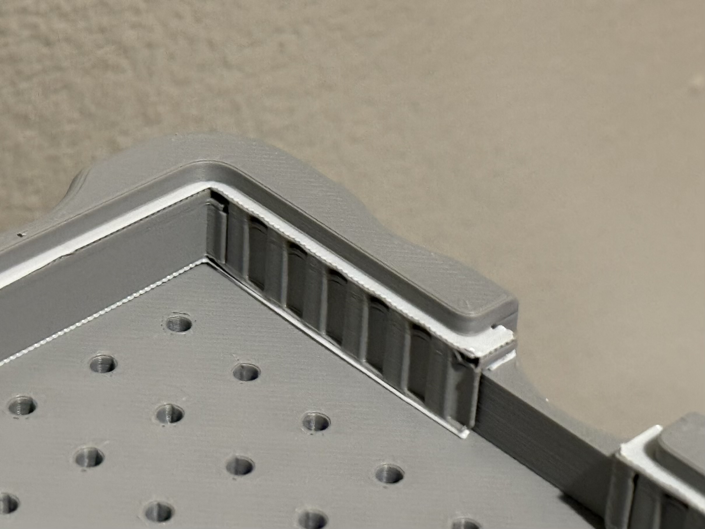

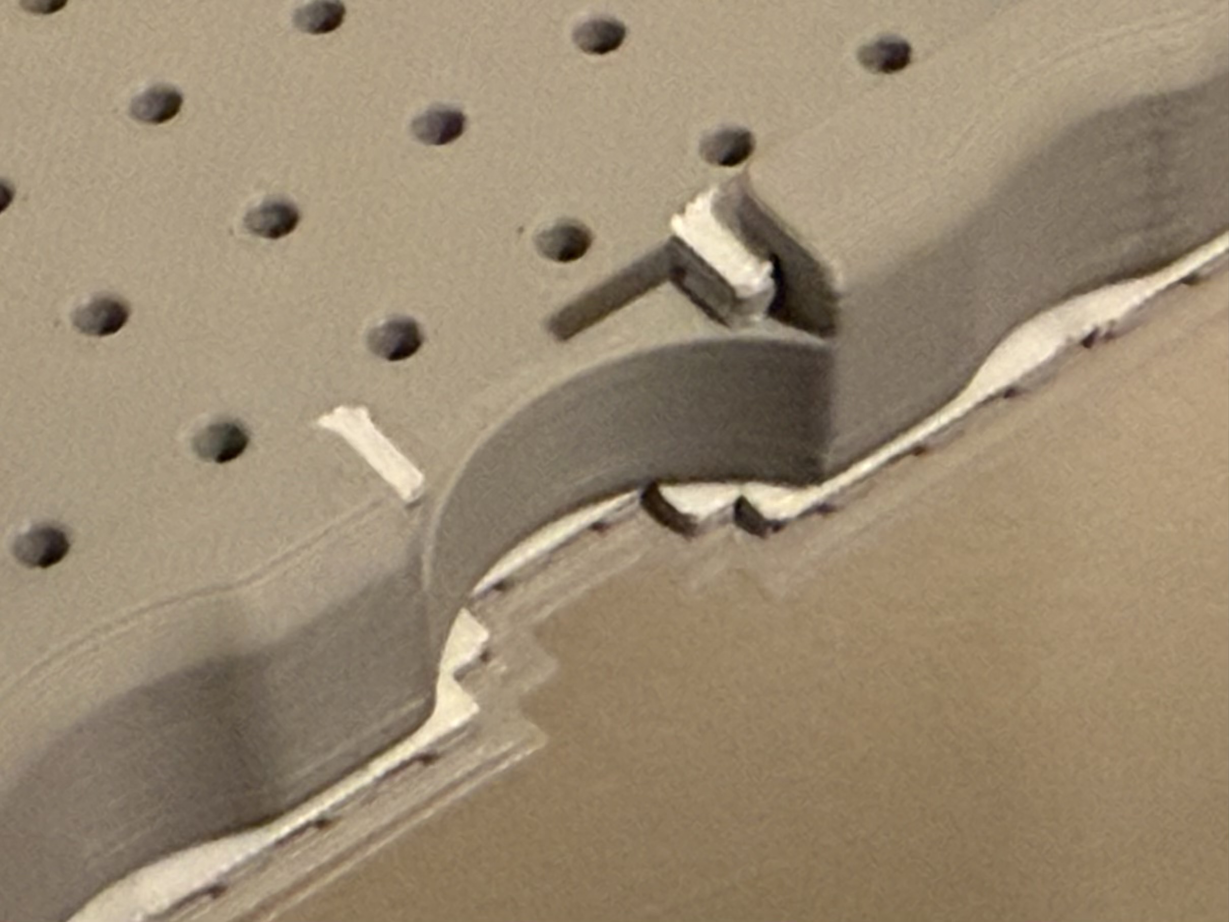

Another case of supports failing at the interface . 0.16 layer, 0.12 top z, again AI failed to detect air printing. Tell me again how that’s ok. This is another model I have printed countless times with the exact same filament on my other 4 machines, including Neptune’s that are not even supposed to run abs, yet the supports won’t fail like that !
Τhis time its with single color, same material for supports, independent layer height turned ON, will try with off on the next print .

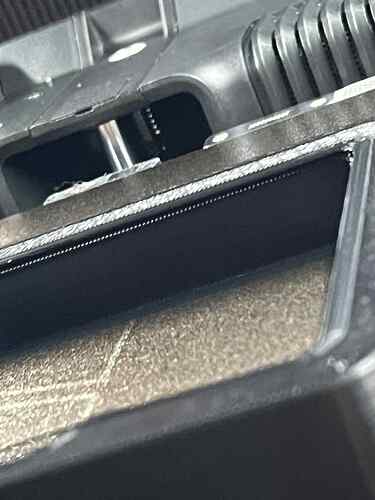

It helped a little, but I ended up finding a broken bolt on the left nozzle rail behind the heater. I think it helped more with VFA’s using the left nozzle than anything. Slicer settings and firmware/BS updates helped more. I feel we need more tuning to deal with the cooling and mechanics of this printer than anything. All my z-banding wasn’t traditional banding but only on geometry changes or layer time changes. Arachne, 2 walls instead of 3 (when possible), precise wall, help alot depending on the model. Also unchecking slow down for overhangs helps a lot on models that will allow it.
That changeout took me about 2 hours taking my time. The only thing that was a PIA was the small screws on the x-axis it self. I used a magnet to help get the ones out in recesses once they were loose and put 1 layer of scotch tape around the Allen key to create enough friction for the screws to stay on the Allen key when I slid them into the recess.
FYI, Do NOT remove the toolhead from the x-axis. There are loose ball bearings inside that are only held in place by grease and the x-axis itself. This is why they ask you to hold the new and old toolhead in place with zip ties or tape while installing or removing.
The other issue I had was my left nozzle stopped heating up to the proper temperature shortly after doing a calibration when we had the bug that would slam the nozzle (and wires below it) into the cleaning pad. So they sent this tool head out to me for multiple reasons.

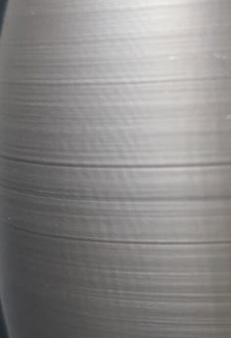

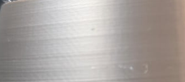

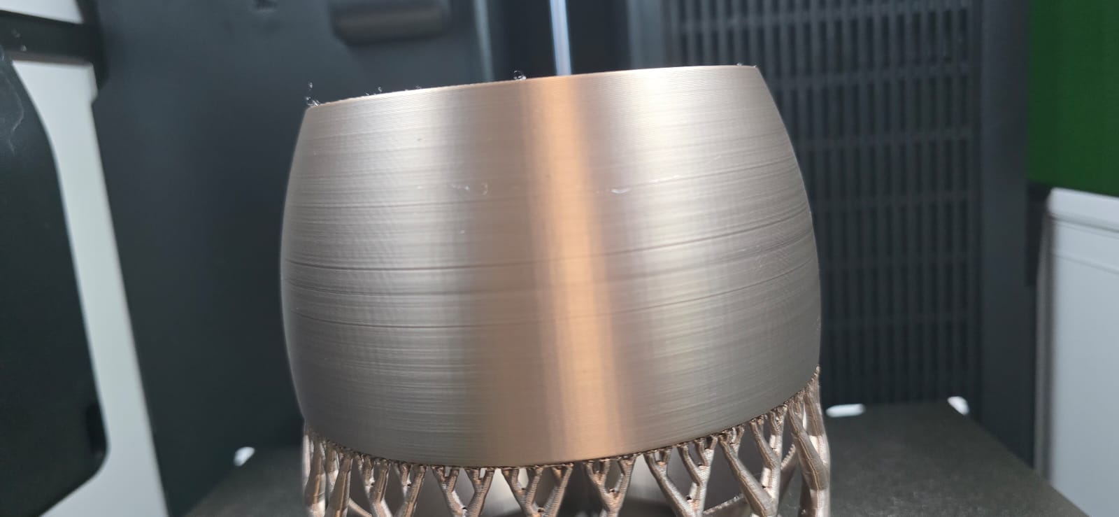

got some pretty bad Z banding on this print, first time printing something this tall. Using Generic PLA Silk profile with no changes made. Does anyone know why this is happening or how to fix it?
Thanks
need 3mf to analyze.

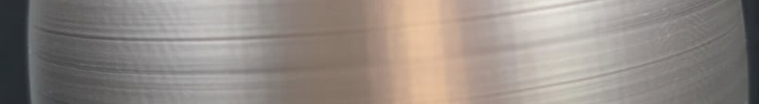

From the looks of it firstly it’s not exported in highest quality (can tell by the rainbow like pattern, it’s not vfa)
then, this regular horizontal pattern hints a regularly changing sparse infill pattern:
The reason of these two bigger lines is unknown. I guess there is a top surface in the center of the model? i must have the 3mf to make sure.
