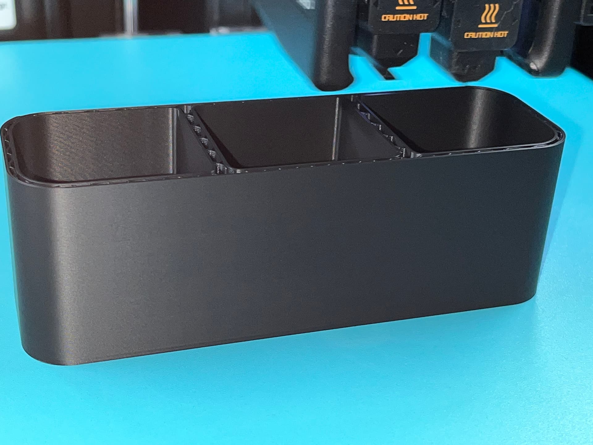

I am trying to print your model, it’s not finished yet but looks quite good so far. That’s BL PLA basic all preset default.

Great print! Thanks for your input. Yes, I’ve already loosened that screw because I did the bed tramming.
