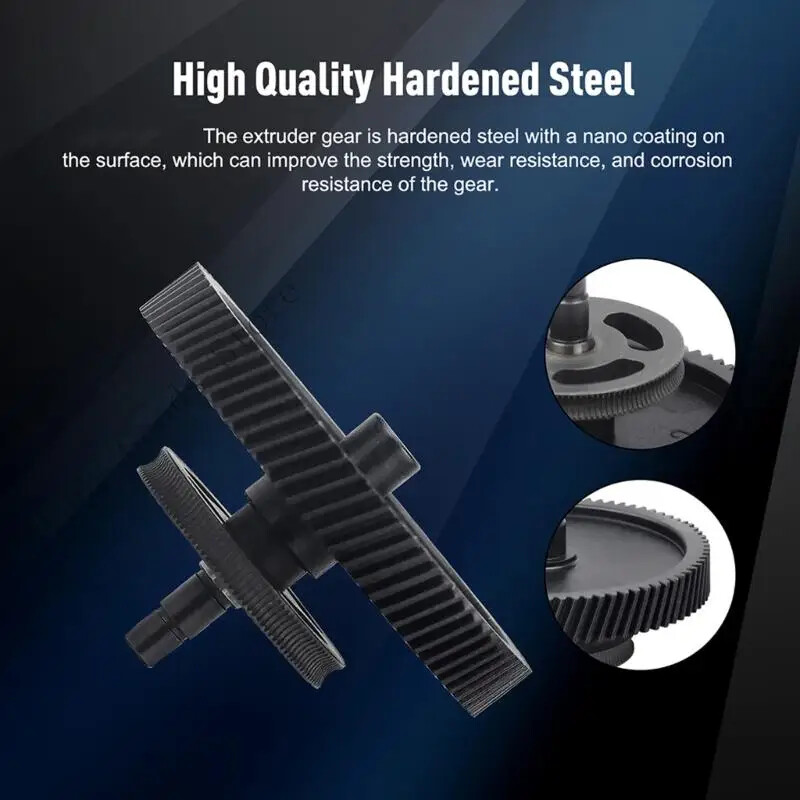

I received my new extruder Today, can’t say if it’s an improved version as it looks exactly the same. On the original I could see some white stuff (epoxy glue?) at the bottom junction of the wheel and gear but not sure it could be seen without the press fit actually failing and none on this one. I tried to rotate (not too strong as I don’t want to ruin it) but it seems really tight.
The extruder assembly is very similar to the one on the A1 and Mini. In fact, some Chinese manufacturers have already made extruders (for A1 series) as a single block. I wonder why Bambu doesn’t do the same.
I found this one, It’s not clear whether it’s a single solid piece (and not two press-fitted parts) like many aftermarket options for the A1 series, but given the price…
https://it.aliexpress.com/item/1005009750132813.html
