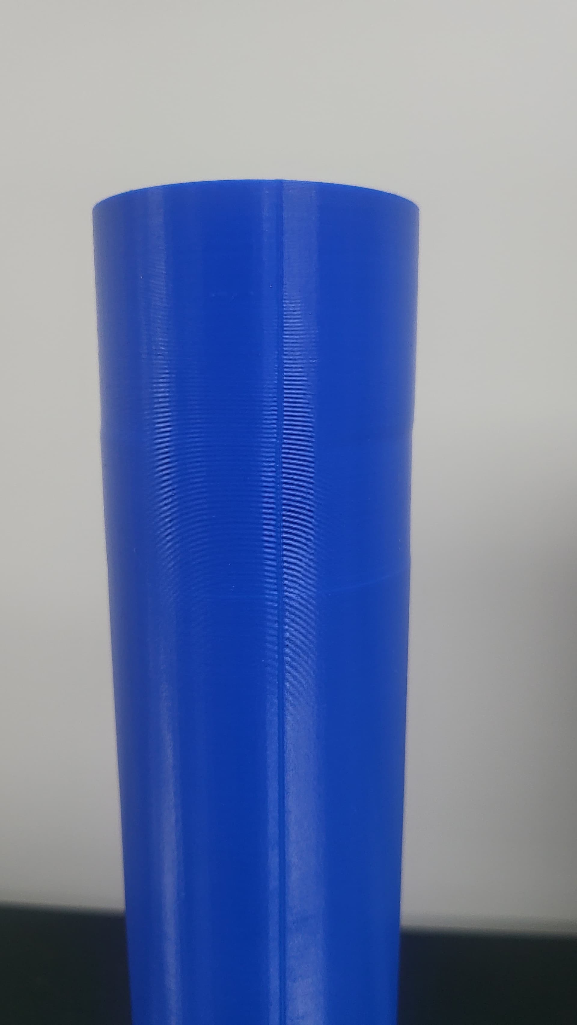

Hey everyone,
I have a couple of H2S machines here and I’m coming across a really odd issue towards the top end of tall prints printed in Bambu ASA.

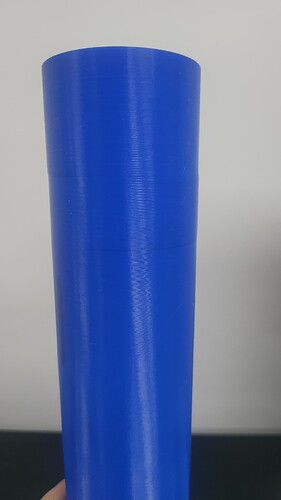

Here is what is happening. I print a test cylinder wide enough to not be affected by wobble (around 70mm in diameter), it prints perfectly up until around 250mm then suddenly the model looks like it twists and shifts resulting in a bulge on the right and indent on the left. It does this for 30mm then returns back to normal (but not always). It also does this for a vase mode cylinder and other shapes like square. I am baffled as to why this is happening.
In the images the black line shows the side which was facing the door. The seam printed top left of the cylinder.
Imagine a pivot point on one side of the cylinder. It looks like it slightly pivots from that point so it’s not just a plain layer shift. It is also gradual.
I’m using the latest firmware and software. Using default standard h2s 0.4mm profile.
It’s happening across multiple H2S machines so unless there’s a mechanical QC issue surely it has to be software or firmware?
I tried replicating possible heating and cooling effects by turning off chamber heating, lowering bed temp slightly and cracking open the door but that just results in an immediate layer change uniformly around the cylinder.
That doesn’t rule out heating and cooling effects but why would it always be happening at roughly the same height rather than a couple of heights.
Any help is appreciated but I’m worried it’s out of my control until software or firmware gets fixed unless there’s a magic setting I don’t know of.
UPDATE: It only happens with ASA. I tried pla and it printed perfectly
