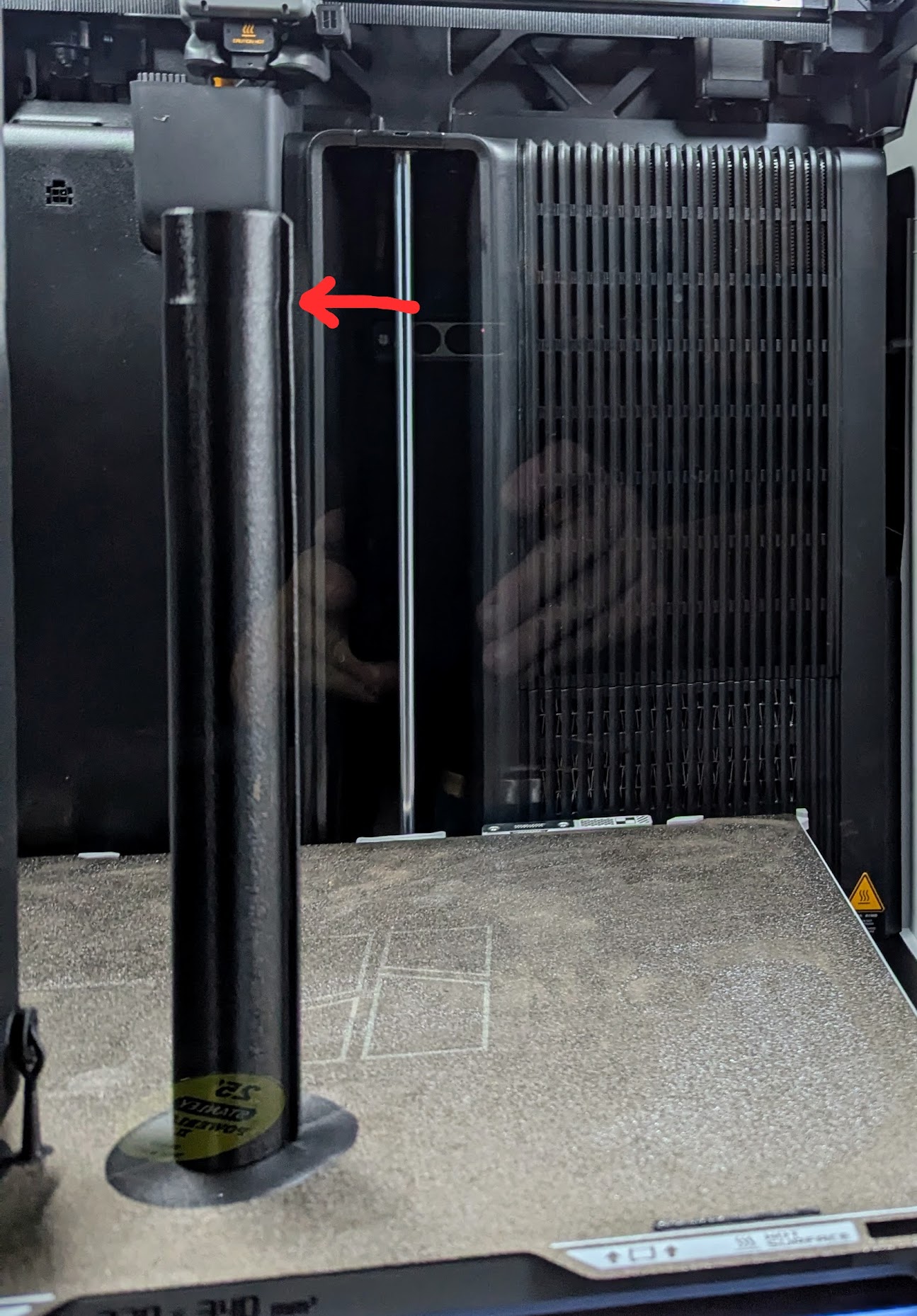

H2S layer twisting at specific height

Yeah this would be a valid workaround, but unfortunately the active heating of 60-65C makes layer adhesion around 1.5x stronger from tests i’ve done myself and seen online than a passive chamber of around 35C. Plus less warping! It’s been a few months now, @BambuLab are there any updates on this issue?
I know slicers like cura have a draft shield feature. If you could somehow get that to work it might help. I could be completely wrong though.
Yeah draft shield would help probably but would be unstable at the higher Z heights and would increase filament cost if you did a 2-3 wall draft shied instead of a flimsy 1 wall shield. Really good idea though I bet it would help if filament cost and print times aren’t an issue to some people.
I actually just tested it out and it did not work lol, so don’t waste time or filament. bambu really needs to fix this issue because I only print with PPA-CF for my side business. It starts at 250mm and ends at 285mm then it looks perfect after that. Super annoying.

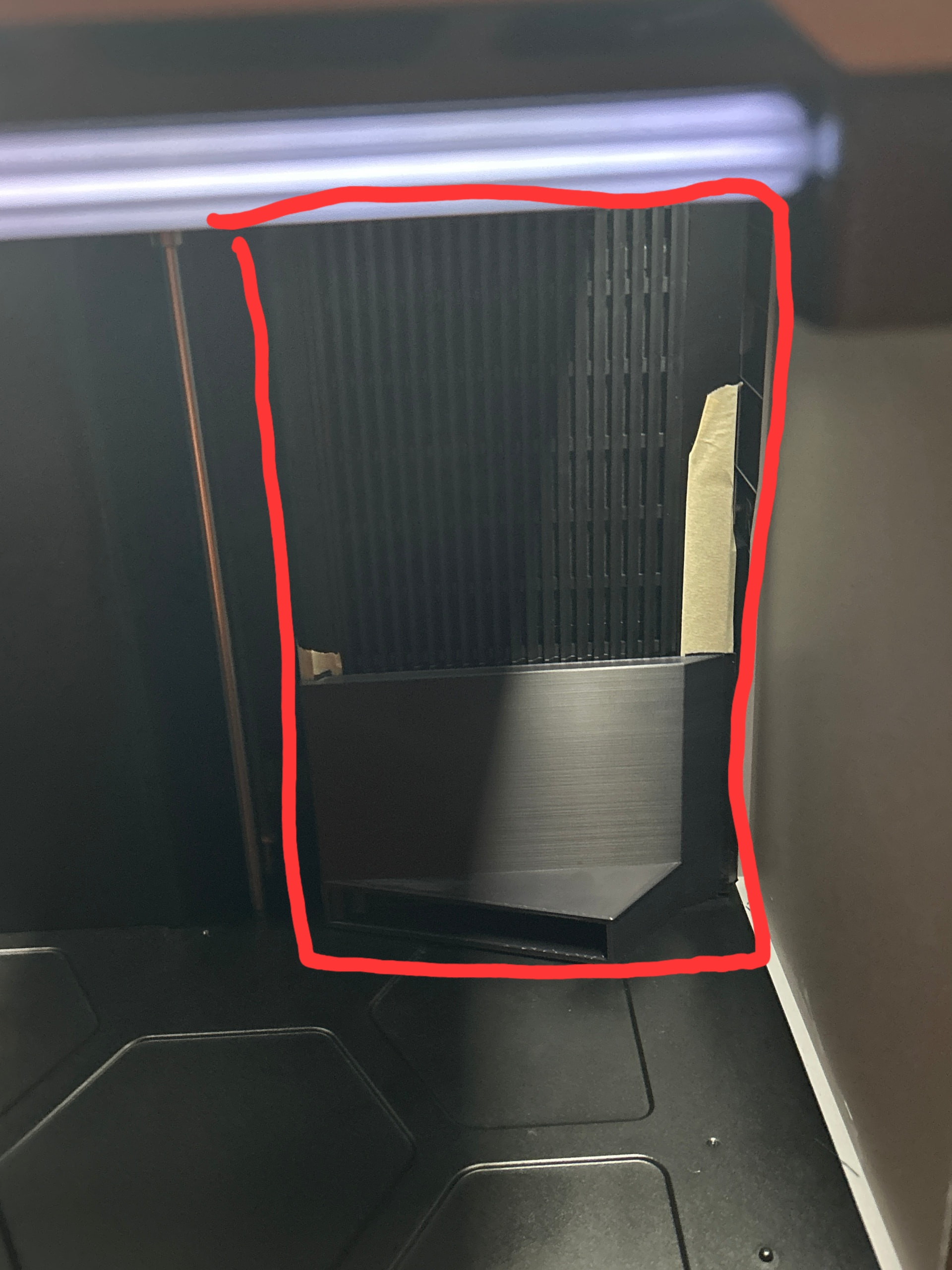

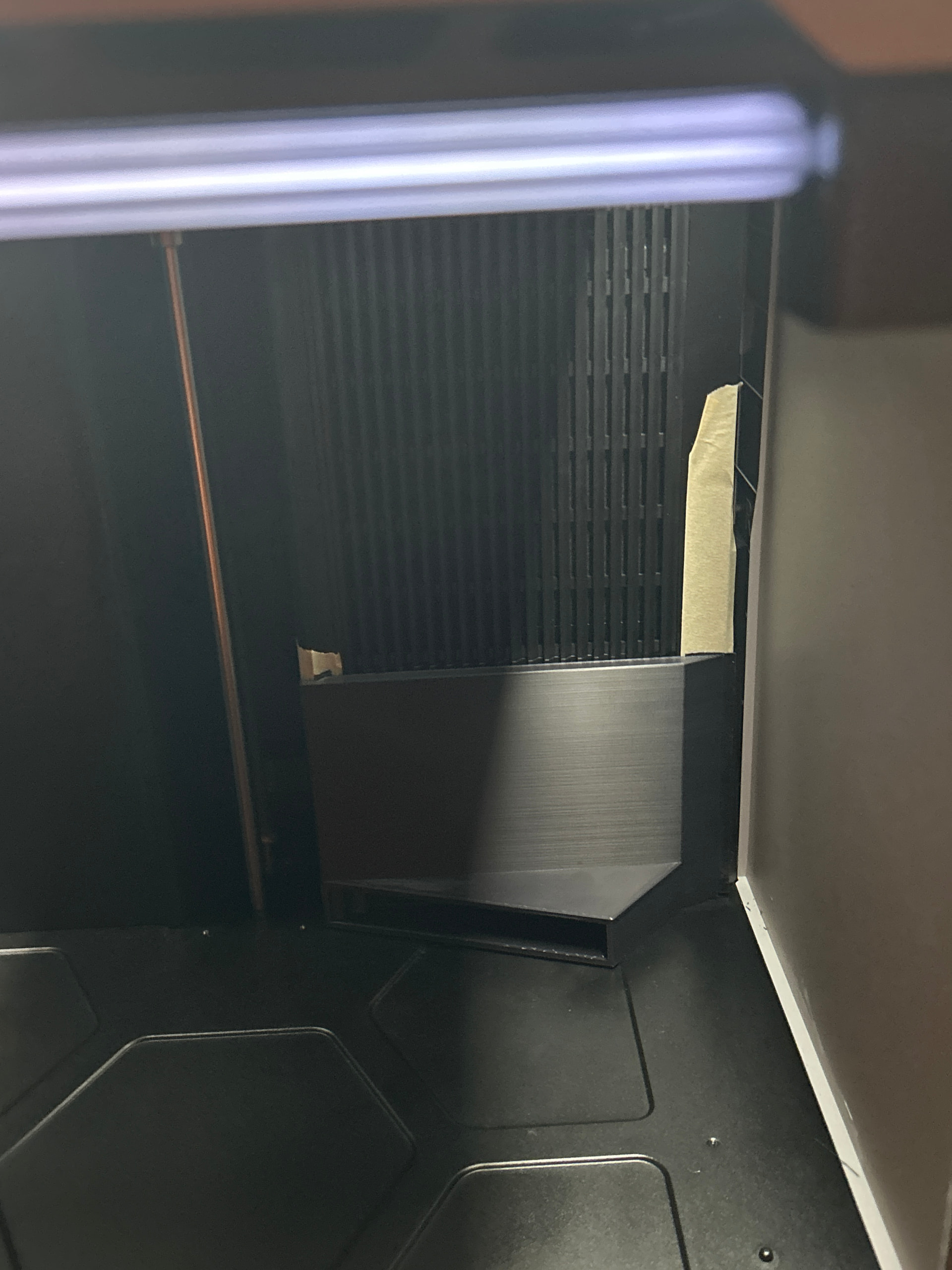

Hey guys, I ended up scanning and making a prototype for the air to be moved below the heatbed.
So far clearance works (very tight though) with 1mm thick double sided tape.
I’ll do a tall test print after confirming fitment at higher temps (thermal expansion could be an issue since the fit is extremely tight)
Will give yall an update and the file if it ends up working. Please feel free to give me any advice on if I should direct the airflow somewhere else or anything else I can improve on.
Thermal expansion ended up screwing it over a lot more than i expected lolll, even when I took the double sided tape off the inside and just overlaid it with regular tape instead. I’ll make it a good bit skinnier and retest​:flexed_biceps:
I hope it works! Fingers crossed!
What if we replaced this entire plastic part with a redesigned grille? That would create more space for airflow control, especially down at the lower section.
Yeah I thought of that, but the only problem is we’d probably have to cut the lower section cover where the actual chamber heater and fan is. That part unfortunately doesn’t come off like the upper chamber filter cover does.
New update guys so the newer one I designed works, the clearance is good now. But the only problem is the upper part of the chamber doesn’t get as hot. (Measured by feel and by a infrared thermometer gun)
The lower area where the airflow was directed measures approximately 64-66C. Whereas the upper areas of the chamber measure 45-50C.
I might go ahead and redesign another prototype where some of the air is directed down like the original prototype, some at a 45° angle, and some of the air directed straight up. What do you guys think?
Im not experienced very much with thermodynamics and stuff like this so I’d appreciate some feedback :slight_smile:
