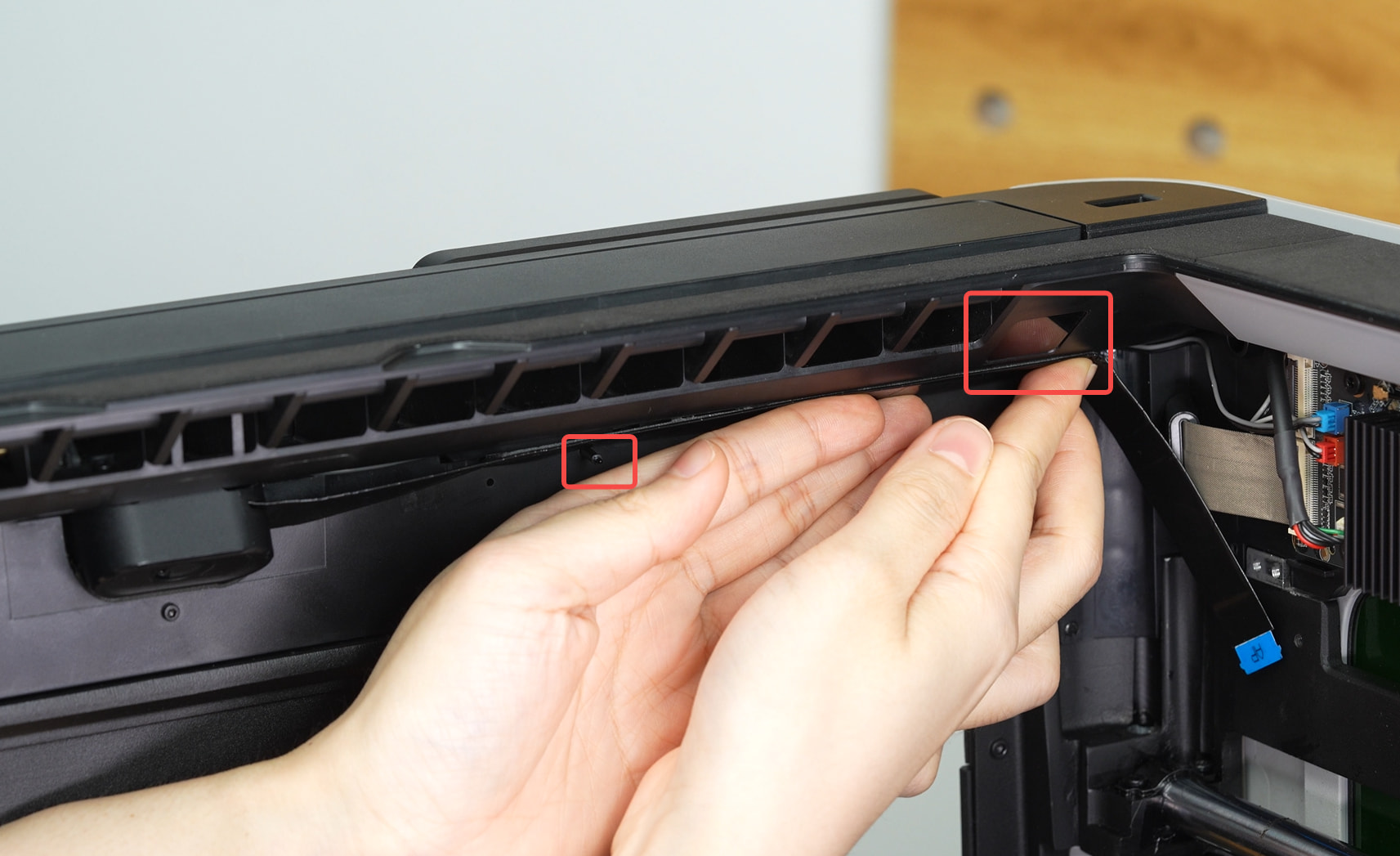

Does anyone know where the chamber temperature sensor(s) is located on the H2S?
Top of the printer, above door - smaller red rectangle on that picture
Simplest? Maybe, but estetically and ergonomically not so much
OK at least the chamber temperature probe is not somewhere silly, like inside of the heater duct. I don’t think any decent engineer would make that mistake but you never know.

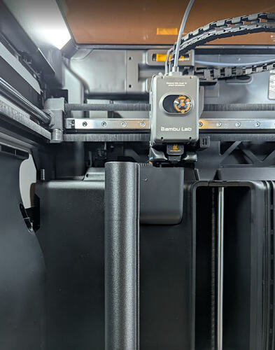

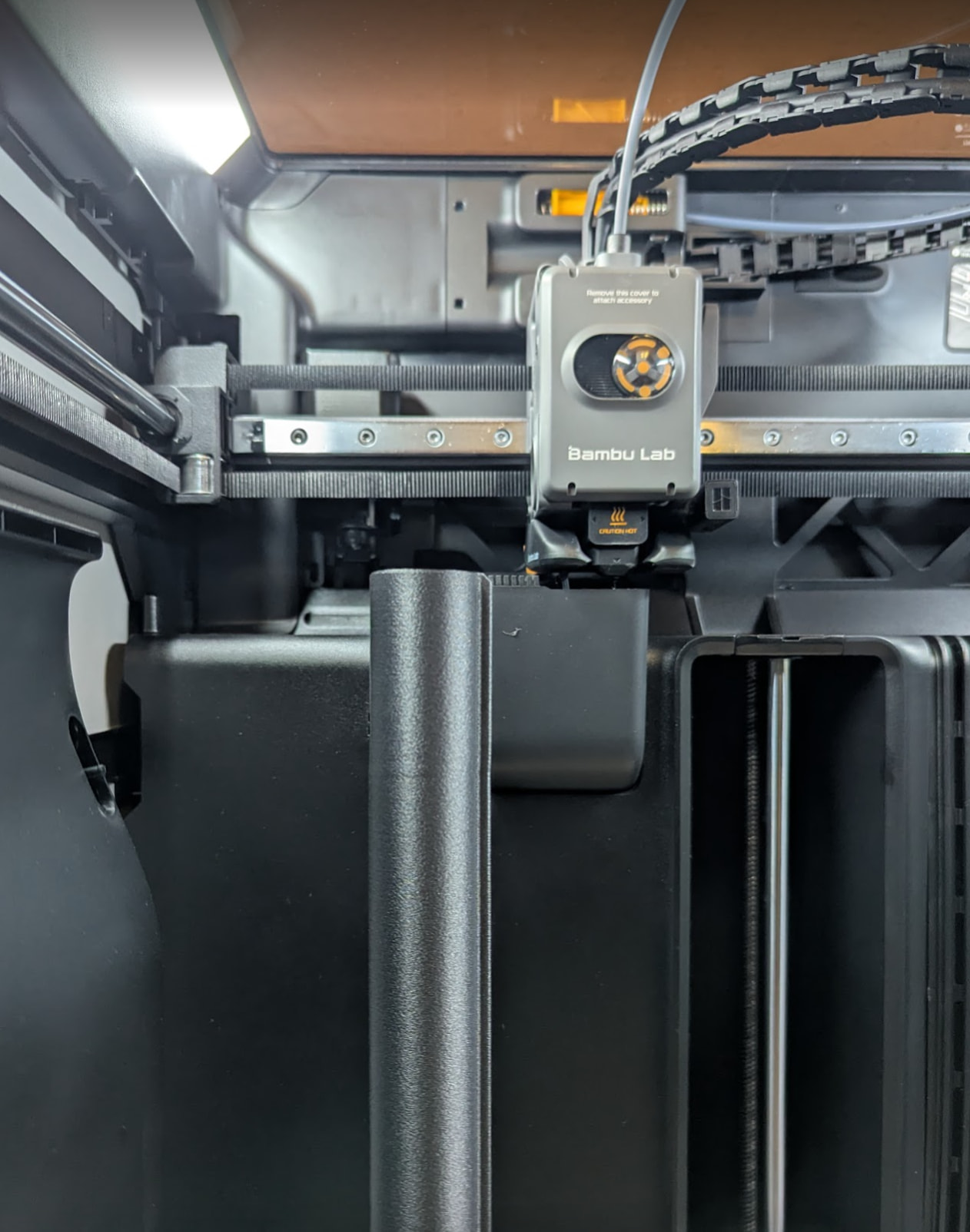

Now some significant news! I implemented the Bambu change to the g-code, the version that shuts the chamber heater off at Z = 230 and printed the same part again. THE PART STILL DEFORMED.
The deformed part printed with the Bambu g-code mod

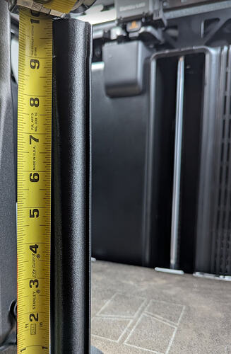

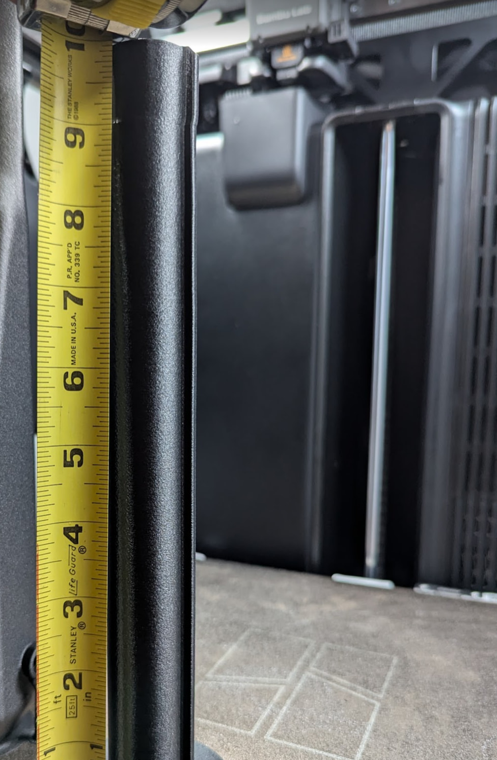

So I had an idea and changed the heater off value from 230mm to 200mm. That way the chamber heater shuts off well before the bed unshrouds the heater exhaust. I also moved the location of the print to the left rear corner of the printer bed; I am thinking this area is farthest out of the fan draft.
Those two changes worked. I got a print of the same part, in the same material, that does not have the previous deformation.
This shows where I placed the part on the bed
This shows the part after printing has finished
For reference, this is my modified version of the g-code ‘fix’ provided by Bambu, with my change from 230 to 200 for the z value. Use at your own risk.

I was next to the printer during the print cycle and heard when the heater fan shut off. The bed was in the position shown below. It is clear to see that the bed was well above the chamber heater exhaust.
Position of the bed and heater exhaust
So, for my filament, printing my part, with the part in this particular position, with my change to the Bambu tech support supplied g-code mod, I got an acceptable print. Success! Sort of…

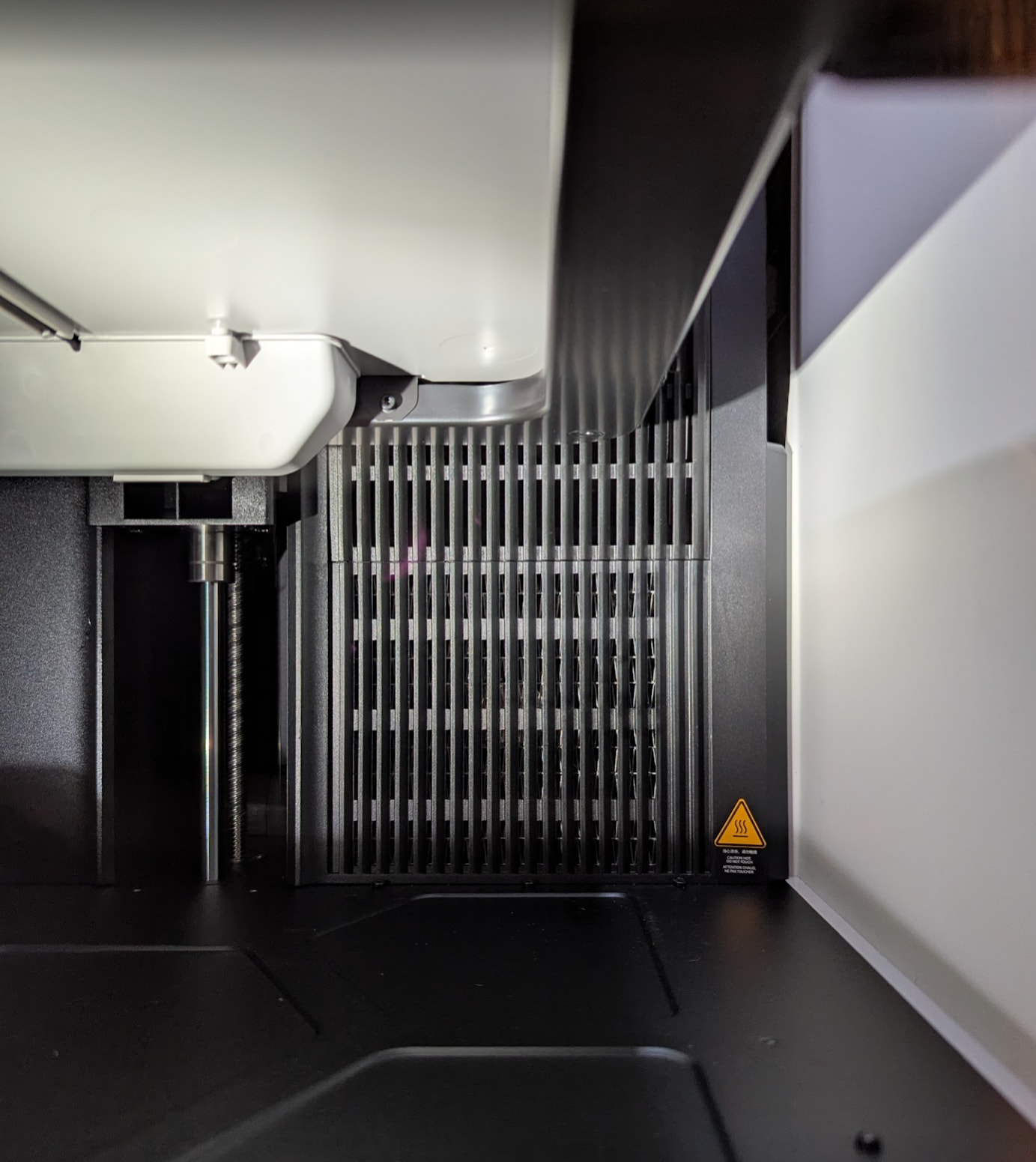

I am not sure I agree it is the flow over the bed that is the specific issue. I believe at the very least it is also the direct impingement of the heater airflow directly onto the part when the bed drops below the heater outlet.
I have not tested or measured the temperature of the air coming from the heater, so it’s not a confirmation of the behavior.
So if you want to be sure, measure the temperature of the air coming out of the heater exhaust when reaching that height.
Additionally a test with a bed temperature equal to the chamber temperature, could give a good indication also.
My assumption came from the fact that there is a part on the bed with a tiny footprint and a huge surface area of 100C that suddenly gets into the air flow.

Has anyone discovered if it’s an issue with the print bed blocking the heat vent (therefore the part cools too much) or if it’s an issue with the heater vent combining with the heated bed (therefore the part gets too hot)? I’m about to run some test prints to diagnose.
My guess is the latter. The hot build build plate is heating up the airflow and causes the sudden change in temperature.
